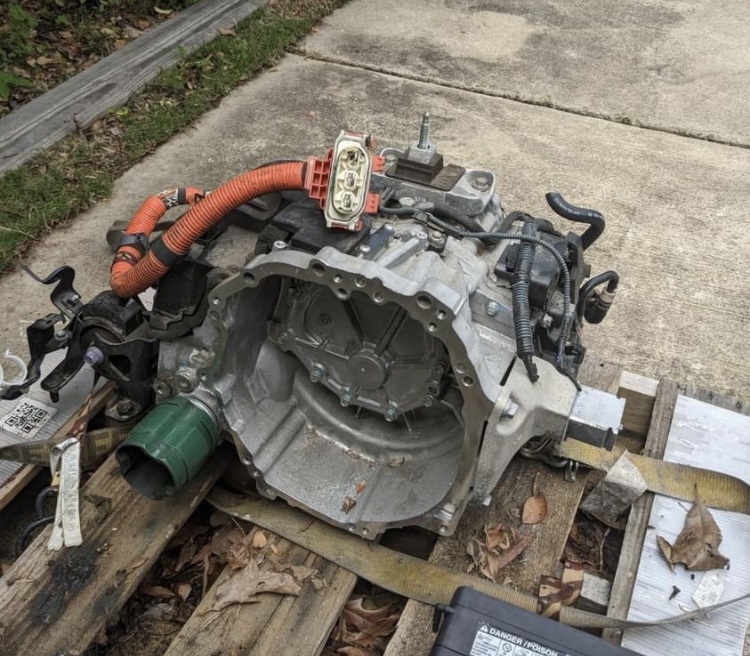

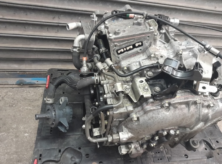

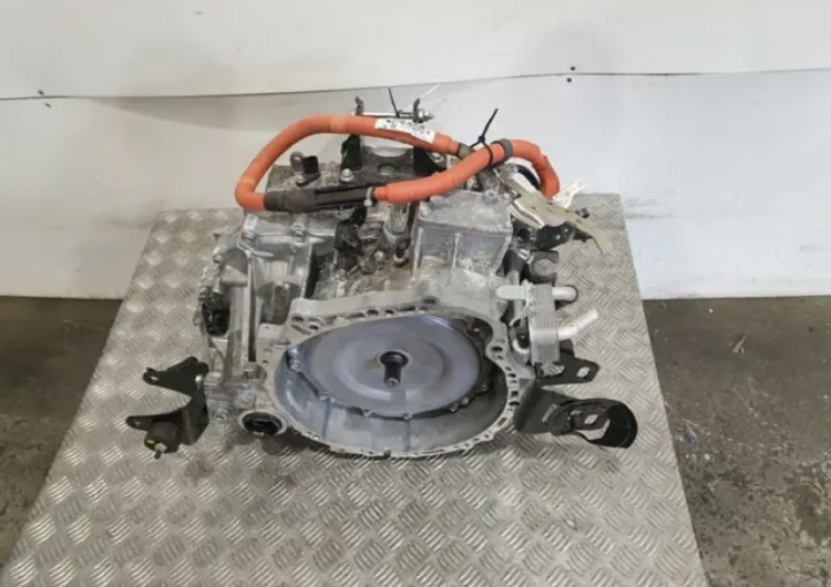

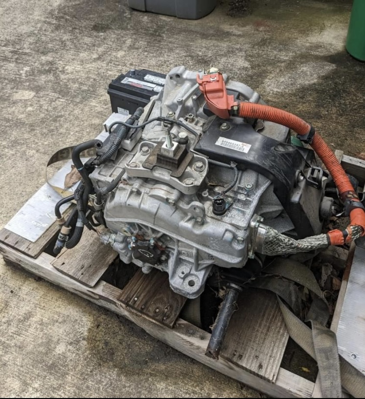

Interesting I’ve just seen a Toyota Mirai motor come up for sale
From the outside this looks like an rx450h transaxle with mg1 removed.some changes to the bellhousing end but pretty much the same on mg2 end! Toyota rates the marai at 134kw with a gear reduction of 11.691:1 and a tyre size of 235/55/19 which seems to indicate they are spinning an mg2 sized motor to approx 9.5k rpm to hit 70mph. I’m guessing that the marai motor must be wound differently!
Re: Project RX8 , Prius gen2, Lexus transaxle to rwd
14500rpm to hit its max speed of 108mph
If it is the same high inductance mg2 from the rx450h then Toyota are doing some magic to spin it that fast!
Looks like they must still employ a boost converter as battery is 310v nominal

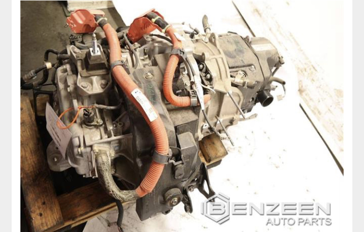

I did a bit of searching and see this link: https://tinyurl.com/2fzxdynn (Sorry to those in the future when this goes away)
It looks like there is a second motor that bolts to the "bellhousing". I see a second set of 3 phase cables as well, so they must have ditched MG1 in favor of something more powerful. The inverter also seems to have 3 separate 3 phase outputs: https://tinyurl.com/bdctkesm
It's quite interesting. I saw a Mirai chassis without a body on it on display in Tokyo in 2015. I only have 3 pretty lousy shots of it on my iPhone still. I didn't really know much of what I was looking at back then. I sat in the car on display as well.
Thanks that is interesting, so I looks like they are using mg1 aswell then… my pictures clearly show no input shaft in the bell housing and the thing bolted to the bell housing in your pictures looks very much like pictures I’ve seen of the large water cooled boost converter I’ve seen when searching, we knew it must be a beast of a unit to handle 130kw!
Added a picture to the full Maria assembly from your link

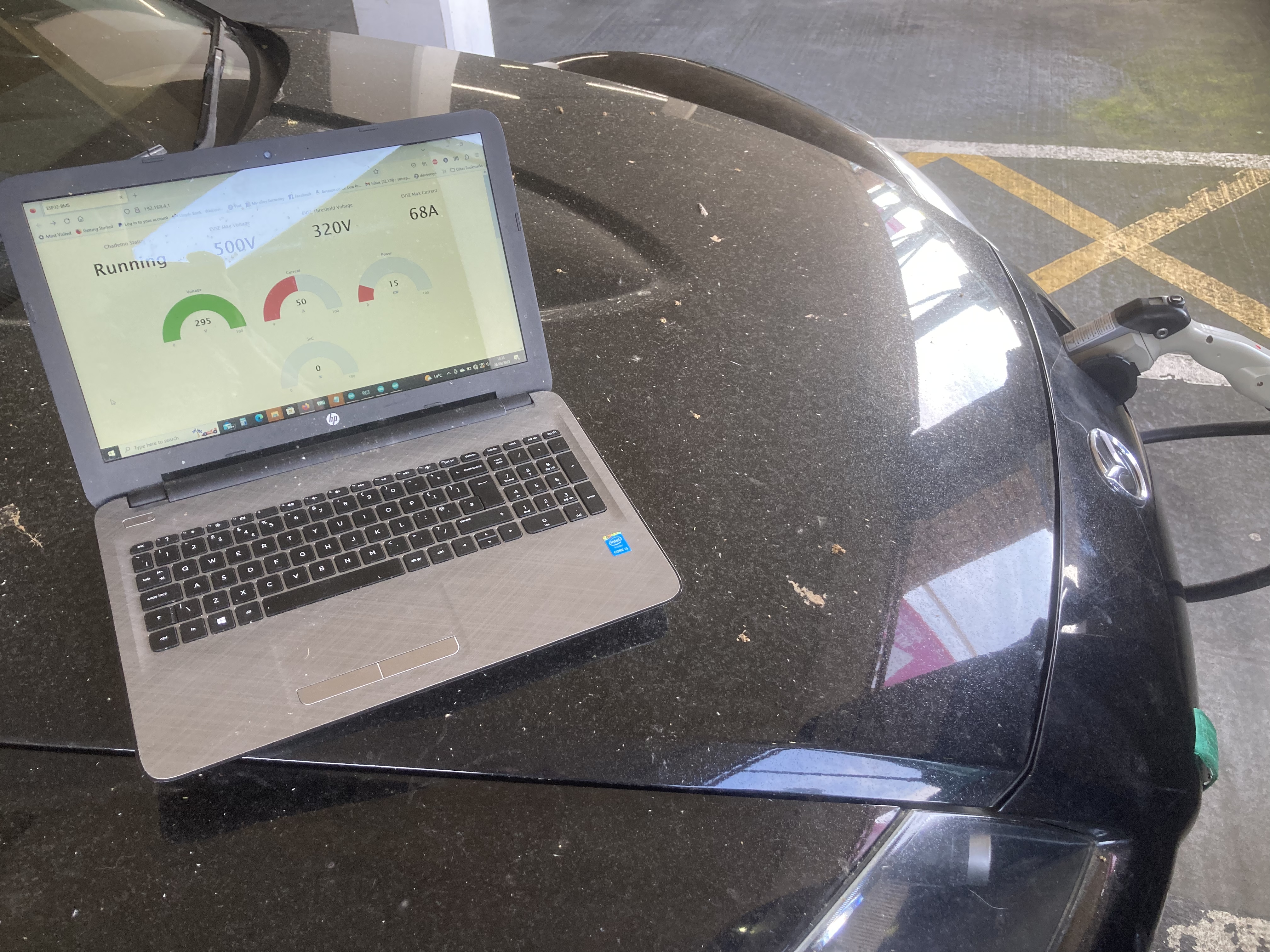

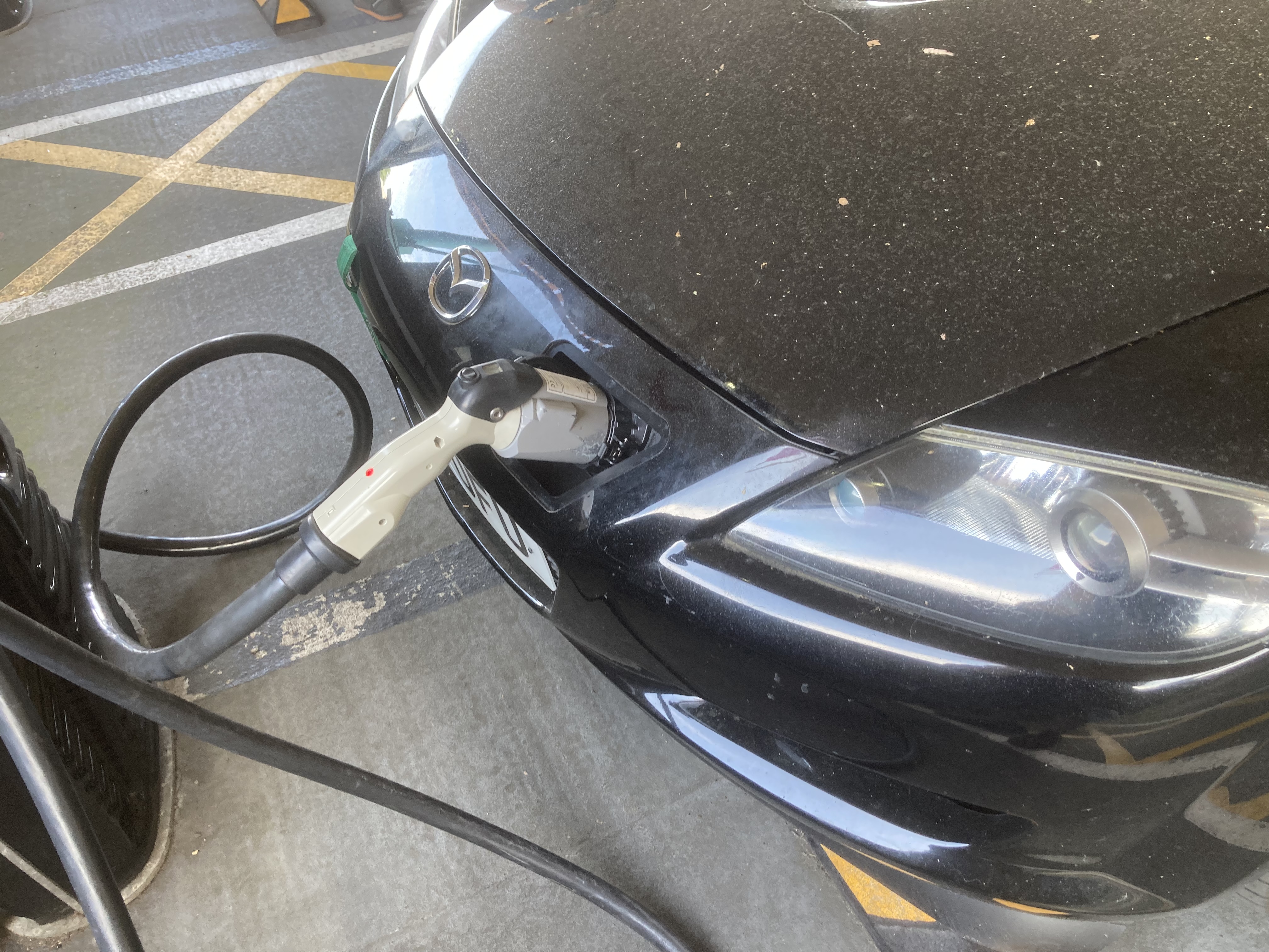

Wohooo! Chademo

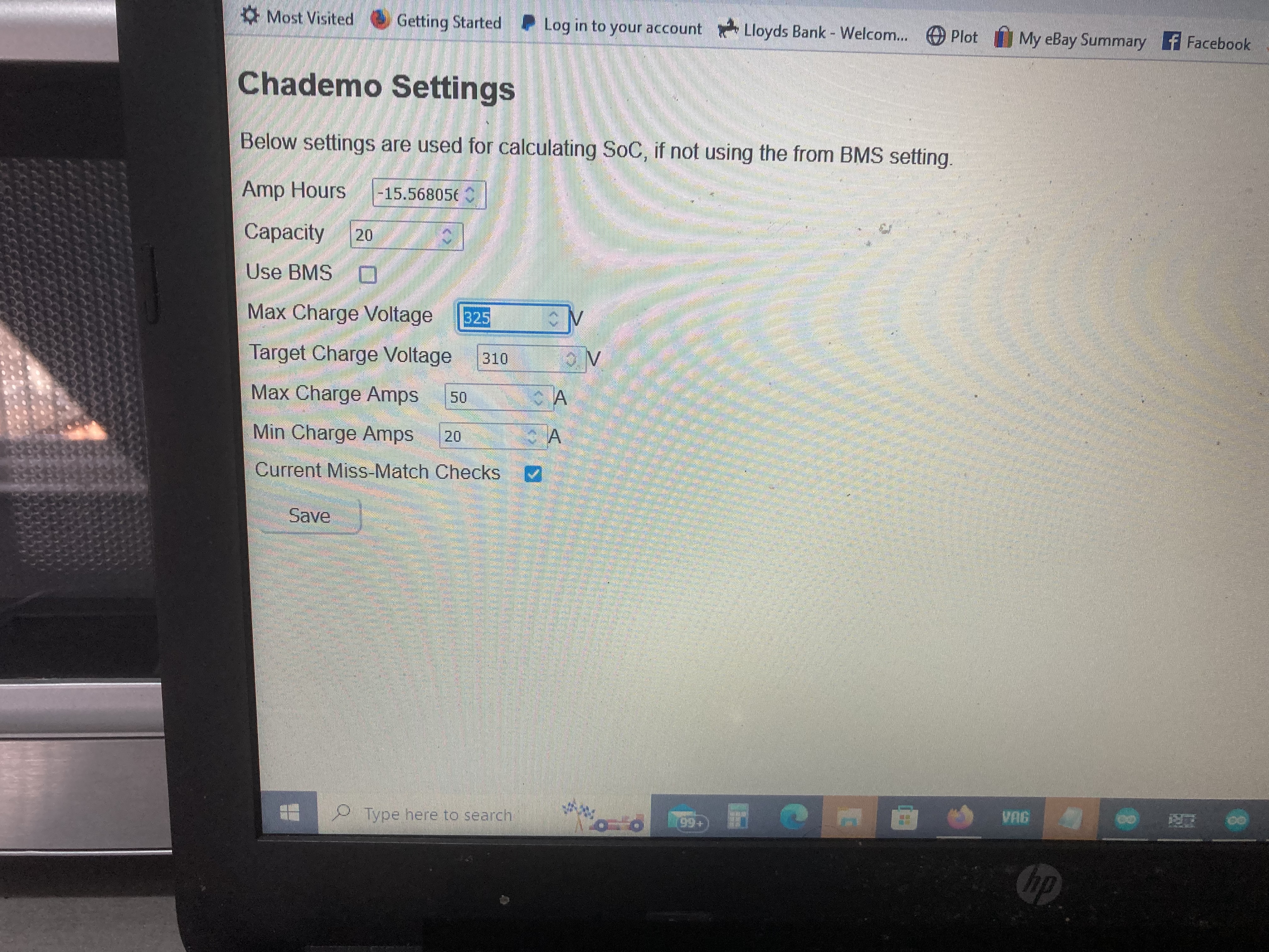

First charge! About 6months later than I’d hoped but finally got there, Hardware is Jamie’s esp32 chademo, it’s a tidy piece of kit, took me a second or 2 to figure what can the isa shunt needed to be on! Lots of wiring to tidy up and need to work out why Soc constantly shows 0%
In The ah settings the capacity seems to just count to minus figures, if I can’t figure it out I’ll just run another twisted pair to the bms as Jamie’s code seems to read the standard simpbms can message for soc
Any input from the creator would be welcomed!
Sorry for the terrible pictures and the state of the car it’s covered in sticky tree sap!

Yes, the SoC is a bug that I've not looked at
I switched to using simpbms reported SoC.
Glad to see it in action on another car. What unit model and network was that?
