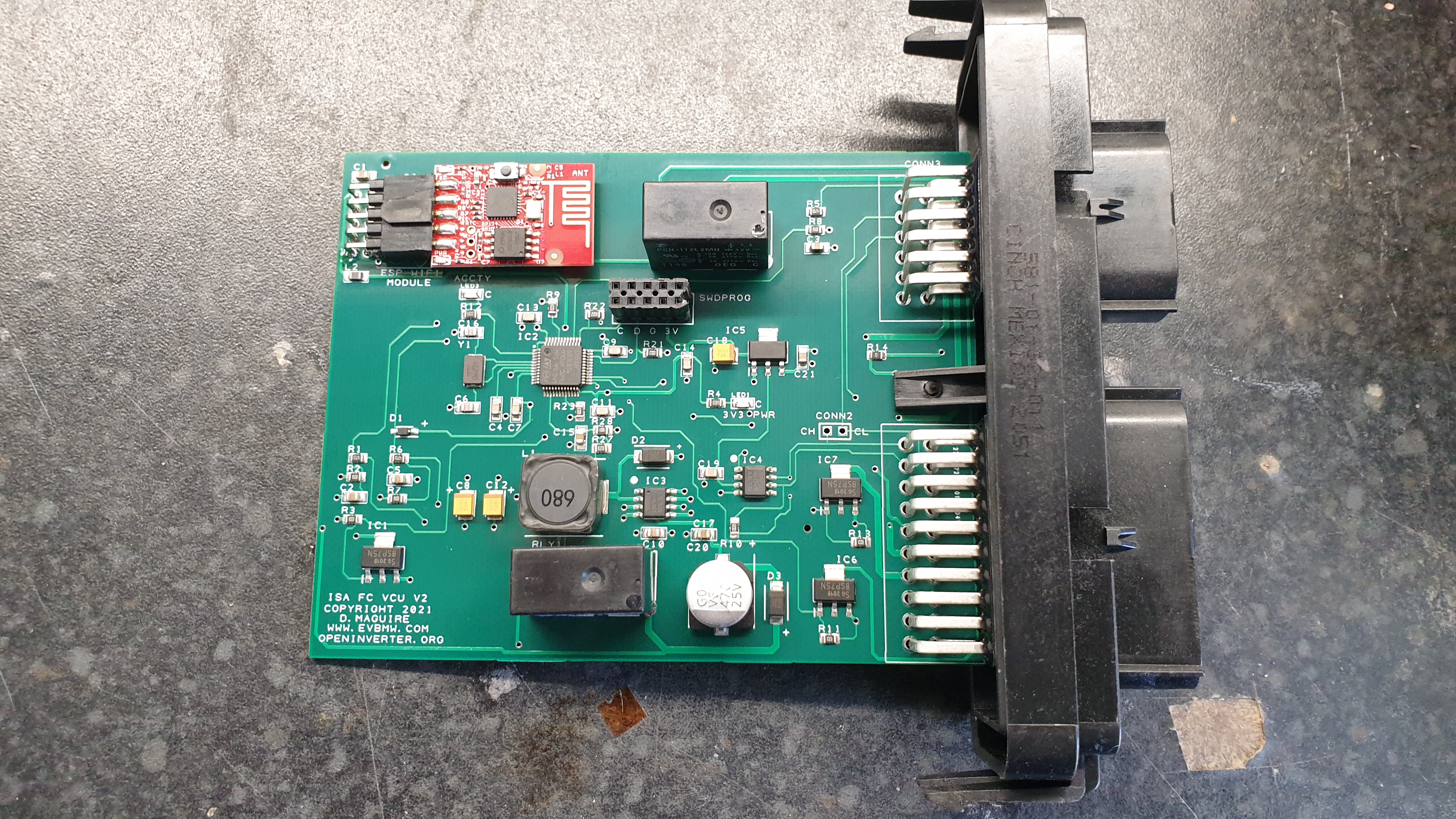

Folks, as it seems the SAM3 due processor is the latest victim of the global semiconductor shortage I'm going to move the chademo controller to the STM32F103 and use the openinverter template for software. I don't suppose anyone would be interested in assisting with the software side of this?

- Posts: 4000
- Been thanked: 1116 times
The only problem I have with Teensy is its a board not an IC to the best of my understanding. I'm not going down the road of piggybacking boards. Appreciate the offer:)
- Posts: 4000
Schematic for stm32 version. Farirly simple from a hardware point of view. Pin compatible with the sam3 version. Now to go rip off Johannes stm32car....again ....
Chademo_VCU_V2_ISA - Schematic.pdf- (154.36 KiB) Downloaded 356 times

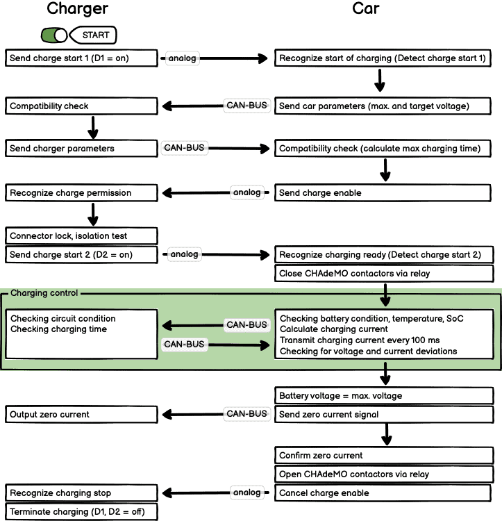

Did you make a start? I've taken stm32-template, added the chademo library from stm32-car and started on an ISA shunt if that's of any use.
https://github.com/jamiejones85/stm32-chademo
- Posts: 1884
- Has thanked: 91 times
- Been thanked: 517 times
I've found a flow diagram to follow https://www.evcreate.nl/chademo-fast-charging-in-diy/

- Posts: 1884
I don't mind helping out on the coding side, but you'll have to do the testing. My car isn't yet mobile and I'll not be using an ISA shunt as I picked up a Telsa shunt cheap.

- Posts: 4000
Boards have arrived. Now time for some software...

- Posts: 4000
Yep thanks tried that out yesterday. I think something is broken in libopeninv or the bootloader as I can't get it to even flash an led. Same with other projects. Johannes is investigating.
