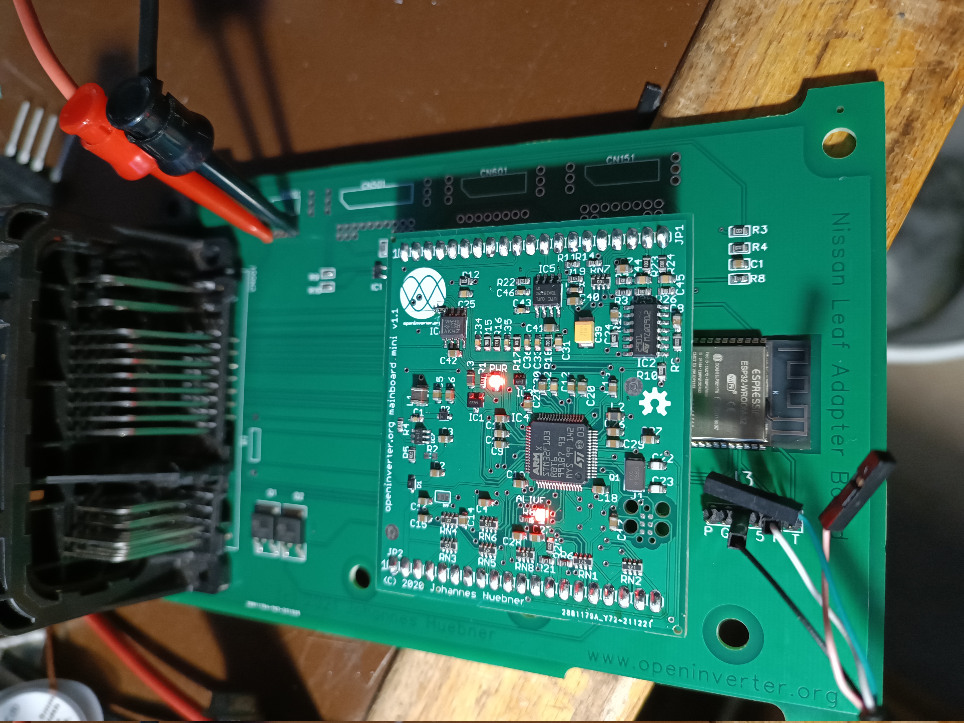

Got a large parcel from JLCPCB today, I think I ordered them just a week ago. They get faster every time!
So amongst them is the new Leaf adapter board with its integrated ESP32. So grabbed Petes ESP32 port (the other one didn't work for me at all). First thing I found it is using Serial2 for inverter comms. Bummer, I wired up Serial1.
So changed the code accordingly, removed all debug output (hmm, could have just moved it to serial2) and I'm now getting replies from the inverter but it's missing large chunks of data, especially noticeable on the json command.
Have you run into this problem? How to cure it? I found the question on the web with no success reported and also you state that the implementation doesn't use DMA.
Needless to say the little brother 8266 handled serial data just fine at 1 Mbit/s

Ok, I see. So went back to your version and only changed
According to https://www.espressif.com/sites/default ... eet_en.pdf page 9
Now I'm one step further. I listen to the inverter return data upon reset and I see
Then I change baud rate to 921600 on my terminal to find the ESP32 still sends its commands at 115200. I wonder if it power cycles for some reason
EDIT found that one. uart_readUntill() and uart_readStartsWith() was using UART_NUM_2 hard coded. I see the json reply from the inverter now but it doesn't end up in my browser
#define DBG_OUTPUT_PORT Serial2
#define INVERTER_PORT UART_NUM_0
#define INVERTER_RX 3
#define INVERTER_TX 1
fastuart
OK
Baud rate now 921600

Seem to remember using a different command to change the espressif api baud rate. Its possible that I forgot to use the #define in it?
Edit - its on line 505 - looks ok so not sure what the problem is, it worked fine on uart2

Oops, must have missed those, do a search on the uart functions and see if any others are still hard coded

All good, it was another hard coded UART_NUM_2 when reading the data. Now it works

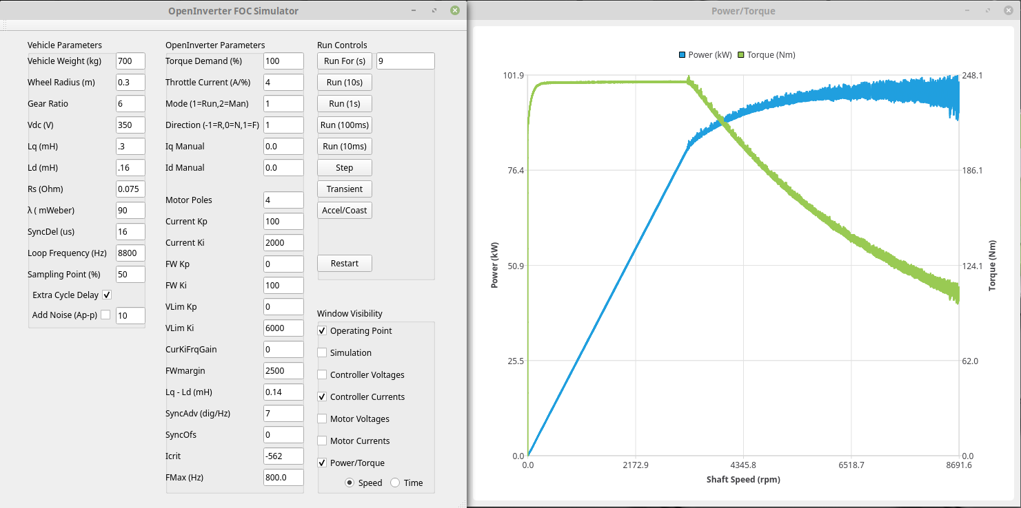

Re: ESP32 Based Web Interface & Data Logger
Is 70kW still the limit for you? If so any idea what is limiting it?
Your motor parameters seem virtually identical to the Outlander rear and when I simulate that I get almost a 100kW This is with a 350V battery voltage which I think is near enough to yours?
Edit - oops, meant to post this in the simulator thread
I've not had chance to mess around again yet, I'd stolen the esp32 for something else at the moment but one arrived in the post today so can start logging again.
I know the front is a lower torque to the rear I think 60kw 120nm vs 70kw 200nm based on Mitsubishi information.
I did briefly try upping the throtcur value to 4.7 (currently 4.5 I think) and that seemed to work on my show test drive but didn't have my phone on showing my shunt data and the boot was open with a desk hanging out the back
My battery is 96s so around 355 nominal

That could explain the difference. It would suggest that two motors have significantly different flux linkage values despite the inductances matching? Next time you're logging try to include a coast so that we can work the flux linkage value out.Bigpie wrote: ↑Wed Nov 09, 2022 5:18 pm I've not had chance to mess around again yet, I'd stolen the esp32 for something else at the moment but one arrived in the post today so can start logging again.
