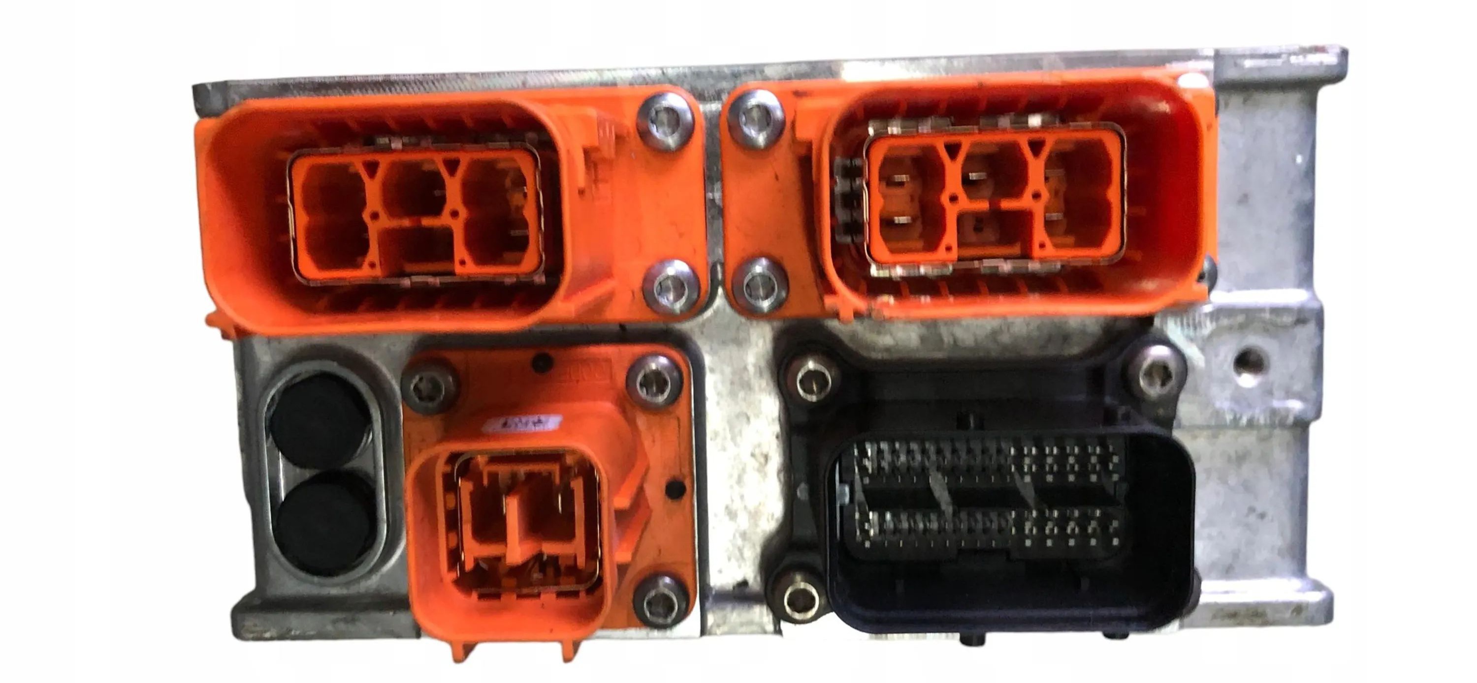

Just to avoid confusion: part number 1EA ... ... is MEB, not MQB.

Anybody had success making those chargers work? I'm particularly interested in 22kw versions or at least 11kw ones. Why do the 22 kwh versions have a second connector for what looks to be 3 phase charging?

Did you try getting the pictured charger working? How did it go?modellfan wrote: ↑Wed Oct 23, 2024 7:46 am I won't say how I found out. VW id.3 Chargers and the other chargers discussed here don't have the same AC plug. The id.3 and propably also id.4 / enyaq have small deviders bentween the horizontal pins. The others don't. CCS HARNESS NOT COMPATIBLE!
