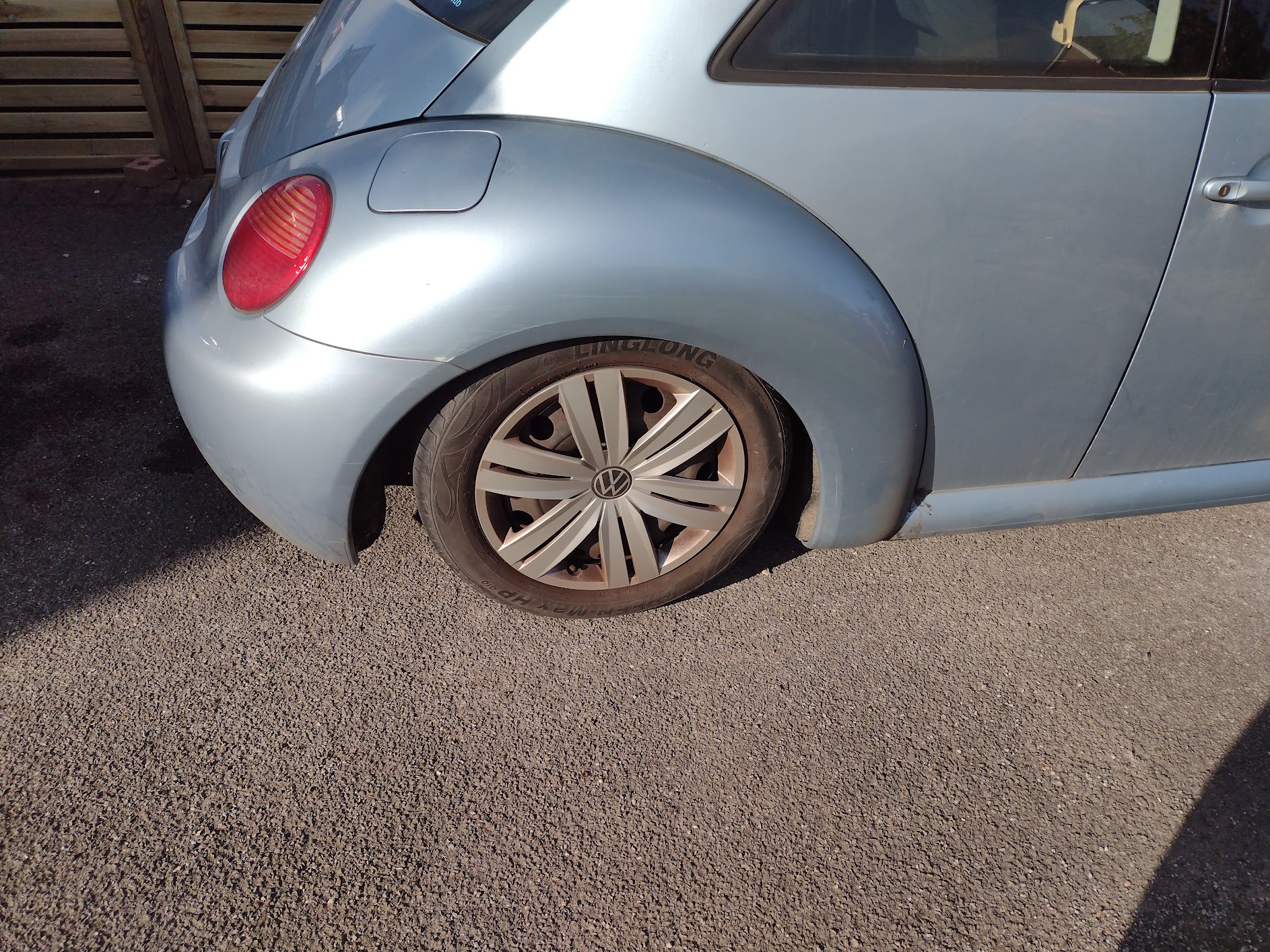

Posted: Thu Apr 20, 2023 7:57 am
by Bigpie
Cars been lowered
Unfortunately it wasn't desired.
I heard a clunk when I set off then the ride was pretty terrible.

Posted: Thu Apr 20, 2023 6:27 pm
by johu
Wow, how did that happen? Did it take out that HV cable?
Re: VW - Beetle 2003
Posted: Thu Apr 20, 2023 6:37 pm
by Bigpie
No idea, I'm assuming it's rusted and snapped. Not had a good look yet.
