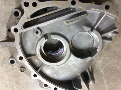

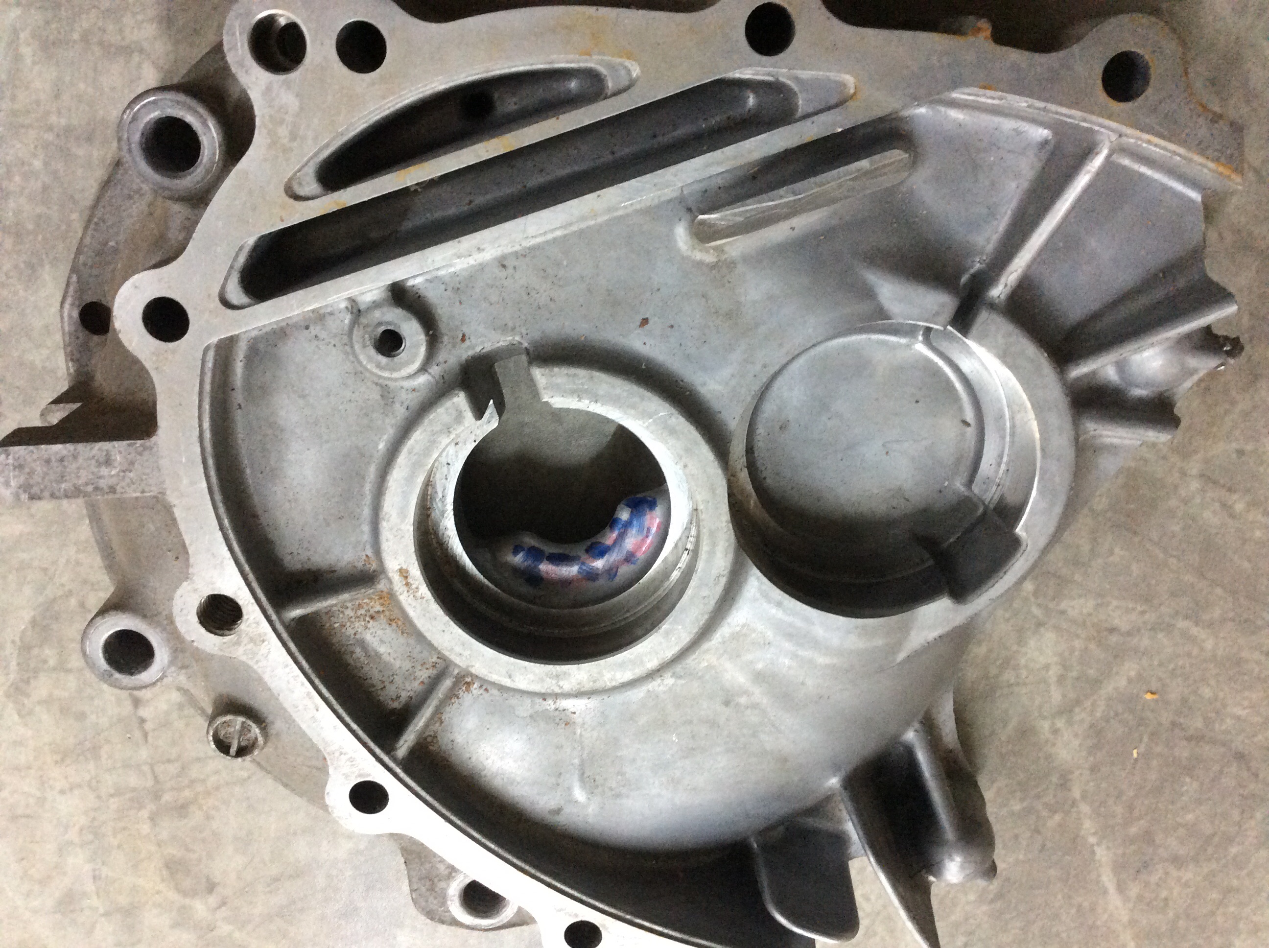

If indeed the problem is down to a bearing failure I have possibly preempted such a problem. I plan on using the modified face plate from the gearbox instead of building a spacer. There will be a steel plate between it and my VW gearbox.
If it proves to have been a been said failure then the cross hatched section in the pic will be removed and a suitable sealed bearing sourced to replace the original which had an open race which would have been lubricated via the gearbox.
The outer diameter of the connector would need to be machined to the ID of the new bearing. The original was a KOYO 6007C3 62*35*14.

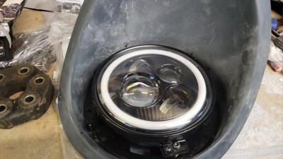

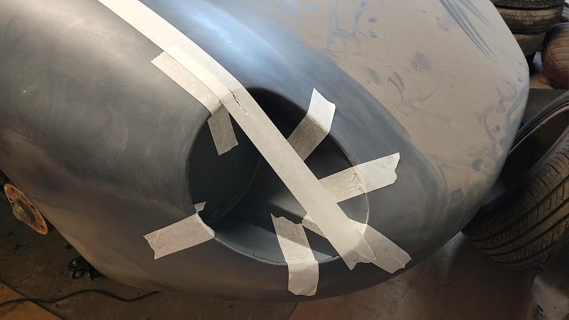

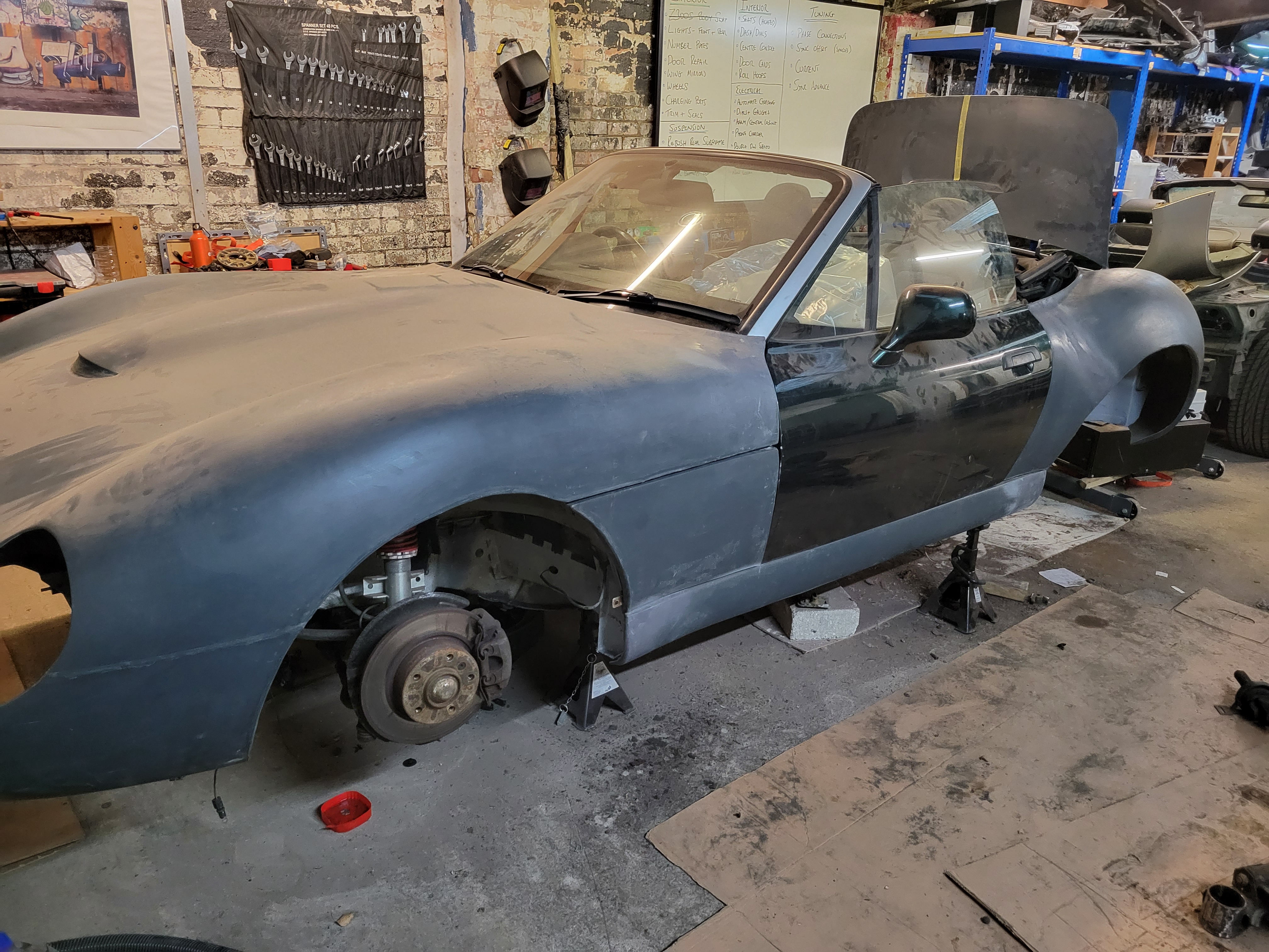

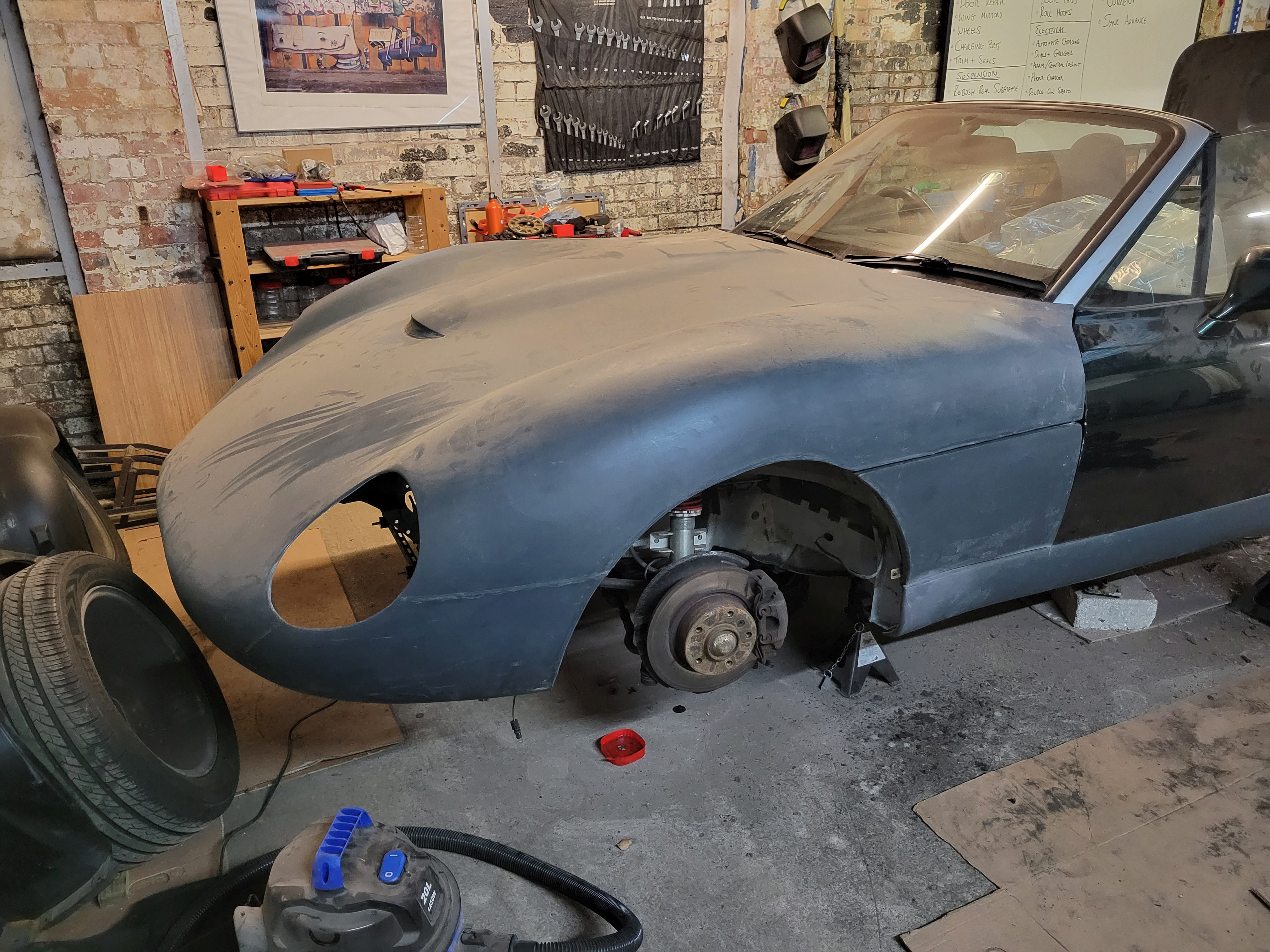

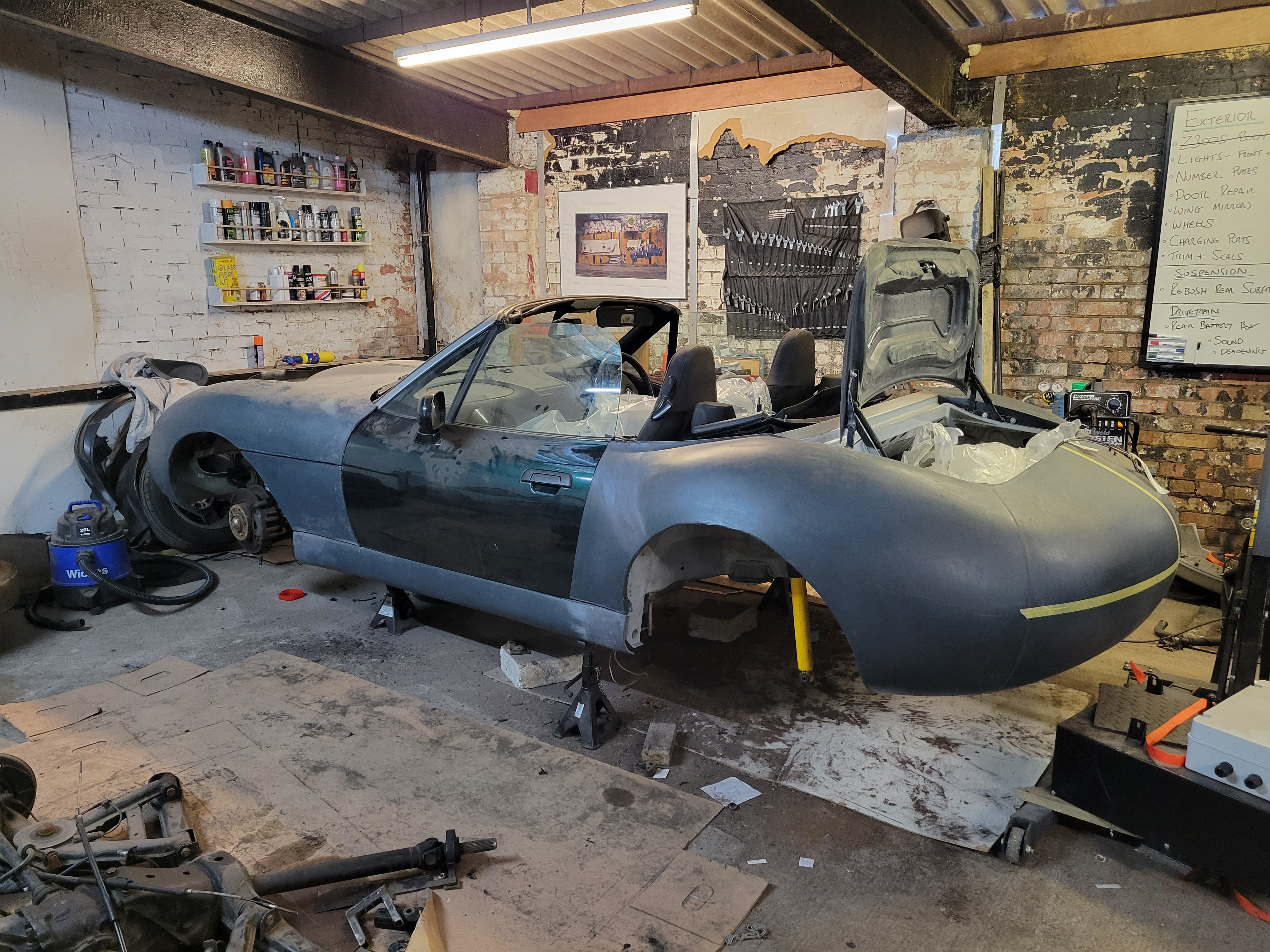

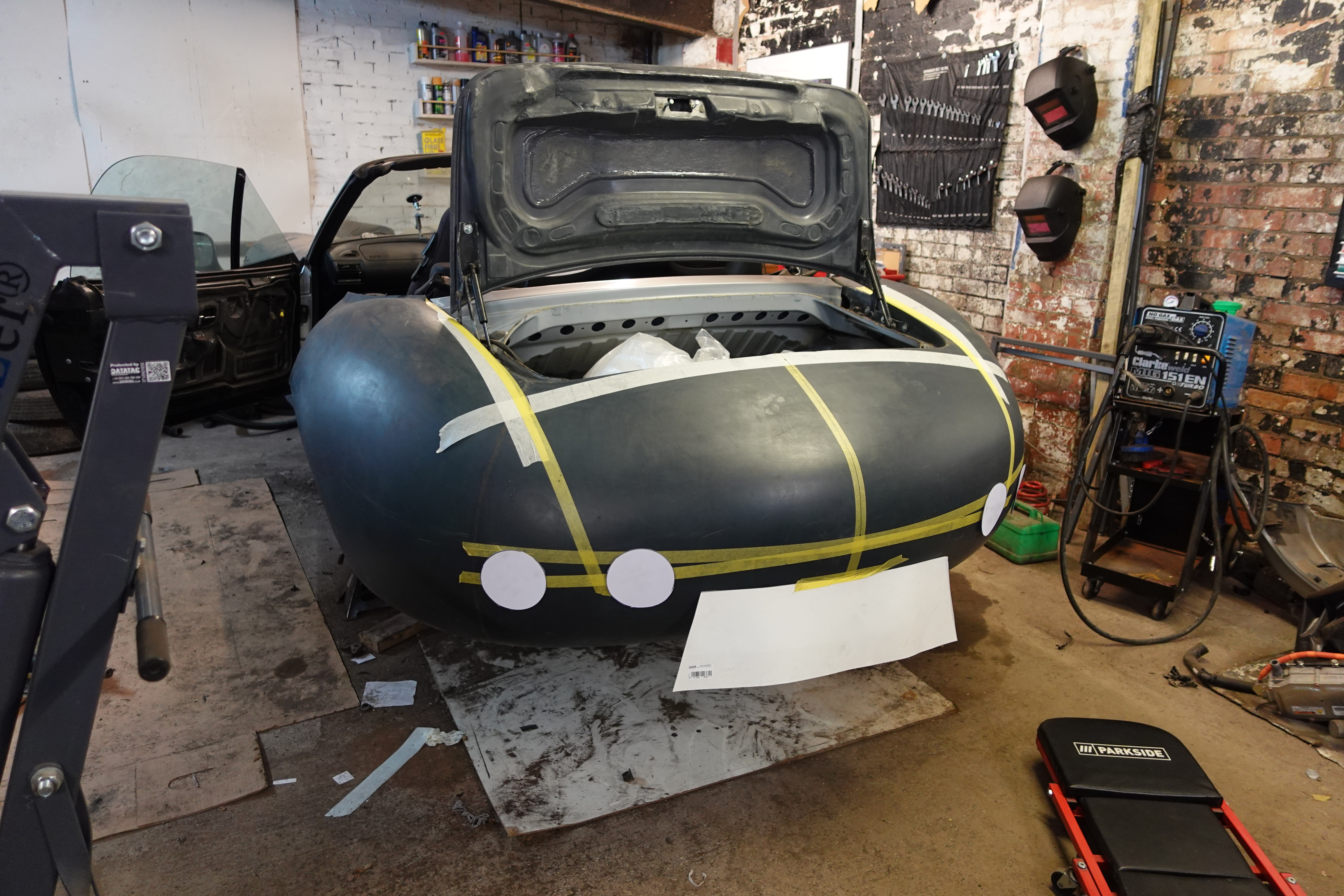

Re: Z3(00)
Working on the cosmetics (at last). Lots of progress on the body swap. Headlights half fitted. Now designing the rear end layout.
