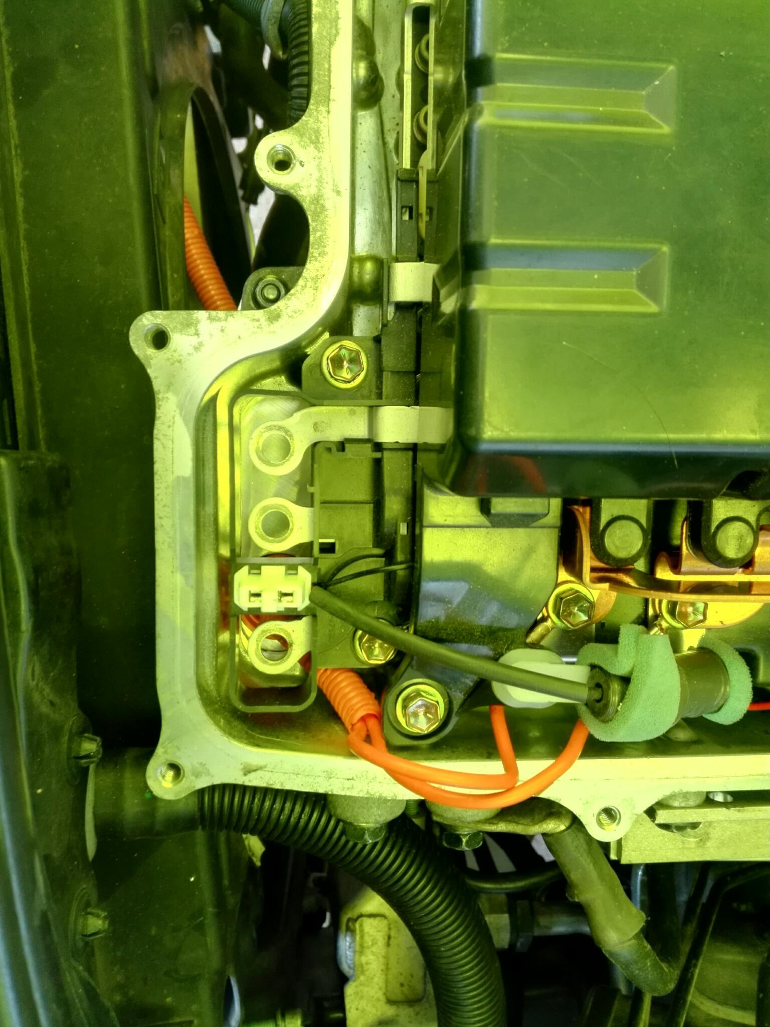

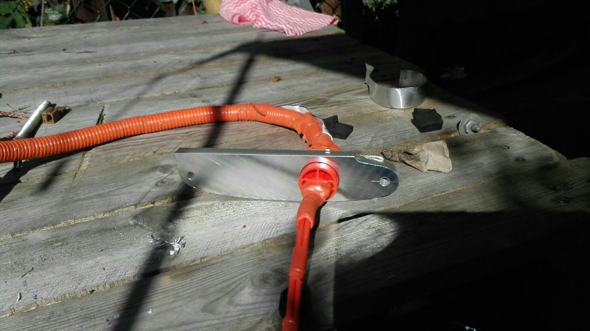

Attached cable for A/C today. Thomas made a custom cover for the MG1 outlet.

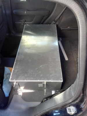

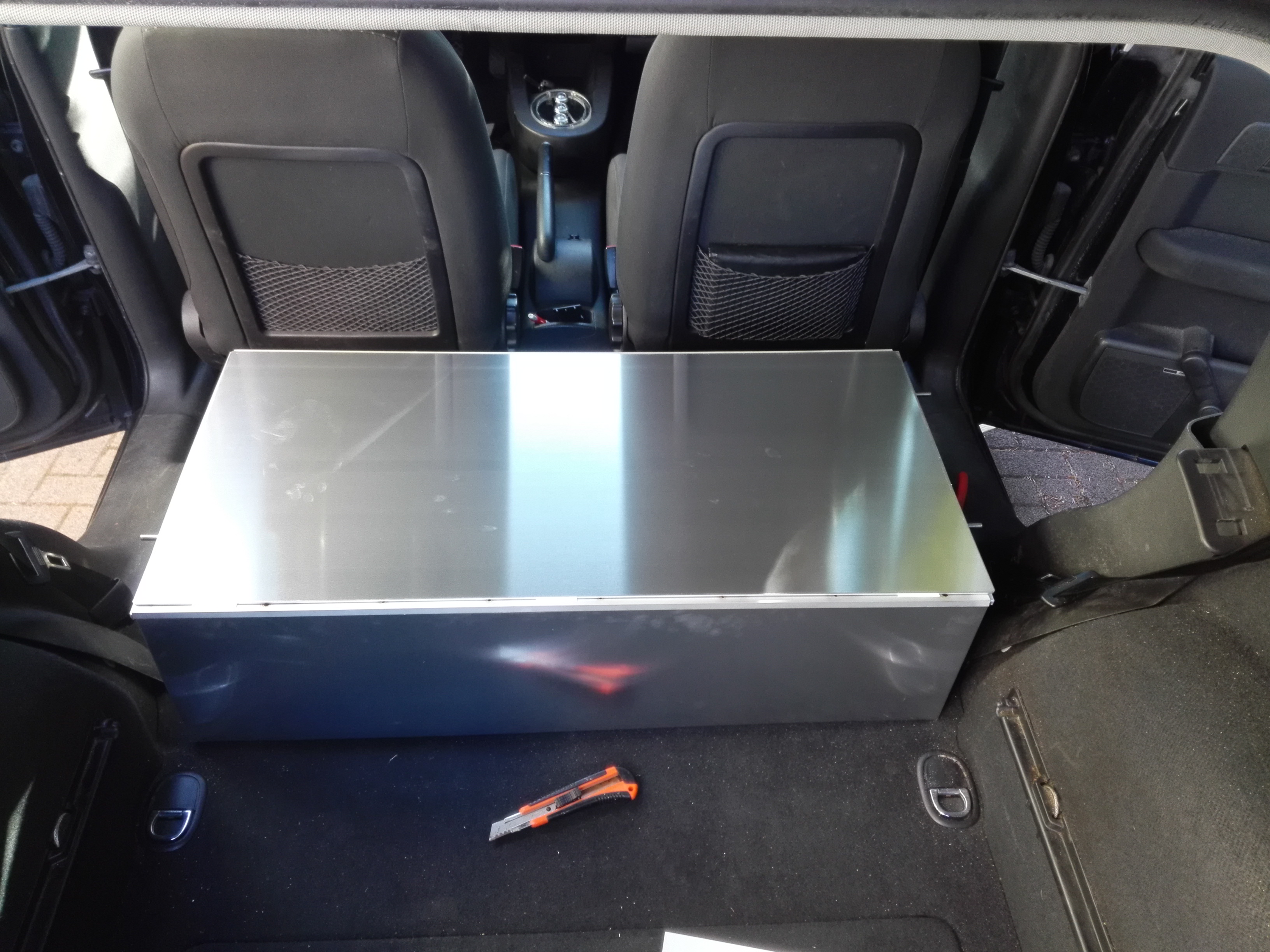

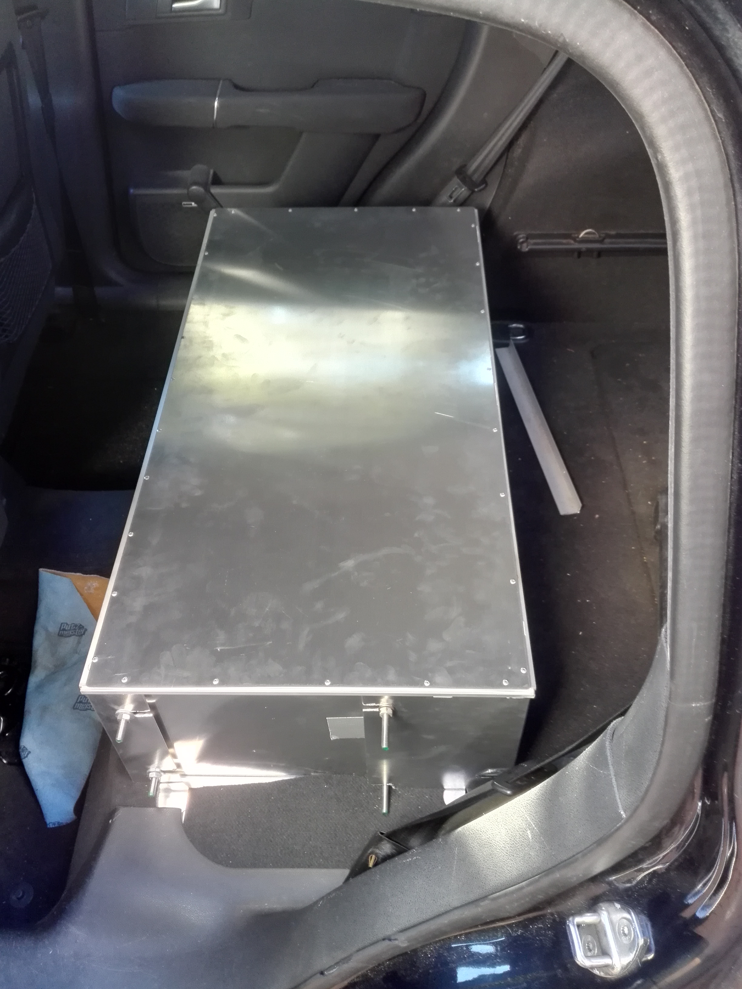

Battery box is coming along nicely. I divided the carpet, the outer parts extend to the front of the box to where they were before. The inner pat folds over contactors, fuse etc. to isolate those from the metal box

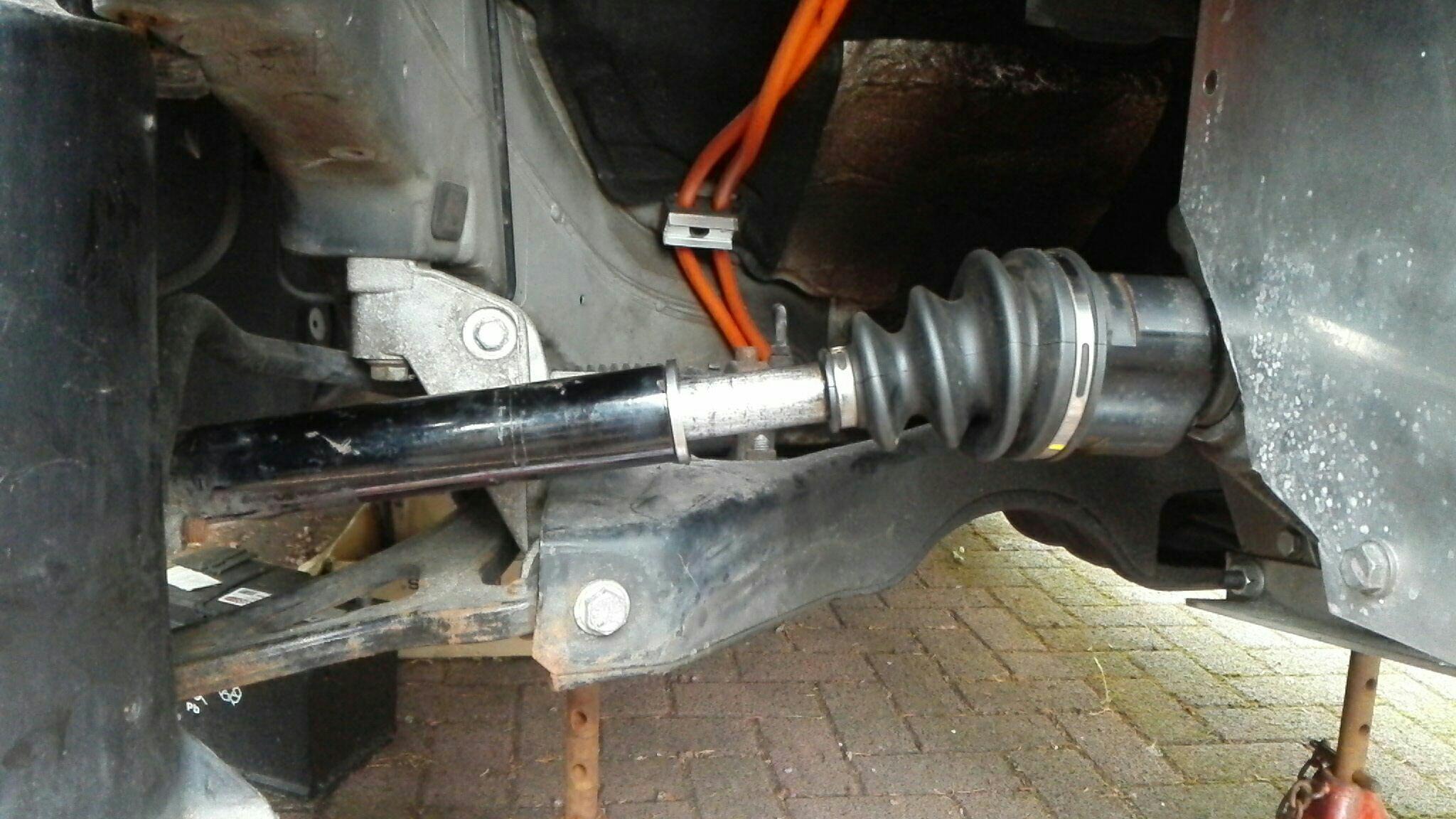

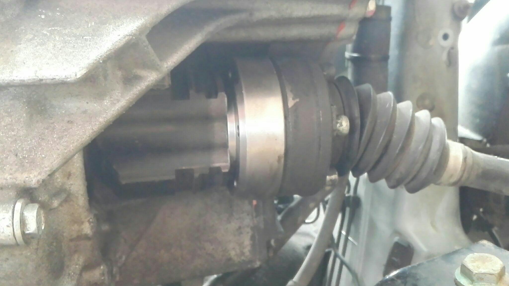

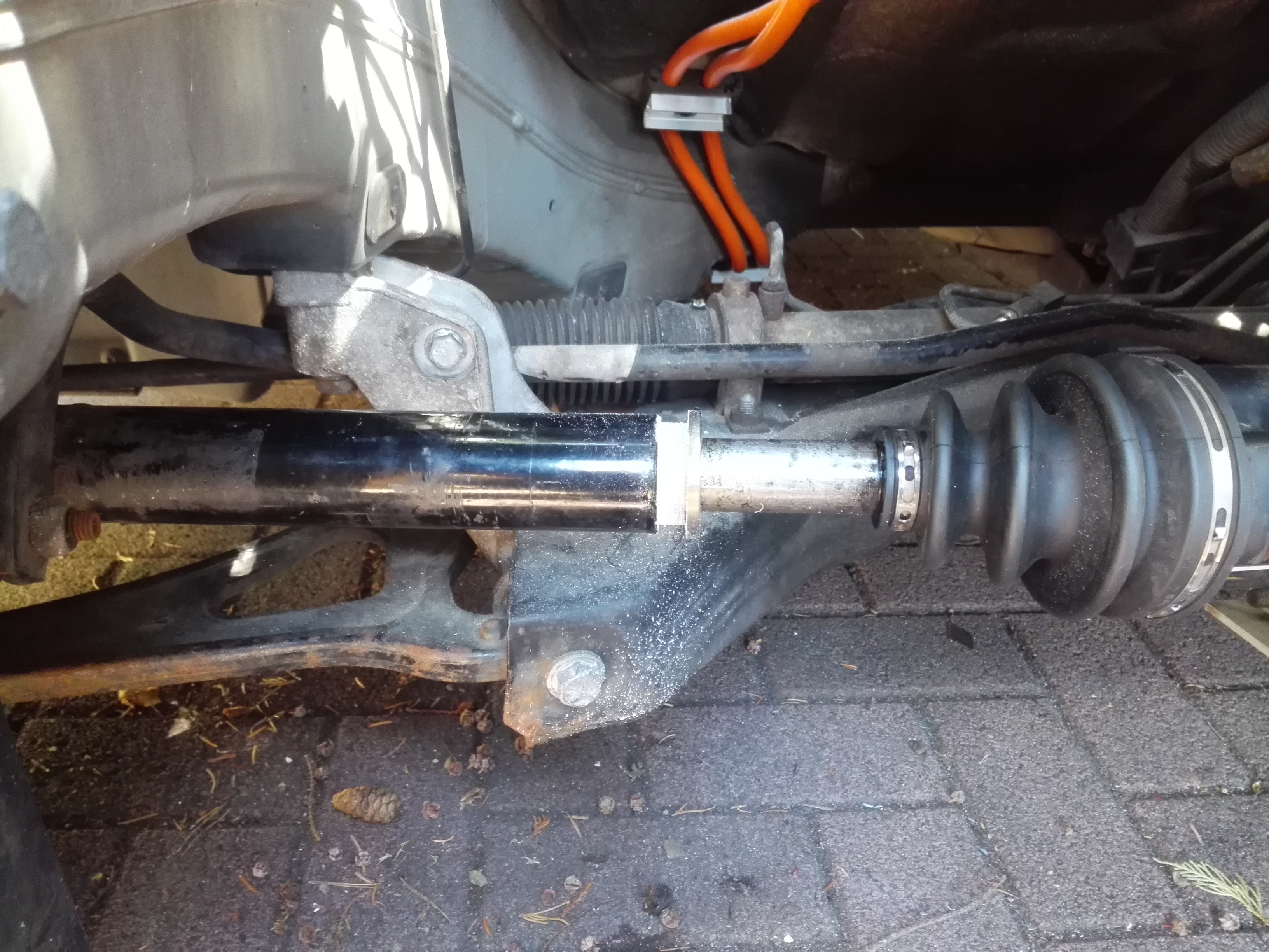

Finally the drive shafts are connected :D
I think driver side is pretty safe. Passenger side is an experiment: it is glued with Loctite 648 metal glue. Let's test how well that goes. I have to wait 3 days now for the glue to reach its final stiffness
If it doesn't work it will still be a good template for a drive shaft company.
The transmission sits forward quite a bit, not sure how much the shafts will like that being permanently "bent"?

My mg2-mg1 coupling has multiple parts press fitted with loctite 648, and one part also has a pair of parallel pins on mg2 end, so not a weld in sight and is holding up just fine! It’s awesome stuff

Yes the driver side shaft is solid and could be joined with a similar technique. So a sleeve that has the one diameter on one side and the other on the other. And then glue it. Of course it's always debatable how well this competes against custom made driveshafts e.g. from motomax.pl which cost less than 200€ each.
Material reuse is maximized "my" way for sure :)

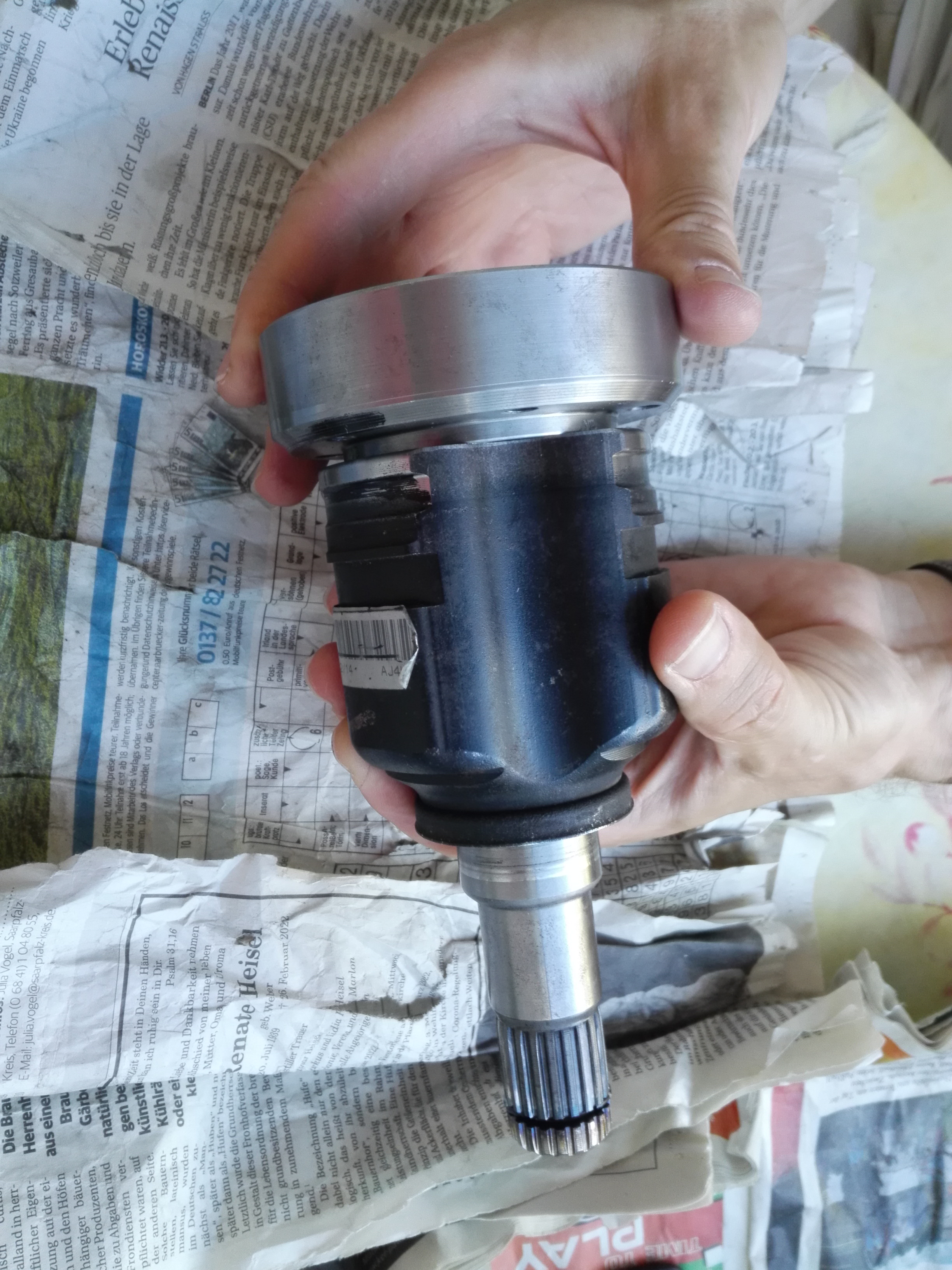

That didn't work too well... The handbrake is all crusty and won't release and was stronger than the glue. Car was still on ramps. I knew what would happen - at some point the ramps just shot forward. Just didn't expect them to puncture my Loctite cleaner bottle :(
No gotta get the whole thing out, clean it properly and glue again. If it don't hold up get a driveshaft made

I'll second Scirocco... shrink fit is stronger than welding. Doesn't take much temp difference could do it on a stove and deep freeze if you had to. Course... now that you're already smaller than press fit that's not going to work.
Why not just weld them and then grind them balanced-ish?
