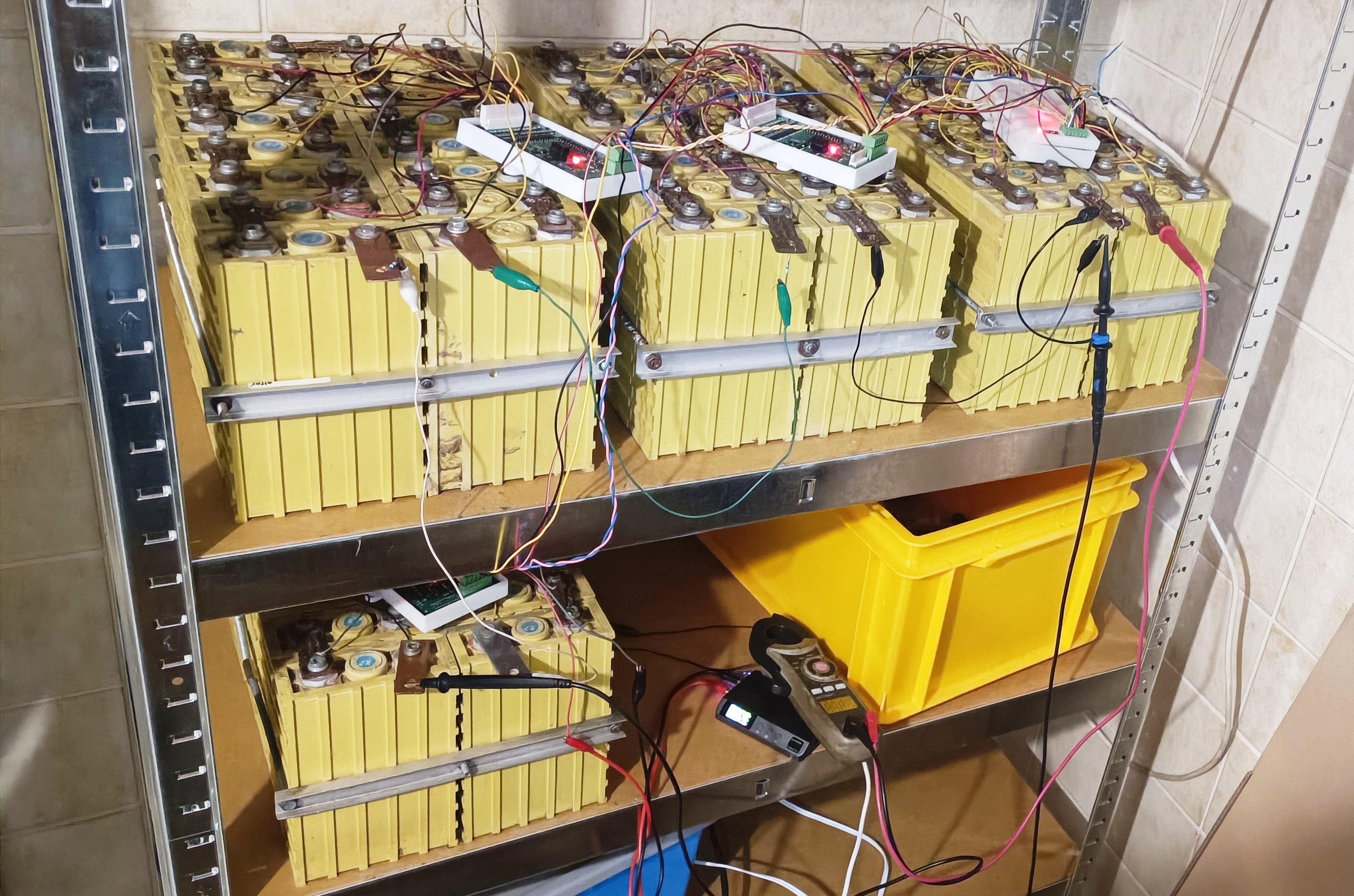

I carried out an experiment of my own with 64 LFP cells all charged to the maximum of 3.4V or roughly 220V total.
With the 4 blocks not interconnected I observed nothing strange. So I connected them all with 500 Ohm in between and measured across one of them with the scope to be able to see any unwanted current spikes. Nothing.
It's a mix of 2.1 and 2.3 boards.
Became brave and connected them straight through without the resistors to see if anything happened. Again, nothing.
Will build more battery bricks (have about 120 cells)

Do you have any 3.7v batteries to go over 4v? Even some small 26500 batteries would work.
- Been thanked: 1913 times
Re: Flying ADC 16 channel BMS 96S test
In fact I developed the BMS with a 16S NMC battery that I charged to 4.1V. Like said, I've never seen it blow up when only one module is used.

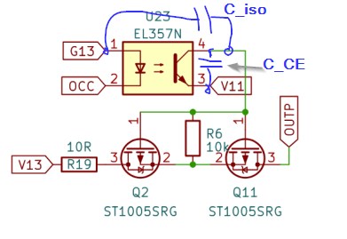

That's a good starting point. In theory, nothing should break even if we inject voltage between the separate battery modules, like 10V DC, 100V DC, 400V rectangle, etc, right? Because the we assume "perfect isolation". But thinking of this:
1. There is capacitance across the opto. If we apply a rectangle between the battery and the chassis ground (which basically a isolation monitoring device could do), we can open the FETs, if the voltage divider, formed by C_iso and C_GS provides sufficient voltage on the gate.
2. Also a weak resistive connection (1 MOhm) over C_iso, together with higher voltage, has the same effect.
3. Also the C_CE needs to be checked, because it also forms a voltage divider with C_GS, in case the OUTP is jumping.

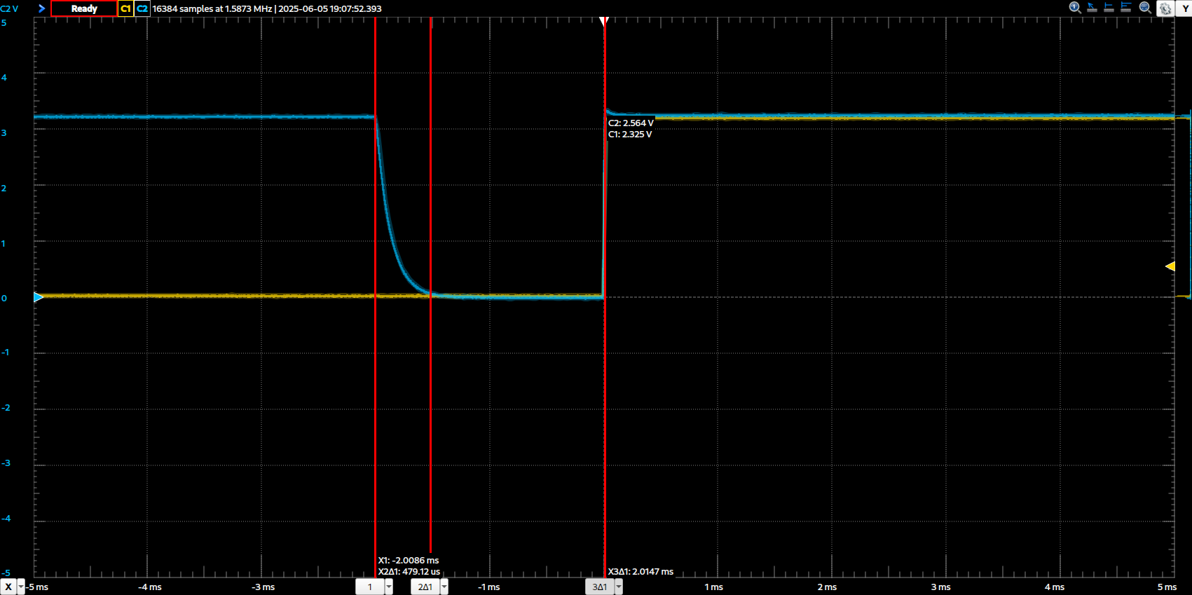

So adding 22n in parallel to R6 should have a positive effect, right? Now the combined C_GS >> C_iso and C_CE which should pretty much rule out false triggers?
The dead time now needs to be increased to around 2 ms until R6 has sufficiently discharged C_22. With the given time constants (one switch every 25 ms) that should be no problem

Hm, I'm not really convinced of my assumption anymore.
The C_iso is around 1pF (https://www.mouser.com/datasheet/2/143/ ... M5gYtOZNbV) and the C_gs specified as "max 600pF" (http://www.stansontech.com/download/Tre ... SRG_V1.pdf), so if we assume 300pF we would have a divider 1/300. So for reaching the treshold voltage (above 1V), we would need 300V. Of course, the layout may increase the C_iso, but I would not treat this as 100% proof to the the root cause.
Maybe multiple effects come together to reach the worst case, e.g. the above combined with some resistive leakage due to humidity. 1V threshold voltage together with 10k needs only 100µA. How much could the 10k be lowered?

Probably a lot. Cell drain reduction was priority but maybe I overshot the target there?
Maybe go with 2k2 || 10nF, and look what the statistics will say.
And reduce the cell drain by reducing the sampling frequency. Maybe introducing two modes with A: fast sampling, higher drain and B: slow sampling, low drain, so depending on the use case everybody can optimize just by setting a parameter.
Another direction of thinking: At which voltage the flying ADC is flying, before any of the mux switches are activated? By which path is this voltage determined?
- into direction of chassis ground, it is isolated via the 5V/5V DCDC and the data isolators. Fine.
- into direction of battery, the voltage can rise or fall until a PFET will reach the avalanche voltage (>100V according to http://www.stansontech.com/download/Tre ... SRG_V1.pdf). Not much current can flow, it is only like static electricity.
Using this situation as starting point, could this lead to an overload of U_GS or an unintended switching of other channels at the moment when the first MUX channel turns on?
Edit: One possible damage scenario is caused by the Miller capacity. It turns the FET on, even if the gate is grounded by resistor. We have 20pF Miller, and C_GS<600pF. Let's assume 400pF. This forms a voltage divider 20pF/400pF, which is factor 20. The threshold voltage of 1V is easily reached by applying a voltage jump on the drain of 20V. Having the ADC sitting around at +100V or -100V at the beginning, it is easy to get a jump of 100V U_DS, resulting in a gate voltage of 5V. Multiple FETS will start to draw current in this situation, until the 10k gets the gates discharged.
Also for this scenario, lowering the 10k and adding a parallel gate capacitance would help.
Edit 2: An other scenario is, that in such a situation the maximum allow U_GS of +/-20V is violated. Because the source can get a quickly rising voltage via the body diode of the other FET, and the gate is still sitting and hold by the C_CE of the optocoupler. If the C_CE is in the same order of magnitude as the C_GS (20pF) or even higher, the gate voltage is only following the source with delay.
Also for this case, an additional gate capacitance would help.

In favour of this theory FETs always failed at power-up. Once the system is up and running I have never seen or heard of failures.
At power-up all FETs are open, this should be ensured by the pull-down resistors. So the ADC floats *somewhere*
I have witnessed the Miller effect on a simple H-bridge. The low-side FETs V_GS can be clamped to 0 with a strong driver and about 1 Ohm gate resistor. Still when you turn on the upper FET you get a spurious turn-on of the lower FET as well. It is only very short and doesn't do much damage because of the strong pull-down. But with 10k this is a different story (despite the lower Miller cap of the smaller FET)

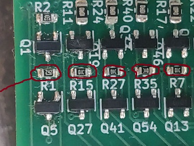

so my 36S MEB modules have been in use for <1 week, so far no issues. Balancing is slow, I am helping the weakest cells with PSU CV set below before it starts tripping the hell out of ADC measurements on the adjacent cells and OCP <300mA.
The gate resistor has 8200pF 100V cap across it, extra 3R on cell taps through the polyfuse. Same i2cdelay=5 as other 2.3HW. Pretty thick coat of conformal coat. I have it completely shutting off with ignition at the moment. Cell taps go in pretty close proximity to the phase cables, which see <300A phase current.

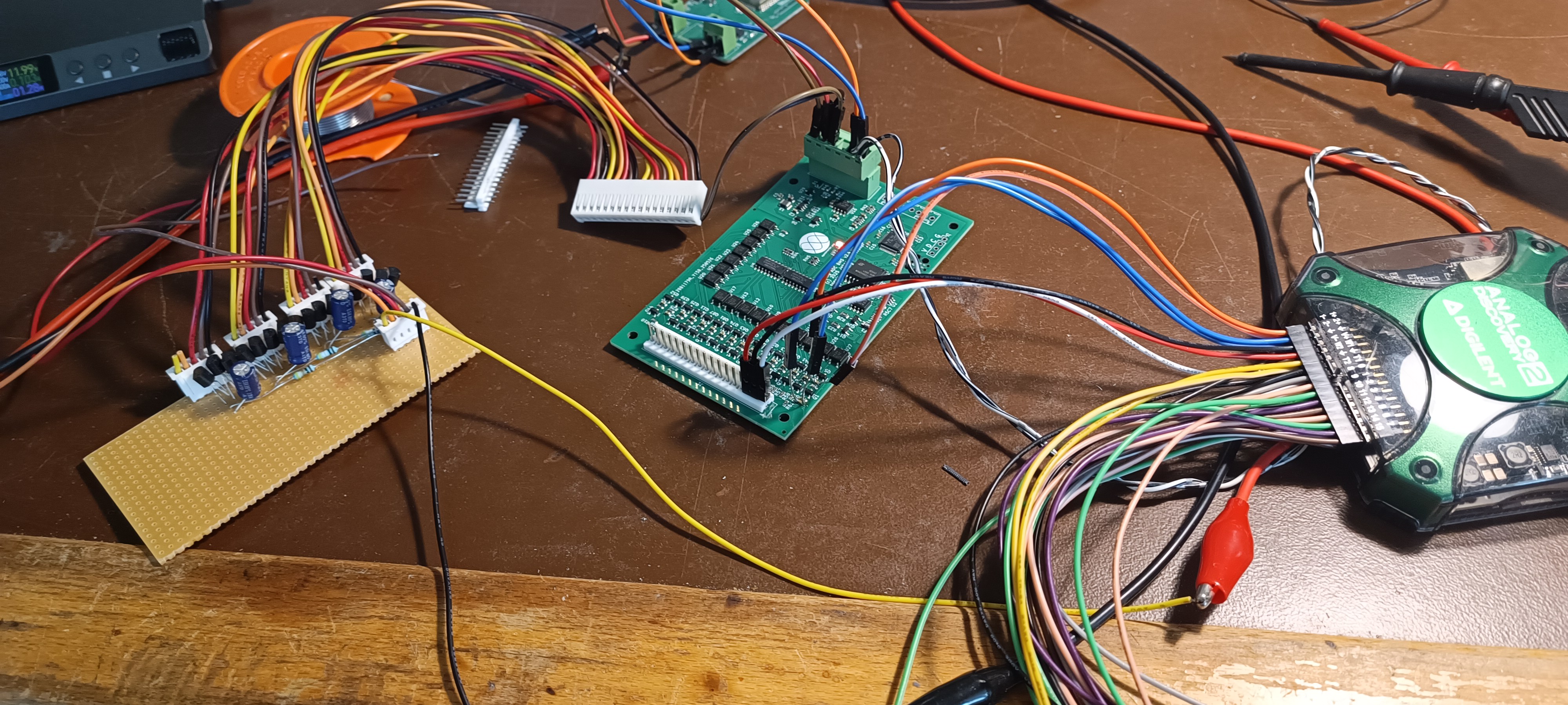

This is the switching waveform with 5k1 || 22nF
The 2ms dead time is plenty even for the FETs that have 10k || 22nF.
Had to remove R10 (that is supposed to put some extra load across cell 16 to avoid passive disbalancing). I connected it behind the 10R inline where it caused too much voltage drop across these.
The new isolator (with DC/DC) seems to have a slow power up ramp and the balancer switch misses its I2C command to switch all pins to output. So they remain at input with pull-up and no control over the balancing circuit. Consequently the self test fails with BALANCER_FAIL. Fixed it for now by issuing the "pins to output" command before every balancer command. Quite redundant but works for now.
Apart from that everything works as expected.
EDIT: I also found that I had forgotten to set all 8 mux control pins to 0 before switching them to output. They have a reset value of 0 but who knows?

I swapped one module into my 64S pack and it works. Of course that doesn't say much as the old one worked as well.
To patch modules to this state first install this software: https://github.com/jsphuebner/FlyingAdc ... 5473329191
Never run a v2.4 BMS or one patched to that state with an older version than 0.26.R!
Then put a 10 or 22nF capacitor in parallel to all gate pull-down/up resistors (R1, R2, R15, R27, R35, R7, R14, R26, R34, R42, R49, R55, R59, R6, R13, R25, R33)
Then start with 2 modules connected together. Power cycle multiple times to make sure it all goes well. Then add a 3rd, 4th and so on.
@maiks: if a module gets destroyed I'll replace it with a new one.

Thank you, @johu. I just want to confirm—should I remove the components marked in red (as shown in the attached image) and replace them with 10 nF or 22 nF 0603 SMD ceramic capacitors?johu wrote: ↑Thu Jun 05, 2025 6:02 pm I swapped one module into my 64S pack and it works. Of course that doesn't say much as the old one worked as well.
- image.jpg (62.08 KiB) Viewed 5678 times
- uhi22
- Posts: 1244
- Has thanked: 245 times
- Been thanked: 684 times
No, the capacitors need to be added "on top" (literally).
