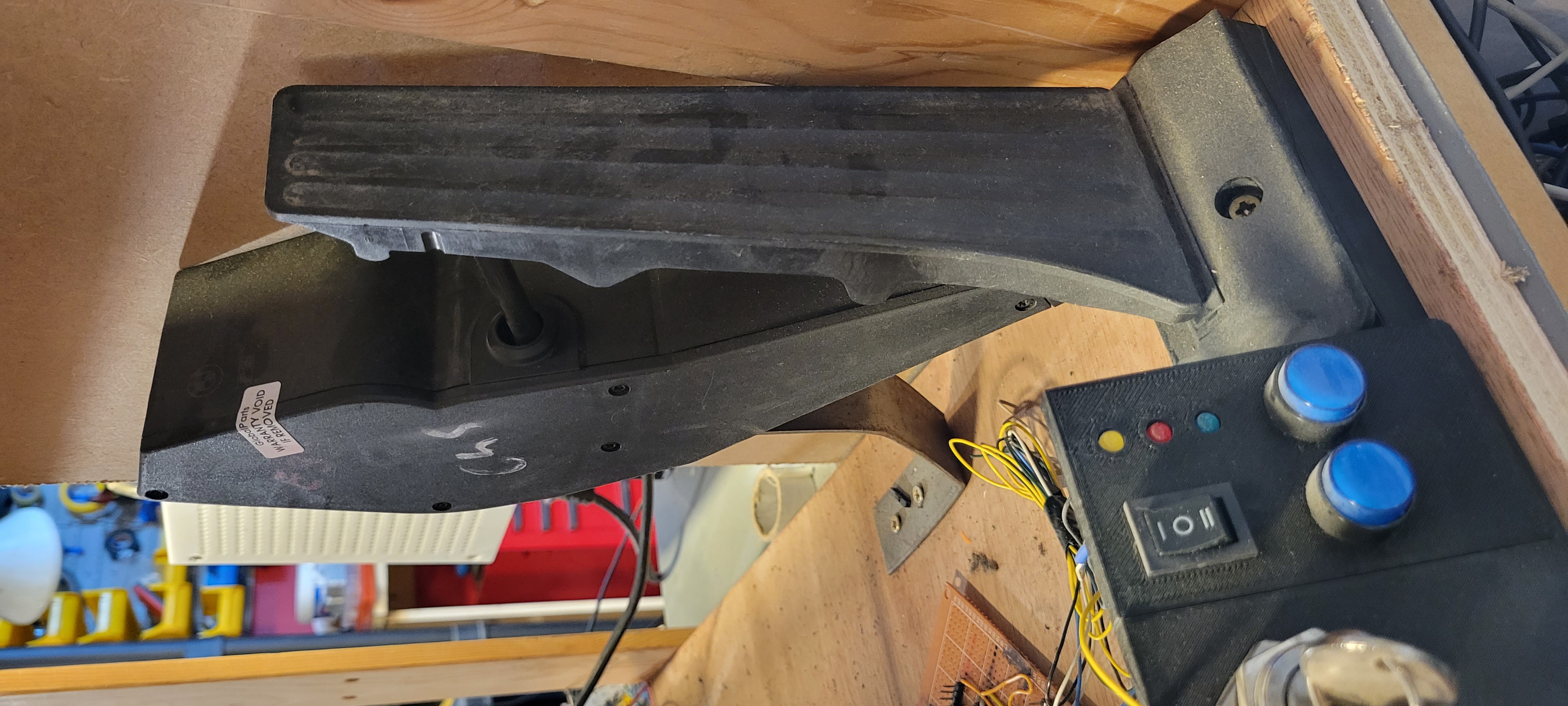

Posted: Mon Oct 25, 2021 2:20 pm
by DaveH
Can anyone who knows about throttle pedals steer me in the right direction to locate a suitable pedal for my VW bus? I need a floor mounted type like a BMW one but I'm not sure what is going to need the least amount of modding/fabrication or will give me a suitable operating position. I don't have any photos right now but the cab floor is flat with a slight bend upwards at the front. At full travel the pedal is almost horizontal. Should I be looking for something from a truck rather than a car?
Posted: Mon Oct 25, 2021 2:52 pm
by arber333
DaveH wrote: Mon Oct 25, 2021 2:20 pm Can anyone who knows about throttle pedals steer me in the right direction to locate a suitable pedal for my VW bus? I need a floor mounted type like a BMW one but I'm not sure what is going to need the least amount of modding/fabrication or will give me a suitable operating position. I don't have any photos right now but the cab floor is flat with a slight bend upwards at the front. At full travel the pedal is almost horizontal. Should I be looking for something from a truck rather than a car?
I recommend you start at the beginning of this very thread with toyota pedals.
viewtopic.php?p=3772#p3772
I like the Auris one because you can cut and weld the pedal to your liking.
You can also make your own ramp for throttle mounting.
https://leafdriveblog.wordpress.com/tag/throttle/
Posted: Mon Oct 25, 2021 3:16 pm
by DaveH
Thanks arber but I can't use that kind of pedal. I don't have a firewall or wheel arch at the front of the cab, just a horizontal floor.
Posted: Mon Oct 25, 2021 3:51 pm
by arber333
DaveH wrote: Mon Oct 25, 2021 3:16 pm Thanks arber but I can't use that kind of pedal. I don't have a firewall or wheel arch at the front of the cab, just a horizontal floor.
Like i said, you can make your own pedal adapter/slope out of wood or weld it from sheet metal.
Posted: Thu Oct 28, 2021 6:49 am
by bobby_come_lately
I'm using the 1-series pedal Dave. Very simple to use with two 5v outputs. I 3D-printed an adaptor plate that allows it to sit in the original mounting position for the old analogue pedal in my Z3. I also have a design for an adaptor for flat floor mounting that I use in my test setup - see pic. Happy to share that design or send you one if you don't have a 3D printer?
Posted: Thu Oct 28, 2021 8:52 am
by DaveH
bobby_come_lately wrote: Thu Oct 28, 2021 6:49 am I'm using the 1-series pedal Dave. Very simple to use with two 5v outputs. I 3D-printed an adaptor plate that allows it to sit in the original mounting position for the old analogue pedal in my Z3. I also have a design for an adaptor for flat floor mounting that I use in my test setup - see pic. Happy to share that design or send you one if you don't have a 3D printer?
Thanks for the kind offer. I've ordered an E46 pedal now, with the mounting bracket (they seem very common). I might not need any kind of adapter if I use the bracket, but we'll see when I get the vehicle back and start looking at it.

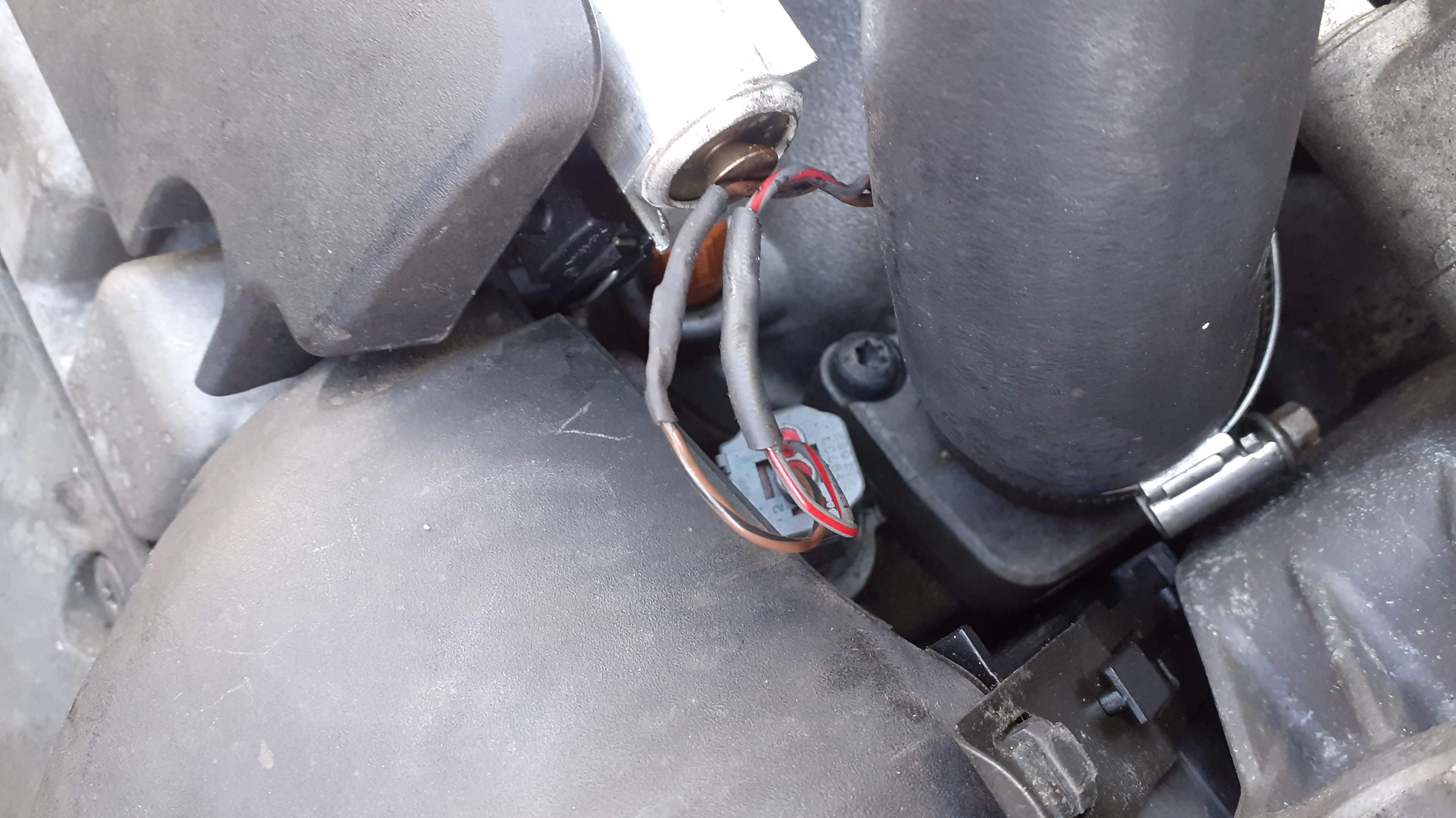

Posted: Sat Jan 08, 2022 6:37 pm
by crasbe
I can't recommend using those. This is what they looked like on my friend's Volvo V70 after just two years. It was used to connect a new pig tail for the temperature sensor.
It is not in a very hot place and still the tubing became brittle. The flux inside started to corrode the wires and the soldering connection was very poor, but that was not visible from the outside.
I had to cut the wire, clean the residue of the shrink tubing, solder and shrink tube it again. In the end it cost more time than it saved.
Maybe they're better when you can get them in decent quality, but I don't think you get that from Aliexpress.
Posted: Sun Jan 09, 2022 1:09 pm
by arber333
crasbe wrote: Sat Jan 08, 2022 6:37 pm I can't recommend using those. This is what they looked like on my friend's Volvo V70 after just two years. It was used to connect a new pig tail for the temperature sensor.
Hm... that would be bad. I can only say i use them for 2 years now and i allways put them into a heatshrink sleeve or those white electrical tubes.
Havent had a problem up to date. Not saying there wouldnt be...
