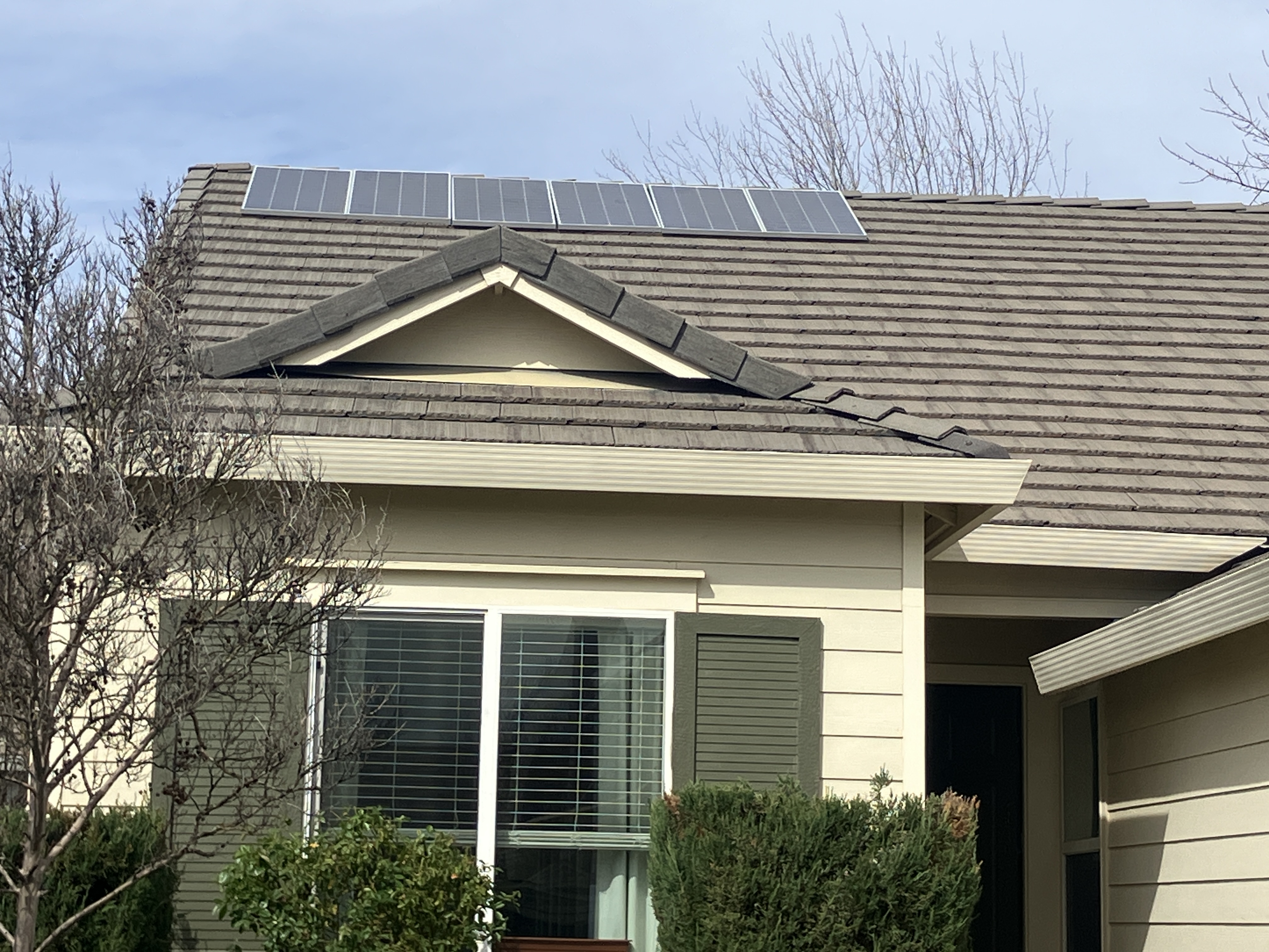

so it's been a while since I posted an update, here I am in my new house, yes I moved again, to what appears to be the world's least solar panel friendly domicile, so here I was doing the best I could
here they are facing South but this side of the house gets so much shade that this really sucked !

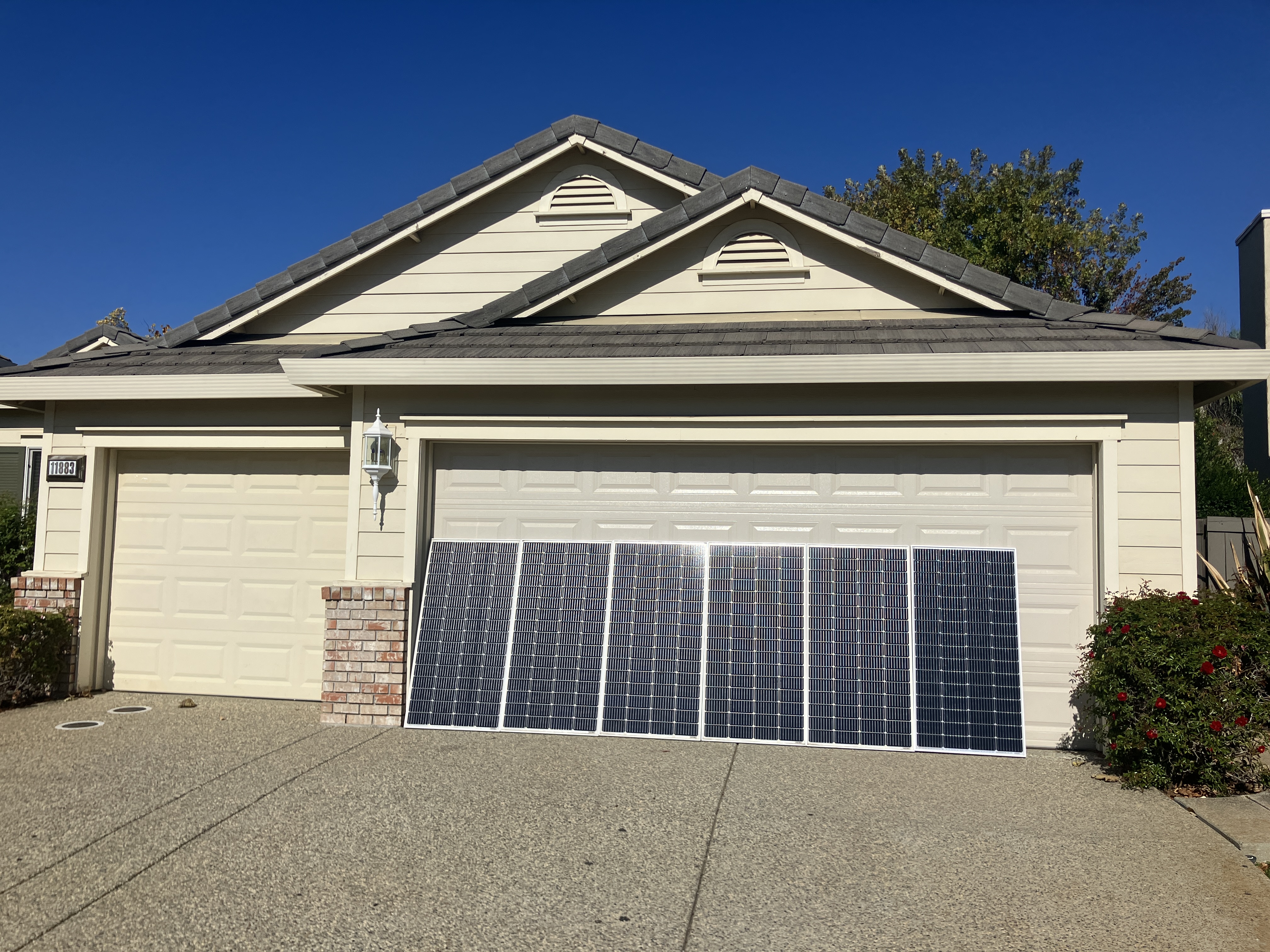

anyway here I am not bending a knee to the HOA, those of you blessed enuff to not be familiar with the Home Owners Association may not get what I am trying to say here, lucky you

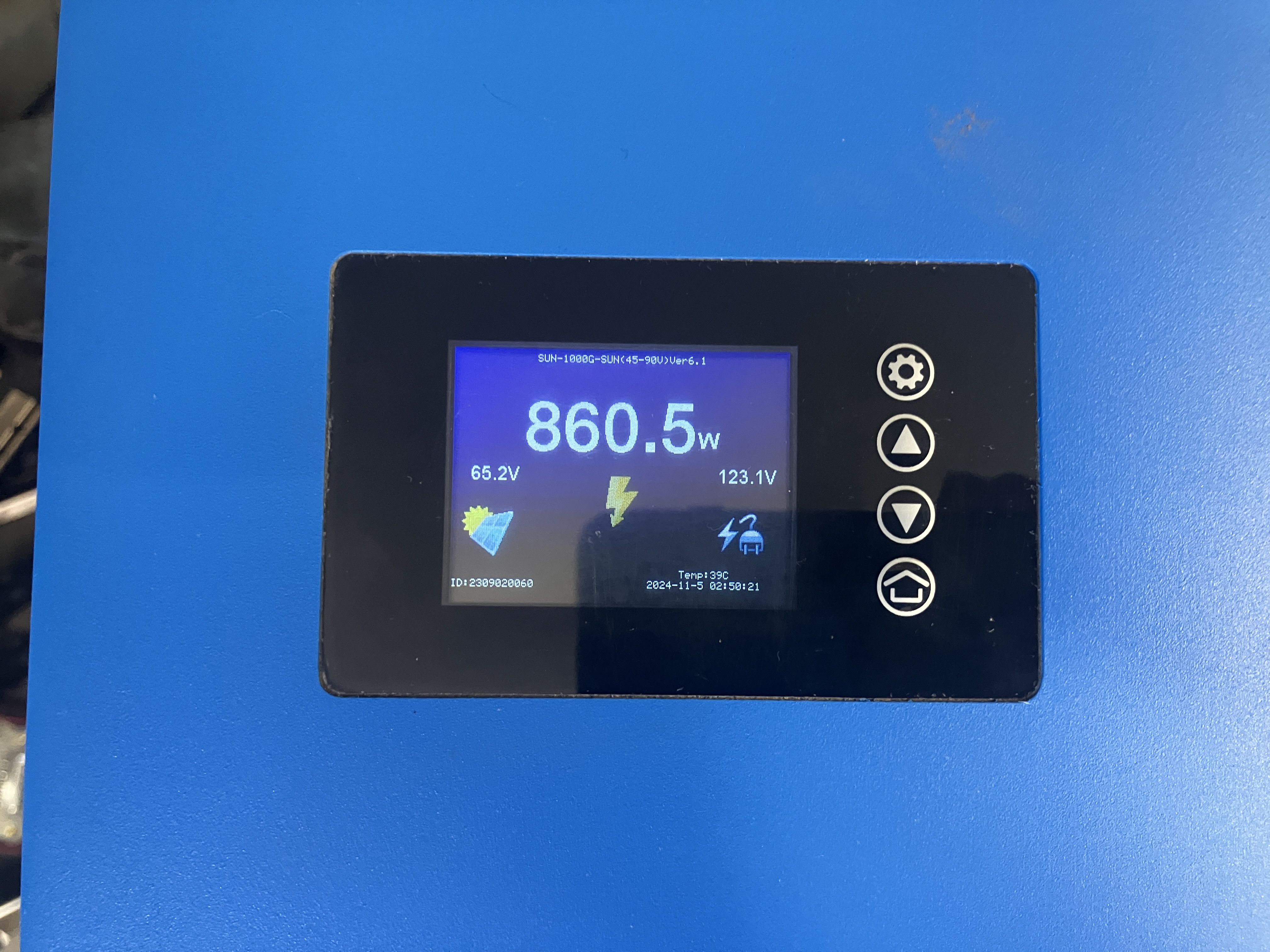

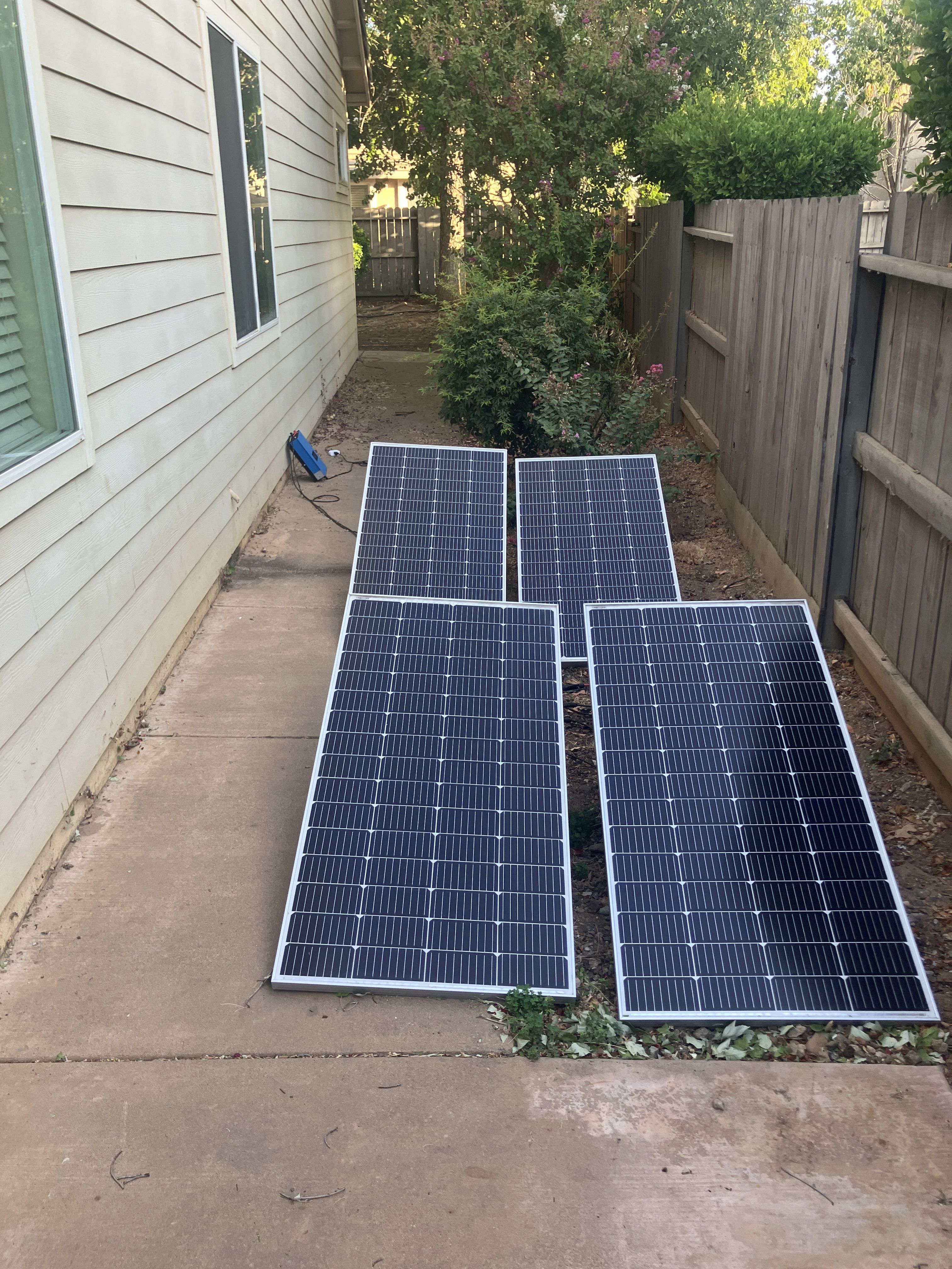

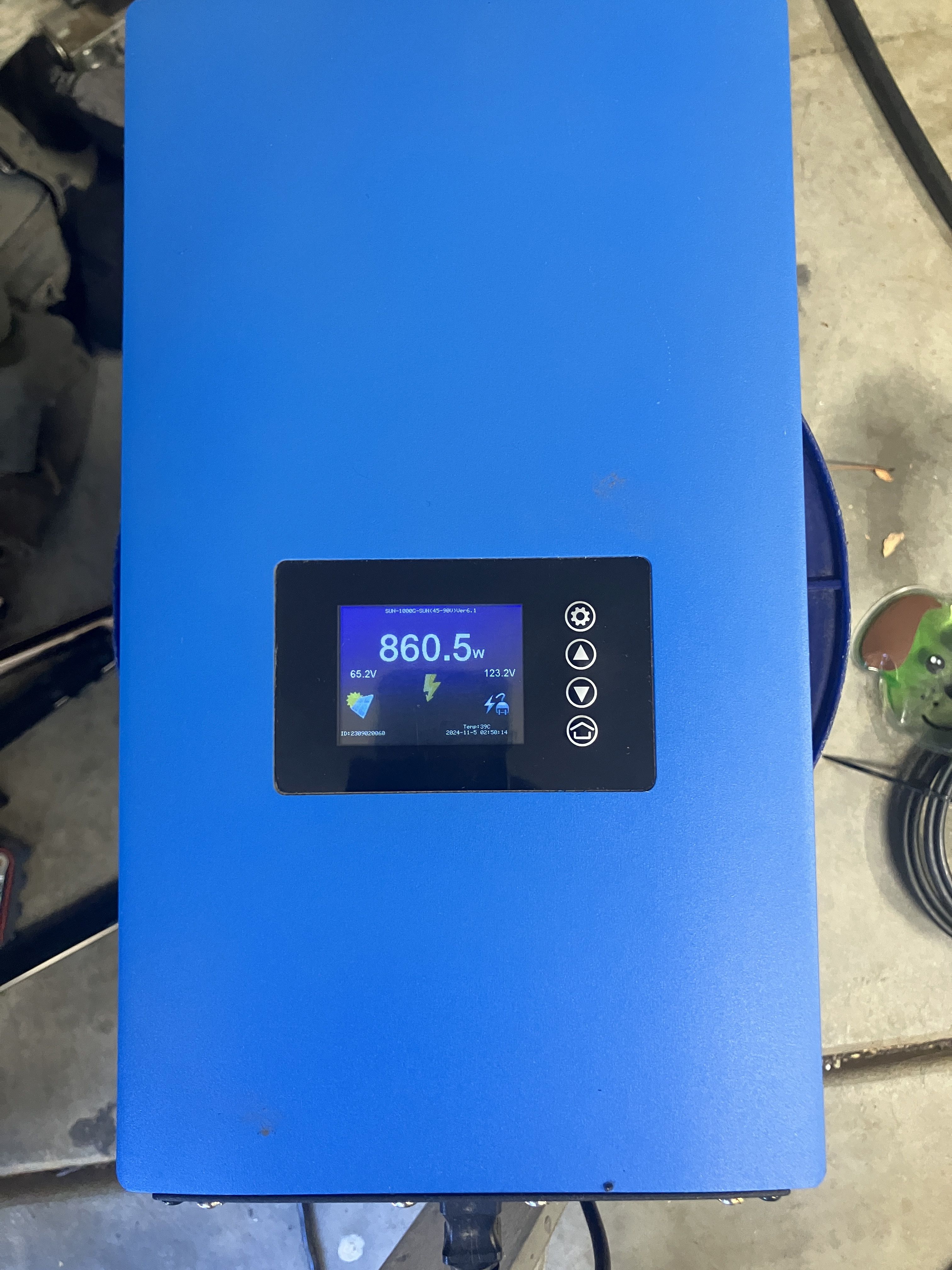

as you can see I have now graduated to these blue grid tie inverters, this one is a 45-90 dc voltage input
here we are in the Fall (November) with the panels facing South
so here we have six 200 watt solar panels for a total of 1,200 watts pulling in 860 watts of solarness, so approximately (860/1200=71.6) so 70% efficiency? they are connected in pairs so panel 1 + panel 2, panel 3 + panel 4, and panel 5 + panel 6 so the input voltage is just above 70 volts, well within the 45-90 range of that inverter
so this setup counting everything including cables is less than $1,500 bucks

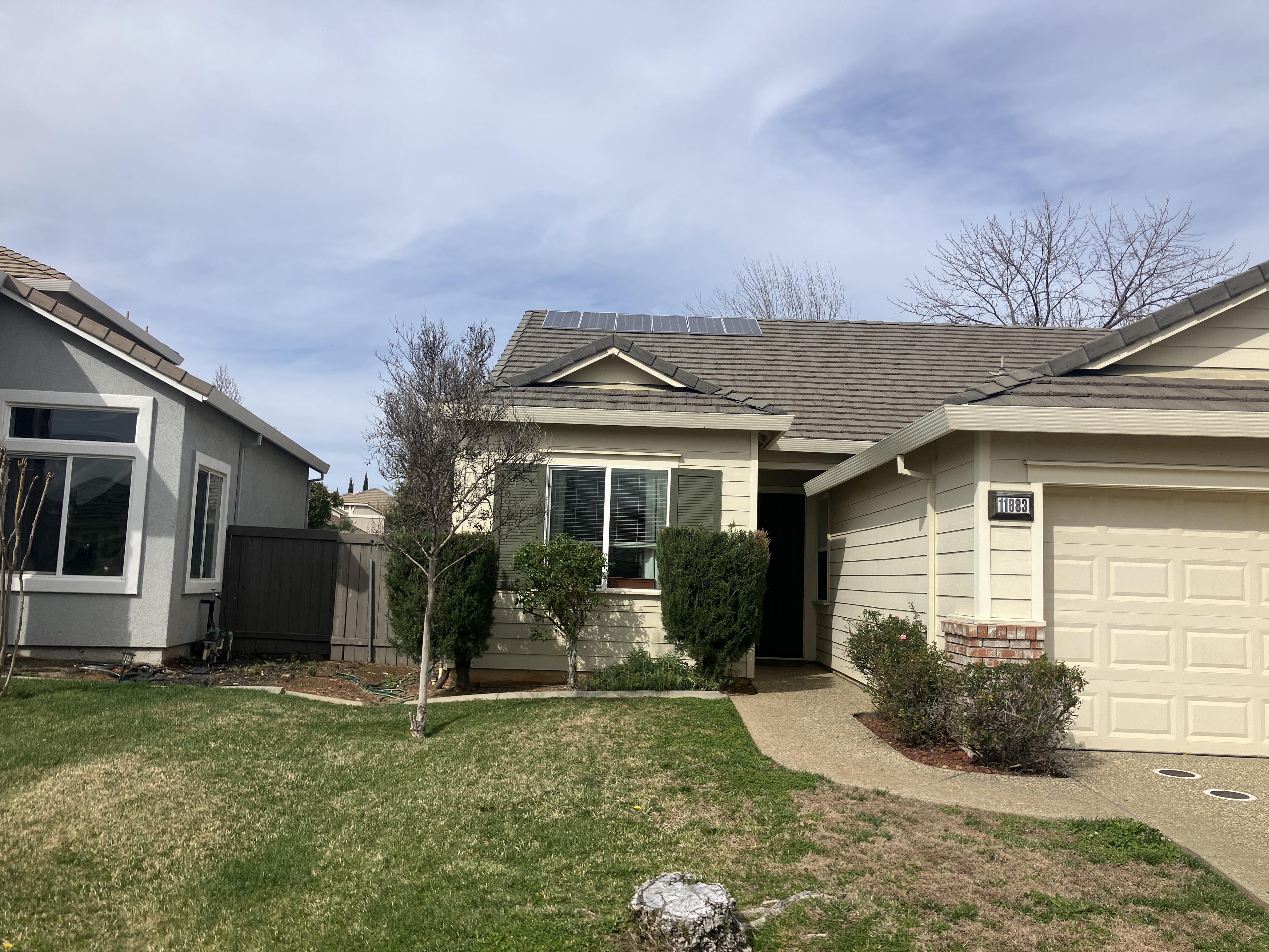

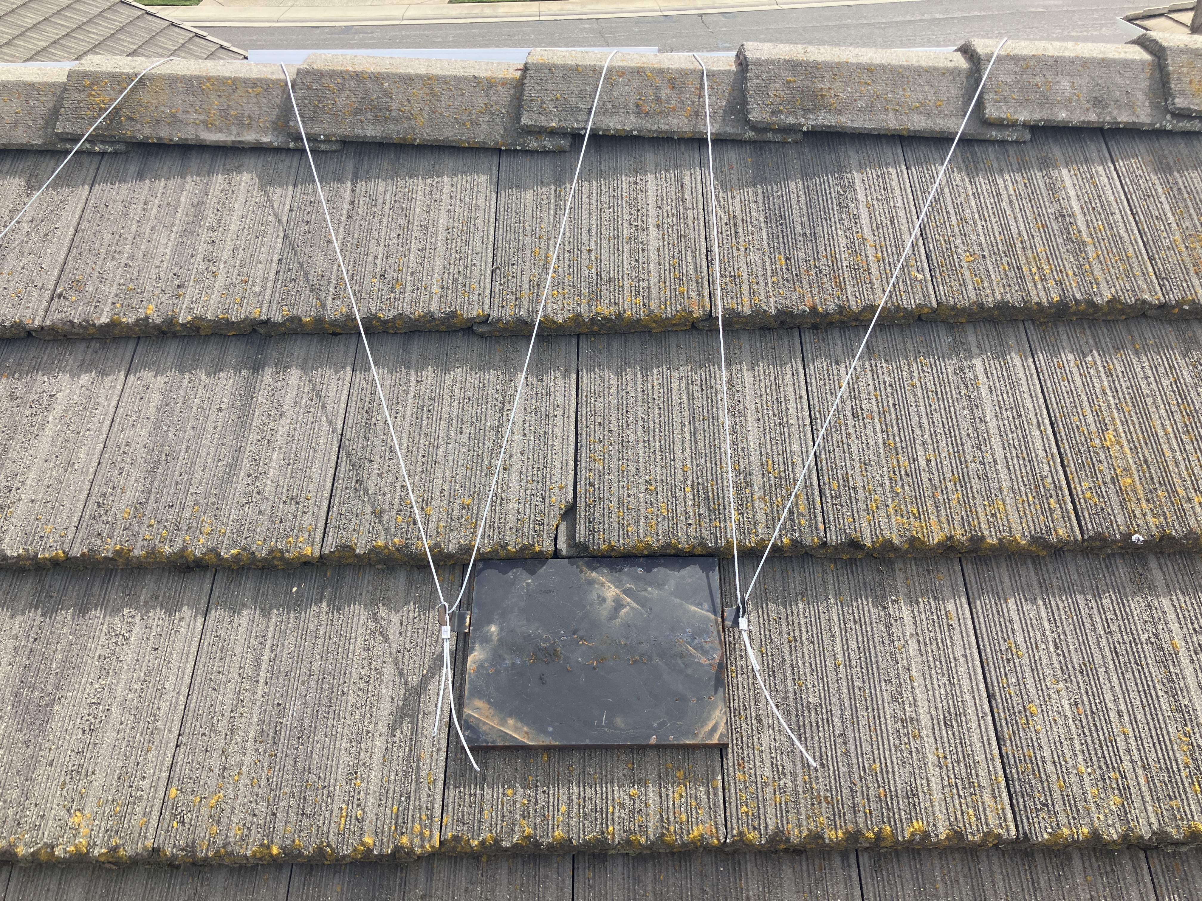

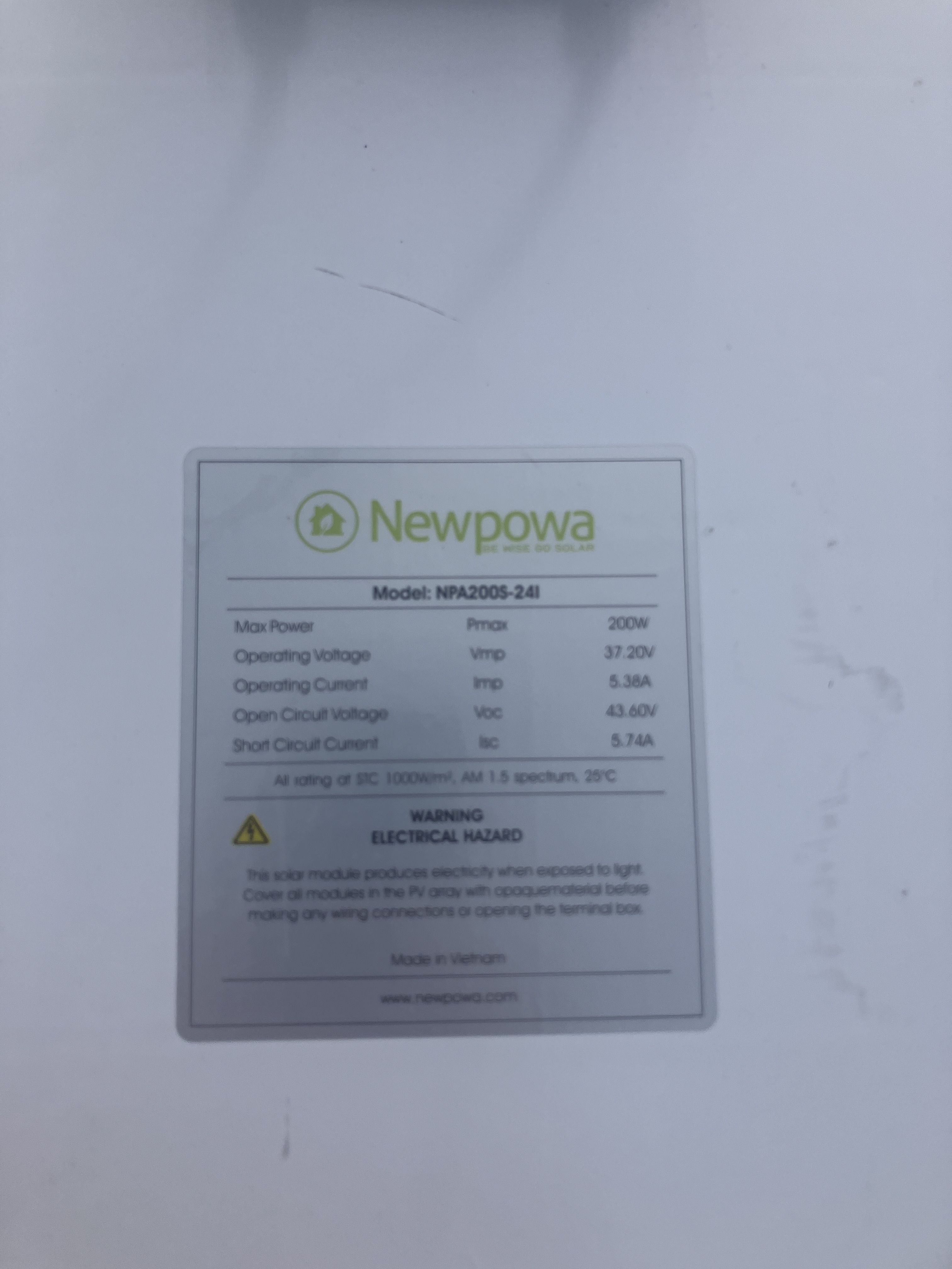

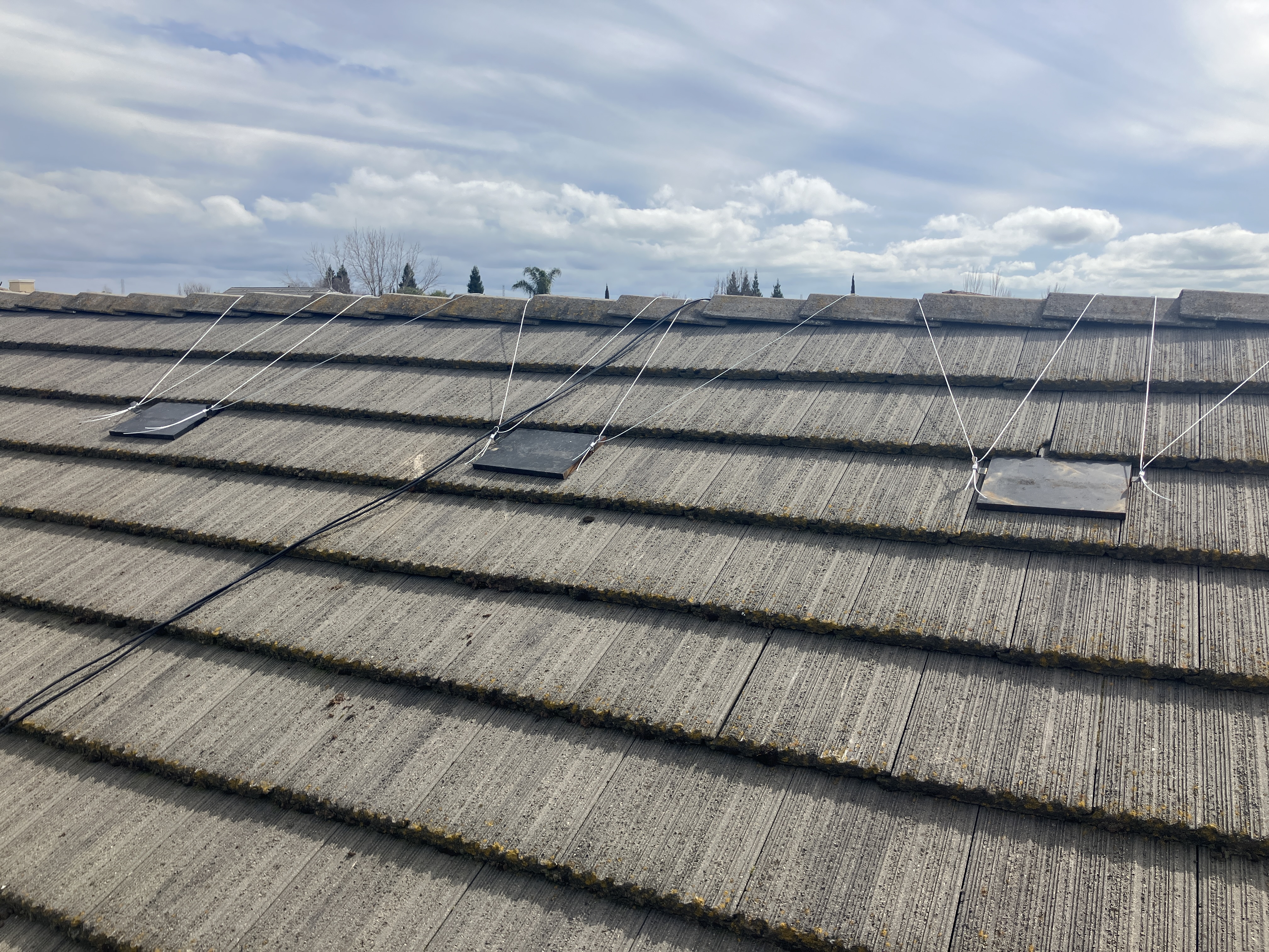

well after 8 months the roof was finally wet enuff and slippery enuff [think February] to climb on up there and temporarily affix the six 200 watt Newpowa solar panels facing South like the sun gods intended
I am using super duper heavy plates to keep the panels from sliding down so that I don't drill into the roof as this is a rental property and I do not own it

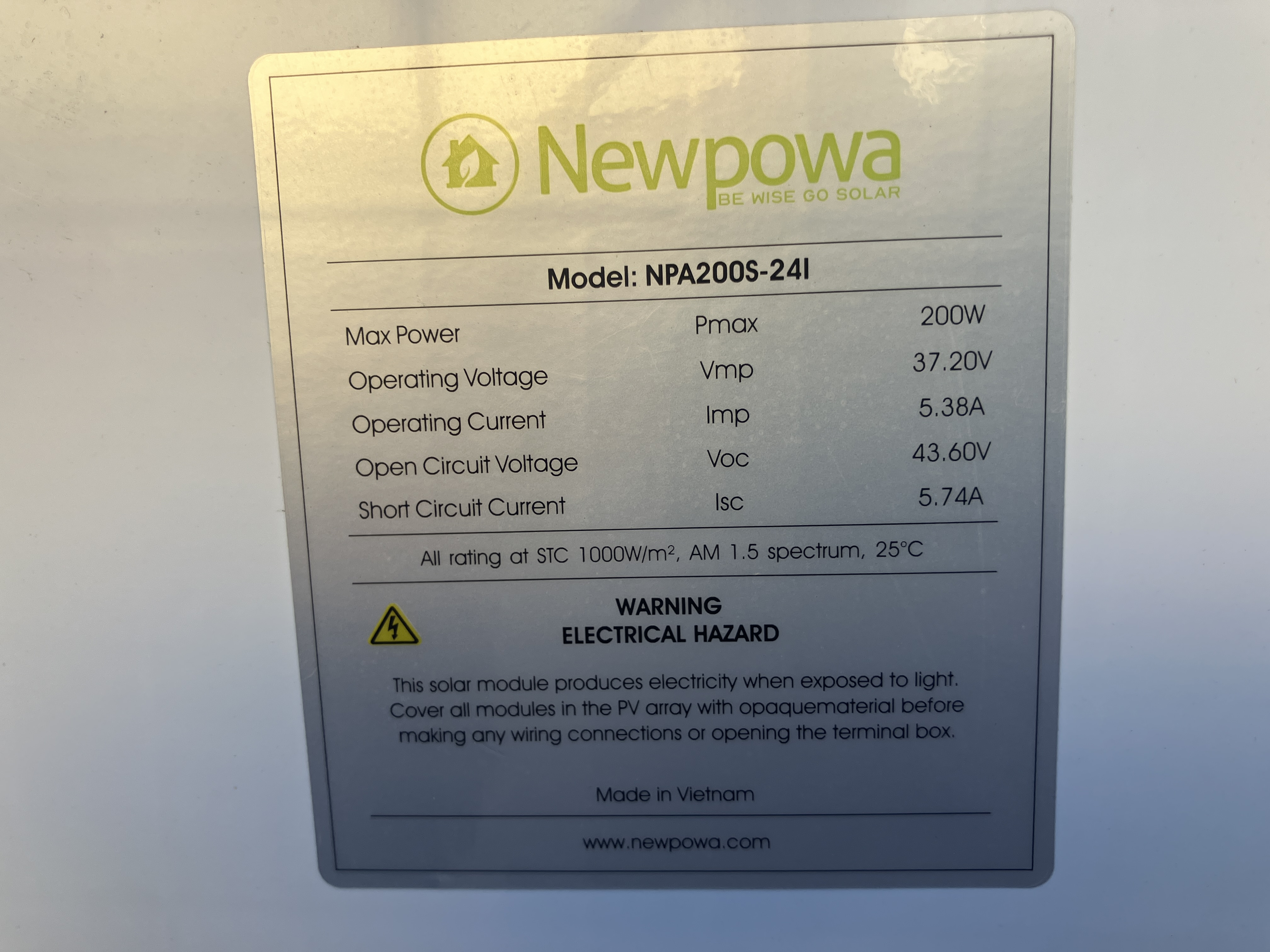

I purchased these panels from Newpowa via eBay for $200 bones each [so $1.00 per watt] I refuse to pay more than that made up heuristic

Gregski wrote: Tue Feb 25, 2025 1:36 am I am using super duper heavy plates to keep the panels from sliding down so that I don't drill into the roof as this is a rental property and I do not own it
Nice job!

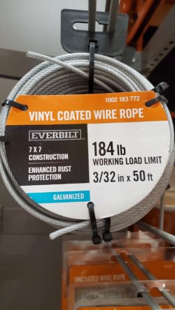

Please let me know what kind of rope you are using. I was thinking of simply using 6mm2 cables with lugs crimped on both ends and fixed by bolts to the solar panels.
I would guess direct sunlight would make short work of the rope...

arber333 wrote: Tue Feb 25, 2025 12:31 pm Nice job!
EVERBILT 3/32 in x 50 ft 184 lb working load limit galvanized uncoated wire rope (with enhanced rust protection) $15 bucks at Home Depot

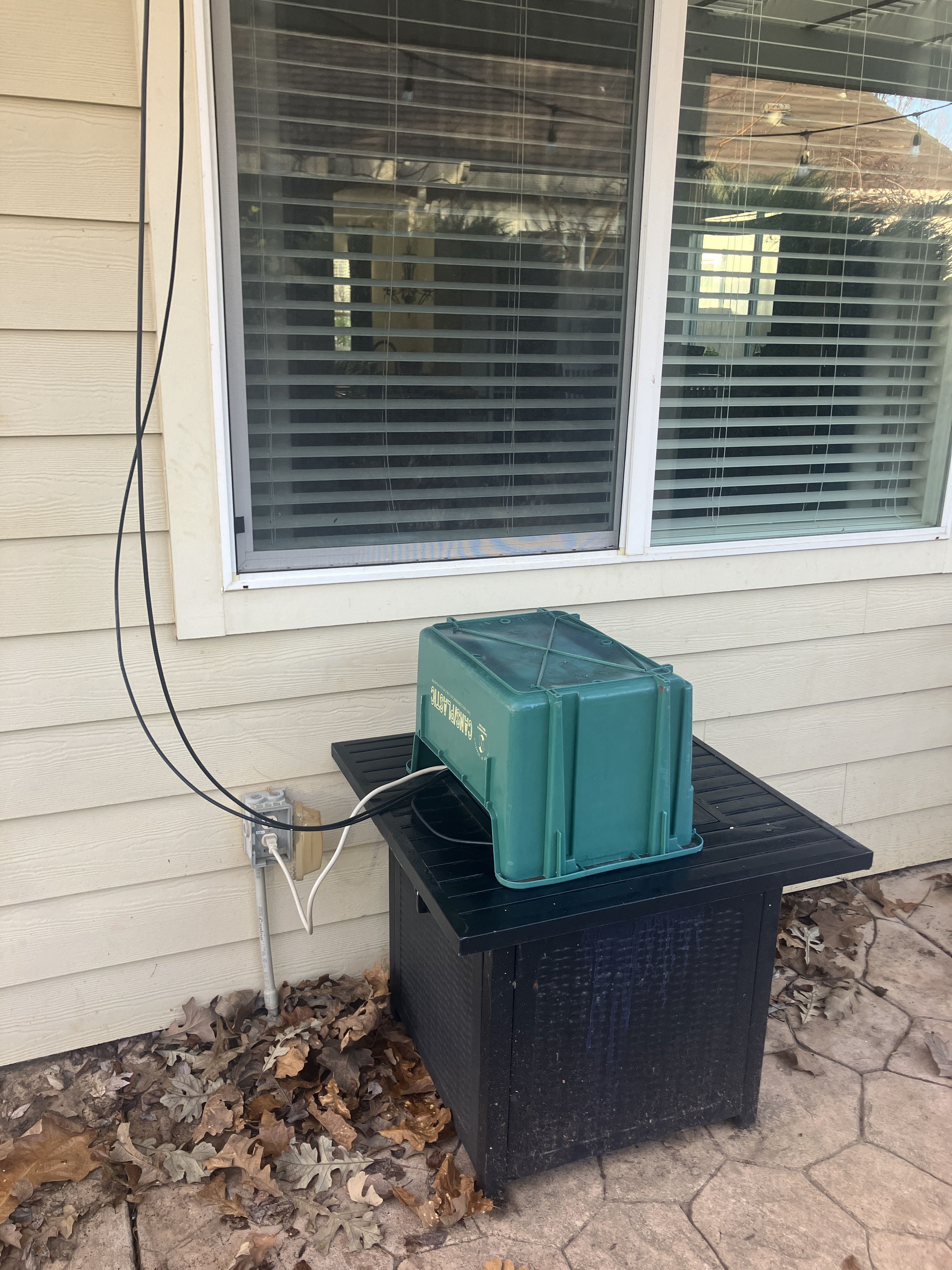

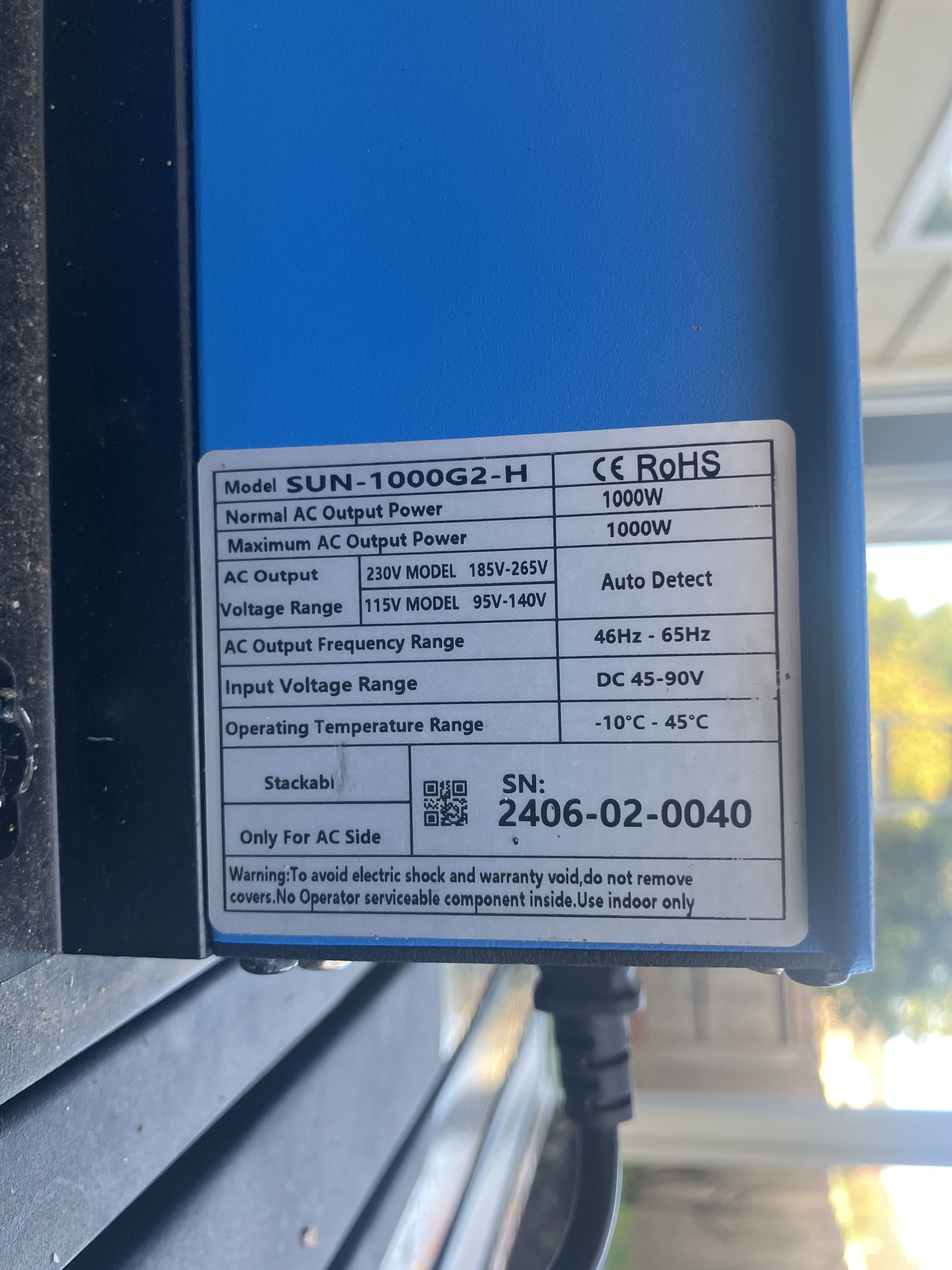

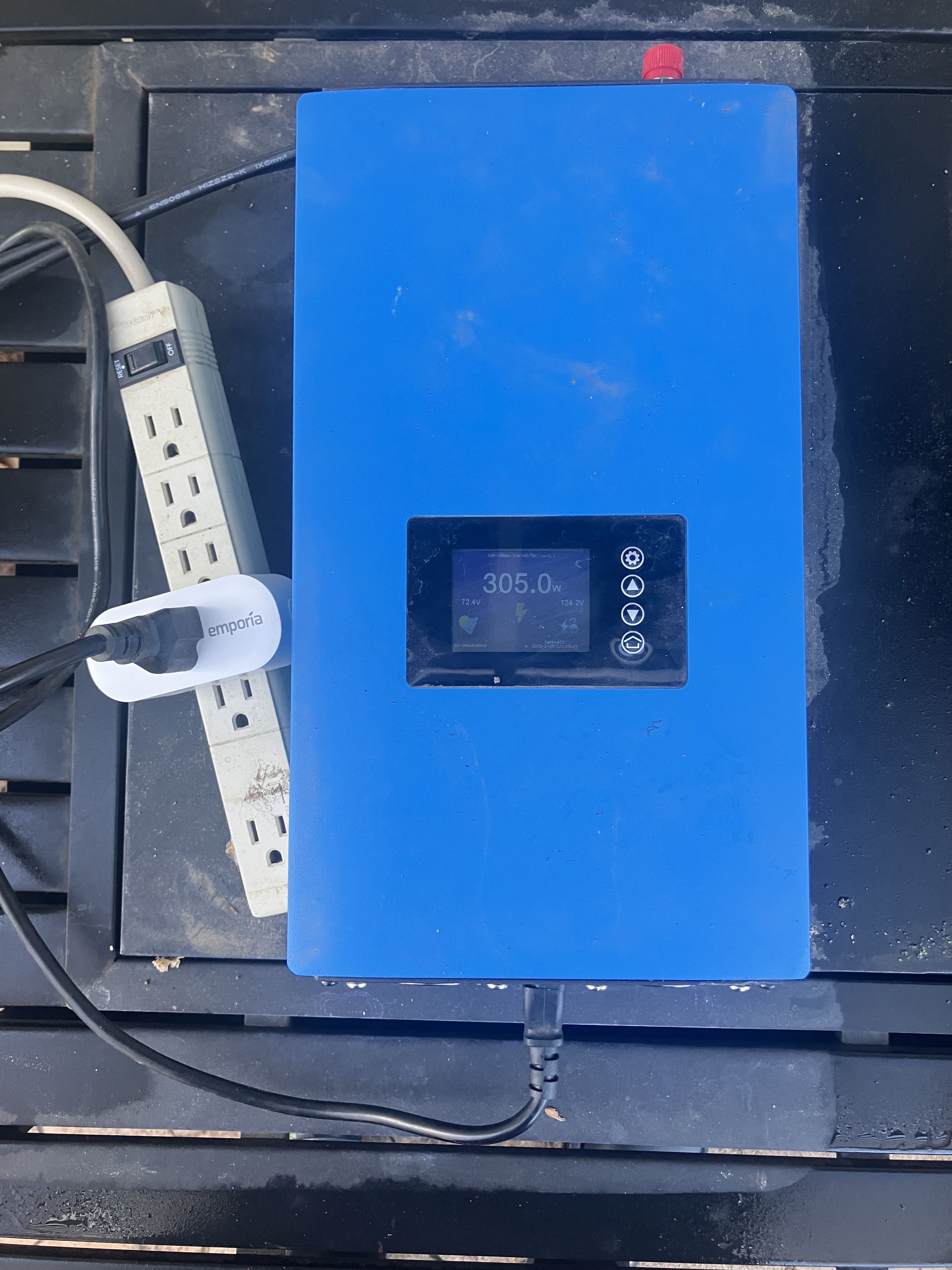

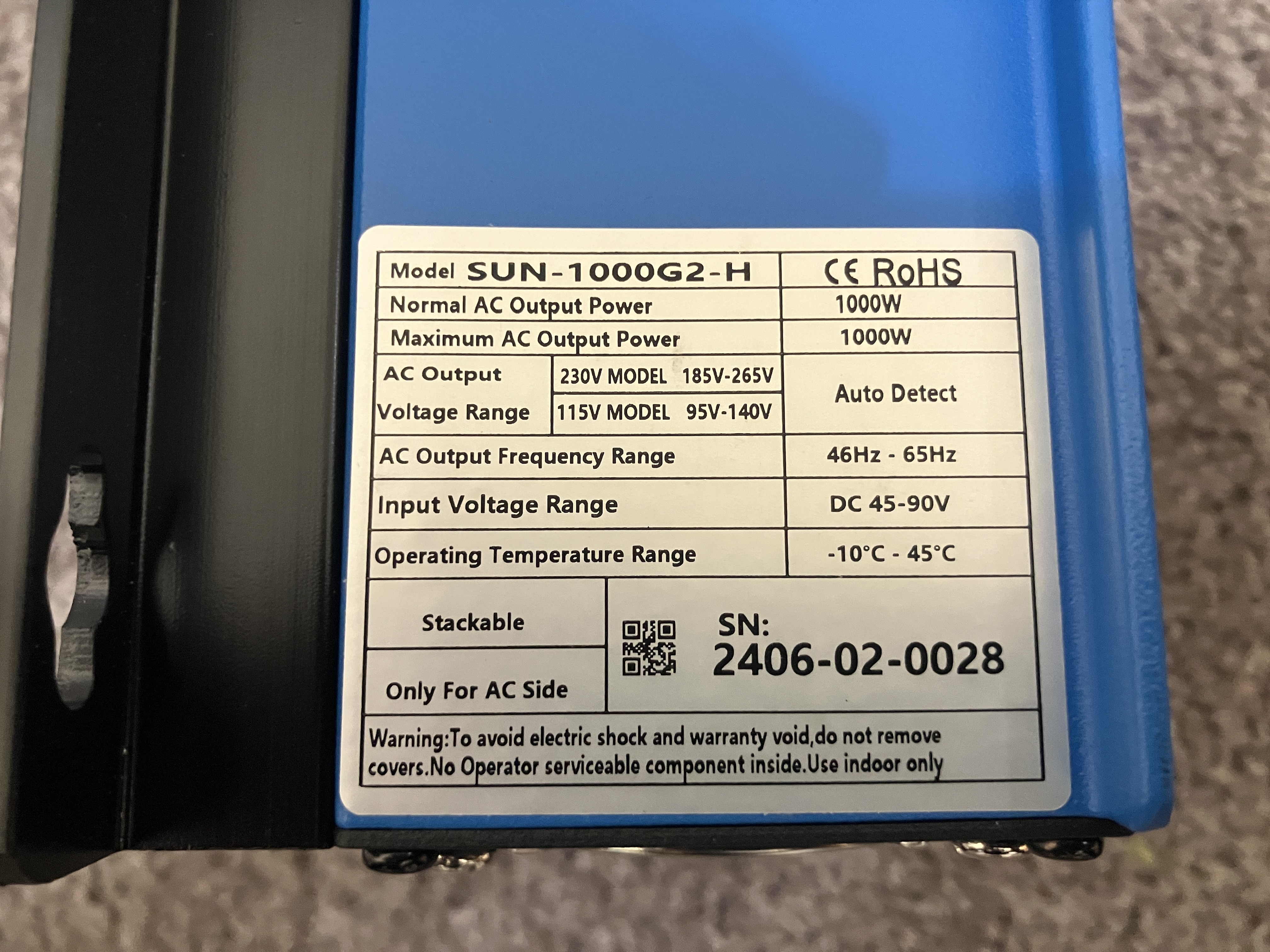

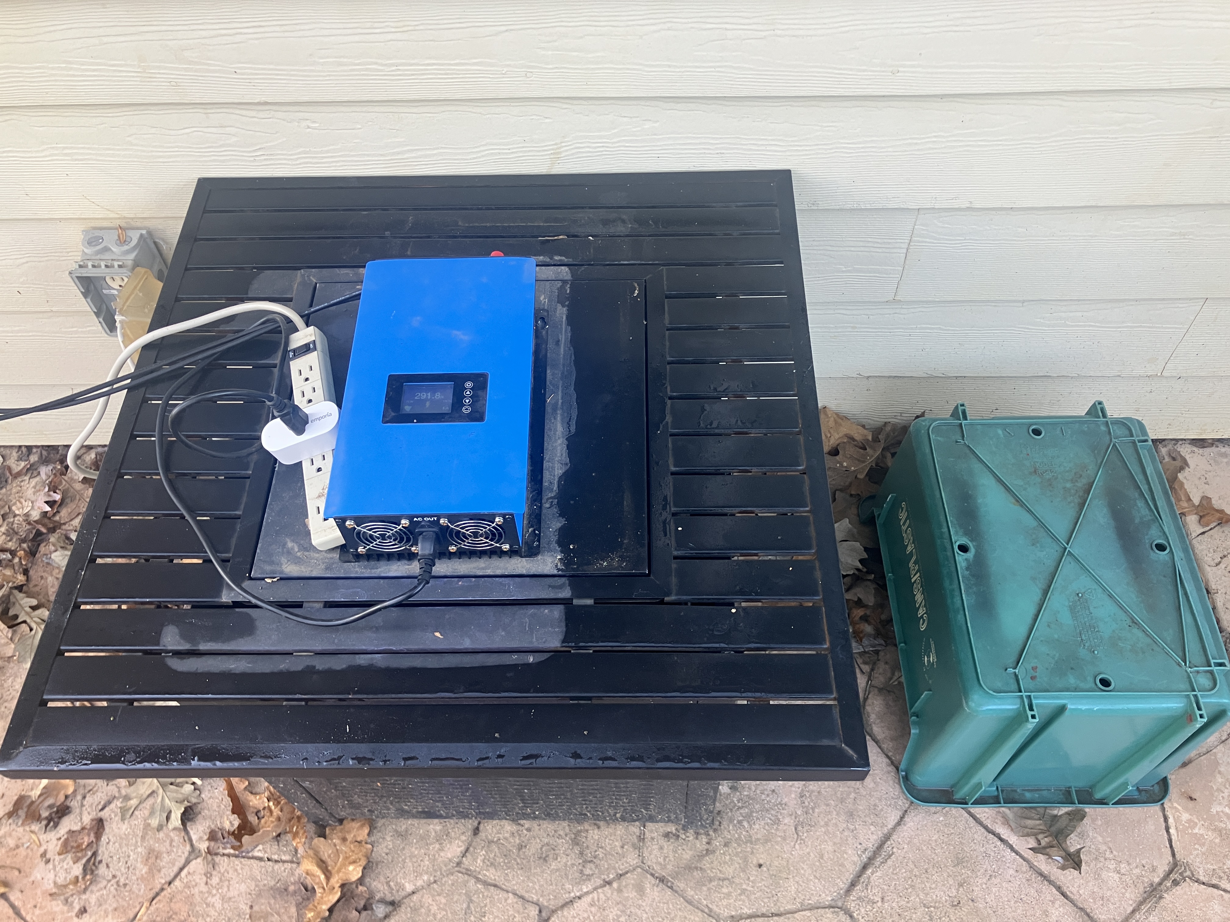

and here is the SUN-1000G2-H 45-90 volts DC grid tie inverter I am using now, $200 bones on eBay
the goal for this year is to finally add batteries to this solution to have some DC juice after the sun goes down
don't tell me this aint no Green Solution
it was 8:00 am on a very overcast and misty morning

Gregski wrote: Tue Feb 25, 2025 4:05 pmdon't tell me this aint no Green Solution
Did the math boys, it all checks out. The bin is in fact green.

LoL, and in the second pic it's even [ahem] grounded !

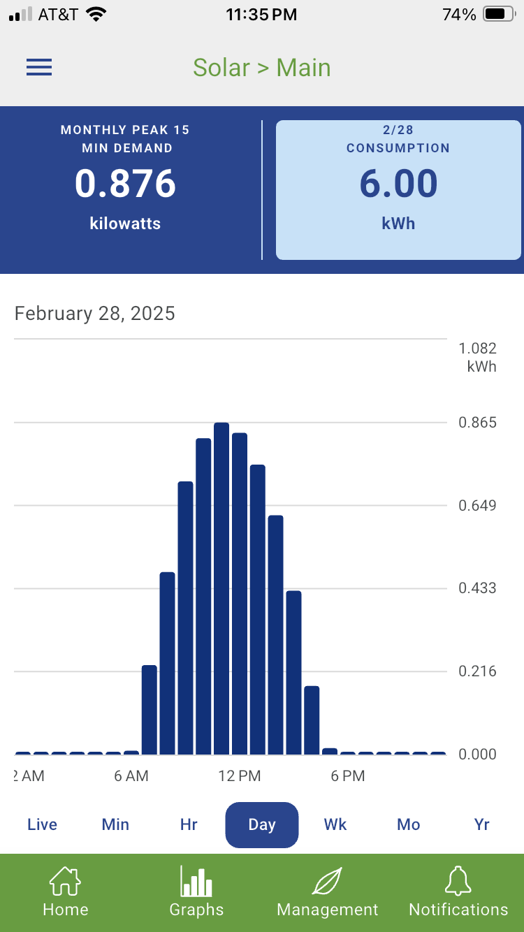

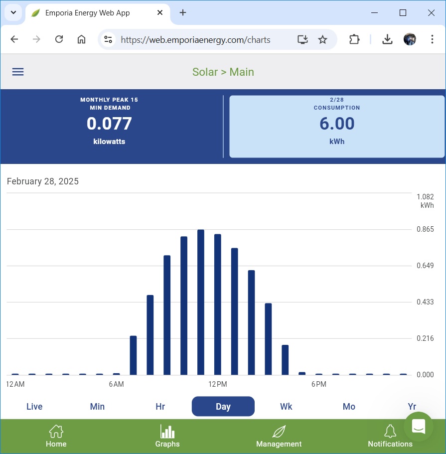

so here is how this little 1,200 watt South facing system is doing in February 2025
not making any excuses but last night I noticed that my solar production starts at 7:00 am and stops at 5:00 pm when the sun disappears behind the 2 story house, west of my single story, oh well, I think the sun will be higher in the sky in the summer and may produce until 7:00 pm
so since I put the panels on the roof a couple days ago I generate 6 kWh of energy from the sun a day and with a peak of 876 watts using 1,200 watts of panels that is 73% efficiency (I think that number can get up to 75% in the summer time)

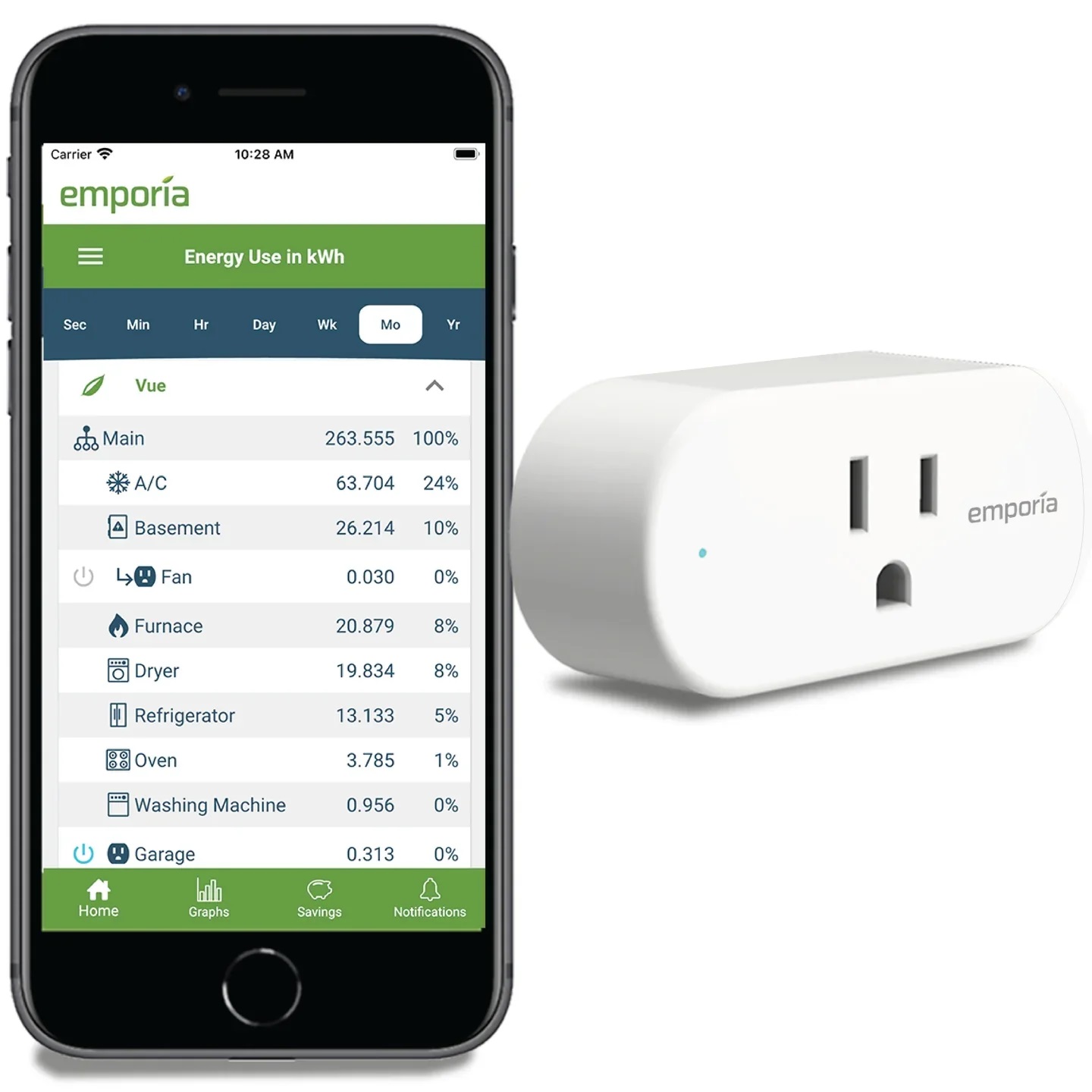

still just using this single Emporia $12 dollar smart plug to monitor my system, I dig it because being a dinosaur you can still use a computer to monitor it, other plugs only offer apps for your phone
that is one sexy bell curve if I do say so myself

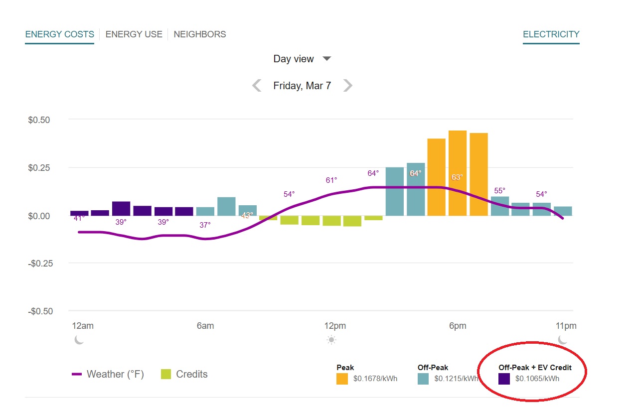

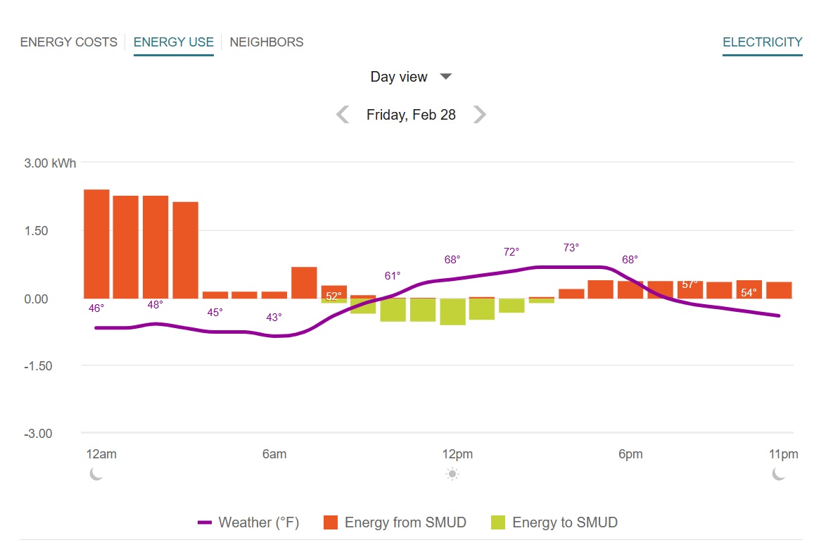

and here is what that day looked like from the perspective of my Electric Company, the green shows me selling energy back to them
ideally that's when I would like to charge my electric 2022 Hyndai Ioniq 5 (the world's sexiest electric crossover) because when they buy electricity from me they don't pay me the same as when I buy it from them, you get the idea

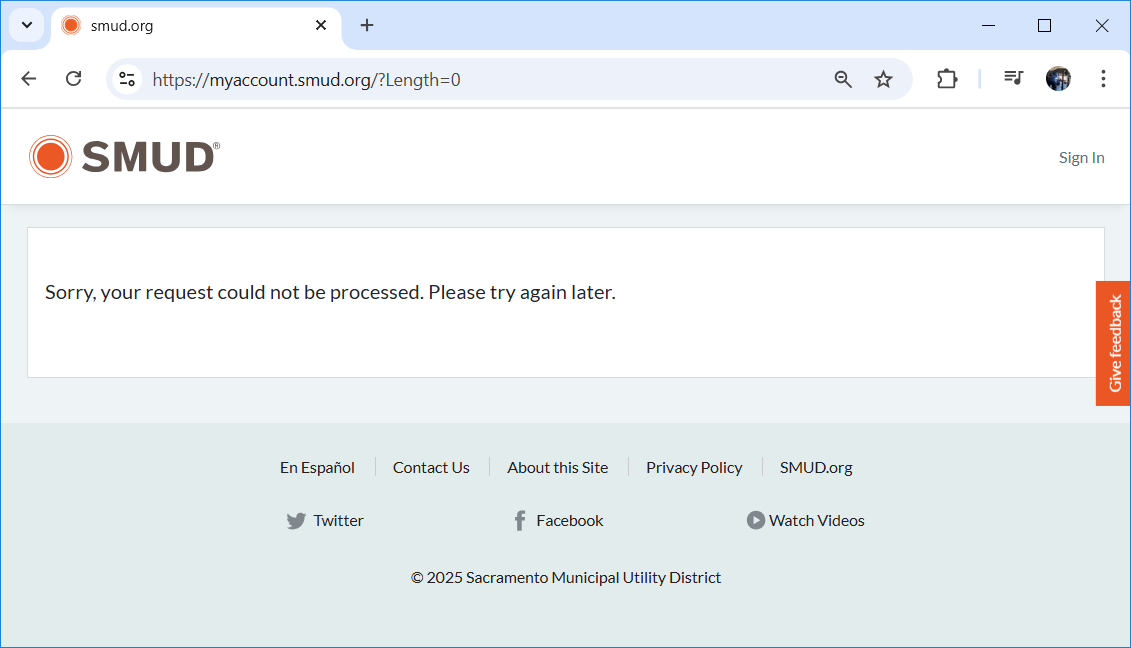

Can't you get cheaper power at night and slightly more expensive during the day?

sorry I would love to answer that, but it appear The Cloud is down !

so here is a lookie look at my electric daily rates, yes my town's utility statement looks like what would happen if your wireless telephone and credit card companies had a baby
Some Perspective: in 2014 when we leased a 2013 Nissan Leaf for three years the same electric company offered EV Rates from 8:00 pm until 8:00 am, if my memory servers me right (and my memory is so bad I can hide my own Easter eggs)
Now, ten years later, they have shrunk that window to Midnight until 6:00 am. I am able to set my charging via the Hyndai Ioniq 5 (pronounced: "the world's sexiest RWD only silver hatch back") app to only charge in that window, which I tried but then reverted back to Charge When Ever The Hell I Want - CWEtHIW schedule

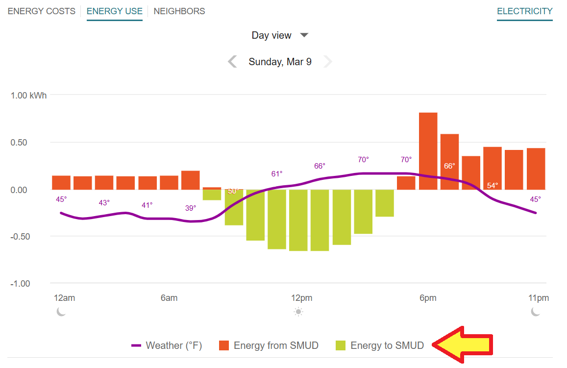

last day before Daylight Savings Time begins, what are your feeling about this [ahem] scam, I hate the winter hours
anyway I can look at the graph below all day, the green signifies me selling electricity back to my electric company, making my household an Official Power Plant, aka OPP yeah you know me (sorry couldn't resist)

Ok I managed to spend more than a few milliseconds looking at the graph and it all make perfect sense. :?
I was thrown by the strange random looking numbers with the degree symbol beside them, then it occurred they may refer to some ancient prehistoric measurement for temperature. Bizarre!
After several hours scouring the Internet looking for a way to translate these numbers into something that can be read by modern man I gave up.
Then by pure luck I happened upon a stone age thermostat the wife keeps on the wall and low and behold there it was. Deg F with Deg C right beside it. :D
So in this archaic language it seems the high temp of 70F is the same as 21C and the low 39F is about 4C
These are very pleasant temperatures for March but I guess you pay the price in July and August.
