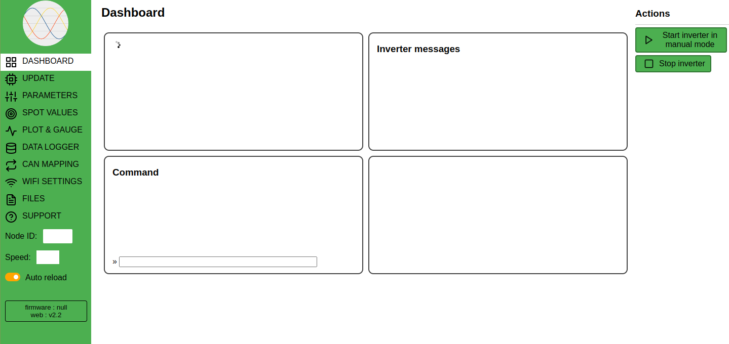

So partially as a reminder of what I've done so far, a how-to (or possibly how not to!) and partially as a cry for help I'm writiing what I've done so far in order to flash my BMS boards.
1 - purchased an STLink USB dongle, connected it up to the BMS board using J5 pinout as...
V = 3.3V
D = SWDIO
C = SWCLK
G = GND
2 - flashed the bootloader linked from the github here https://github.com/jsphuebner/FlyingAdcBms using STLink GUI on Linux to the default address that comes up... 0x08000000
"The firmware is linked to leave the 4 kb of flash unused. Those 4 kb are reserved for the bootloader that you can find here: https://github.com/jsphuebner/tumanako- ... bootloader When flashing your device for the first time you must first flash that bootloader. After that you can use the ESP8266 module and its web interface to upload your actual application firmware. The web interface is here: https://github.com/jsphuebner/esp8266-web-interface Binaries are here: https://github.com/jsphuebner/FlyingAdcBms/actions"
3 - installed the web interface on an ESP32 board (Lilygo TCan with onboard CAN) using PlatformIO (because for some gawd-damn reason I can't get the ESP32 SPIFFS data upload to work in Arduino IDE anymore).
4 - connected the ESP32 to the BMS board via CAN (H/L and GND) and gave the BMS 12V, Gnd and 12V on the enable, and gave the ESP32 12V and GND
5 - Connected to the web interface wifi network and go to 192.168.4.1, here I get "Communication problem between ESP and STM" which I assume is because I've not flashed the firmware yet.
6 - get the BIN from https://github.com/jsphuebner/FlyingAdcBms/actions (don't forget to log in if you want to actually download the files!)
7 - flashed the BIN on the WEB UI using the firmware upload, I get a pretty much instantanesous "upload successful message", but then it hangs...
8 - power cycle the boards
9 - ??? still get the communication error so I suspect it's failed.
Any help/nudging/guidance appreciated.

Yes unfortunately the ESP doesn't play well when there is no firmware installed. It doesn't pick up the cyclic "Hello" from the boot loader. So flash the firmware HEX file with your ST Link as well.

Hmm I think I actually tried this subsequently and got a "binary overwrites flash" error. Do I write to the same address as previously? (0x08000000) And still have the "communication problem between esp and STM" warning.

You don't specify addresses when using hex files as they contain the address info already

So I've resorted to the cmd line tool for a bit more information on what's going on.
Here's the output...
~$ sudo st-flash write stm32_loader.hex 0x08000000
st-flash 1.6.0
2024-07-21T08:09:24 INFO usb.c: -- exit_dfu_mode
2024-07-21T08:09:24 INFO common.c: Loading device parameters....
2024-07-21T08:09:24 INFO common.c: Device connected is: F1 Medium-density device, id 0x20036410
2024-07-21T08:09:24 INFO common.c: SRAM size: 0x5000 bytes (20 KiB), Flash: 0x10000 bytes (64 KiB) in pages of 1024 bytes
2024-07-21T08:09:24 INFO common.c: Attempting to write 8008 (0x1f48) bytes to stm32 address: 134217728 (0x8000000)
Flash page at addr: 0x08001c00 erased
2024-07-21T08:09:24 INFO common.c: Finished erasing 8 pages of 1024 (0x400) bytes
2024-07-21T08:09:24 INFO common.c: Starting Flash write for VL/F0/F3/F1_XL core id
2024-07-21T08:09:24 INFO flash_loader.c: Successfully loaded flash loader in sram
8/8 pages written
2024-07-21T08:09:24 INFO common.c: Starting verification of write complete
2024-07-21T08:09:24 ERROR common.c: Verification of flash failed at offset: 0
stlink_fwrite_flash() == -1
~$ sudo st-flash write stm32_bms.hex 0x08000000
st-flash 1.6.0
2024-07-21T08:10:35 INFO common.c: Loading device parameters....
2024-07-21T08:10:35 INFO common.c: Device connected is: F1 Medium-density device, id 0x20036410
2024-07-21T08:10:35 INFO common.c: SRAM size: 0x5000 bytes (20 KiB), Flash: 0x10000 bytes (64 KiB) in pages of 1024 bytes
2024-07-21T08:10:35 INFO common.c: Attempting to write 68964 (0x10d64) bytes to stm32 address: 134217728 (0x8000000)
2024-07-21T08:10:35 ERROR common.c: addr too high

Connecting the BMS board to 12V, GND, 12V to enable, CANH and CANL, connecting to the wifi, and navigating to 192.168.4.1 I get the Web interface, no longer do I have the communication error (which may have been down to an error in the OI_Can.cpp pin mapping), I get firmware: null.
- Been thanked: 1913 times
Re: Switched ADC BMS
It seems the esp32 firmware isn't up to date. Is it the latest github source?
