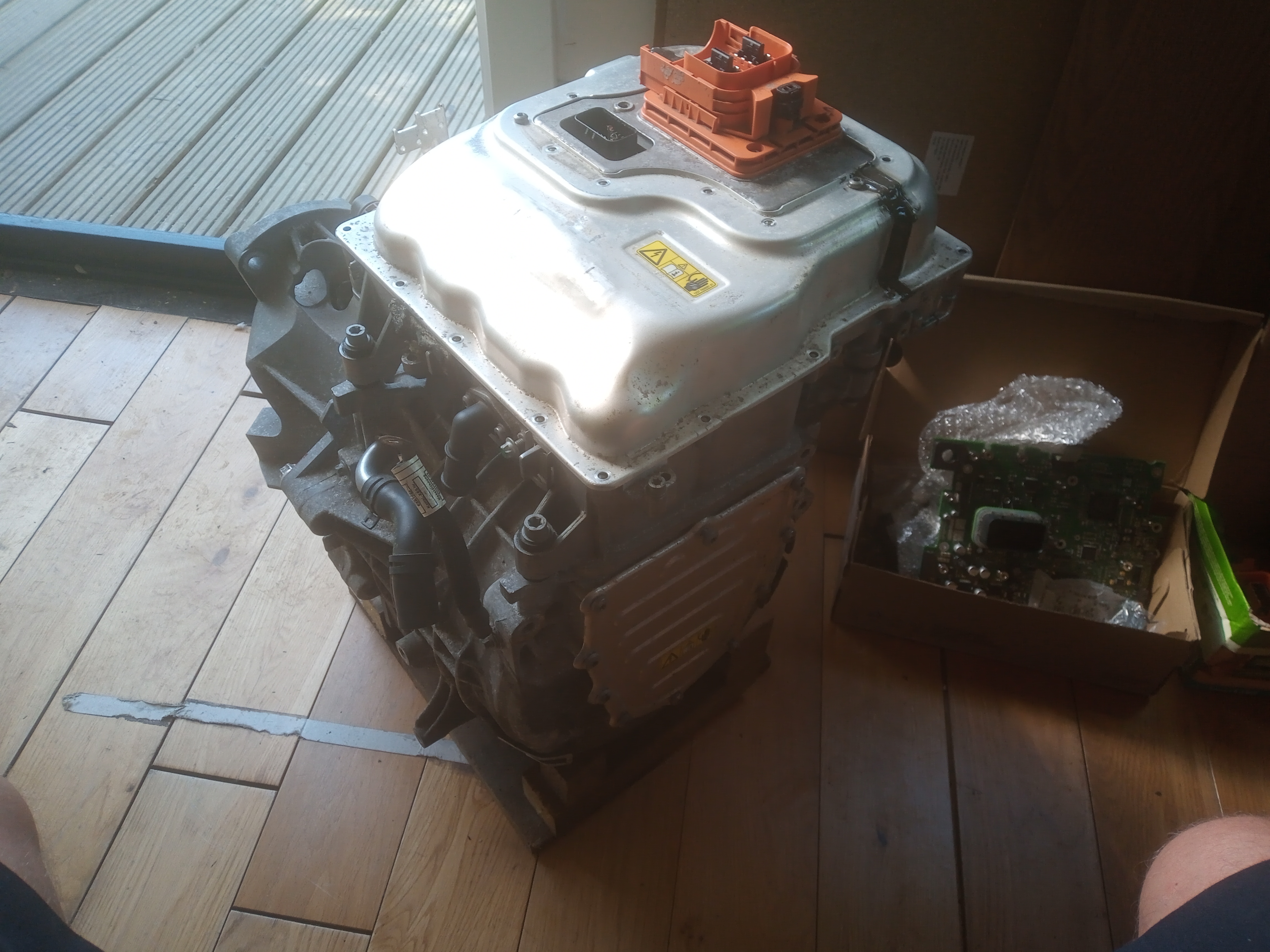

Re: i3 controller hacking from diyelectriccar.com

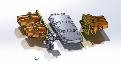

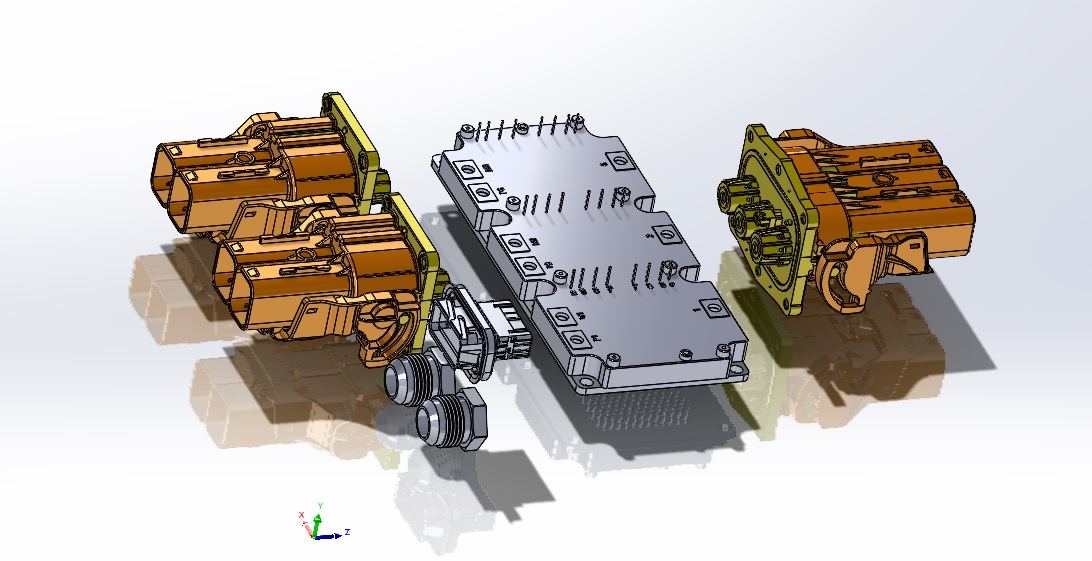

I'm pretty much there with the physical side of the inverter, I'll be popping a video up soon with the cut lines etc
Thought you might like to see it all together
Nice job! Well done! This is exactly what I meant. Was it easy/doable? Did you TIG weld it in the end?

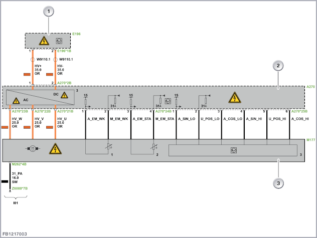

Does anyone have the pinout of the 12 pin from the resolver please?
I have looked through and can only see Hans has detailed the motor temp wires.

So I've been prodding the connectors and I've come up with this to go in tandem with the above pinout.
The grey block from the resolver Hans has already dealt with but I'll add some details too.
Working on the 12 pin connector I've taken pin 1 as the one by the dots.
Pins 1-6 go to the black connector
12 pin number 1 goes to black block pin 4 I think this is Sin H
Number 2 to black block 1 I think this is Sin L
Number 3 to black block 5. Ex H?
Number 4 to black block 2. Ex L?
Number 5 to black block 6. Cos H
Number 6 to black block 3. Cos L
Number 7 to grey block 1 blue
Number 8 to grey block 2 grey
Number 9 to grey block 3 red
Number 10 to grey block 4 grey
Numbers 11 + 12 unused
The question is which Temp wires do we connect to pins 17+18 on the board?
Restoring and converting a Classic Mini, I have mad ideas, semi sensible ideas and NO idea if I’ll ever get it done
- Posts: 107
- Joined: Thu Jun 04, 2020 12:23 pm
- Location: Dorset, England

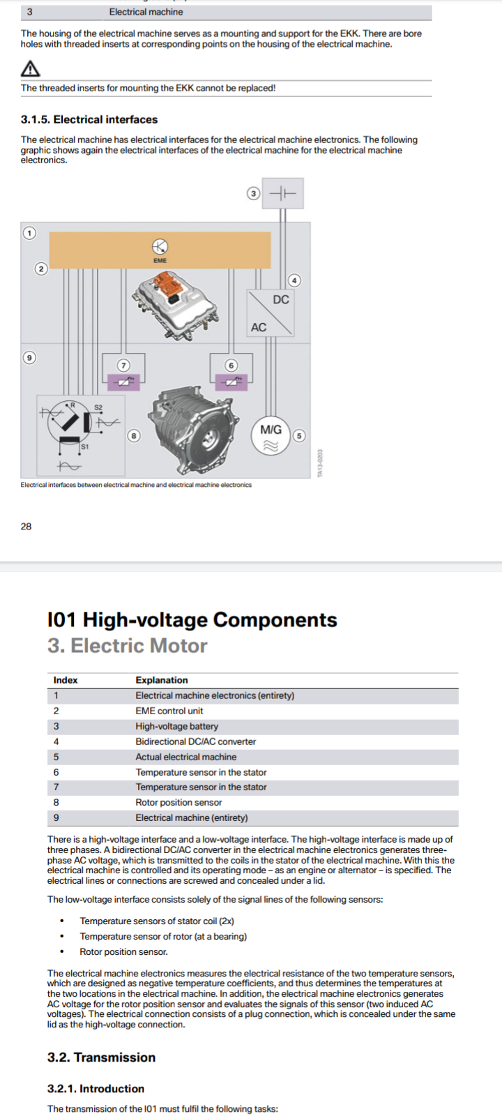

Found it!
The two temp sensors go to the stator and rotor (at the bearing)

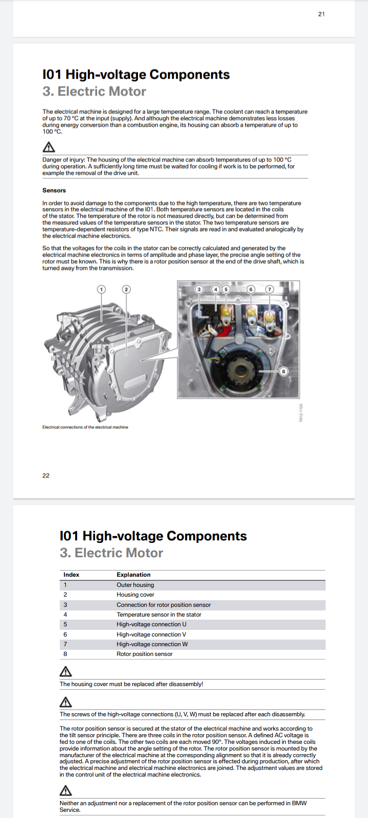

That documentation is confusing it states 3 sensors are present and only states two connections. I think that one connection has 2 sensors of the stator in parallel. So you will read half the signal.
If you see in the connection list it only states 2x stator but no rotor sensor. The diagram also looks to omit the rotor sensor l..
As we only have one temp sensor input do we use the rotor or stator temp?
Even more confusing is this page shows the connectors the other way round to what I expected with the block with 6 wires for the temp and the block with 4 wires for the rotor position

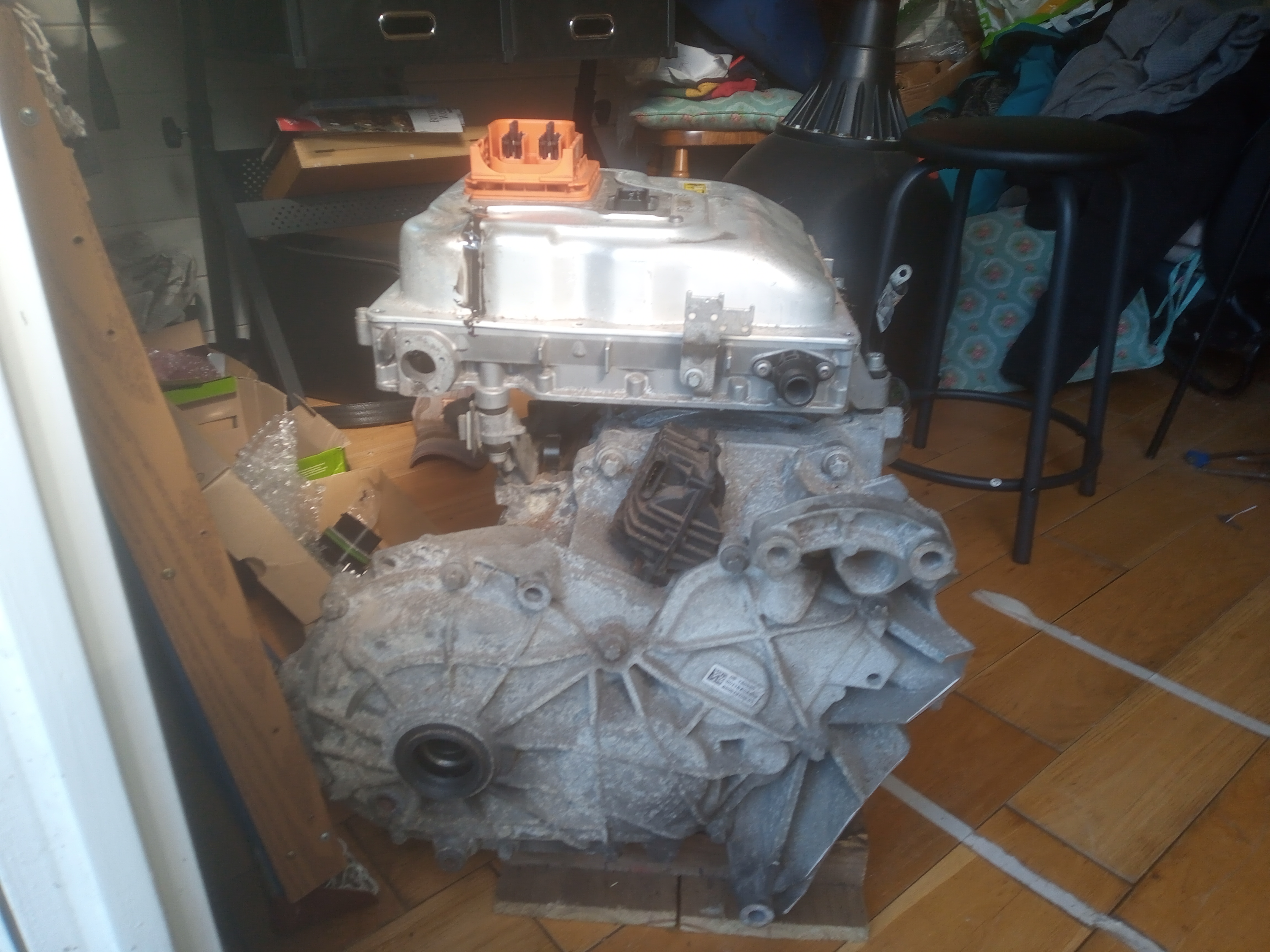

My motor seems to be stuck in Park, Damien says it should turn by hand but it's not happening.
Do I have to take the transmission off?

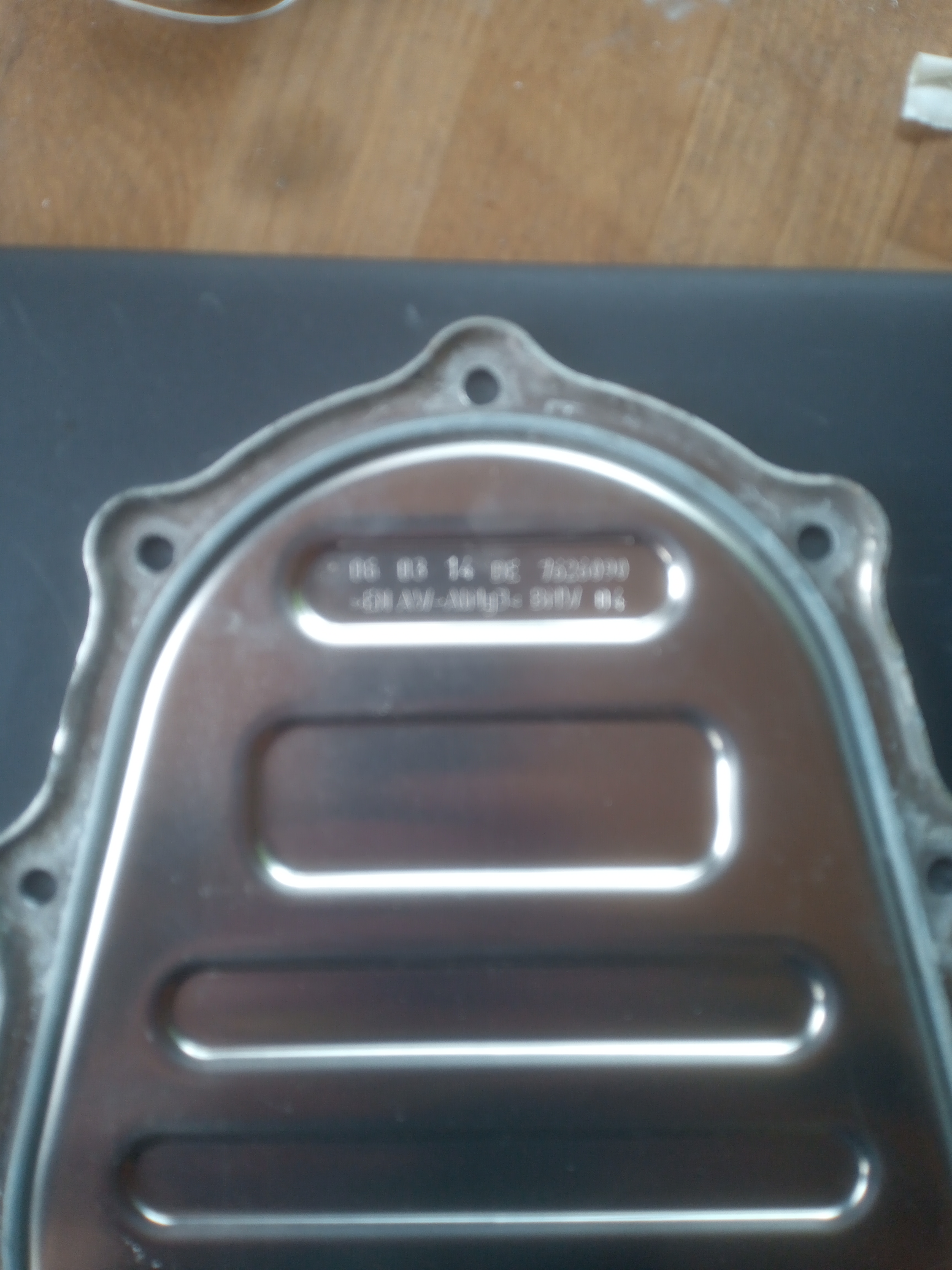

If anyone knows the pinout of the parking actuator that would be amazing.
I've been doing some reading and I think these numbers on the motor cover could be to do with the position sensors.
Sorry, forgot the image
- Posts: 107
It's not very clear but there is a 06, 03 and 14

The motor actuator is 12V to the outer two pins of the plug. Apply 12V in one direction to lock, reverse the polarity on the pins to unlock. You should only need ~5A of current to actuate, and you will head the gears moving in the actuator until it stops in the new position. If that doesn’t help, you should be able to unbolt the actuator from the gearbox if you get properly stuck. Please don’t open the gearbox unless completely necessary! You’ll just have more pain reassembling everything.
