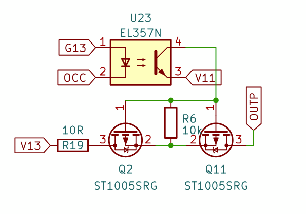

I managed to kill another board while doing harry potter movements around the the cell taps with a chinese cell internal resistance meter (which as far as I understand measures by AC current injection) probe - only one end. The other probe end just sits on the bench or is touched by me to exxagerate whatever is going on, on oscilloscope the signal looks similar to 50Hz ether background, just much choppier, by doing various magical movements I could get up to about 20Vpp.
I lack many 101s in EE, but as far as I understand:
some transient kicks over VGS and opens the wrong fet at the wrong time, maybe even exceeds the VGSmax and kicks a permanent hole there. The gate capacitance is pretty low so some stray electrons can open it up.
There's long battery balance wires, various power electronics nearby, I don't understand much, but there doesnt seem to be many EMI protection provisoions anywhere on frontend.
Could a simple ceramic capacitor across cell taps aide here if cycling between cells is clocked down from whatever it is to account for the extra delay? Maybe bidirectional TVS diodes to negate anything caught by the long cell taps? Maybe extra zener or tvs near 10k VGS resistor?

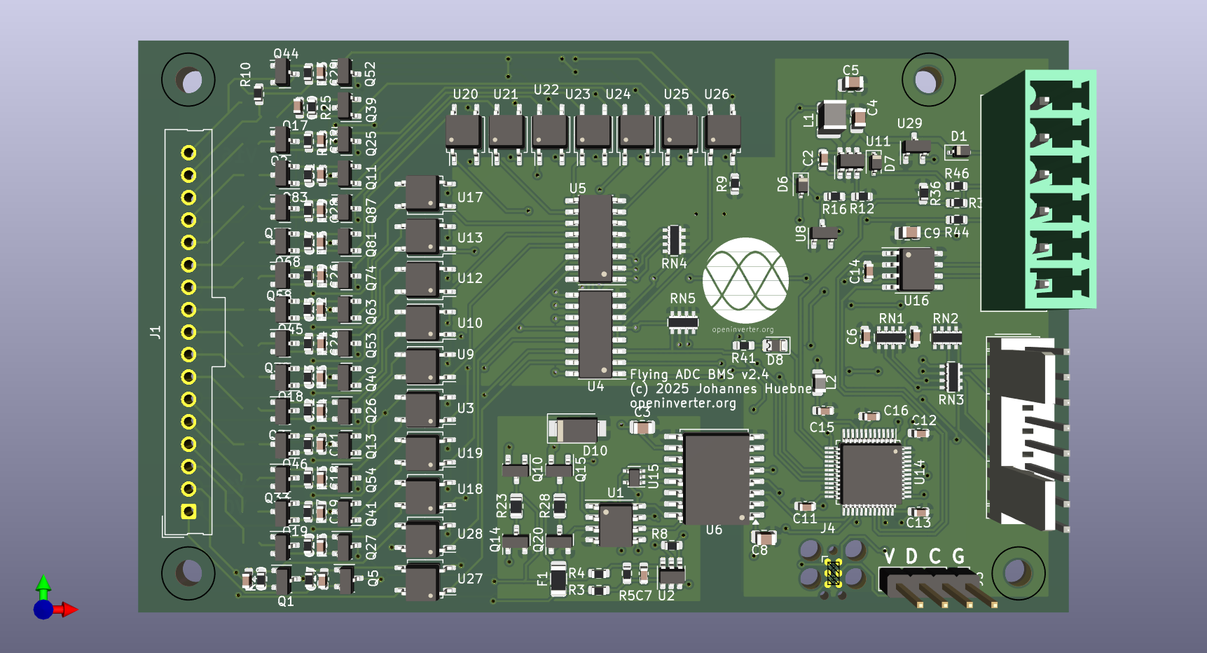

skr wrote: Sat May 10, 2025 7:21 pm Johu here has done tremendous amount of work, this is something we can figure out <3
Thanks, that is very motivating!
You could have a point with the missing transient protection. It might also be worhtwhile to dampen the gates themselves with a capacitor? Plus the cell taps themselves. The cap on the gates would need to have a sane time constant in conjunction with the 10k pull-down resistor.
Right now a cell voltage is sampled every 30 ms, so all cells are sampled within roughly 0.5s. The dead time is generated by inserting an I2C transaction with the balancer which takes 1 ms on < v2.2 and 100 us on a v2.3 board. Usually that is plenty of dead time.
I also observed that 99% of all failures happen once the boards are chained up AND they happen at startup. I think you are the only one who had a board go bad in the middle of operation. These chain+startup failures date back to the first version boards that we tested in London in 2023. Worked a charme when only one was connected, started blowing up once a second or third one was added.

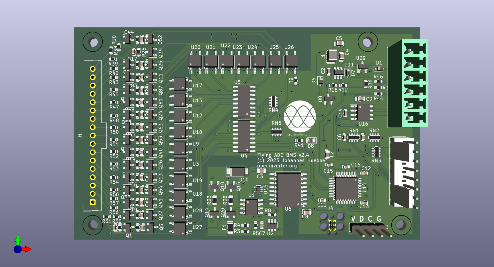

Since then many aspects of the design changed. To sum it up
- v1.x boards didn't have individual optos per input but a 74-series shift register, adder and decoder behind a digital isolator. We suspected that to behave strangely plus it slowly disbalanced cells over weeks when balancing was turned off
- v2.0 boards then deployed the individual optos together with 74-series decoders to save pins and avoid illegal switch states
- v2.2 boards added pull-down resistors on the decoder inputs
- v2.3 boards replaced the low creepage distance 5V to 5V DC/DC converter by the IS2631 isolator
All these changes have not reliably fixed the problem so we are clearly missing something. The gate and cell caps are worth a try. And we must find out why it is so much more likely to happen when boards are cascaded??
The next production run will revert to the 5V DC/DC as the IS2531 has gone out of stock.
EDIT: a 10 nF cap in parallel to the gate pull-down resistors would add a time constant of 600us. These could just piggy-back the resistors for testing. Likewise caps on the cells taps could just be soldered directly across the inputs.

I noticed that the fw checks for passives to see what revision it is.
Does the above timing outline mean that there 2.3 has 10x more time doing nothing for the dead time, or is the overall loop just quicker? I mean that in terms of adding 10nF on gates would still be within the operational window in terms of gate slopes?
If that's not the case, any pointers on fw changes would be welcome, as I now just flashed CI artifacts.
If yes, 10nF or less is within acceptable limits- my plan is to put 1uF or 100nF on cell taps and =<10nF on gates and see if running a taser next to the board or something still kicks the mosfets in to the sunset.
Been thanked: 1913 times
Re: Flying ADC 16 channel BMS 96S test
It spends less time doing nothing: https://github.com/jsphuebner/FlyingAdc ... ms.cpp#L40 (and #84)
Because the IS2631 has a higher data rate.
And the cycle time is actually 25 ms to accomodate the 17 ms cycle time of the ADC. So it might be worthwhile to have 3 states
1. read ADC, disable mux
2. enable mux
3. start sampling
4. and 5. nothing
So the cycle time would drop to 5 ms and we'd still leave the ADC its 17 ms for sampling. We'd have a loooong dead time of 5 ms

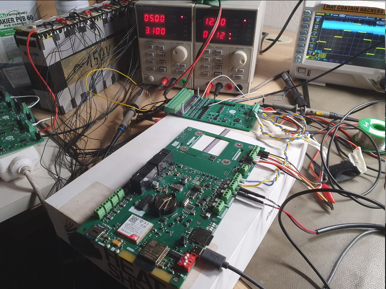

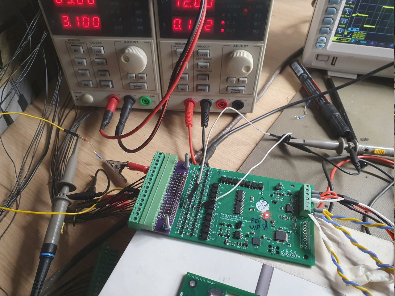

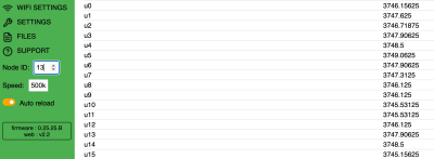

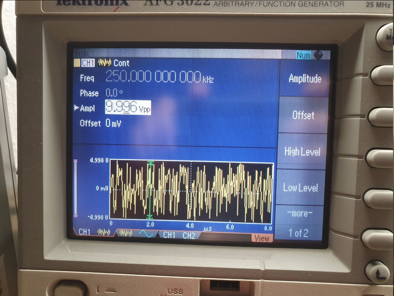

johu wrote: Sun May 11, 2025 7:18 am You could have a point with the missing transient protection.

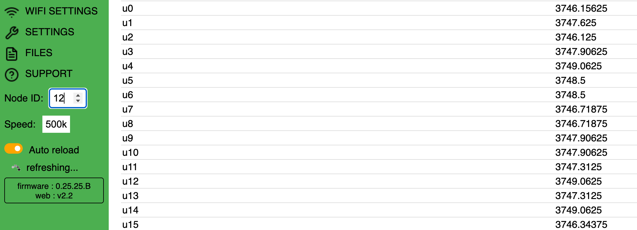

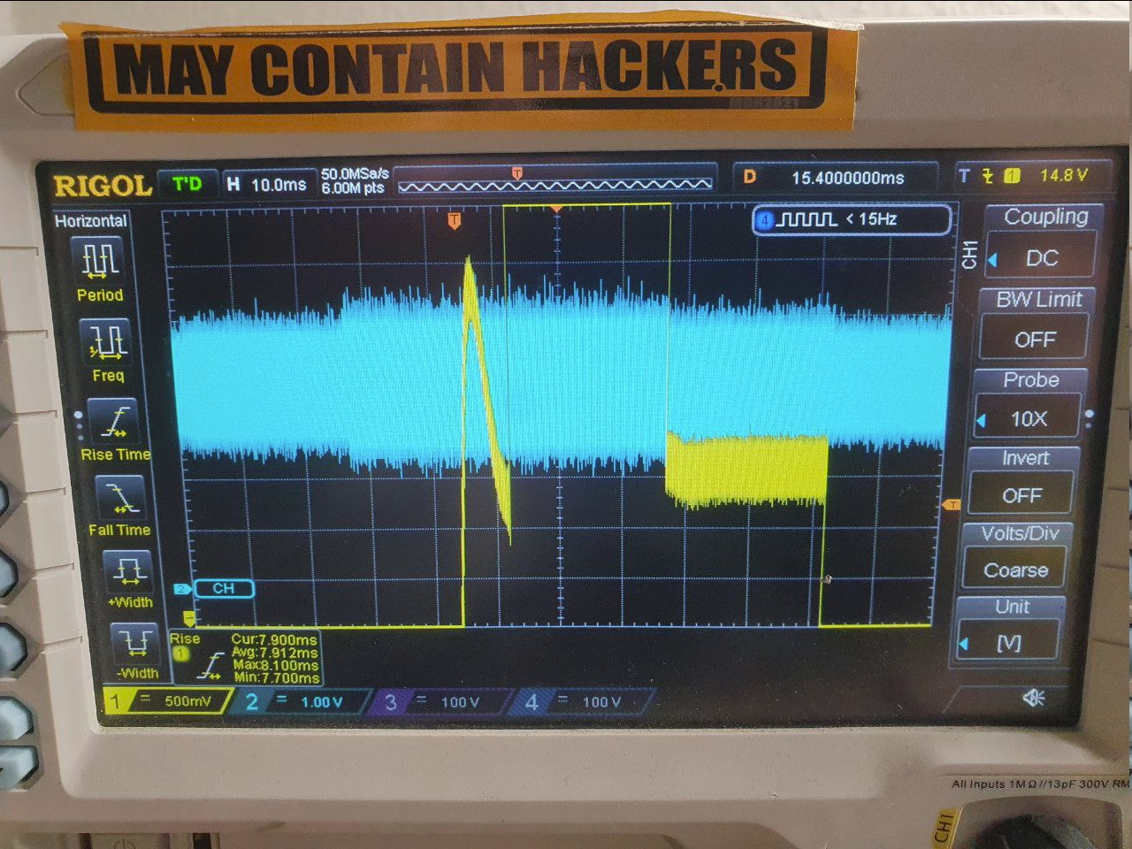

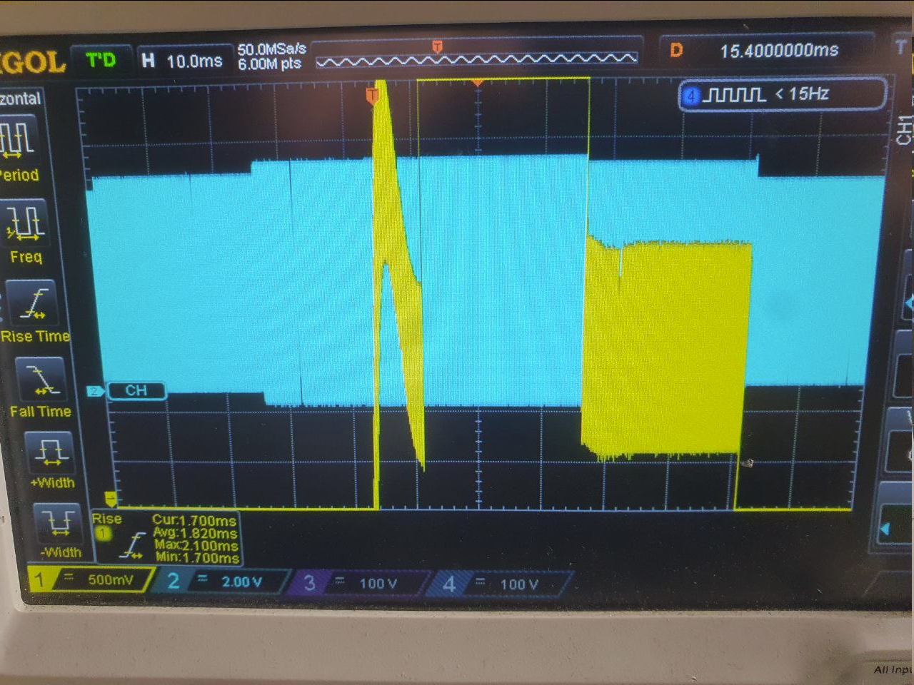

I took one of the muxshort boards and replaced two identified bad fets.
fets replaced, no cells attached, board running, no error.
http://jsonblob.com/1371648109440065536
on live board cells attached, values out of wack (some negative), taps are correct, on other working boards reports normally.
http://jsonblob.com/1371647936345333760
a few json requests after that, muxshort, error
http://jsonblob.com/1371647804015042560

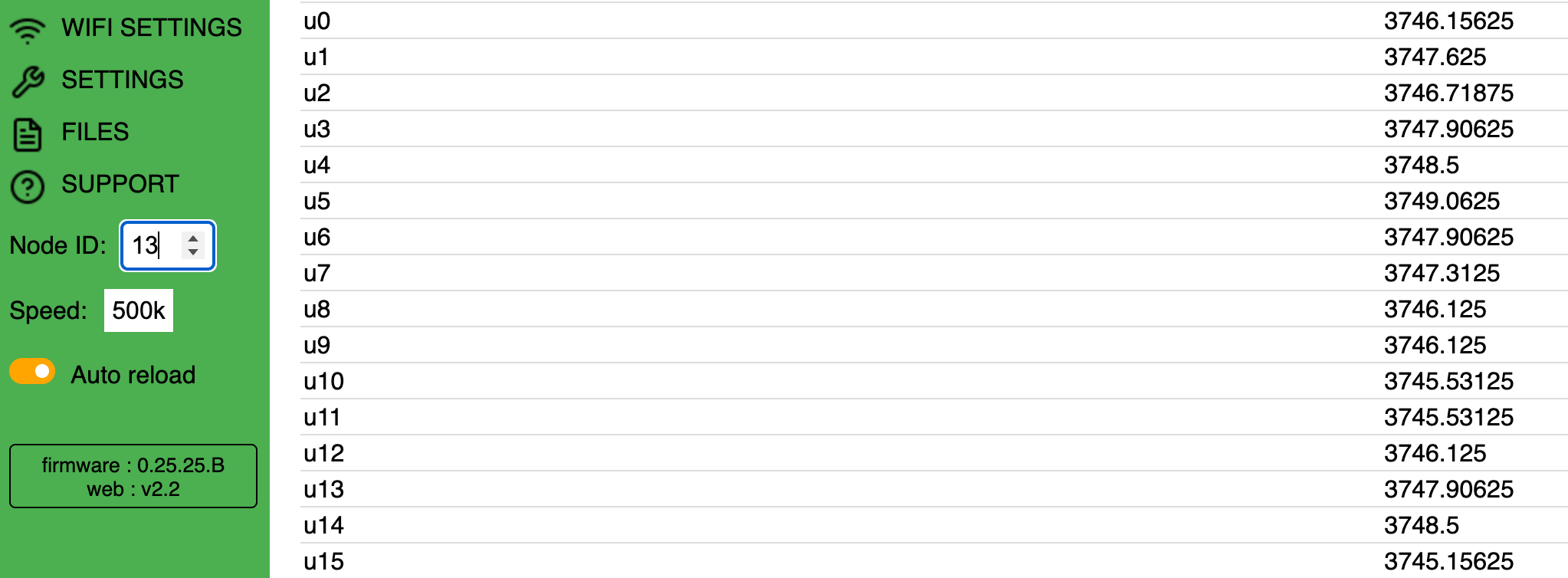

Not sure if it killed it now or I had missed one dead fet at low side, and two poylfuses which had turned in to infinite resistance resistors, not sure before or now, probably before when these polyfuses turned in to partial pyrofuses, IIRC I changed all dead ones, but maybe these were stuck in an undefined state.
now getting values properly. Interestingly on first boot after fixes u0 reported pack voltage and u0 was u1, u11 was u12, after reboot it got back where it should be. I have somewhat forked OIcan, so maybe that's something on my end.
http://jsonblob.com/1371647570421669888
The board is now balancing, only 12S attached to it.

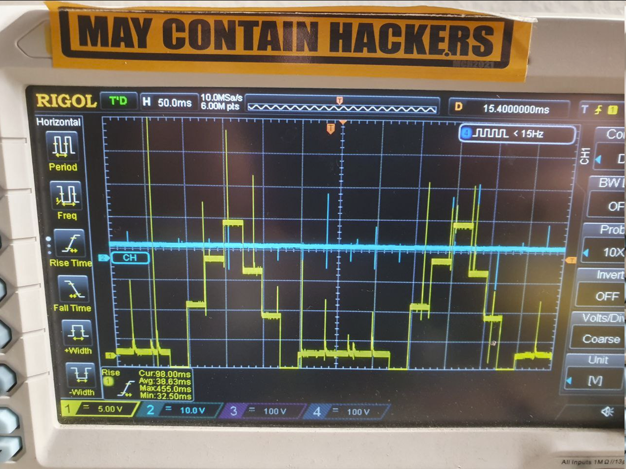

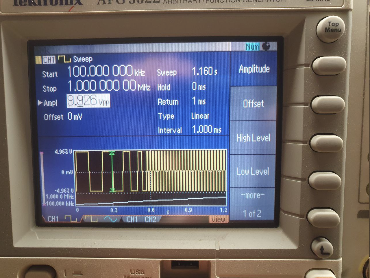

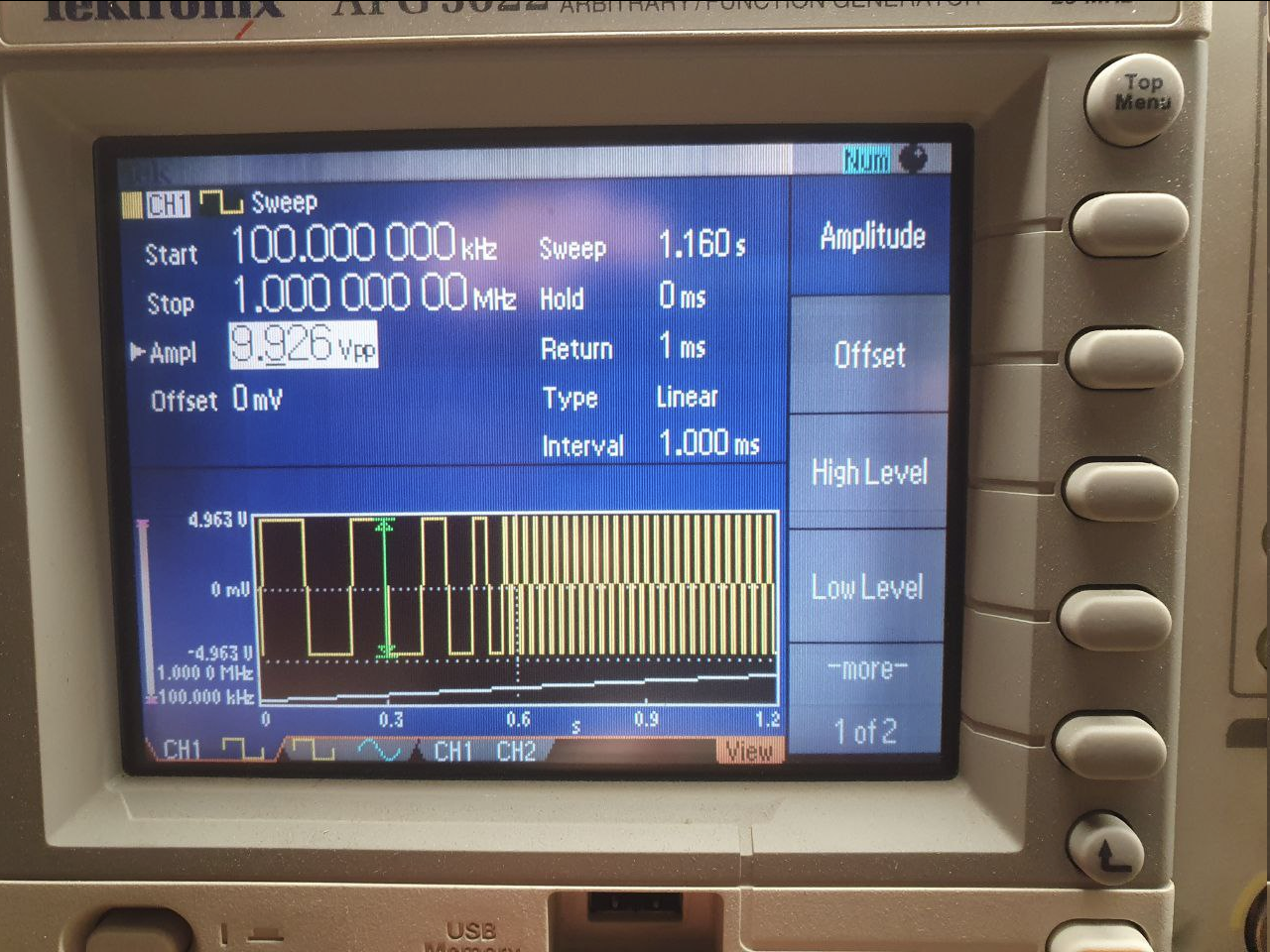

Plan is to use AFG3022 and inject noise simulation with it, increasing apmplitude slowly by +/- 100mVpp until anything happens or not.
AFG3022 is connected to V6 through a 10nF cap + 250 ohm resistor in series, ground ref to V5.
Oscilloscope one channel looking at V6 gates, ground ref to source after 10R. Other channel at V6 voltage.
Balancing turned off otherwise I could not really get the oscilloscope trigger to keep the gate in view.
At 10Vpp noise battery tap looks like shit, gate gets noisier, but BMS keeps chugging along, ADC still shows normal values.
Switching to squarewave 100mVpp -> 10Vpp.
fixed f up to 10Vpp no effect. Sweep from 100kHz to 1MHz no effect, scope completely out of whack.

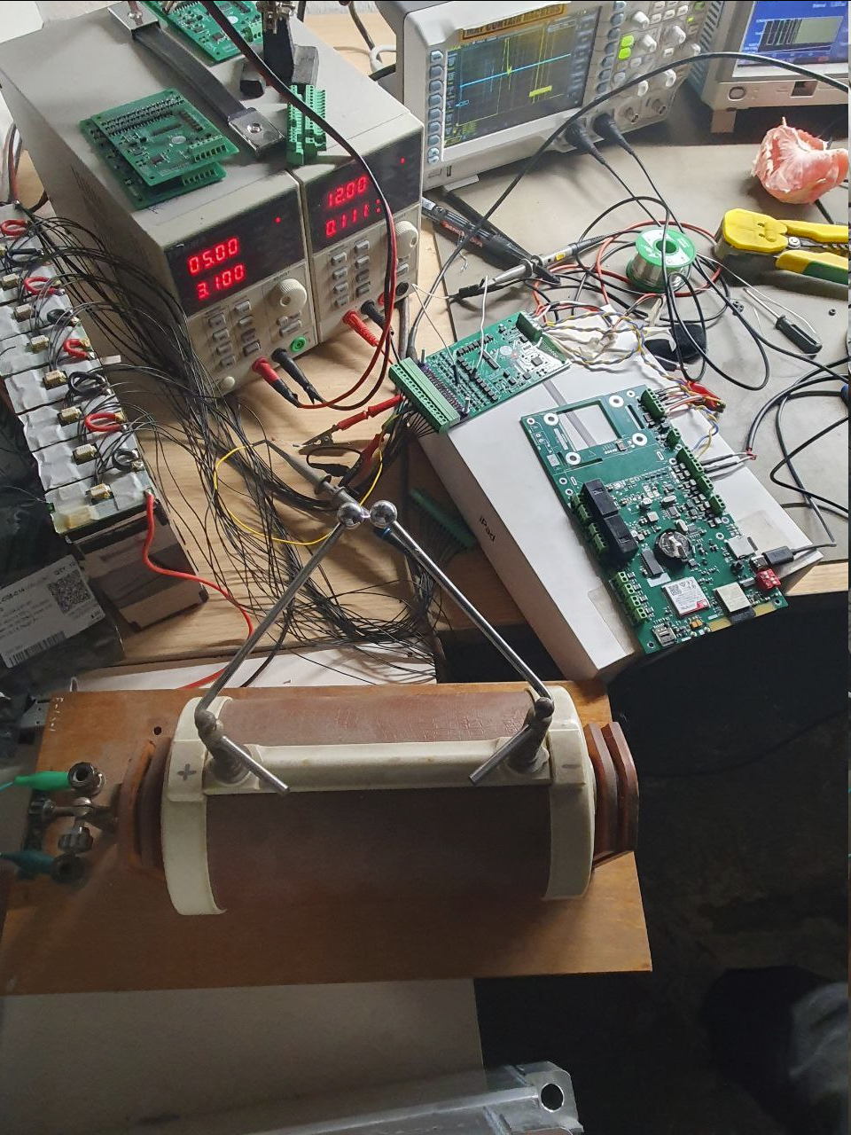

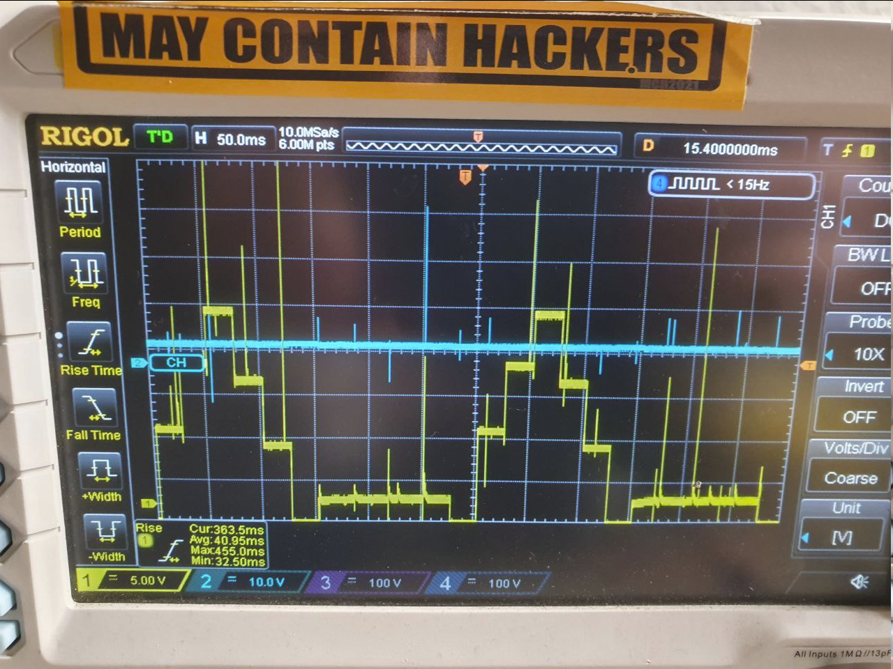

I had no bafangs to try, but I tried a PI metal detector with coil directly over bms and bms tap cables, IIRC coil peak current was ~1.5A @ 13V. No effect.

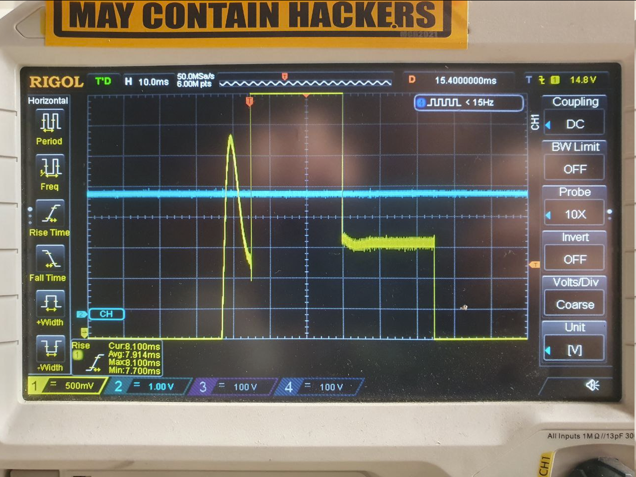

Next up: a physics experiment (A universally legal taser)
Located about 20cm from cell taps, can see up to +/-30~60V transients in cell taps, up to +/- 30~40V in gates. My laptop gets random stripes on the display and USB devices randomly reset a meter away.
BMS keeps chugging along.

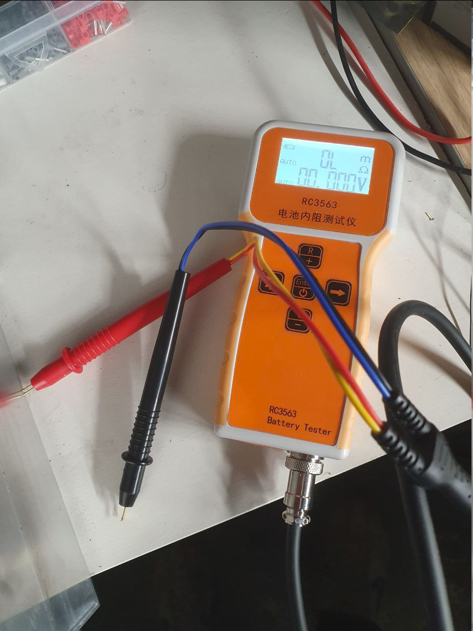

As a last resort: the chinese cell internal resistance meter on V6:
First one probe on bench, one on tap, then one probe in hand. Then doing all sorts of wavy things.
Nope, BMS has zero fucks to give. My previous theory of my antistatic mat shorting out cell tap TH solderjoints seems more plausible now.
Whats next?
No clue. Maybe Johu has some ideas, the taser should have worked if the issue was transients. Maybe it would have been worth it to be closer to 16S to give those fets something to worry about...maybe for more objective test it should have been done while balancing, but I am too lazy to try and repeat this.

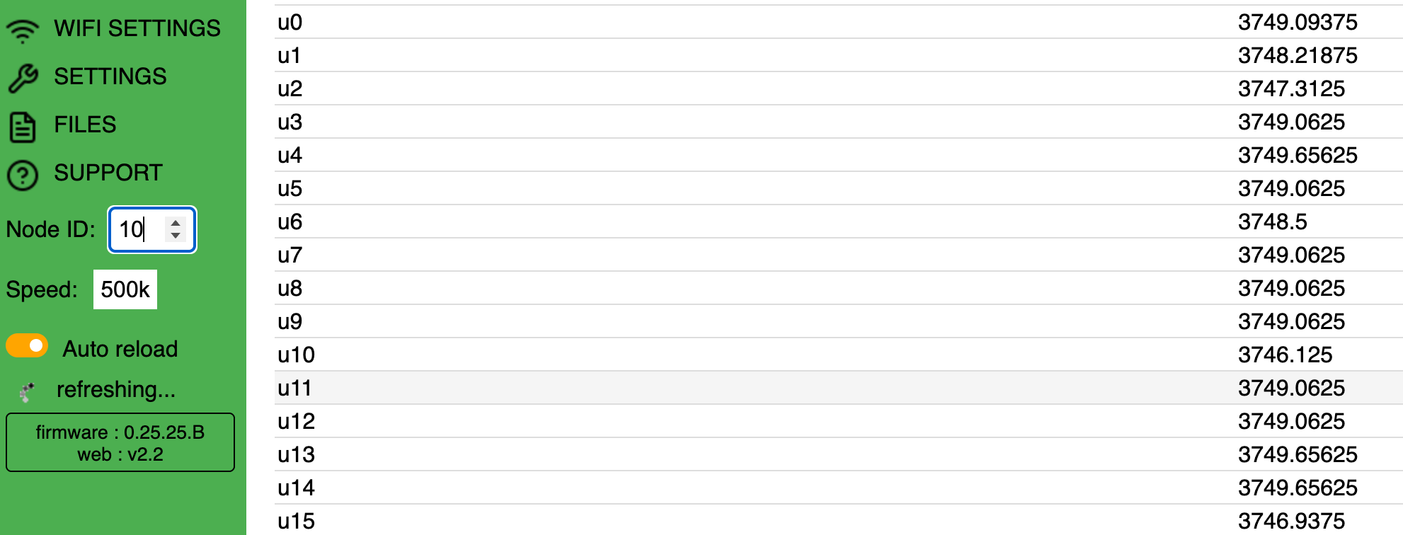

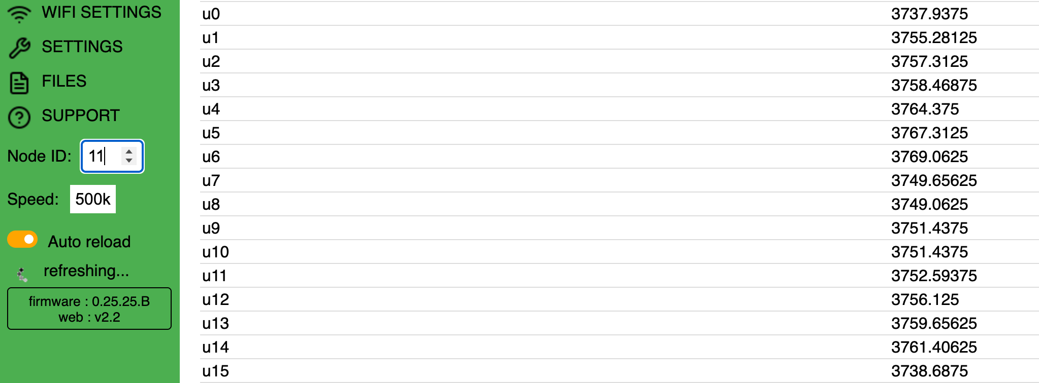

I noticed that ADC values had gotten out of whack showing 3800mV cells as 1000~2800mV, not sure if that was after the taser test or after the internal resistance meter. A power cycle sorted this.

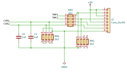

Another thing I noticed- if transients can happen in in cell taps, most batteries may have temp sensors running with the same long wires to a thermistor as well as the current sensor probably goes where some power electronics may cause weird things. Not much current can flow there, but voltage can still cause problems.
For not that many cents more extra protection, in my opinion, should be added here:
1) not to bring 5V line down unexpectedly if something goes wrong with the current sensor or thermistors
2) maybe RC filter the temperature inputs + TVS
3) current sensor also something to protect the STM32 to not get a hole blow in it.
I understand the design goals of this bms by keeping the component count as low as poosible, but it may cause much less headaches down the road with customer support by adding <20 cents to the bom of each board + some assembly cost. This is probably one of the coolest bms designs out there, and I don't question that you will make very many batteries healthspan improvements out there in the long run. :)

That is some extensive tests, cool :) So it looks like destroying a single board is near impossible, even without any anti-transient measures. I've already placed the gate caps yesterday. I will also remove the 10R input resistors as obviously they fail to protect the circuit but add another failure point. Will use the gained space for cell input caps.
So back to square 1 in fault finding. Here I see the main culprit in cascaded boards. So maybe the coupling capacitance from LV to HV side plays a role here? Like said I'm currently rigging up a test battery that should use a large number of boards.
Regarding the LV side inputs I indeed haven't put too much work into them. I wouldn't worry too much about the current sensor input as that is well isolated and has RC filtering. Has worked for a decade like this on inverter boards.
The temp sensors should receive more protection. A series resistor in the 5V supply and some basic part Zener behind RN3 for protection + capacitor for filtering.
It's not just about low component count but merely about using off the shelve parts. So we can add as many caps and diodes as we want without spoiling the design idea ;) Would just like to keep the dimensions.
That said I replaced the IS2631 by an IS3642 most of all because it isn't out of stock and it is pin compatible with an Adum5402

I wanted to test the taser with 8200pF 100V fitted on gate resistor + 1uF 50V X5R across cell taps, but repeatedly was getting cell polarity error. Soldered, desoldered caps, checked fets, connections to no avail.
I increased i2cdelay for hw ver 2.3 to 30, 100, could not get past this error unless I reduce cell number below the affected cell. I should probably look at this not during late night sessions, as hw seems ok otherwise...

running 4 bms board for almost a week straight, so far no issue.
been balancing away. cell voltages are spot on!!
BOARD 1
BOARD 2
board 2 was the first board to get a muxshort error a while ago, i didnt know better back then, i just left the board unpowered, but connected to the cells, so those 16 cells voltages went all over the place. i had to balance them with my lipo charger which took days, and in the process i charged them higher than the rest of the pack, but flying ADC has been working day and night to bring them down.
BOARD 3
BOARD 4
