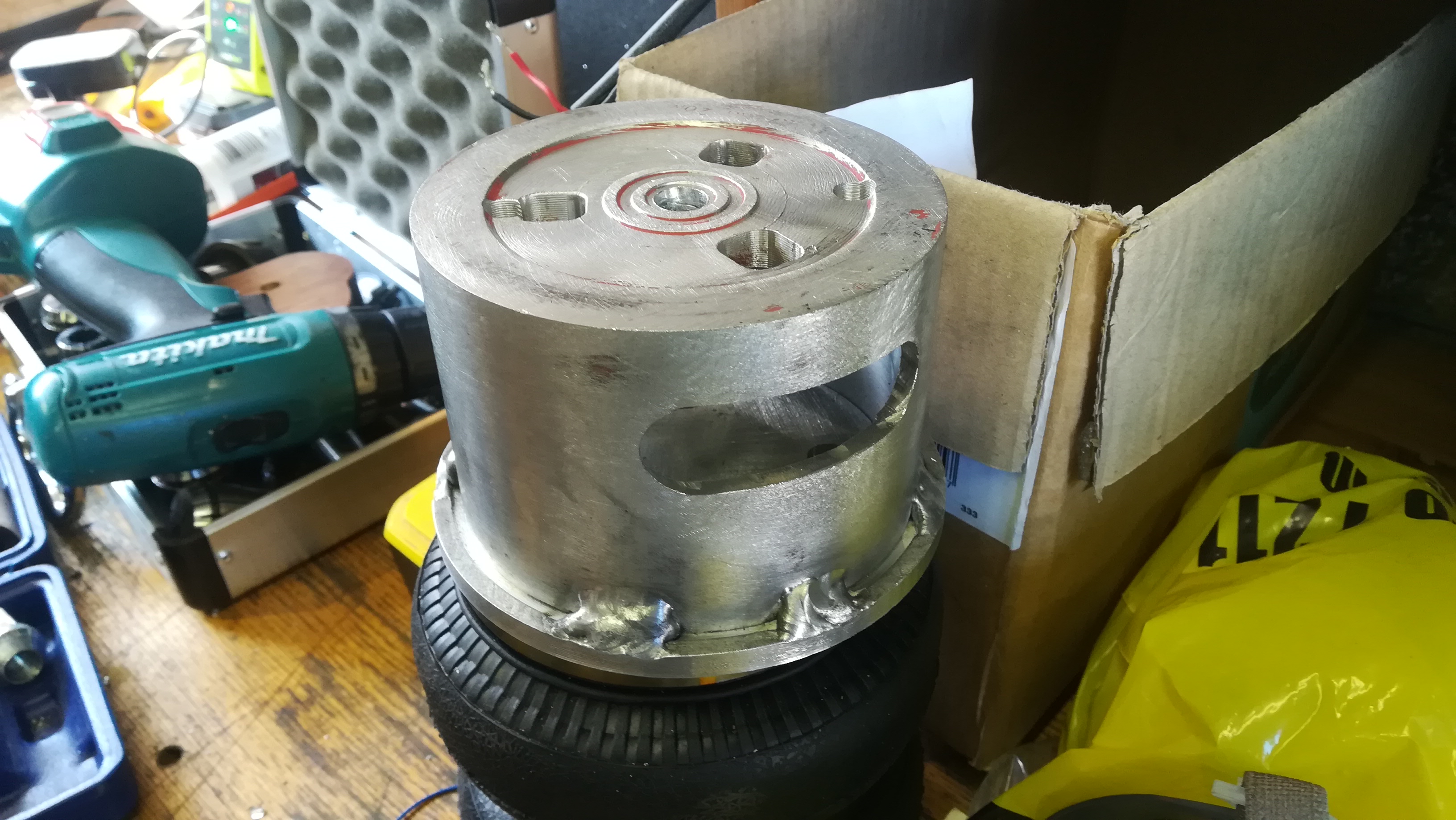

350Z air ride
Top mounting started off as a fire extinguisher in fact I was accused of ghetto rigging

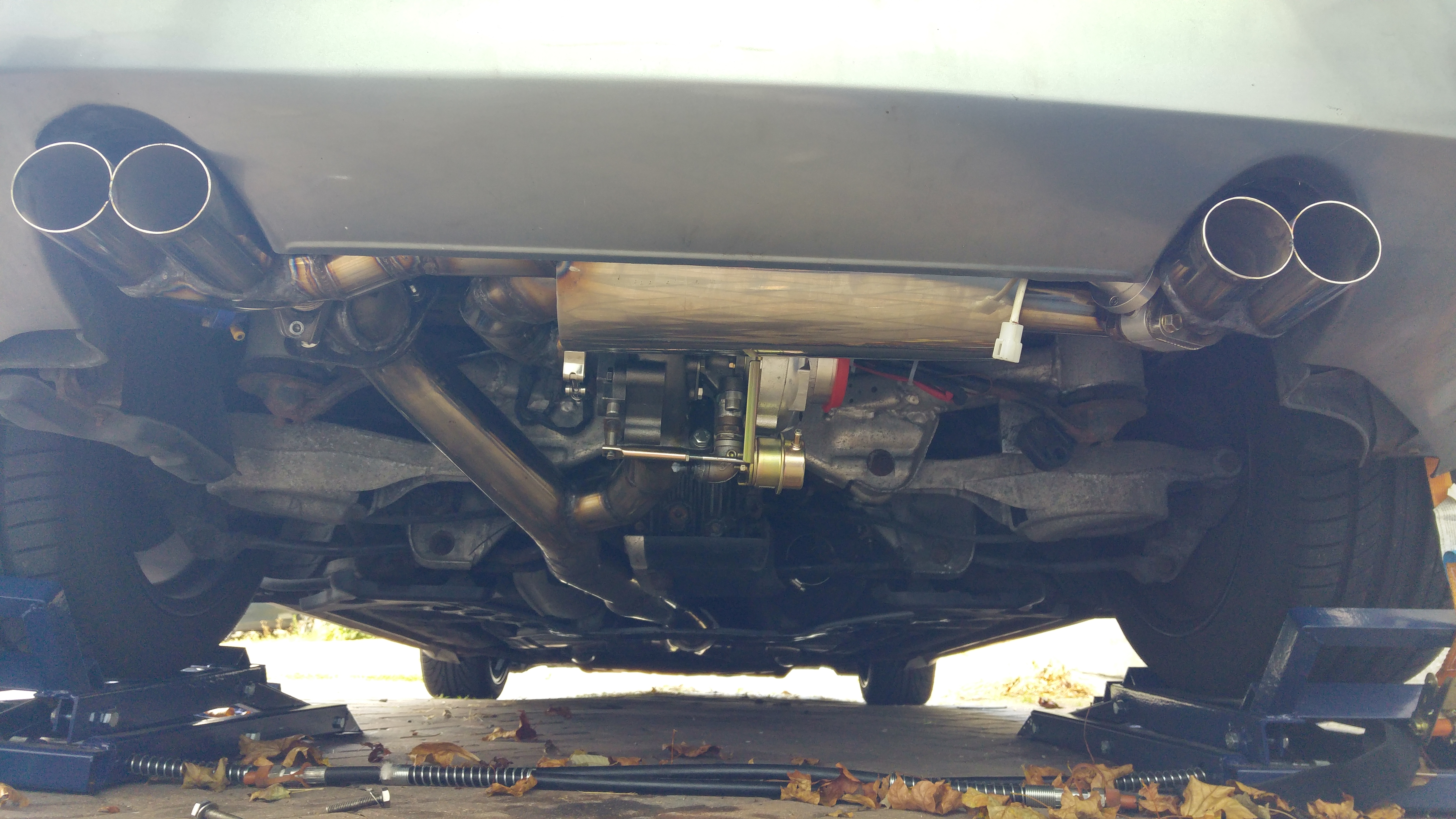

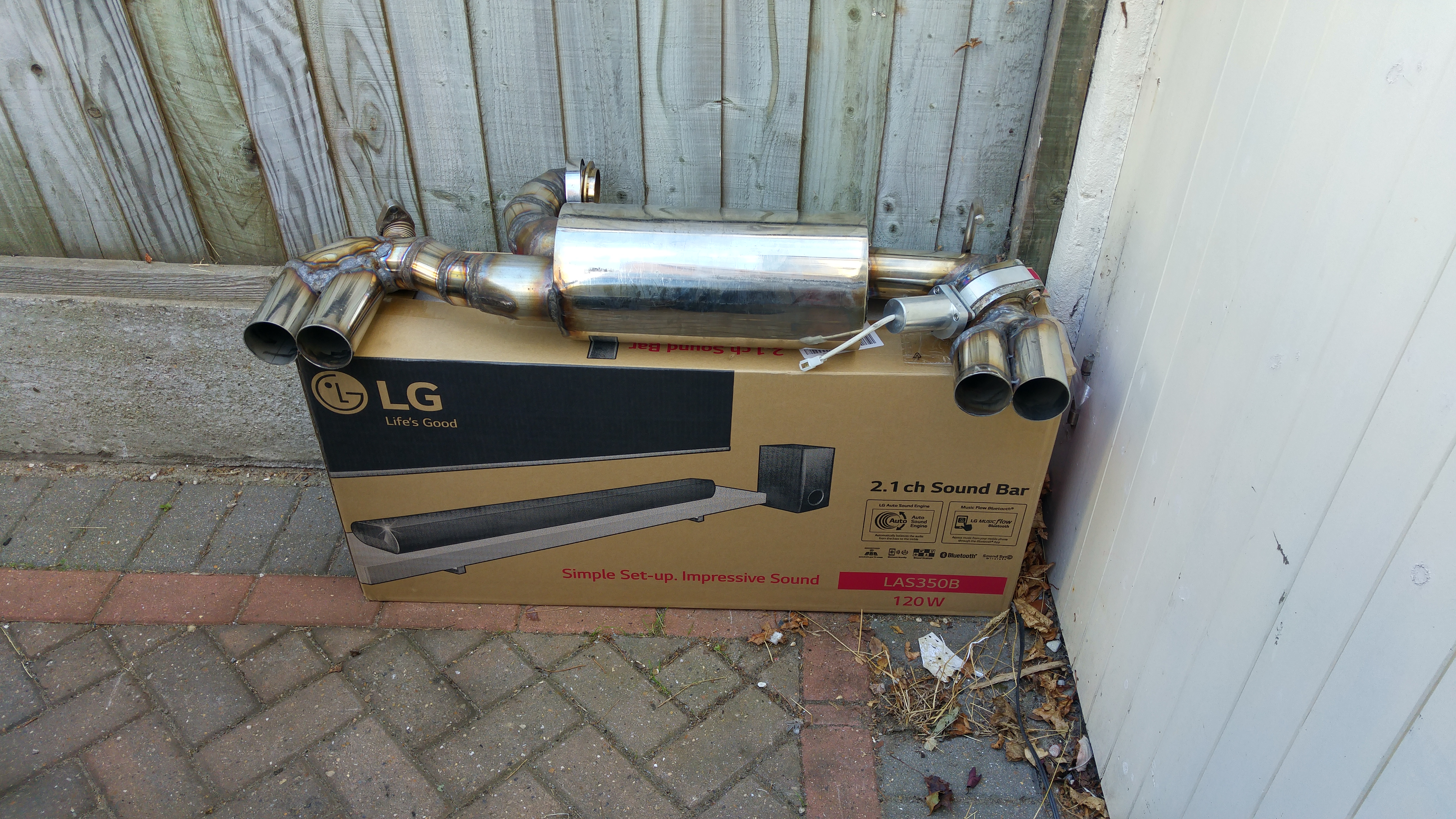

rearmount turbo 350Z

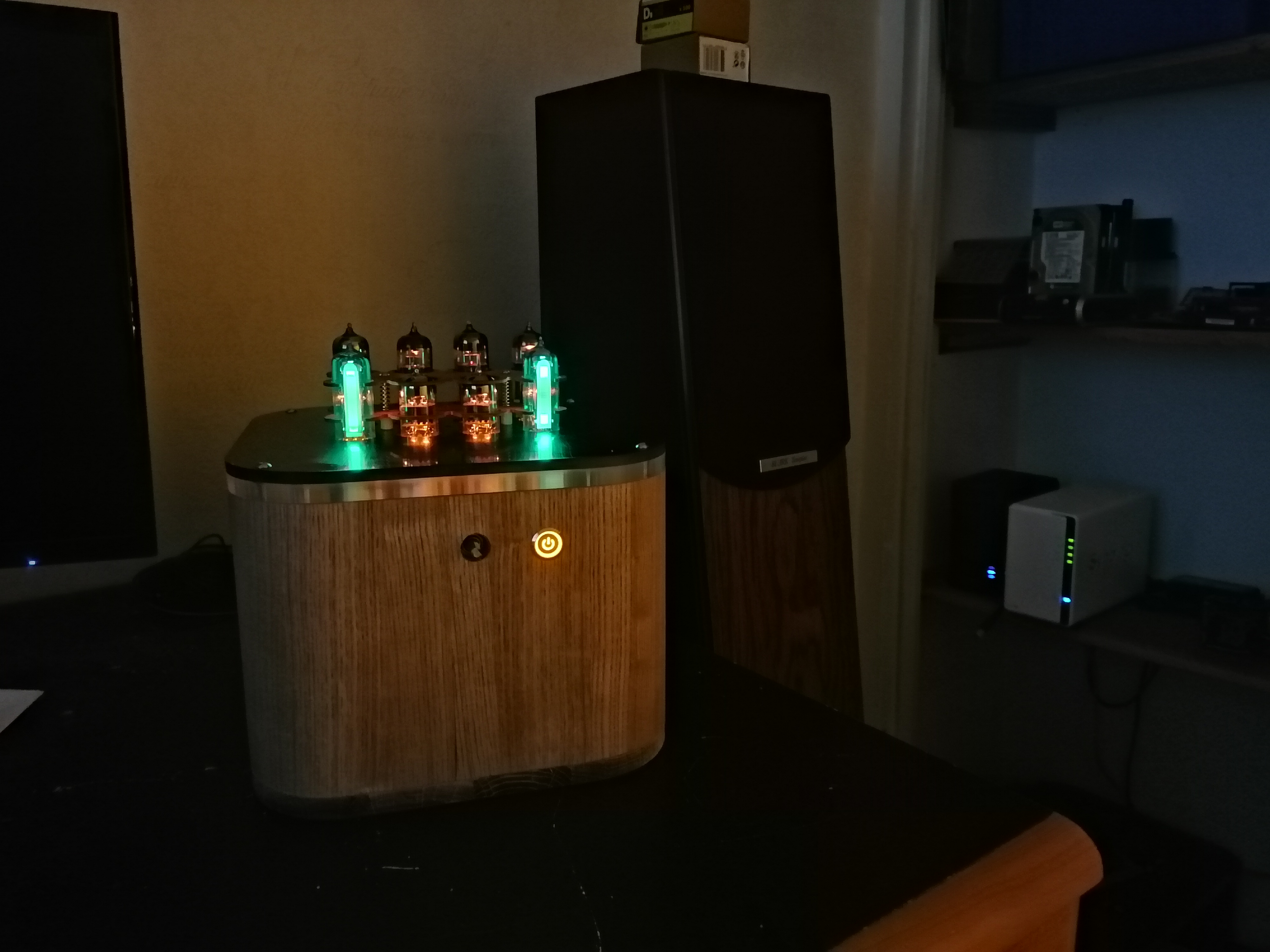

it's not all car stuff
cnc cut speaker enclosure sounded amazing
