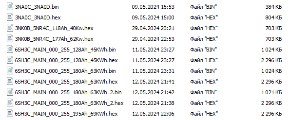

Marat
Posts: 29
Joined: Wed Nov 16, 2022 6:24 pm
Been thanked: 12 times
Re: Nissan Leaf BMS
Post by Marat »
Reprogramming the unit is necessary, otherwise the factory firmware will only process 22KWh, and this is in the case of a wear data reset.
BMS 40KW sees a maximum of 115Ah, and requires a different current sensor.

I've not heard anywhere that states the need for reprogramming on any thread on the leaf BMS when I was looking into it. Do you have more information on this?
Marat
Posts: 29
Re: Nissan Leaf BMS
Post by Marat »
I modified the firmware of the BMS unit of all generations of Liaf, chip 70F3236 70F3382, in order to expand the range of their operation to the required battery parameters, the most popular CATL 115Ah 120Ah 180Ah..., there is an example of standard BMS30 firmware adapted for BMS24 (3NR4C_BLINK-OFF.kwp).

noelho
Posts: 3
Joined: Wed Jul 31, 2024 12:19 am
Re: Nissan Leaf BMS
Post by noelho »
Marat wrote: Thu May 30, 2024 7:24 am Reprogramming the unit is necessary, otherwise the factory firmware will only process 22KWh, and this is in the case of a wear data reset.
Is it possible to change firmware and the sensor on a 24kWh BMS so that it can see a larger 62kWh pack?

Marat
Posts: 29
Re: Nissan Leaf BMS
Post by Marat »
The 24 kWh BMS current sensor does not need to be changed, only the software is changed.
Unfortunately, it is almost impossible to do this now (RU).
