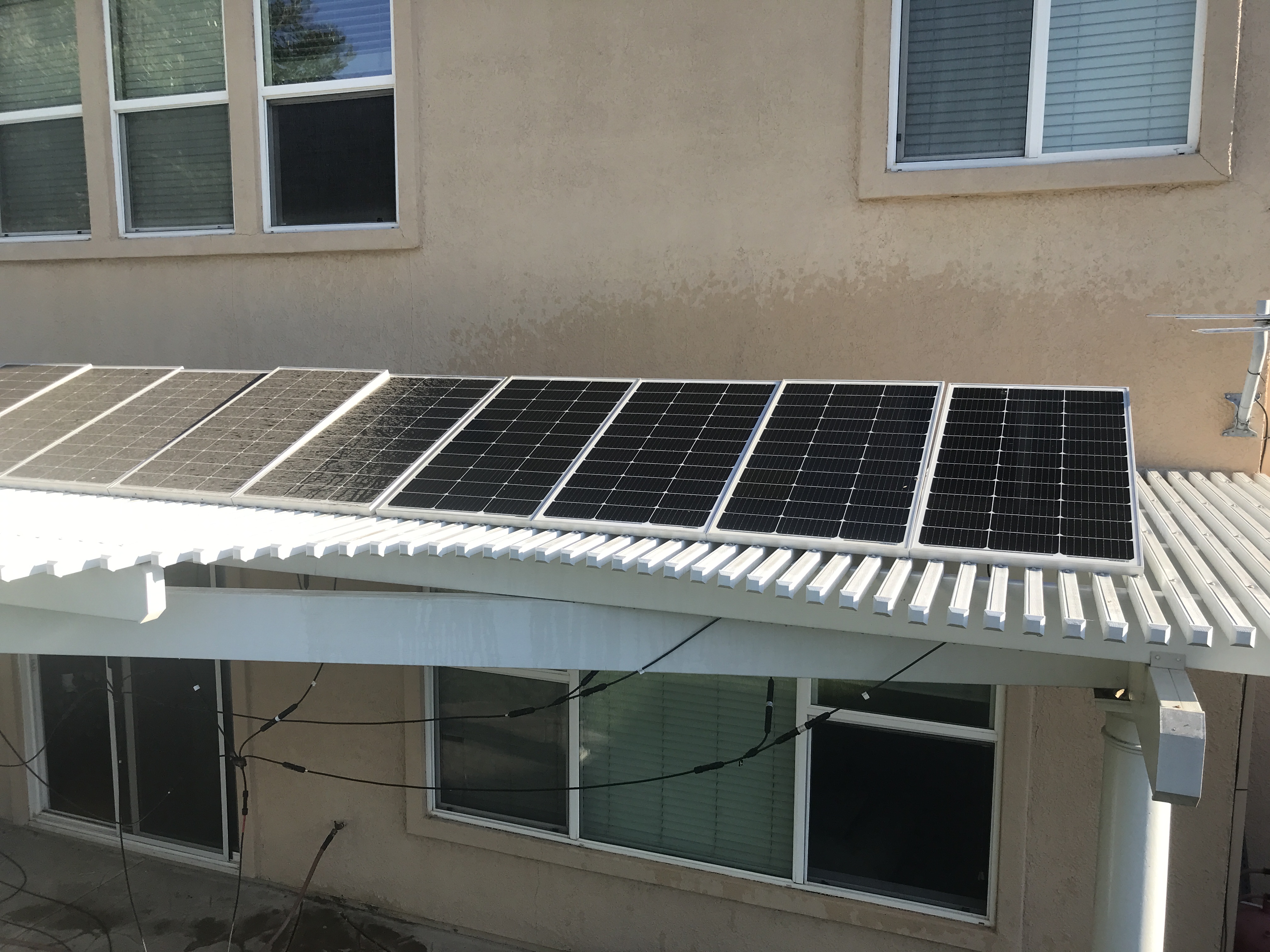

Does cleaning your solar panels make a difference? On this Sunday Solar episode:

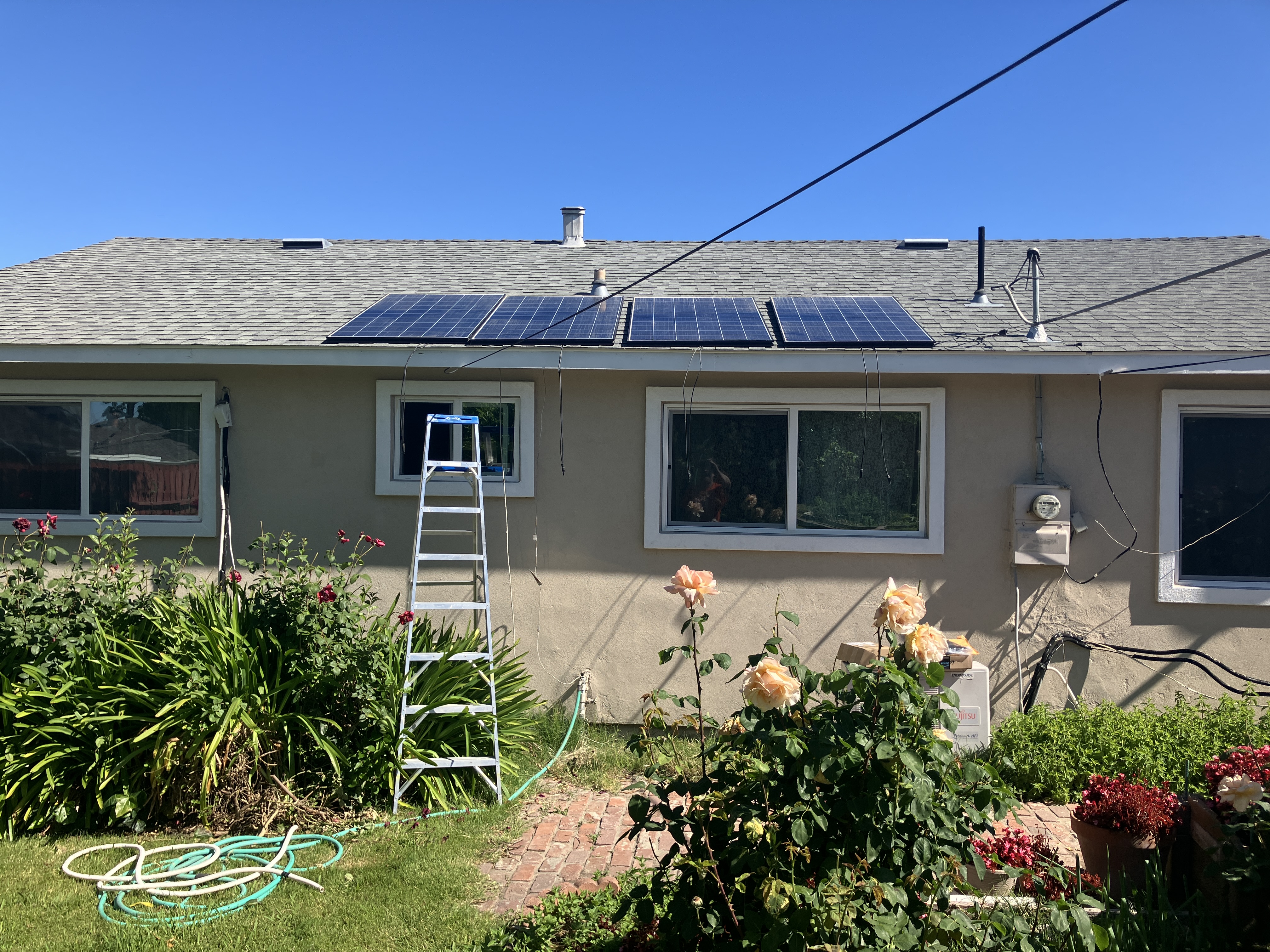

so this morning I decided to hose off the ten 100 watt solar panels that make up Solar South
don't mind the free range organic cable installation, I am still chasing a potential bad connection

finally I see some being cleaned

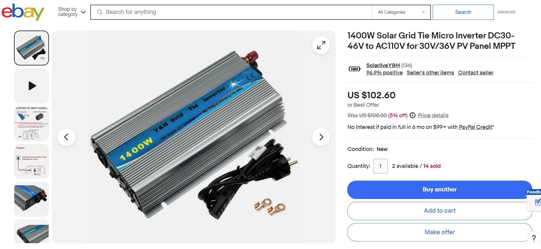

got her one of these 1400 grid tie inverters for a $100 bucks on eBay, no batteries required
