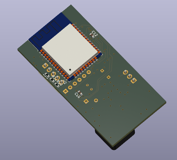

Not got as much done over the weekend as hoped but have managed to get the logic board finished:
The current filters are now set to 40kHz cutoff which gives a 10us phase delay. They won't do anything to attenuate PWM frequencies but should help reduce switching noise. The CT have been plugged in too and seem to work ok, yet to pug it into the inverter though.
For anyone who is designing hardware to interface to the Gen3 Prius I've also figured out how the current sensor interface should be done. The CTs actually use the +5V rail to provide their 0A reference (the output is +5V at 0A). If the CT output is just divided down to suit the ADC input range you get offset errors as both the +5V rail and 3V3 rails move (only regulators, not precision references so will move around with temperature and load). A better way to do it would be to use a diff amp (supplied from -5V and +26v) to provide a level shift function from the 5V input offset to a virtual earth generated from half the 3V3 rail. The diff amp can also include a bit of LP filtering. Done this way there will be no 0A shift as the rails move and it would probably be possible to get rid of the offset compensation block in the firmware.
Just wishing I'd clicked sooner. It's too late for this board but if there is ever a V2 I'll move to a proper diff amp then.

Good point on the WiFi although I'm not planning on using it much. The module will be there mainly to do SD card logging but I plan to have the WiFi disabled unless it's actually being used, it is also located remotely from the inverter connected on a RS485 link so will not be pulling power from the logic board. I tend to go a bit overboard on power supplies and rail decoupling so hoping not to have too many many problems with load changes.

Regarding the WiFi and your mention on RS485. Are you planning to have the WiFi module outside of the inverter and communicating with it using RS485-bus? Could you share your control chip used and how it is powered? I think it is a good idea to have the possibility to turn off the WiFi and having it externaly is even better. Just plug it in if needed.

The external ESP board is now all routed. Decided not to bother with a box so no mounting holes as it's only 30x60mm. It will just be covered in heatshrink instead. The battery is soldered rather than replaceable now as calcs showed it should last over 10 years. Revised schema and PCB views below.
Once I know it works I'll stick the design files up on github.
Re: Smart Roadster (with Prius Gen3 Inverter and Outlander Rear Motor)
Posted: Tue Feb 07, 2023 6:27 pm
by Ev8
Wish I had half of the kicad skills you have Pete, I’m ok with schematics but once I start having to find missing footprints ect I get bored and give up!
Posted: Tue Feb 07, 2023 7:04 pm
by Pete9008
It's just takes practise - I've spent too much time over the years doing PCBs. Kicad is amazingly good for an open source package, I'd say it's easily better than many commercial packages and getting close to some of the best. So far I haven't had the latest version crash either (not sure whether that's due to the version change or the fact I switched from Windows to Linux at the same time).
I know what you mean about footprints though (I'd rather go and find another part than have to create one from scratch) but I've found that the libraries that ship with Kicad are now pretty comprehensive. There is a good chance of finding the exact part and even if not there's likely to be something close enough that it's just tweaking rather than creating. Didn't have to do a single footprint for this board (although the SD card socket was chosen specifically because a Kicad part for it already existed!).
Got to say it's quite nice to be doing electronics as a hobby again rather than for a living!
