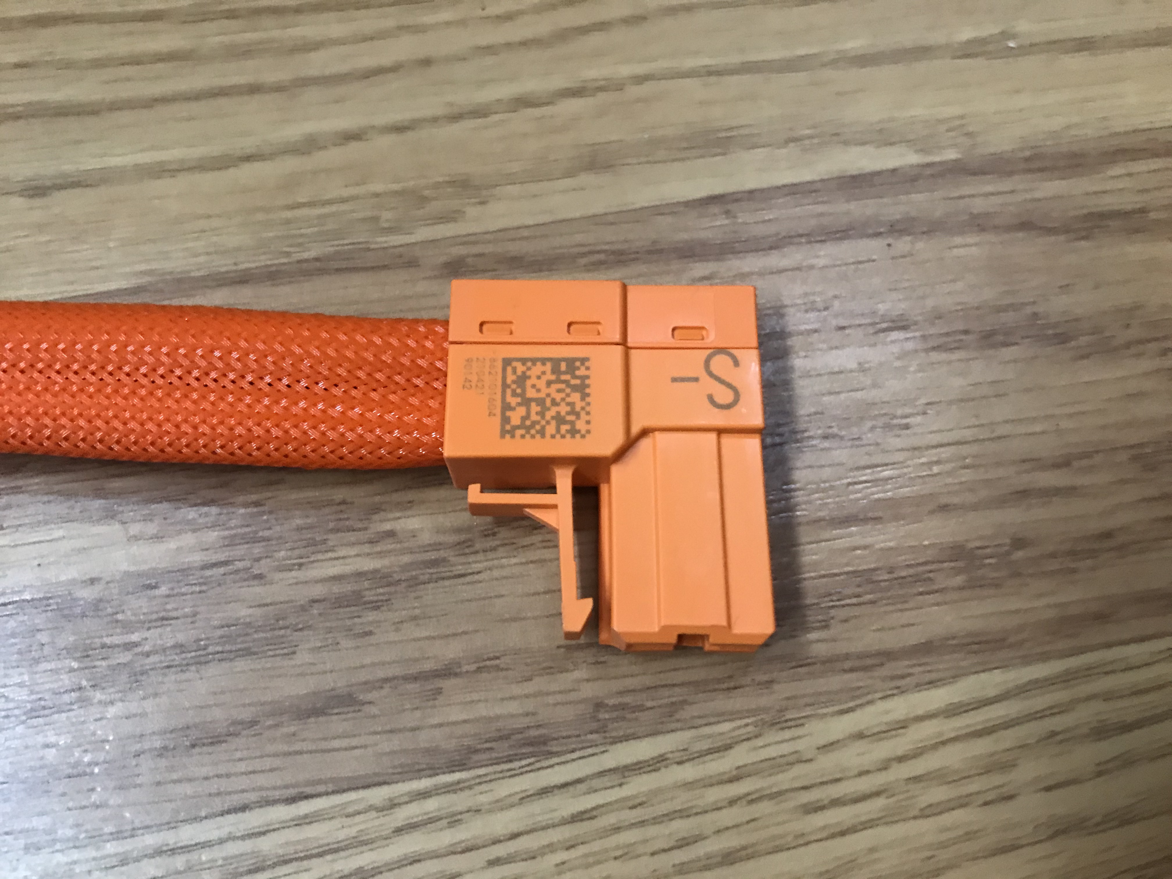

so I went out and bought some new battery cables, I bought two of the main negative lead cables, as they are the longest in the pack
bmwpartswholesale.com
Part Number: 61-27-8-621-016
Price: $58
Posted: Tue Jan 18, 2022 6:23 pm
by Gregski
the ends are keyed so they go in a certain way
Posted: Tue Jan 18, 2022 6:25 pm
by Gregski
I decided to pop one open to see how it was built, since I could feel that there were really two wires side by side in that orange mesh housing
