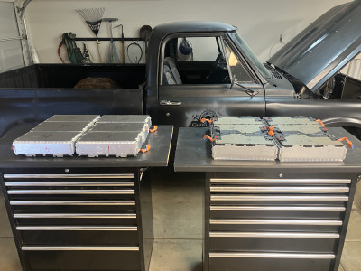

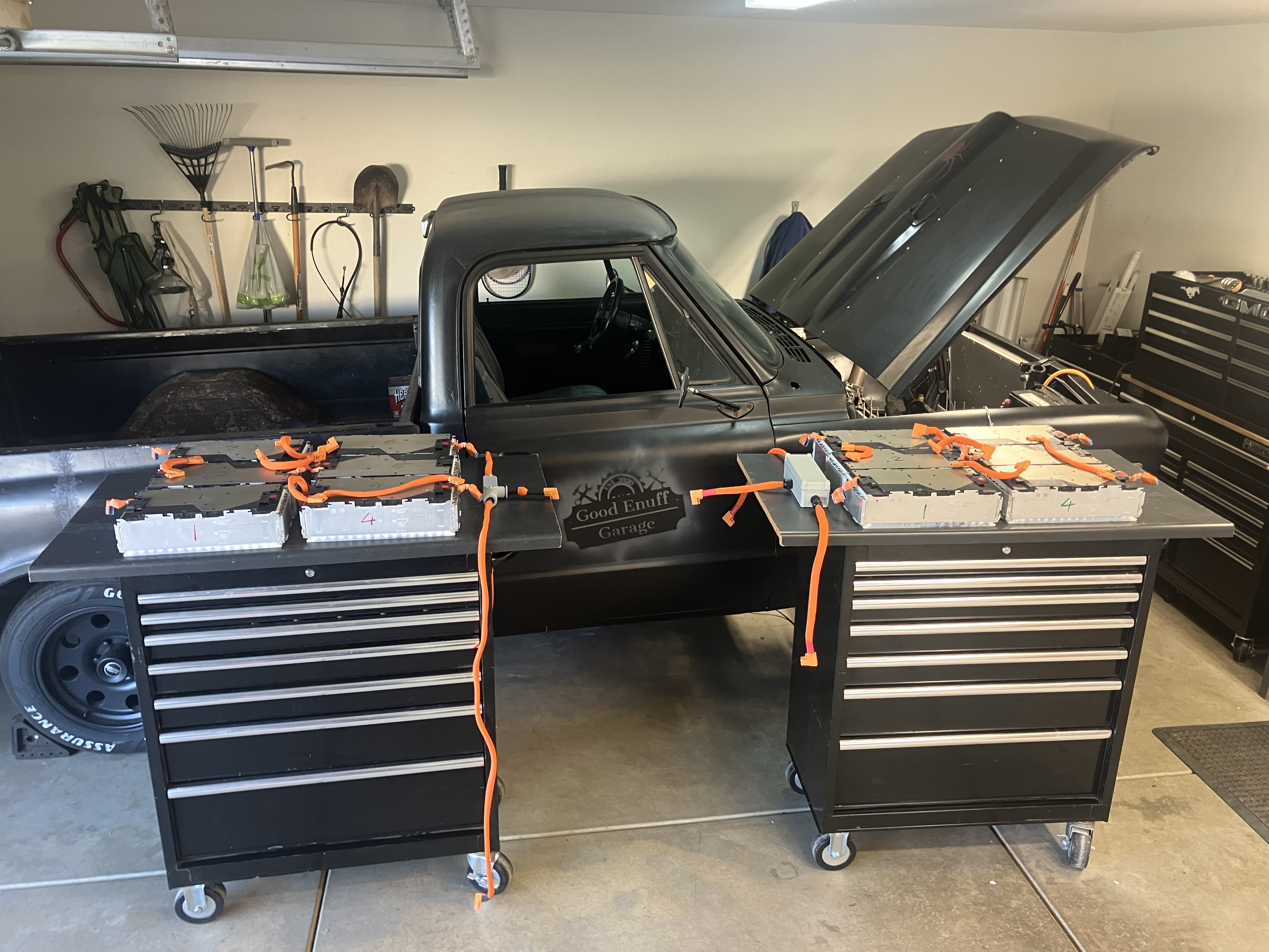

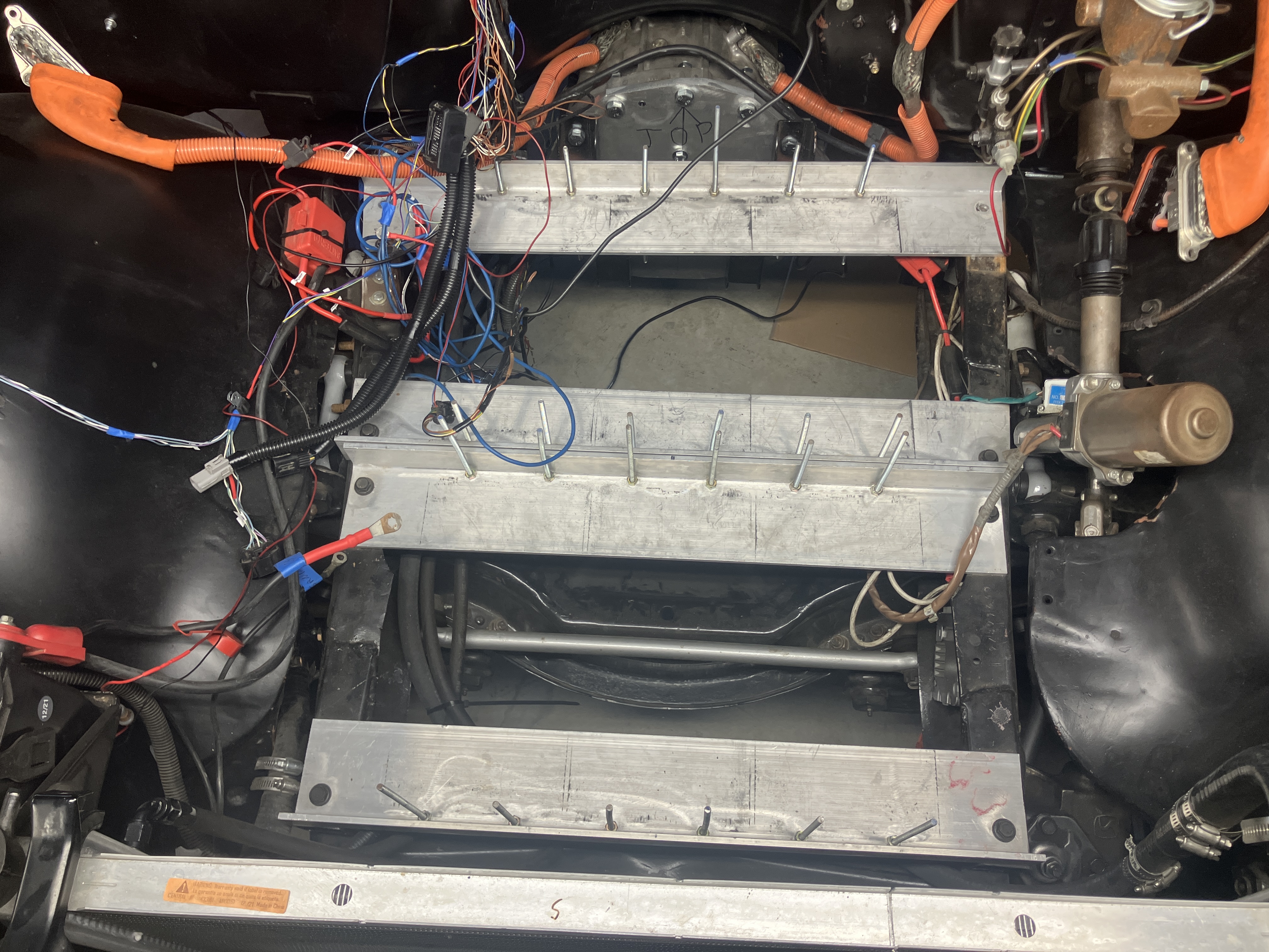

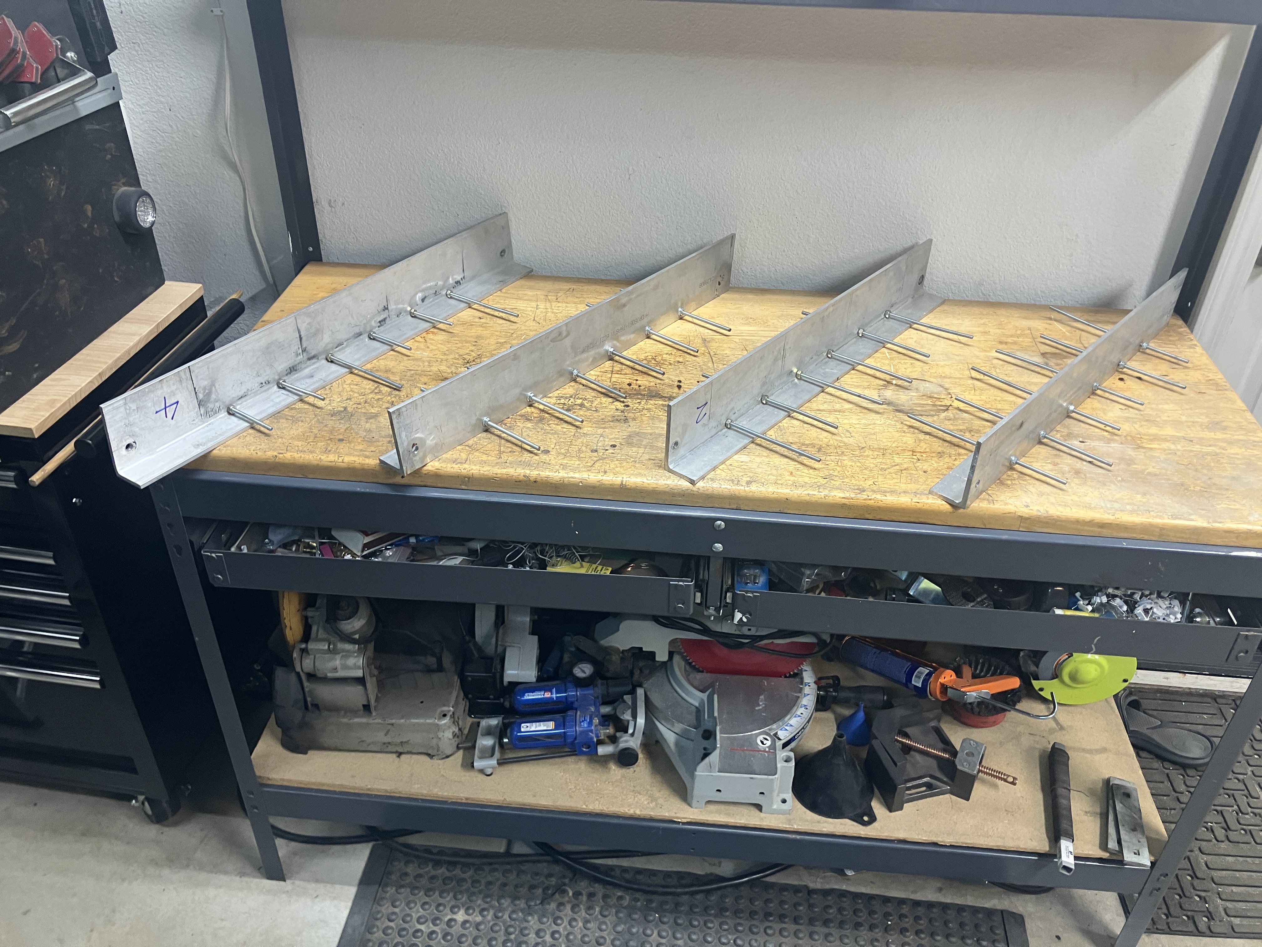

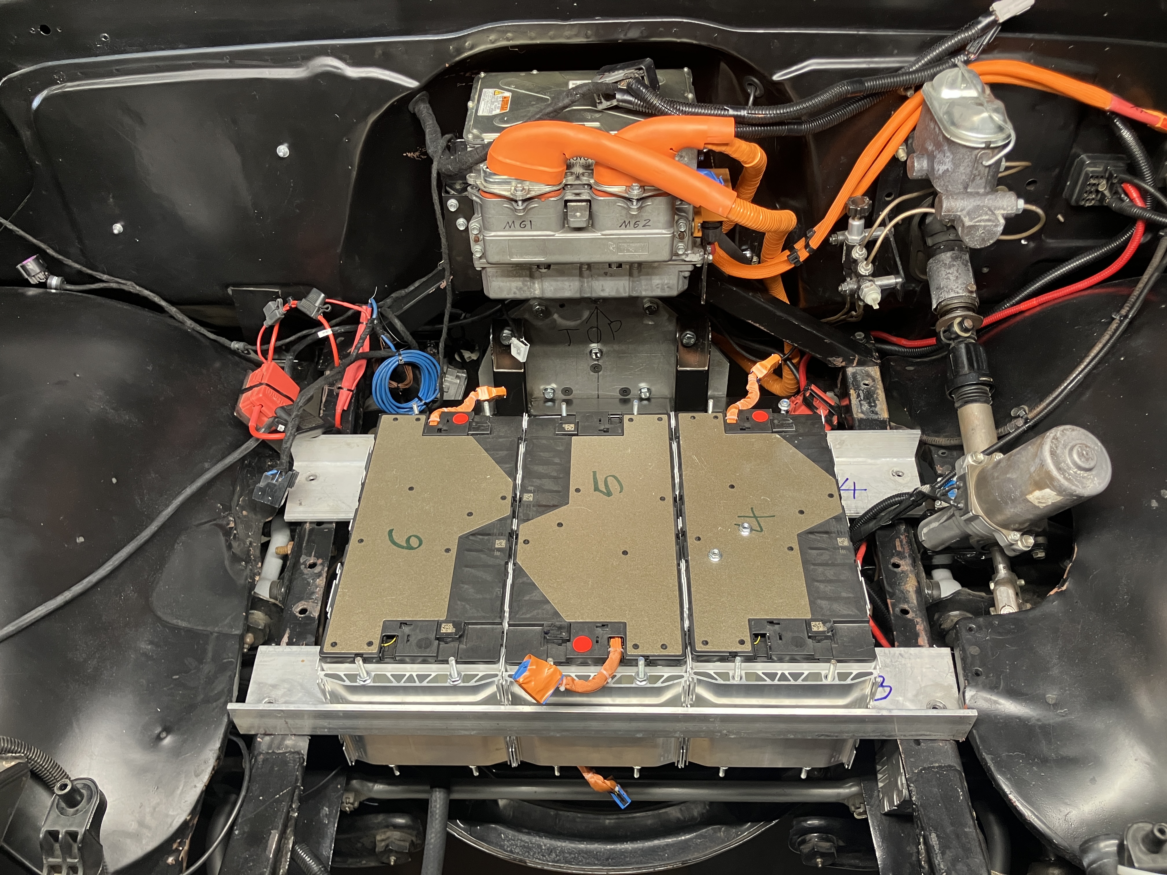

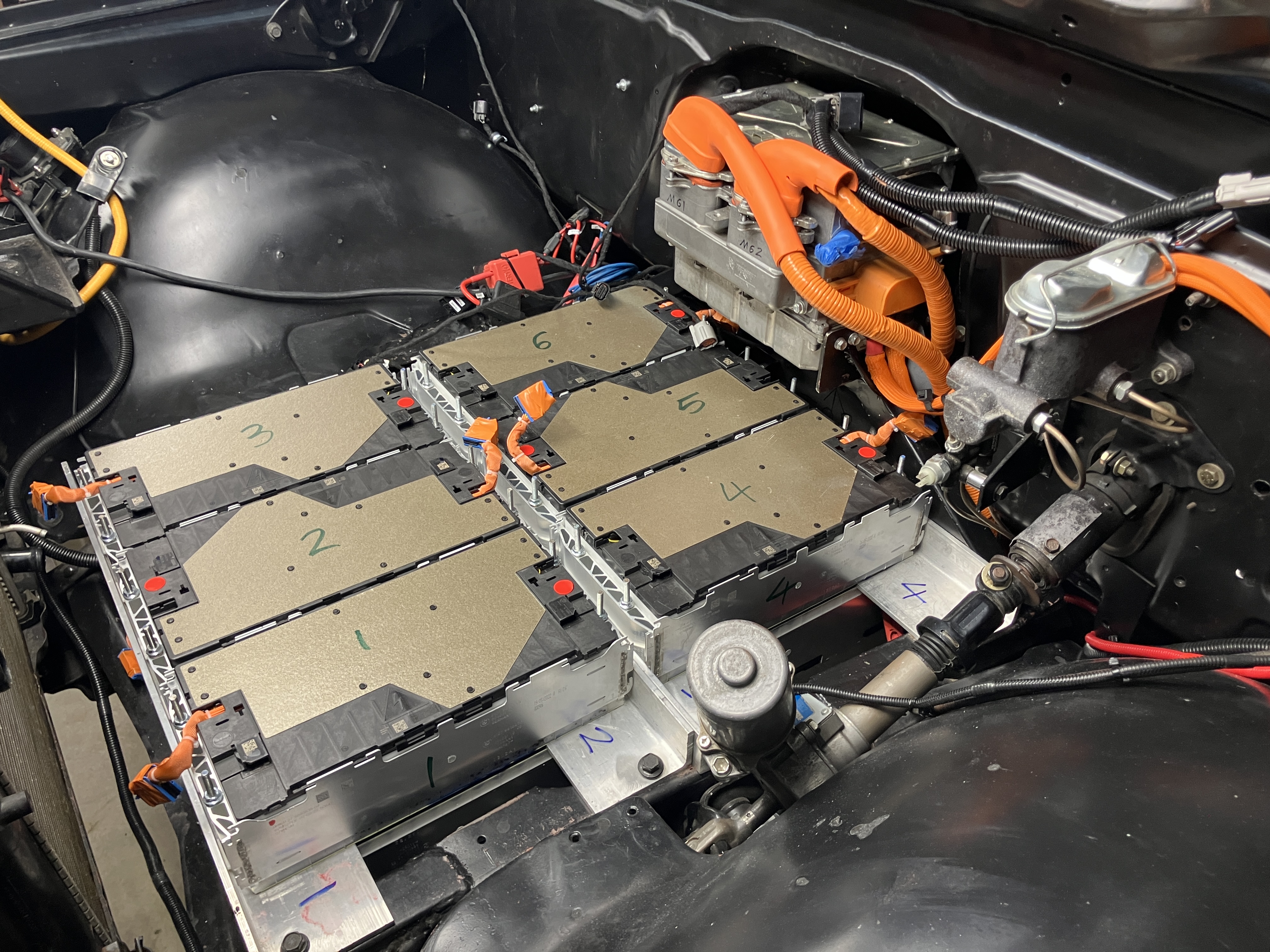

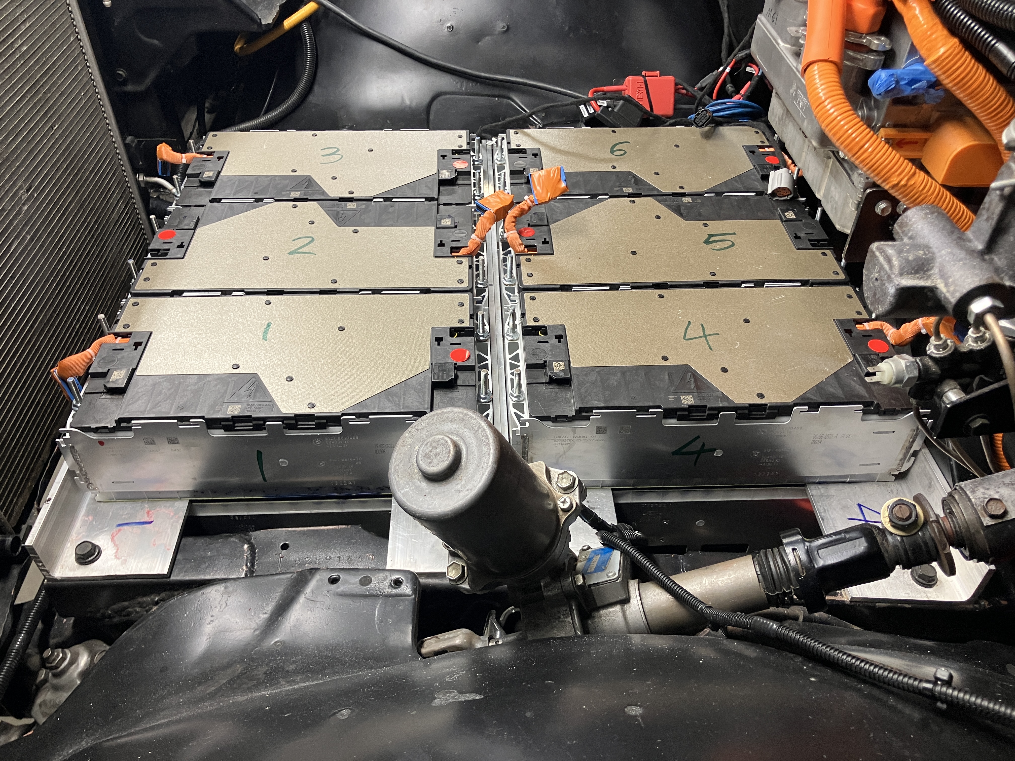

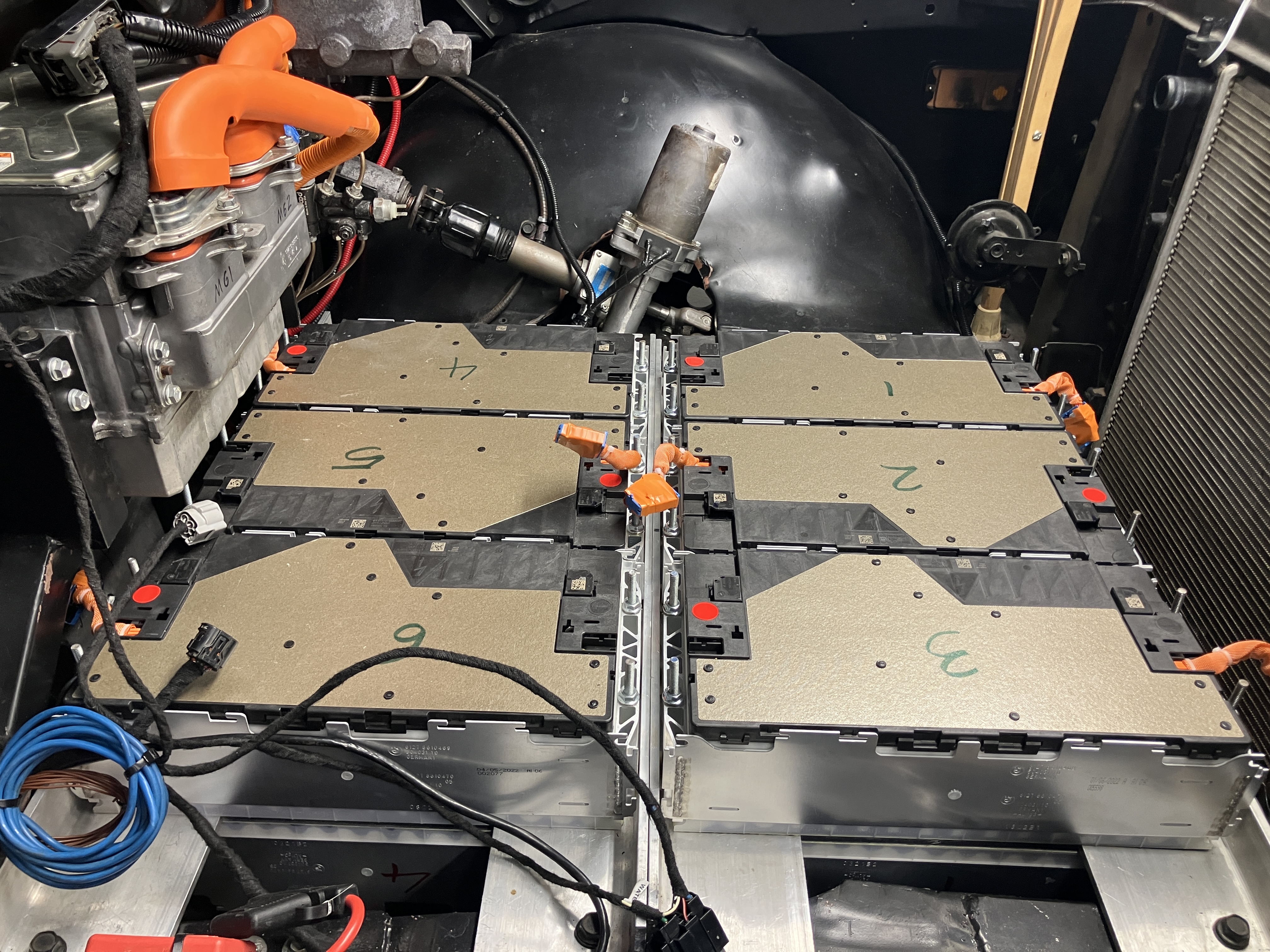

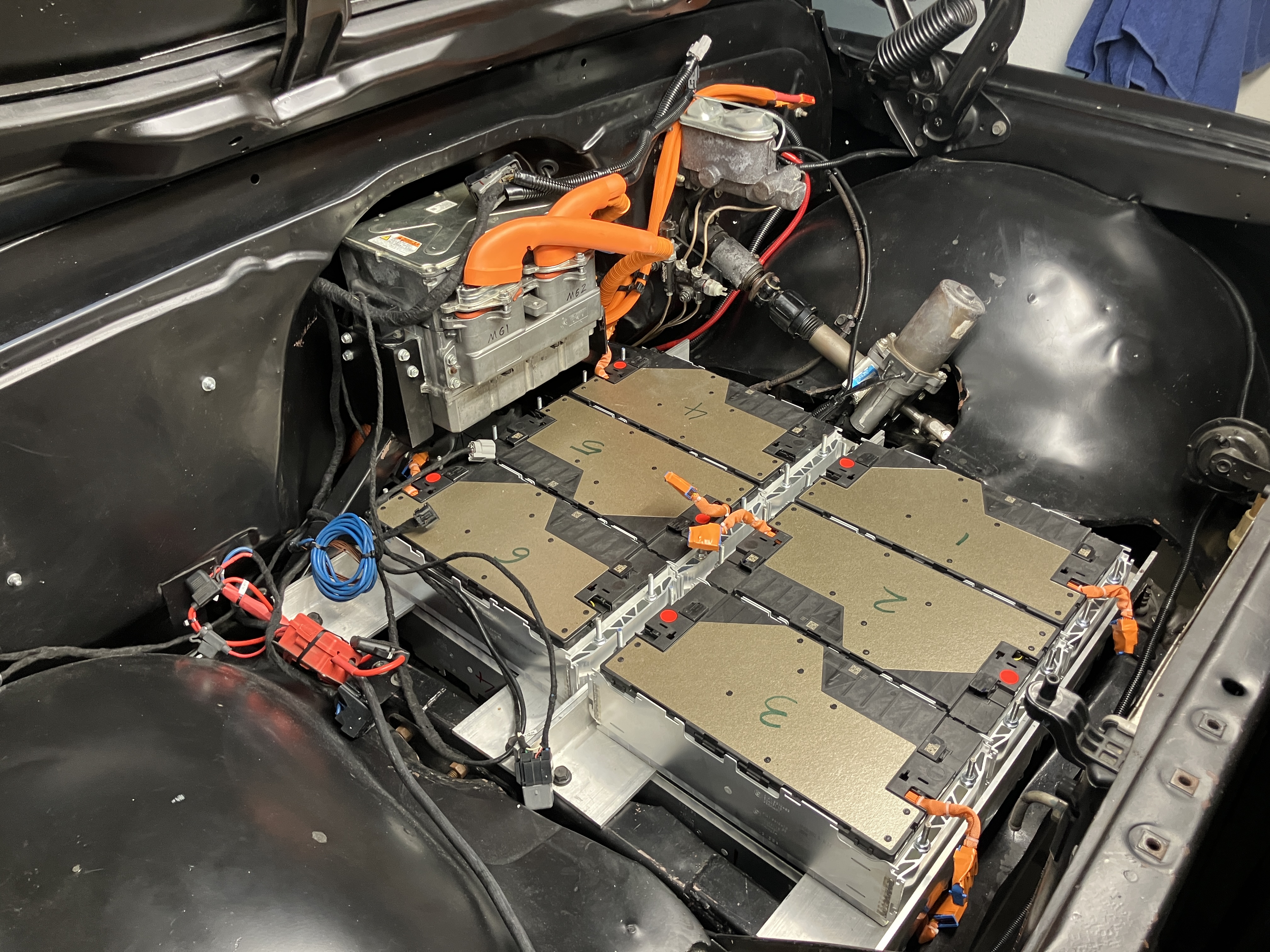

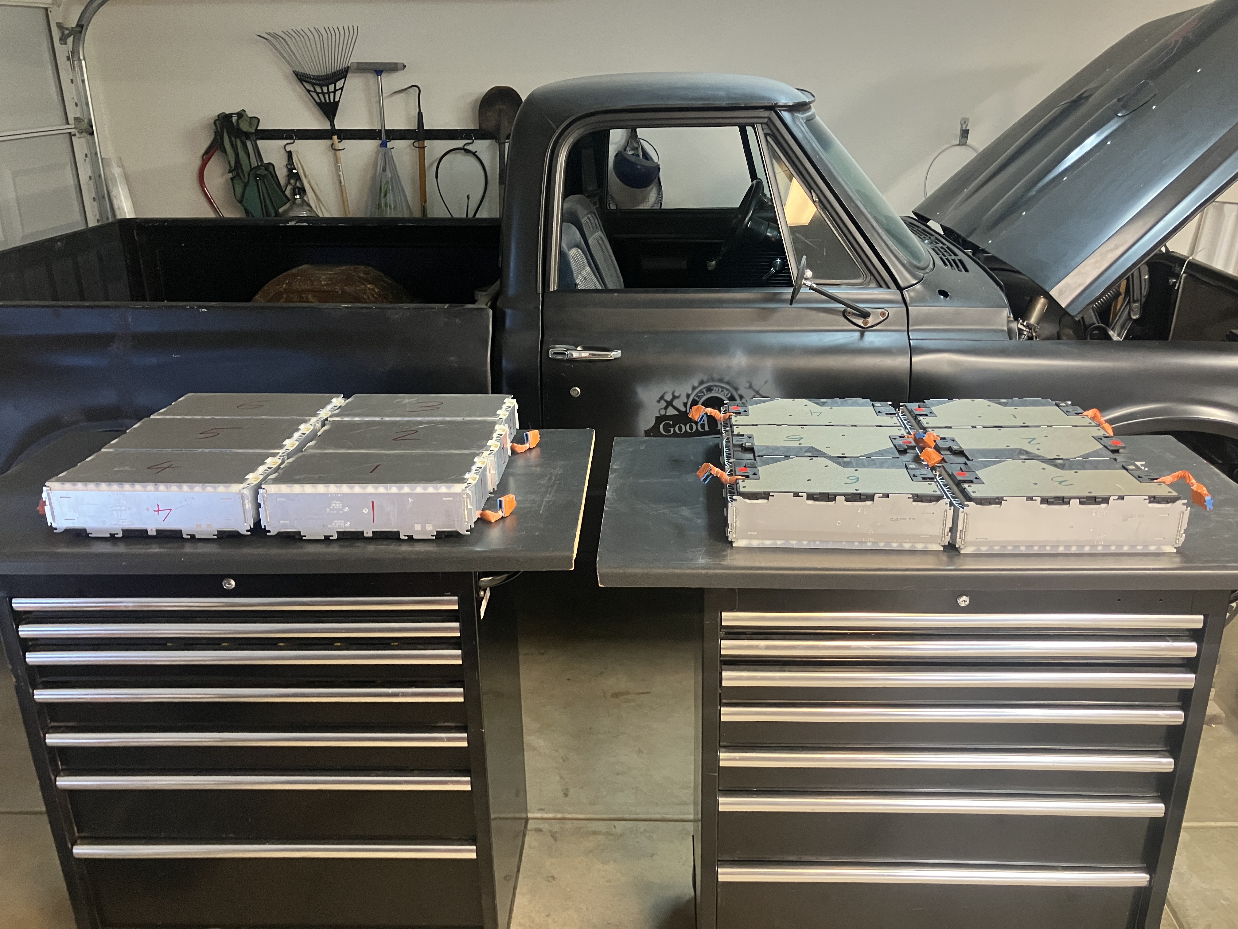

bigger 24 kWh BMW battery pack going in tonight, this should give me a range of just over 80 miles
modules arranged in installation formation
the patented porcupine design

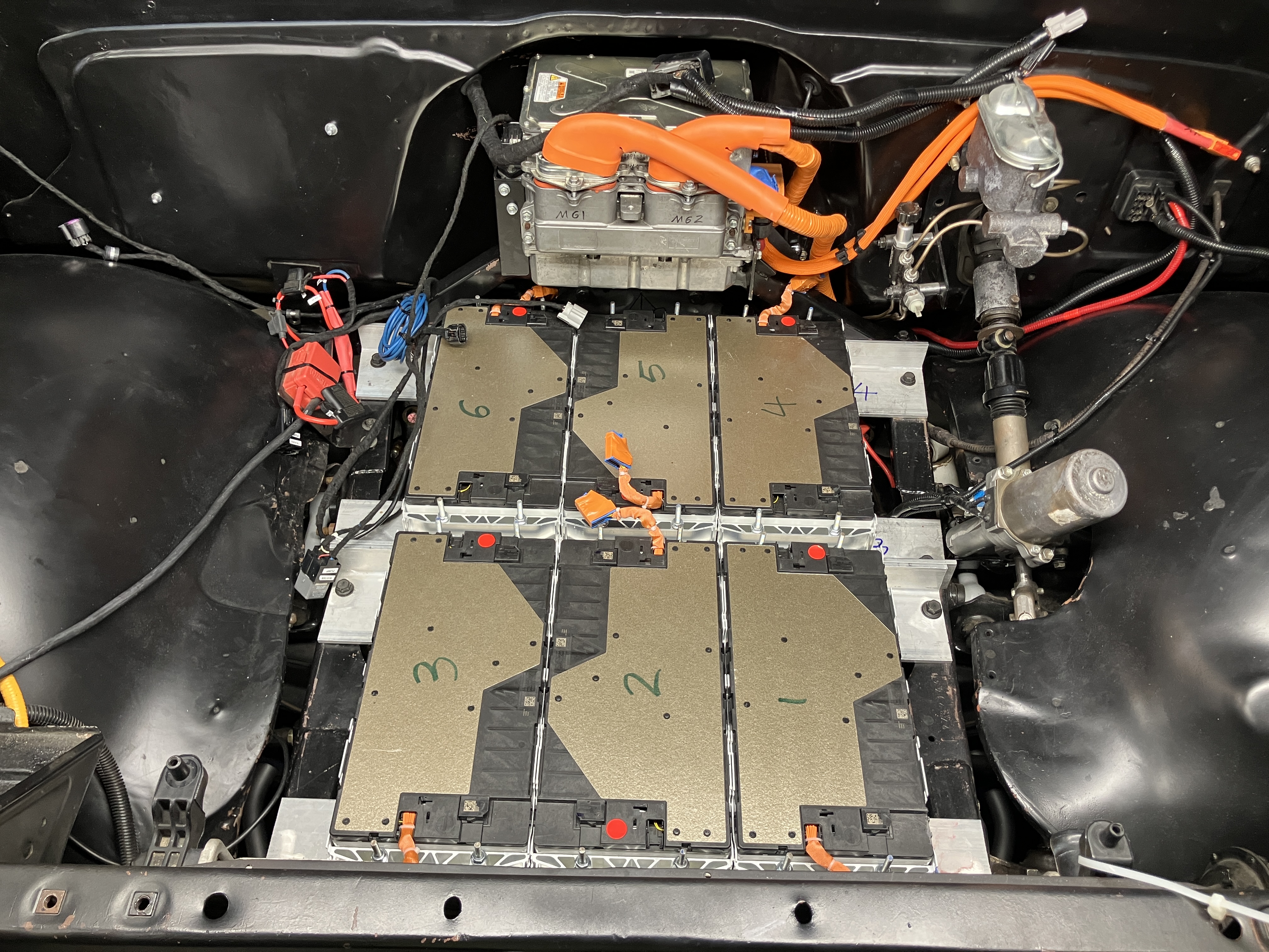

well then I saw this mess and I just couldn't let it go...
some time later.jpg (9.72 KiB) Viewed 5440 times

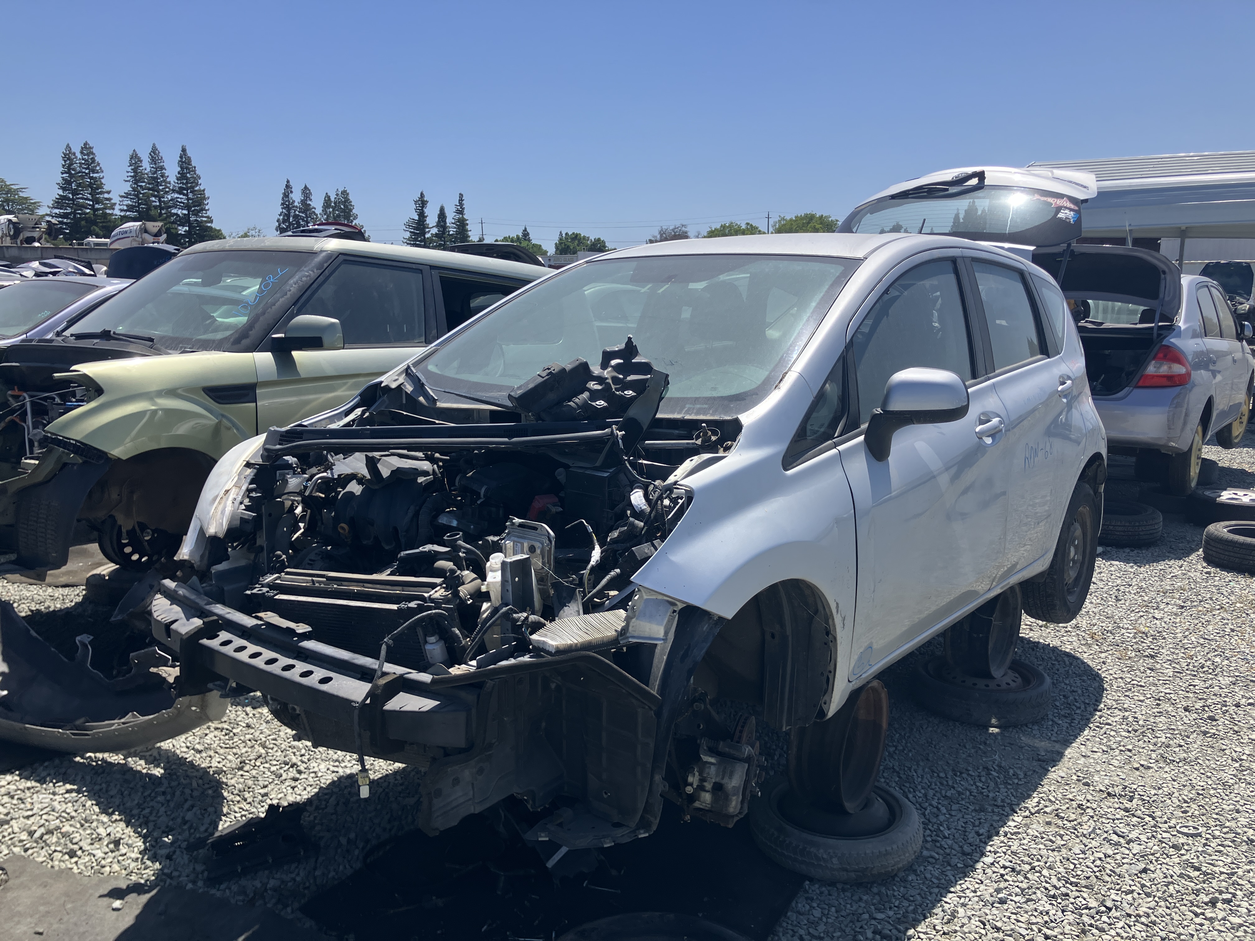

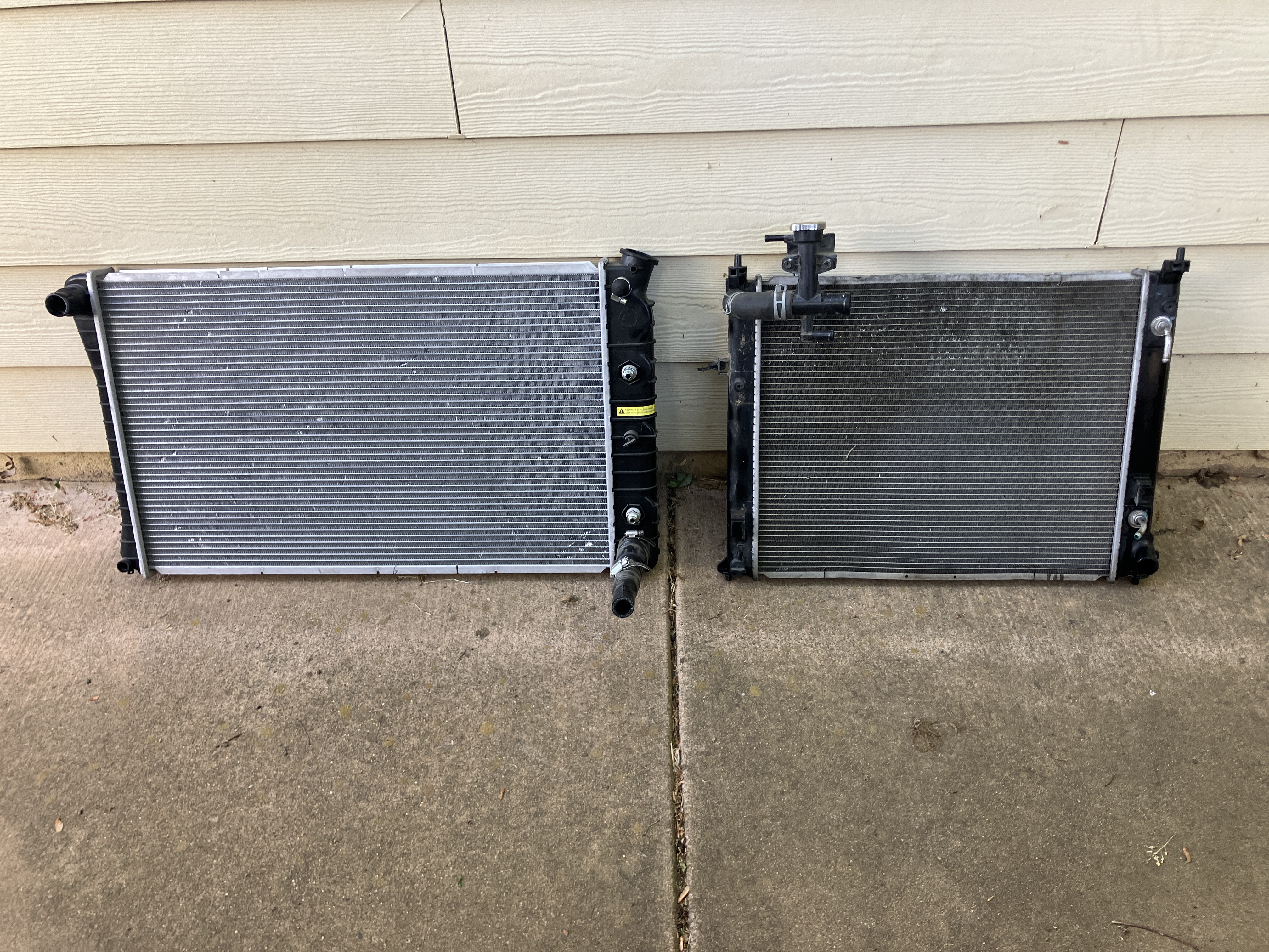

So now lemme tell you what I'm not supposed to tell you, the extra curriculars

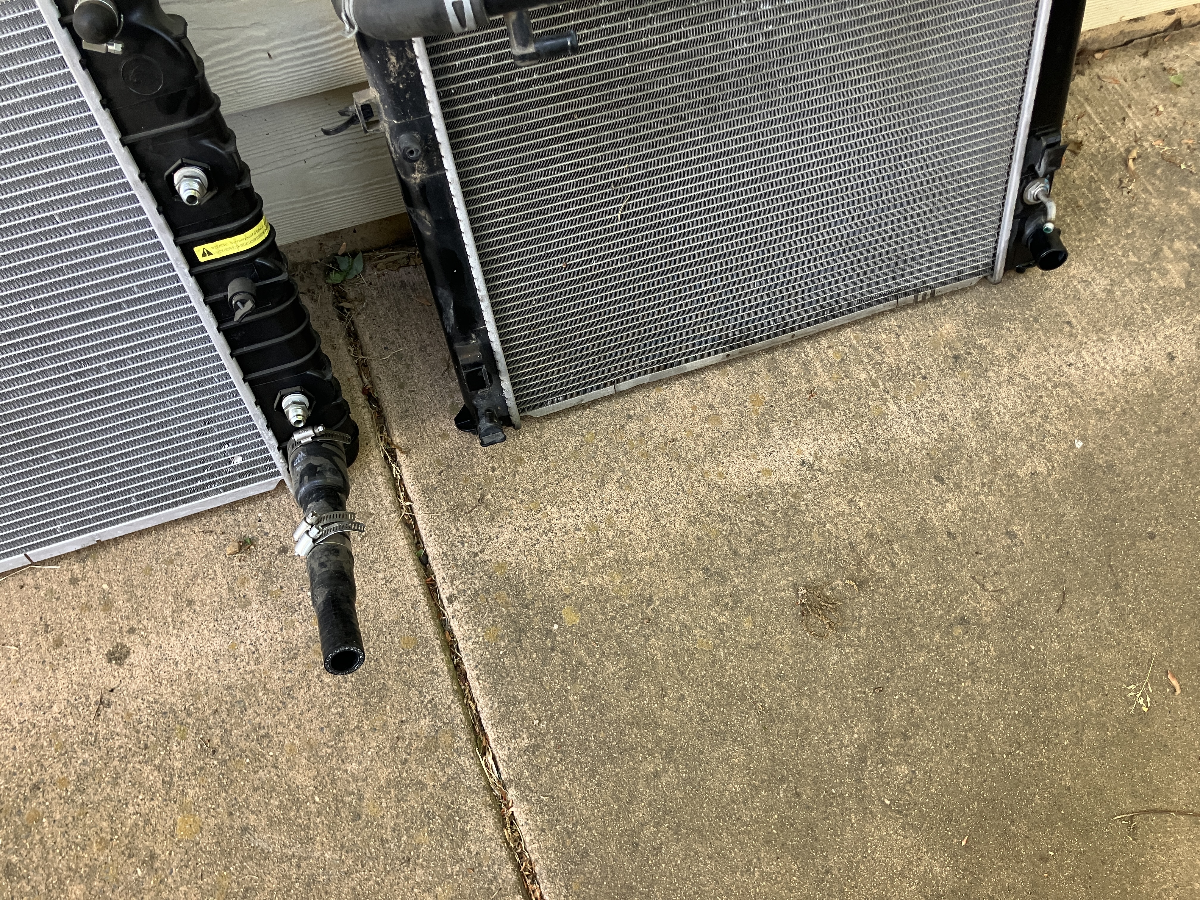

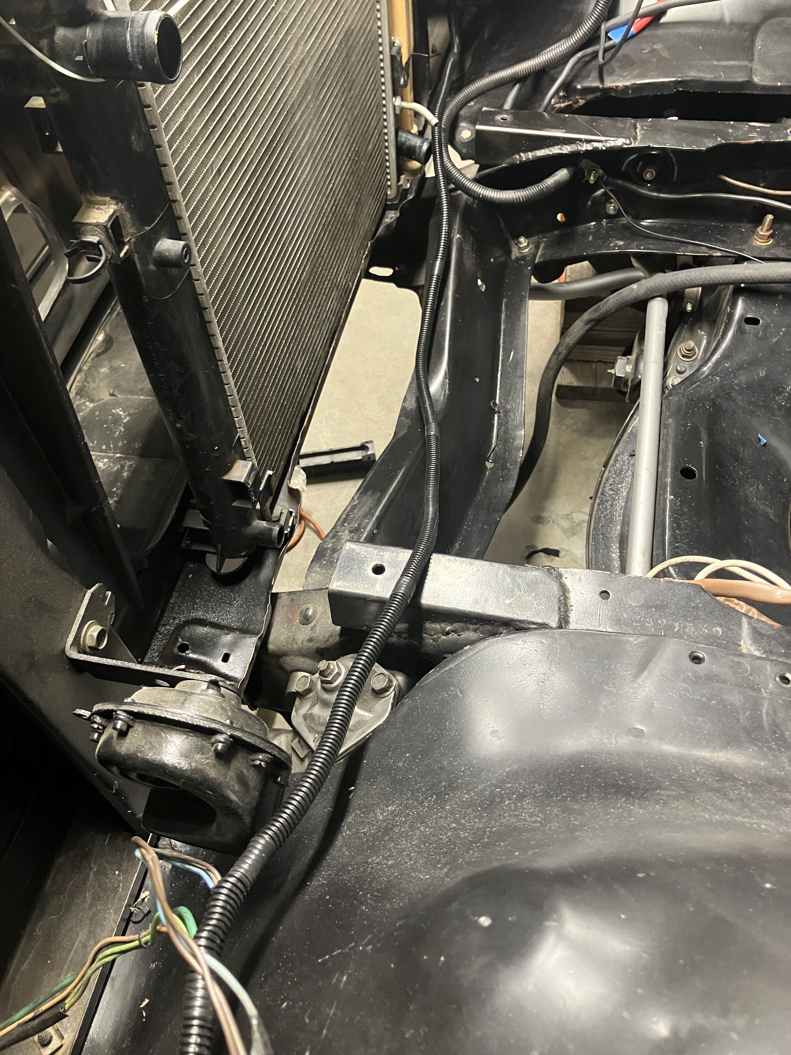

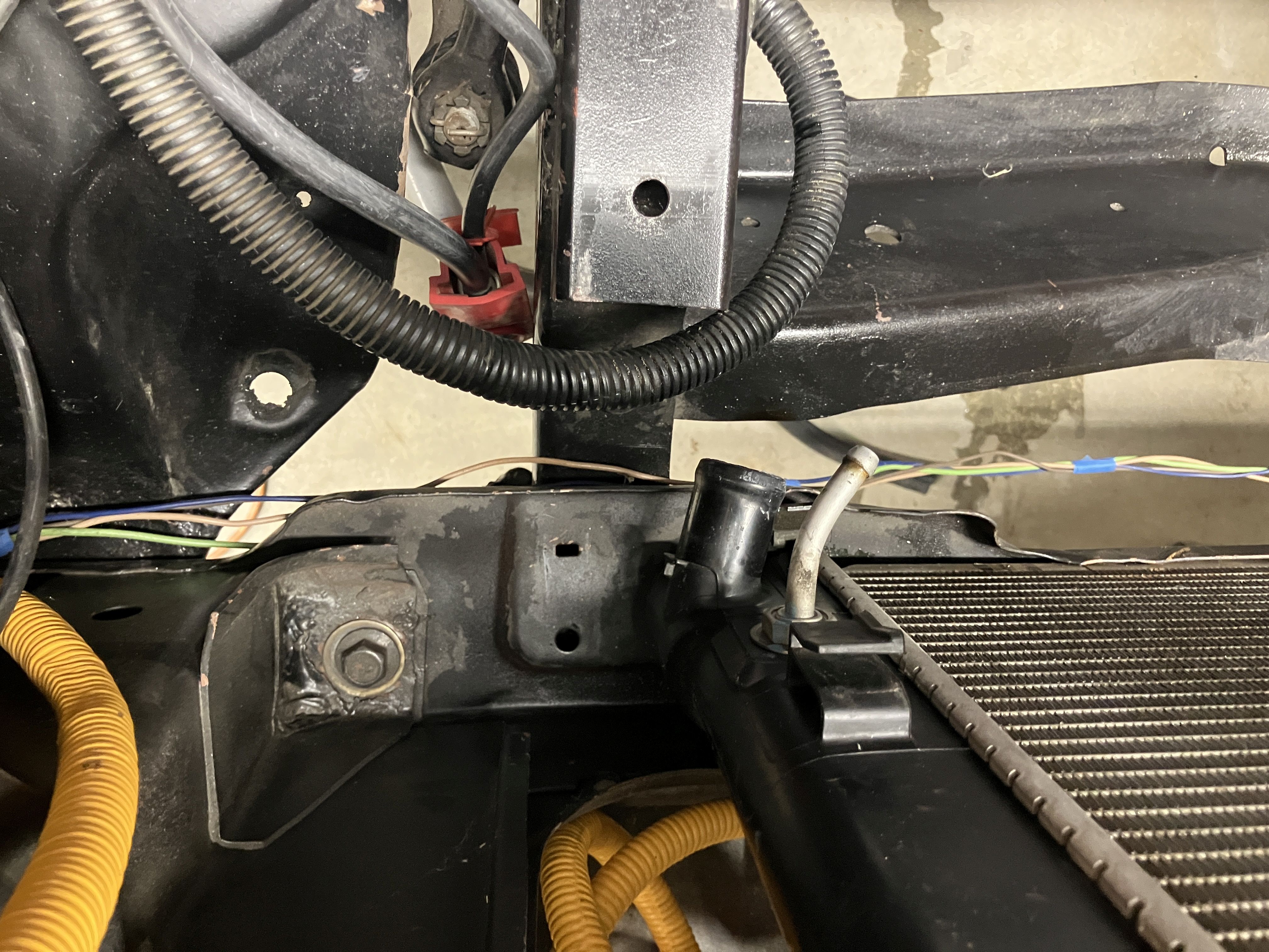

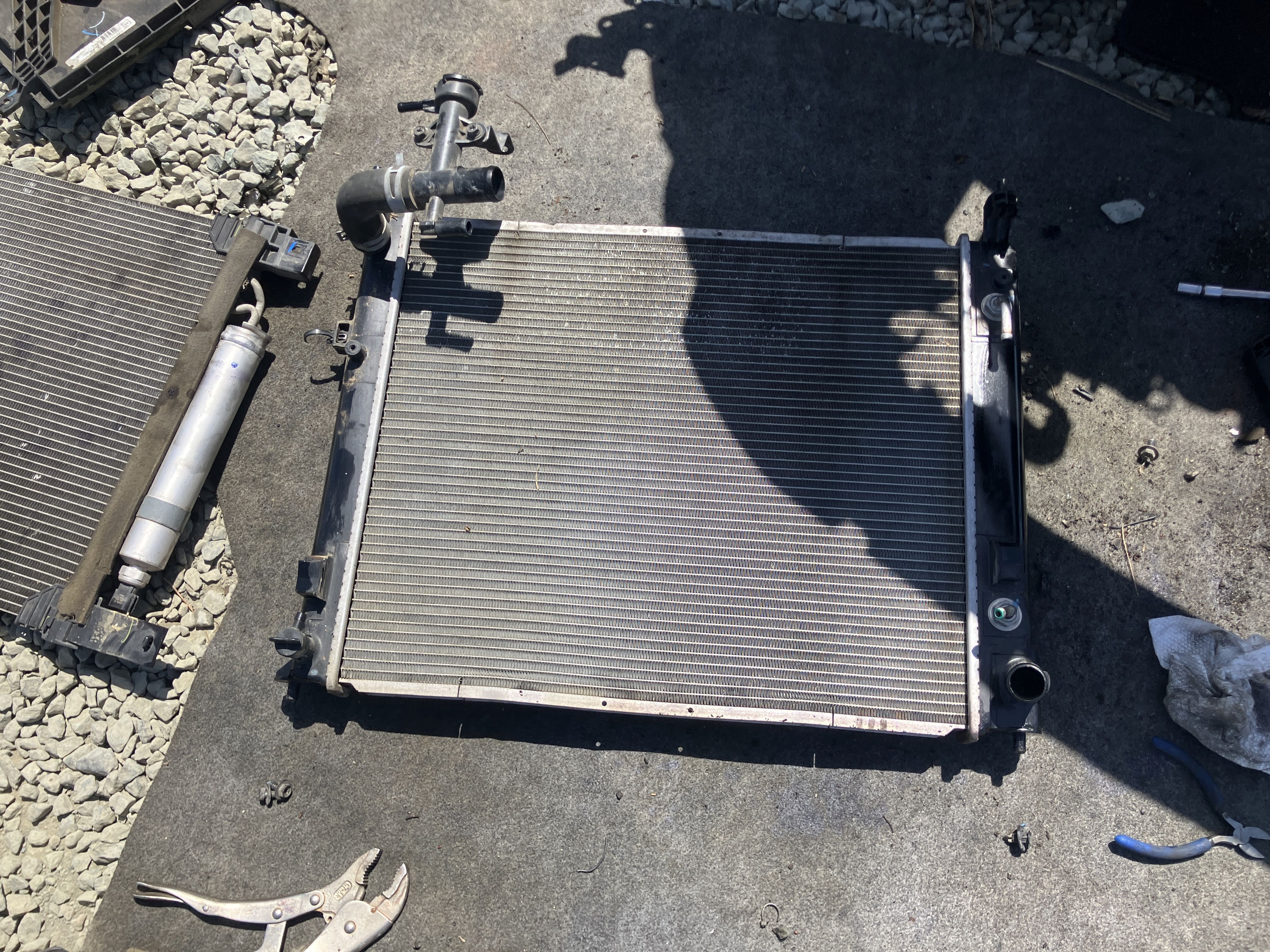

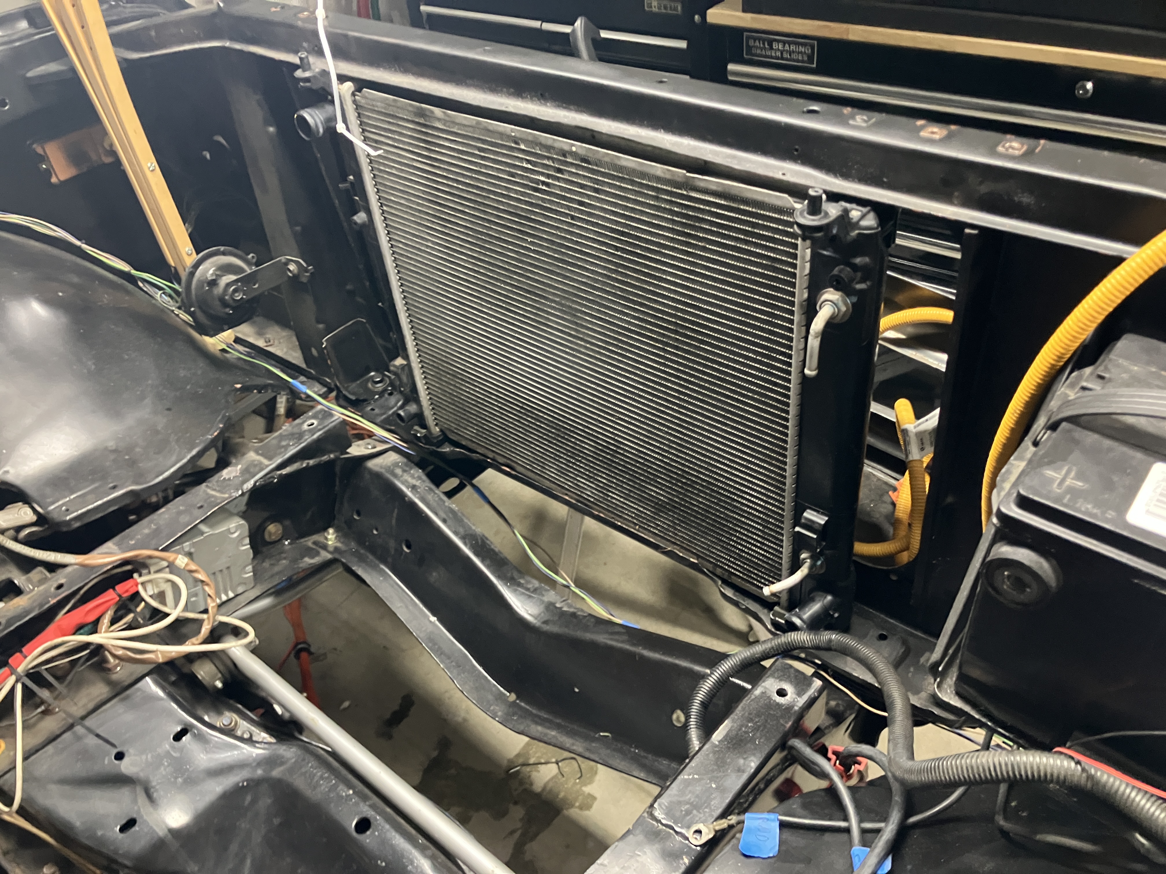

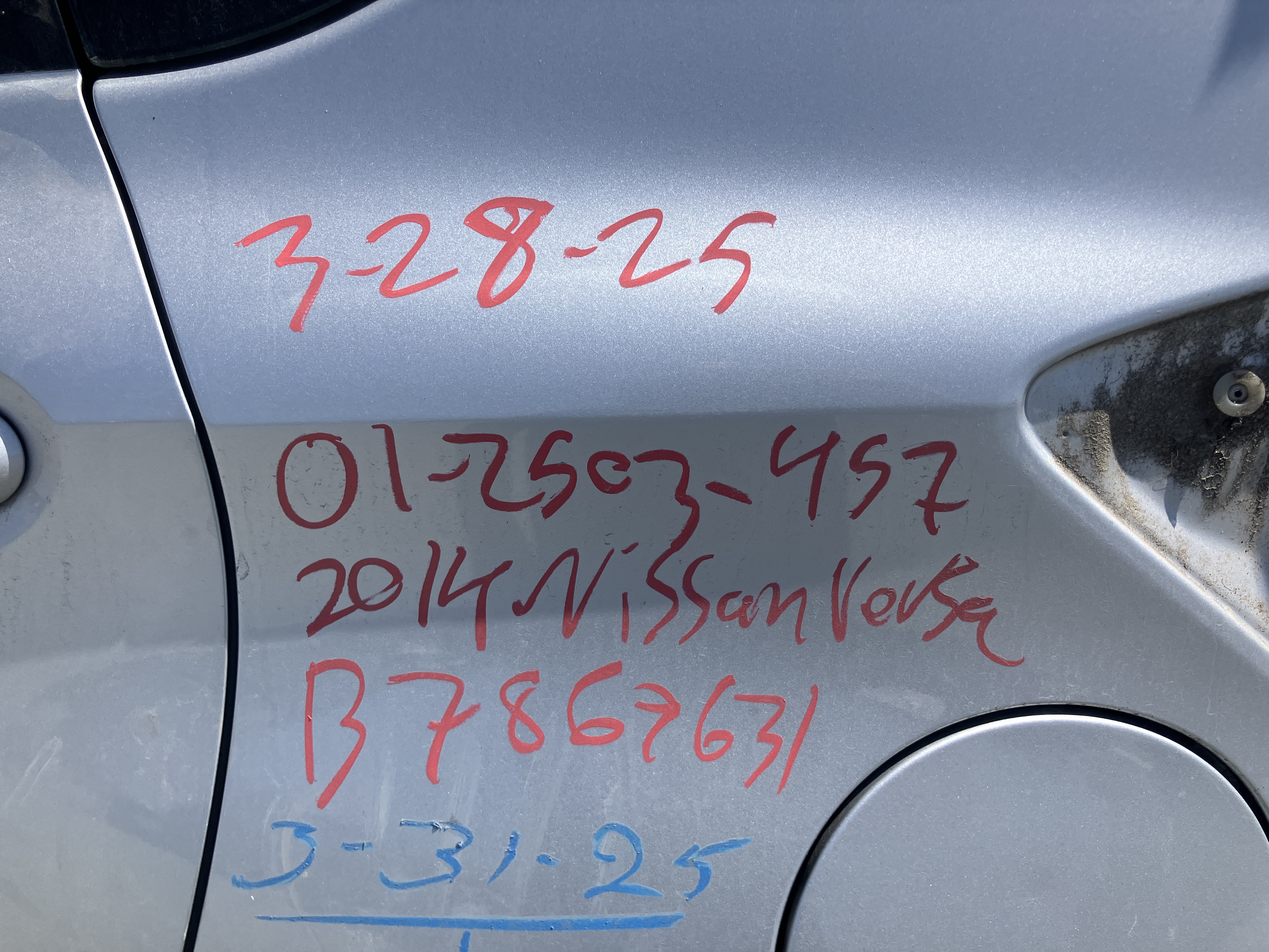

so it all started with me wanting to relocate the water pump which then led me to this, replacing the radiator, and I did this for a couple reasons, first I got tired or using many reducer hoses to step down from like 1 1/2 inches down to 3/4 for the Tesla water pump and even further down to 5/8ths for the inverter, and transmission
and the second reason was cause the darn bottom outlet port on my stock Chevy radiator headed straight for the passenger side frame rail, so I needed a narrower radiator, complements of this sexy 2014 Nissan Versa
Mandatory Stare 'n' Compare
the new Versa rad has only 1 1/8th inch inlet and outlet
all moched up
notice how the bottom outlet clears the frame rail now - Winning !

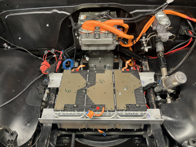

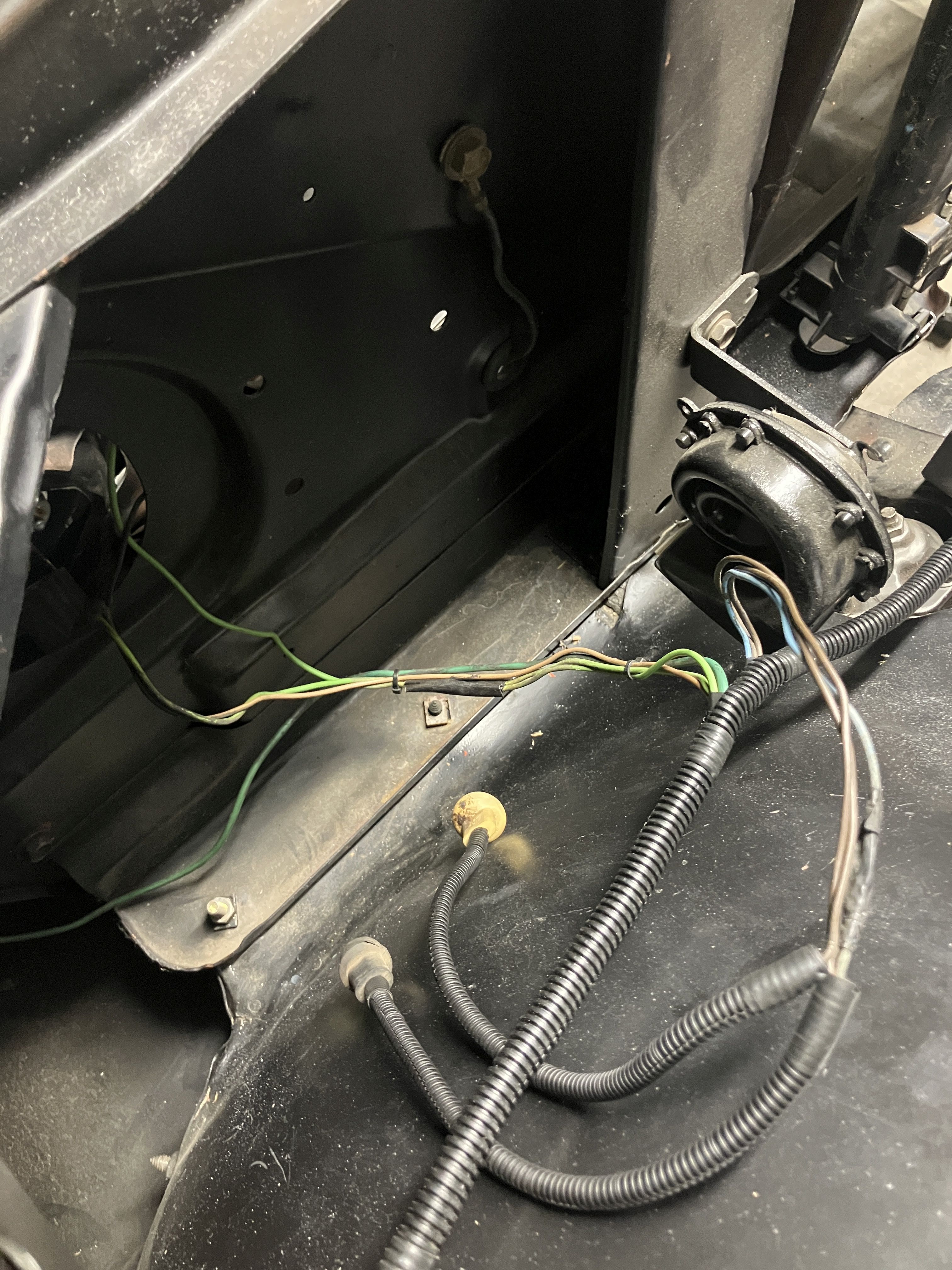

you all ever werk on your car and say ahhh I'll do that later, well looks like now it's later for the Greg and he is going around and a fixn' everything he should have done did right the first time
here I am finishing loomin' the OEM headlight wire harness, I swear once I run out of this corrugated split wire loom (pronounced: cheap crap) I am graduating to that sexy braided expendable wrap like all the cool kids be runnin'
Gregski
Posts: 3157
Has thanked: 628 times
Been thanked: 1606 times

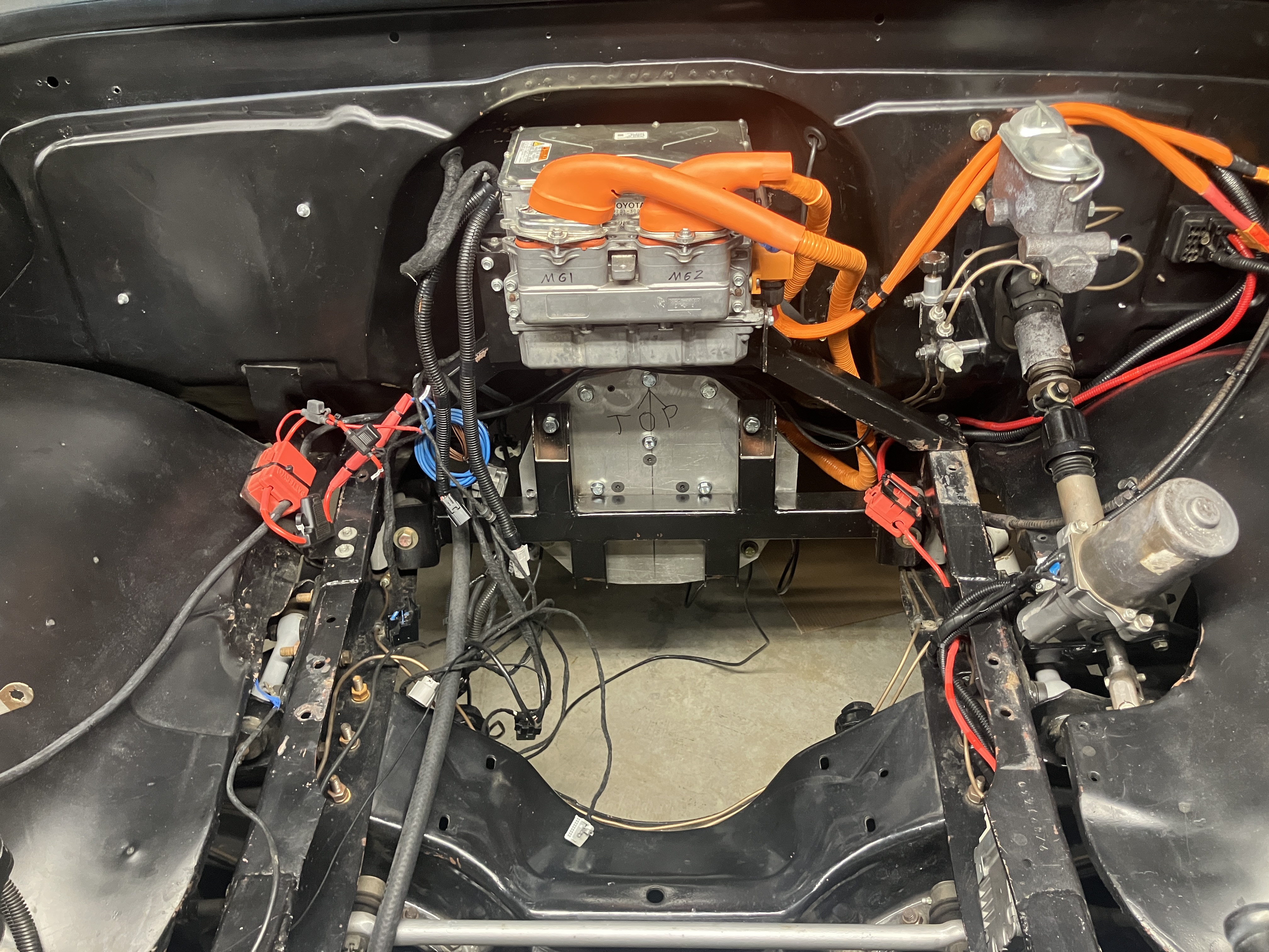

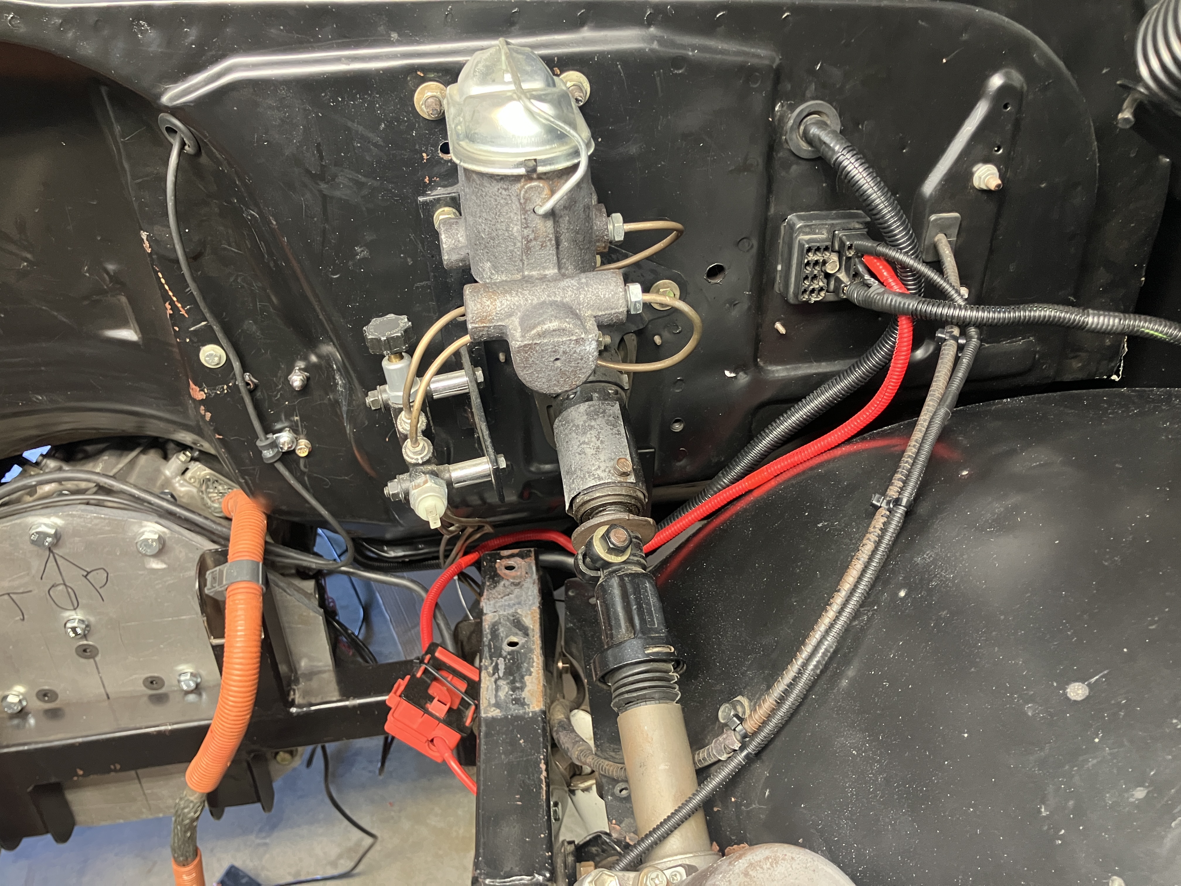

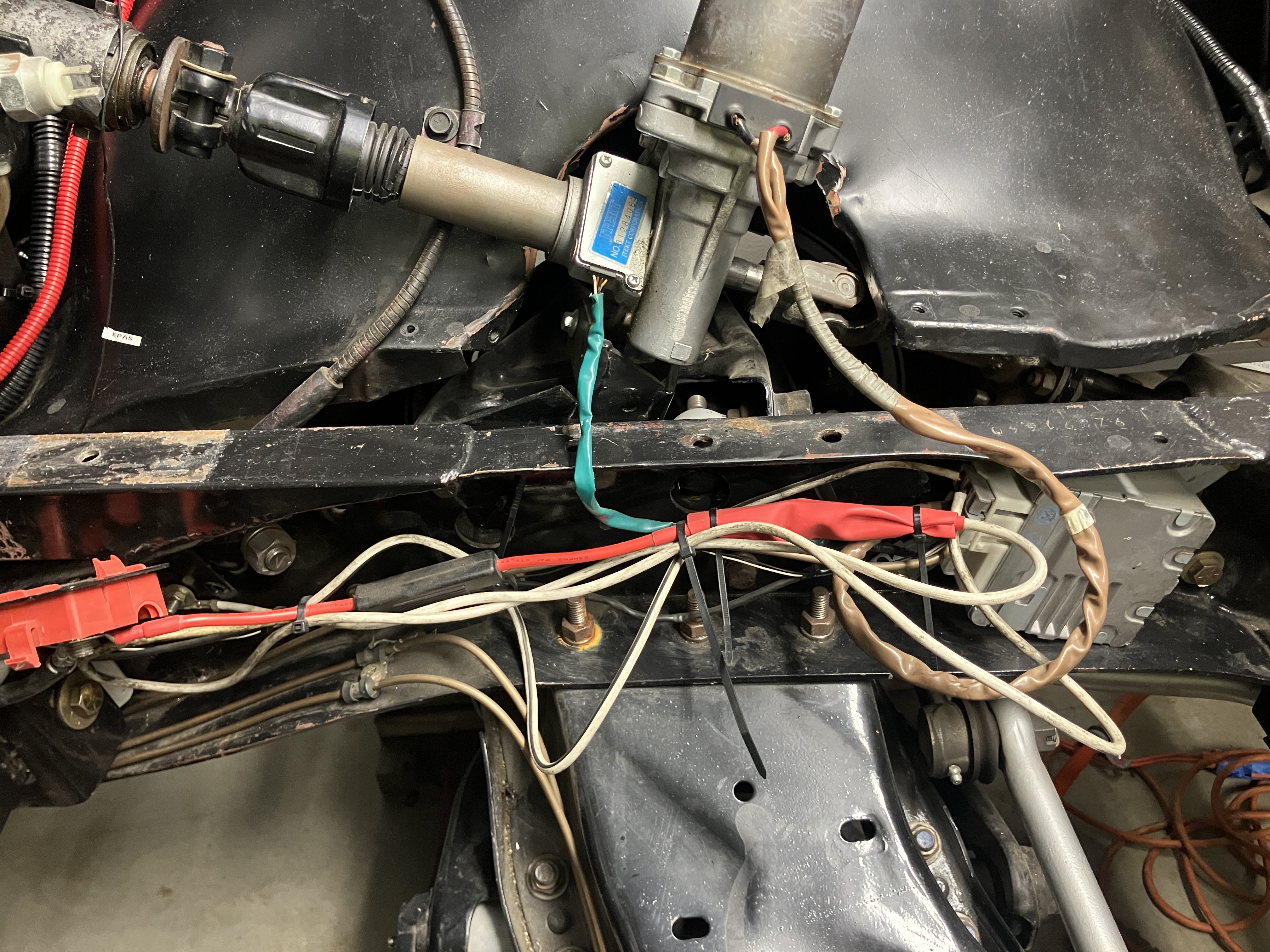

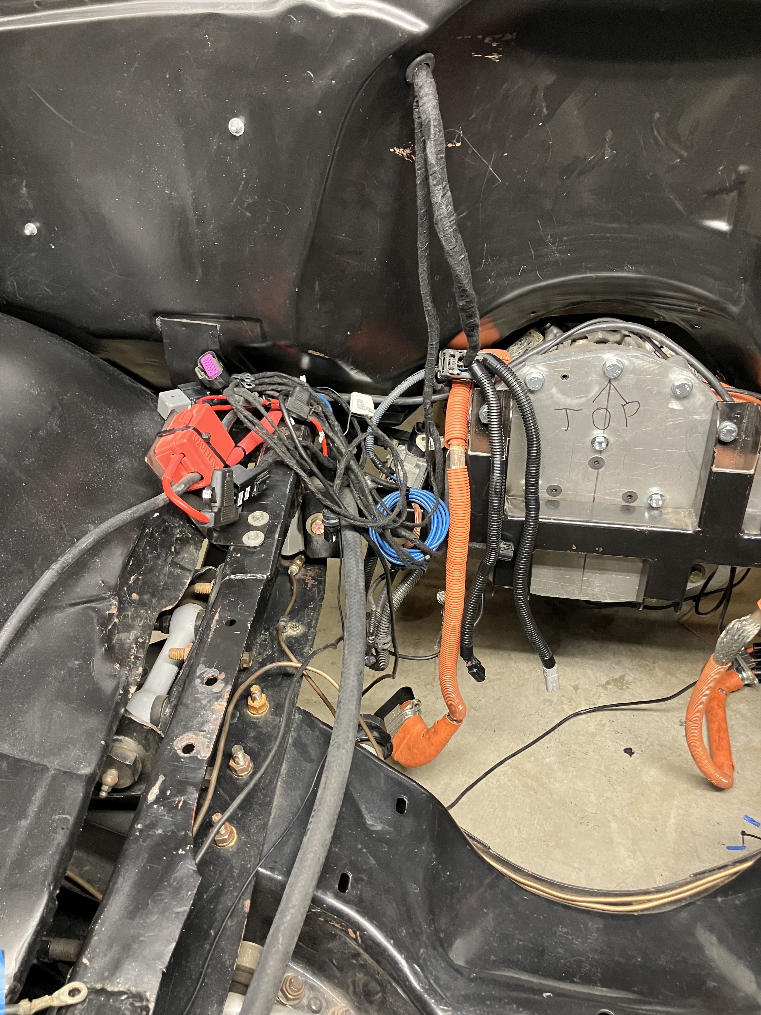

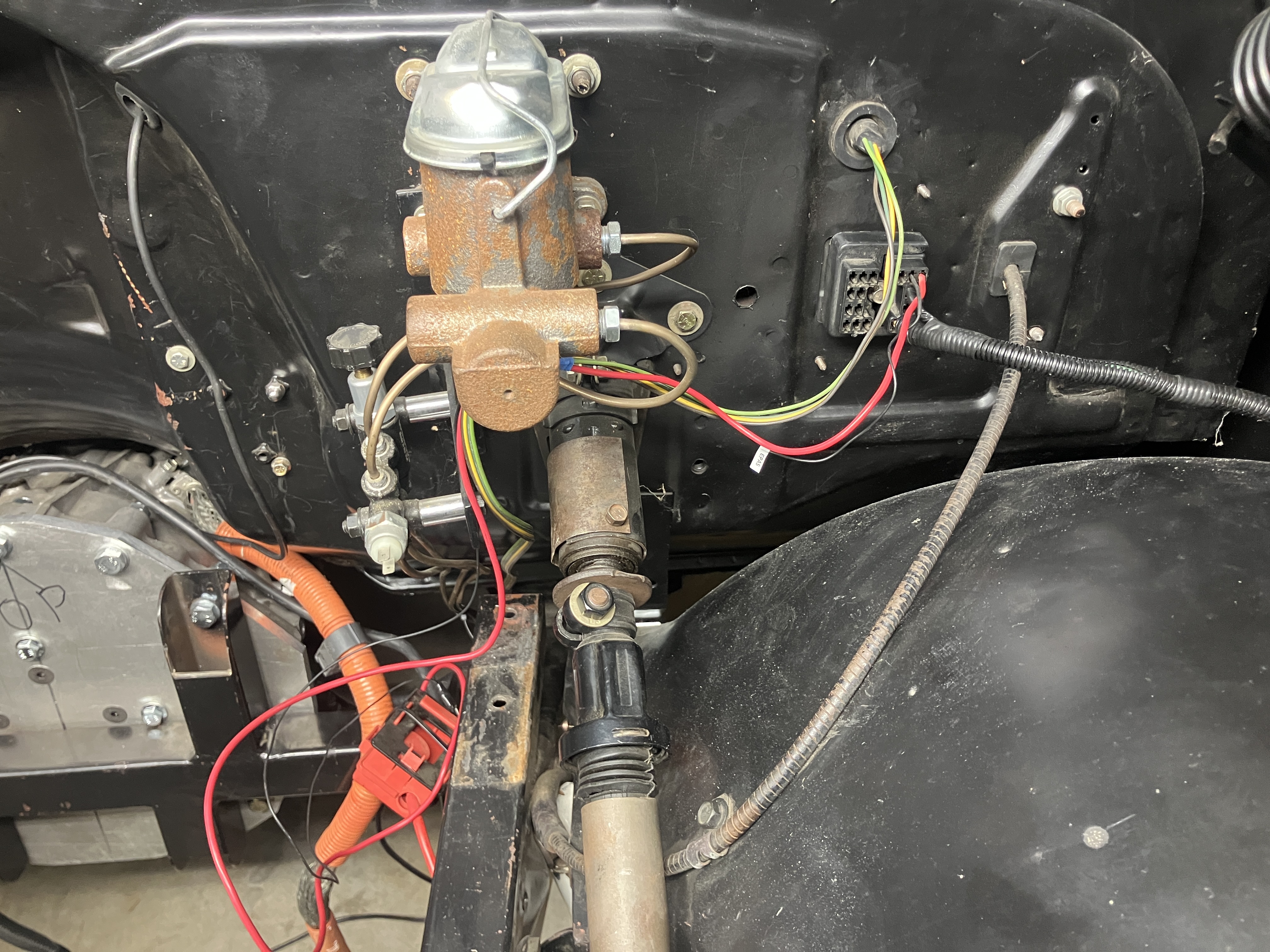

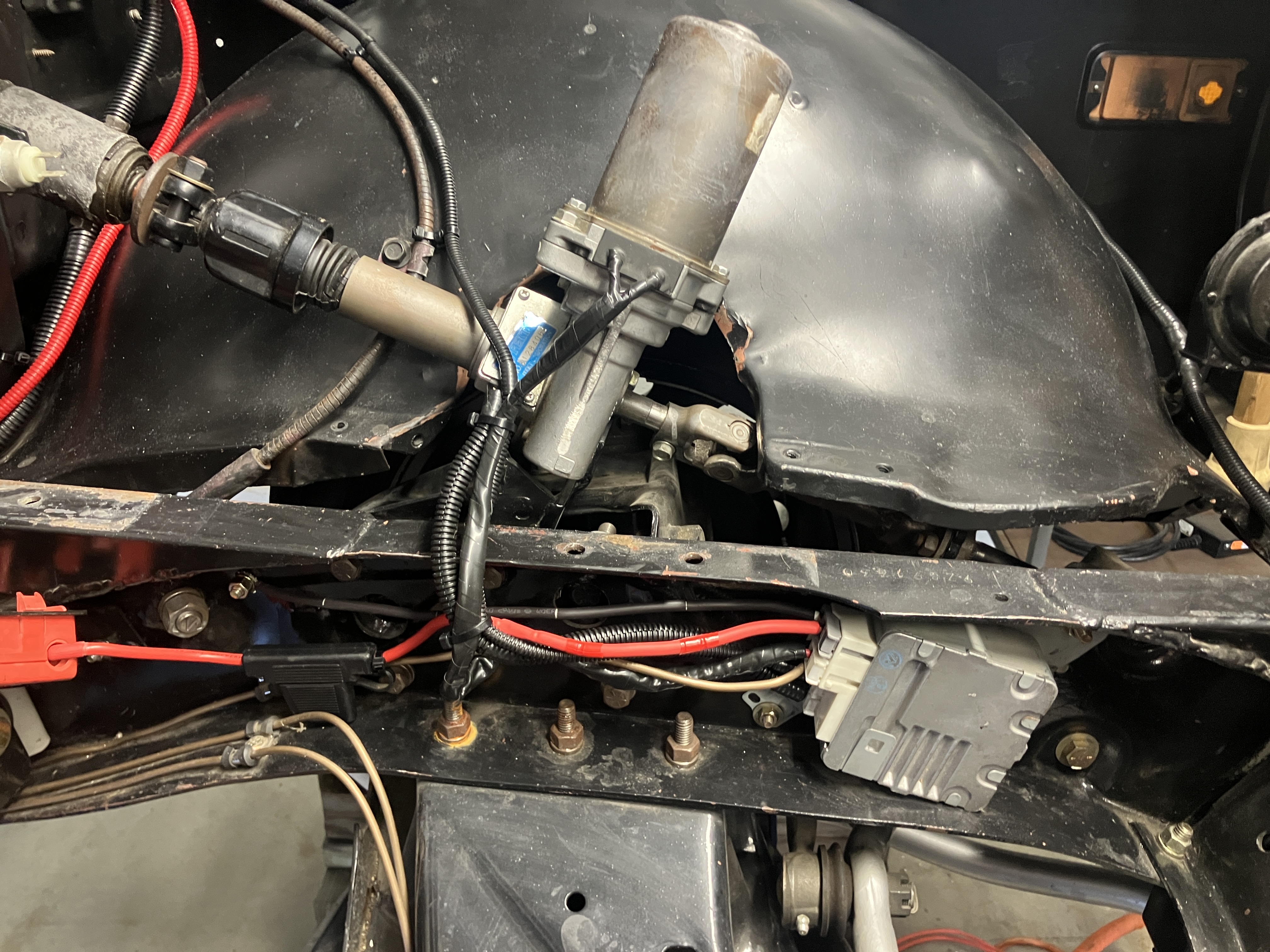

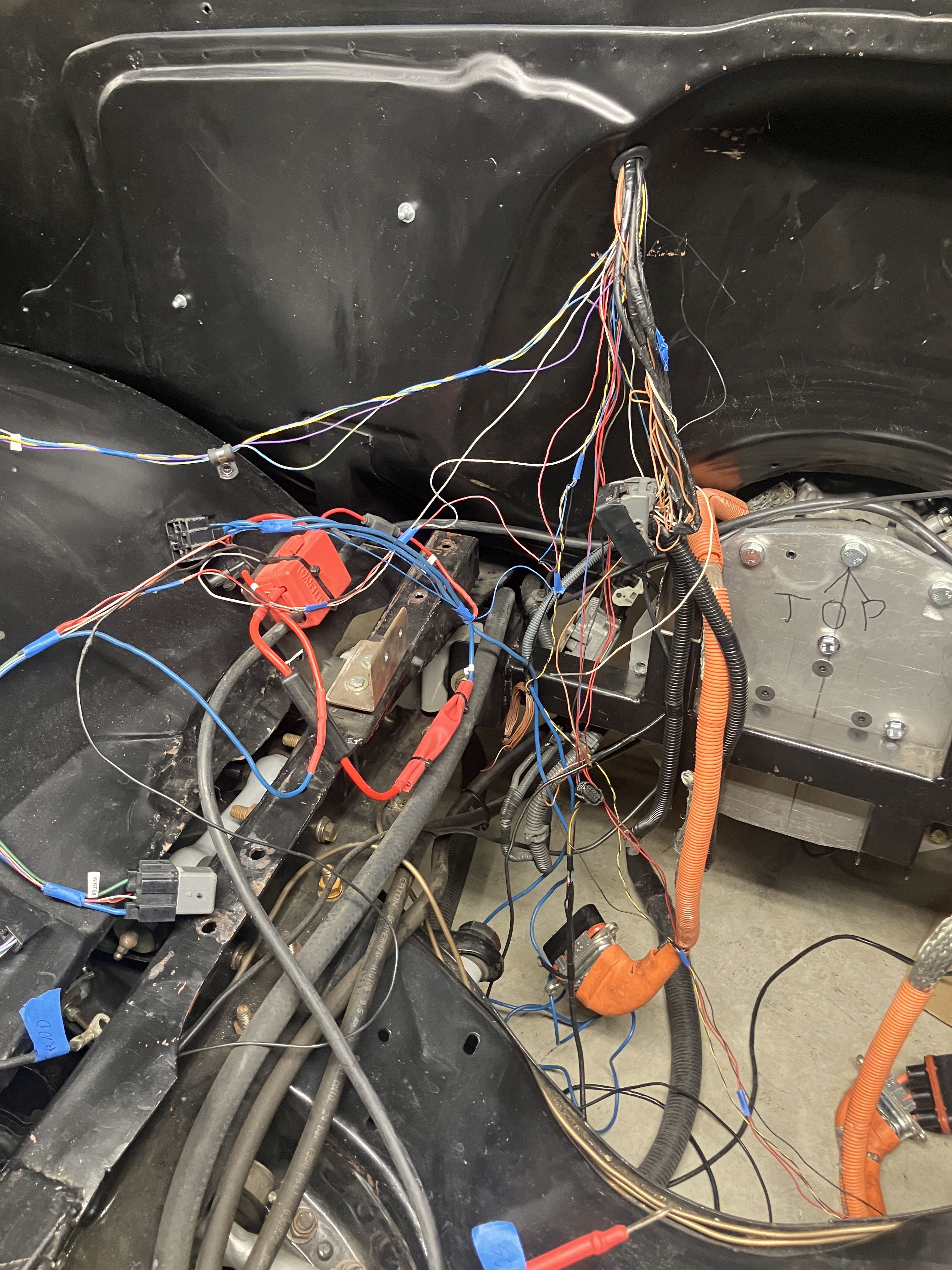

Post by Gregski »
I swear there's a wire mess every where I look, that green and yellow wire bundle is the stock rear lights harness, and all I really have going to the OEM bulkhead (everything else was engine related and has been deleted) is the red wire which supplies main 12v power to the OEM fuse box in the cockpit, the tiny black wire is the signal for the Prius EPAS Electronic Power Ass. Steering, this should get cleaned up tonight, so that my brain can function and not be distracted
that's a little gooder

ha ha, you mean like I've been hiding this fugly Prius power steering mess for over a year, note the unclipped zip ties, how recluse it that?
I can live with this

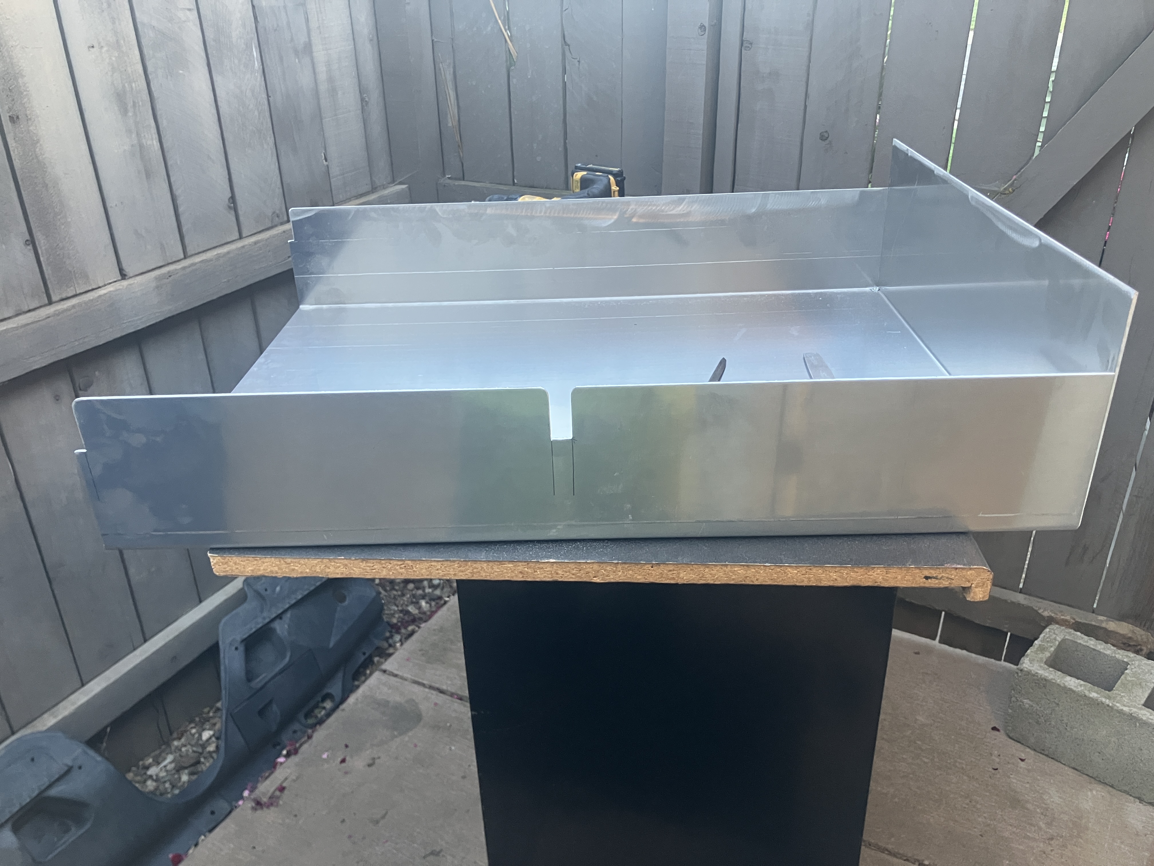

GMCe DIY EV 24 kWh BMW Battery Pack Upgrade
Gregski
Posts: 3157
Re: 1971 GMCe Lexus GS450H BMW 530e Tesla Model S Electruck [Upgrade]
Post by Gregski »

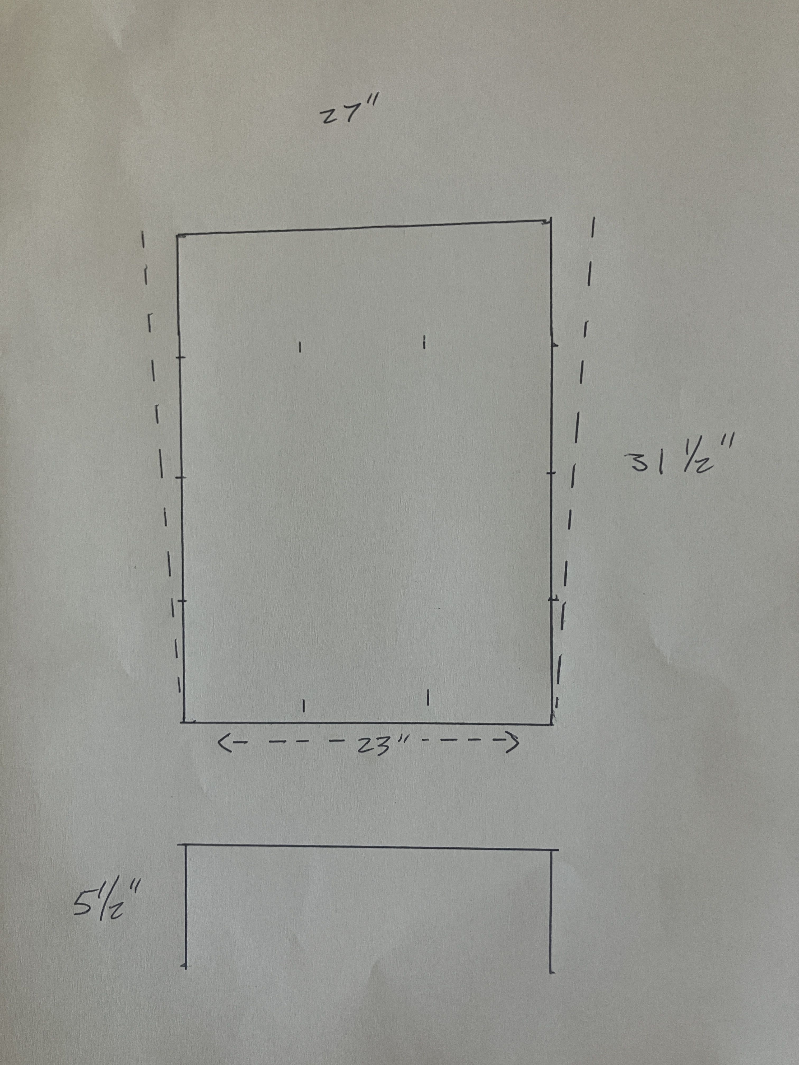

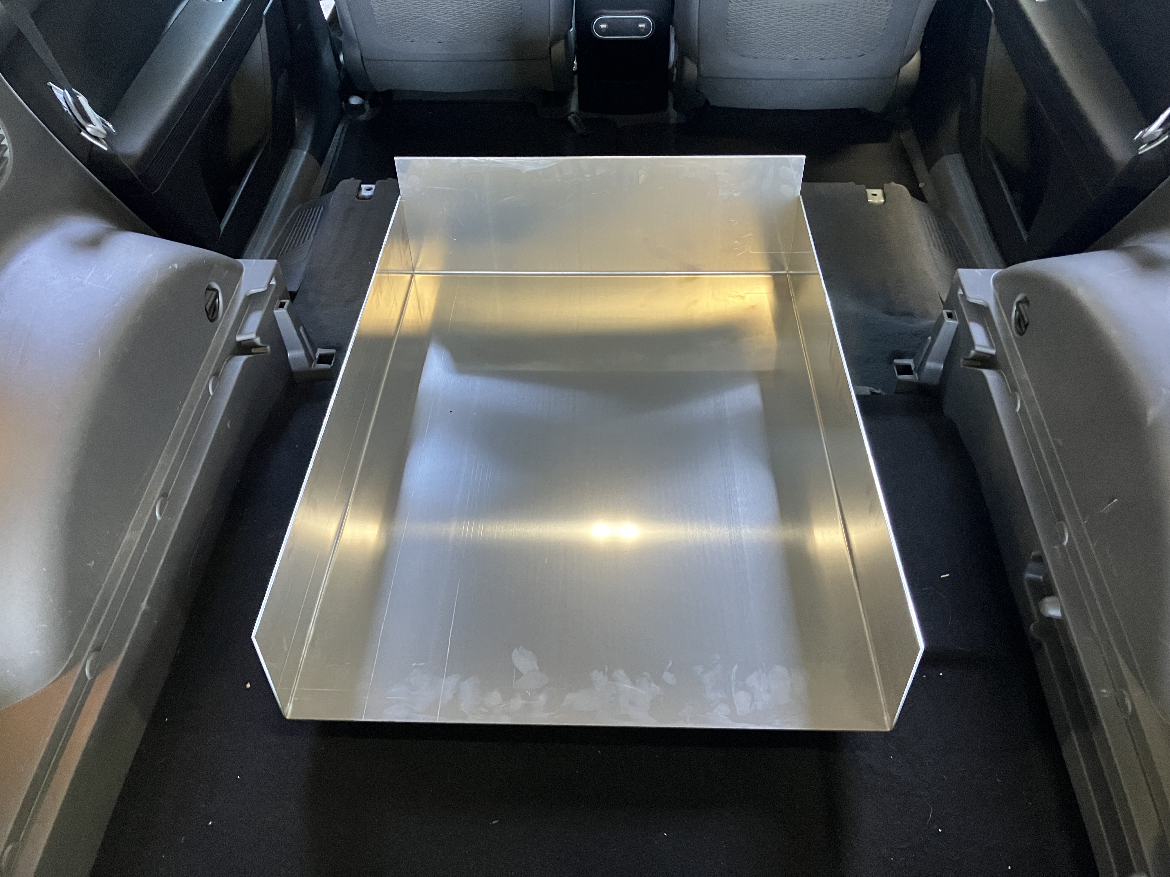

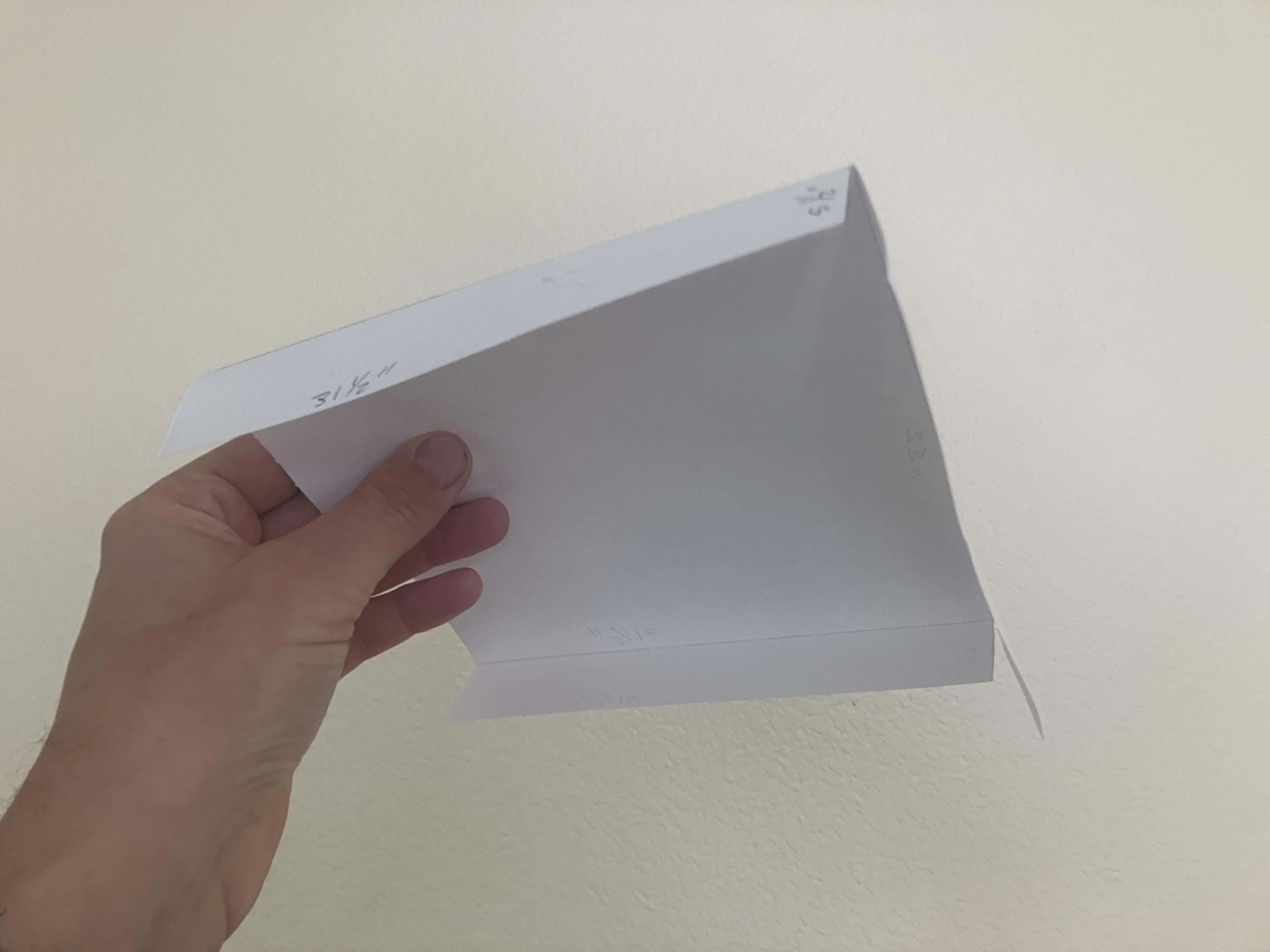

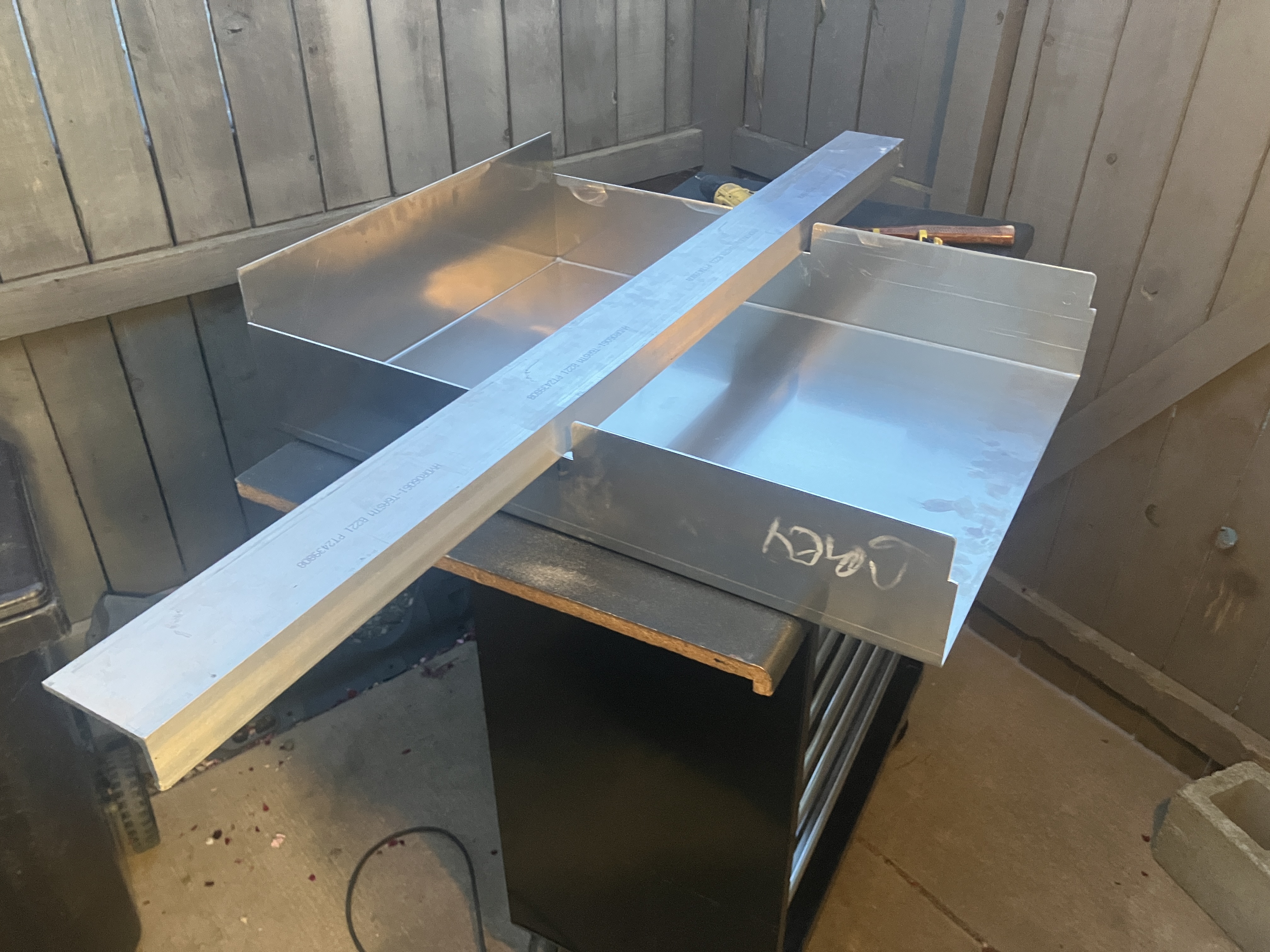

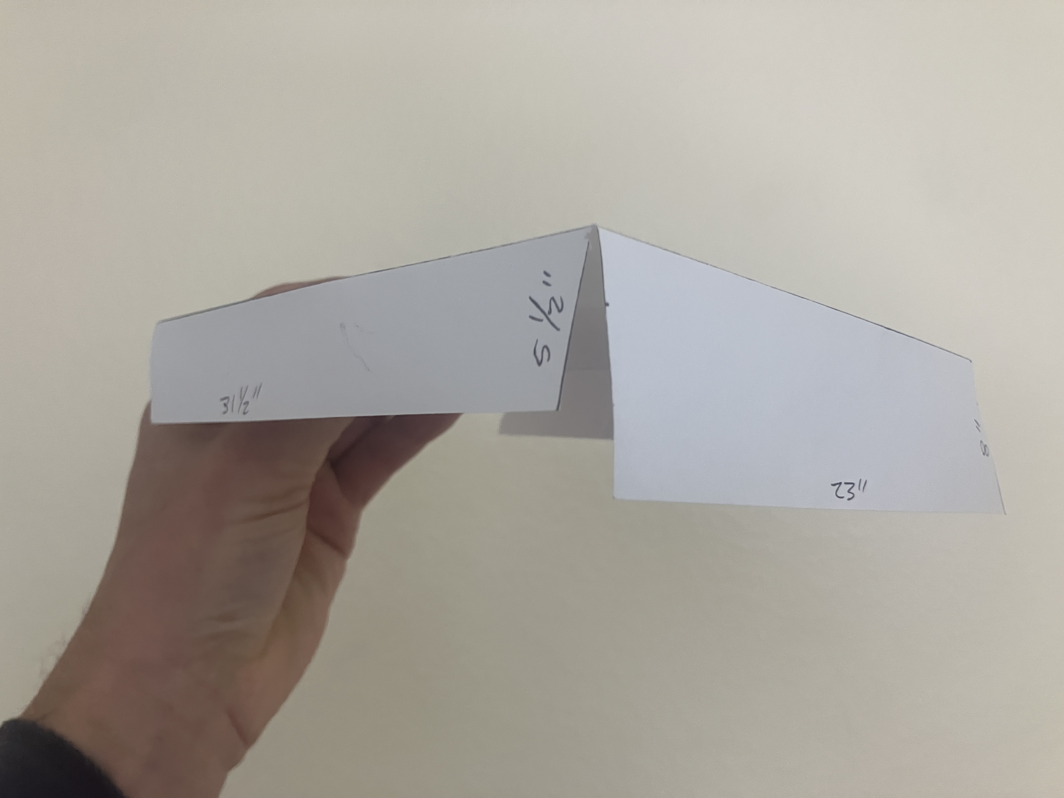

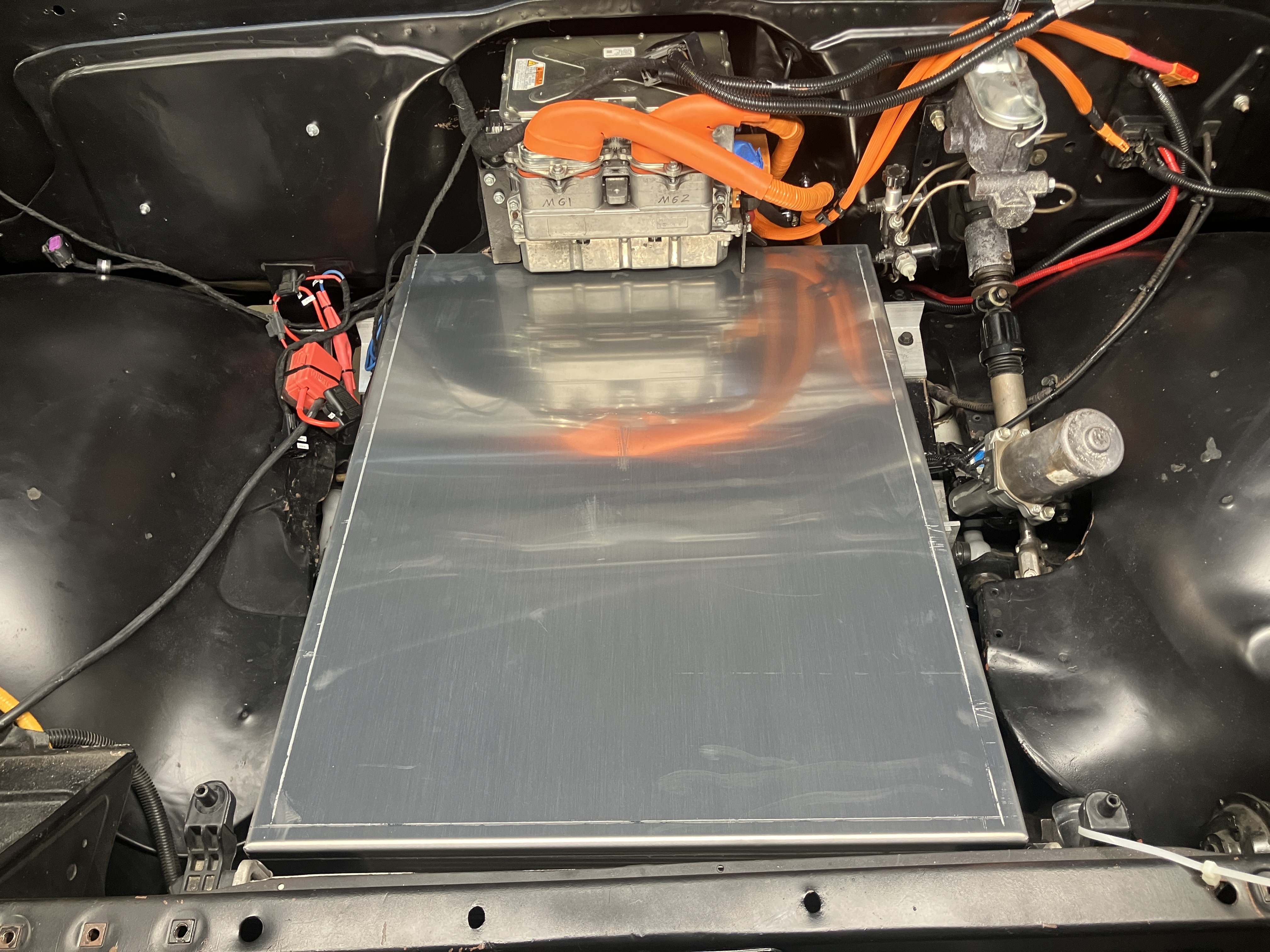

how it started...
Jacobsmess
Posts: 871
Location: Uk
Has thanked: 545 times
Been thanked: 153 times
Post by Jacobsmess »
Wow, that's a real nice paint job on that piece of card.

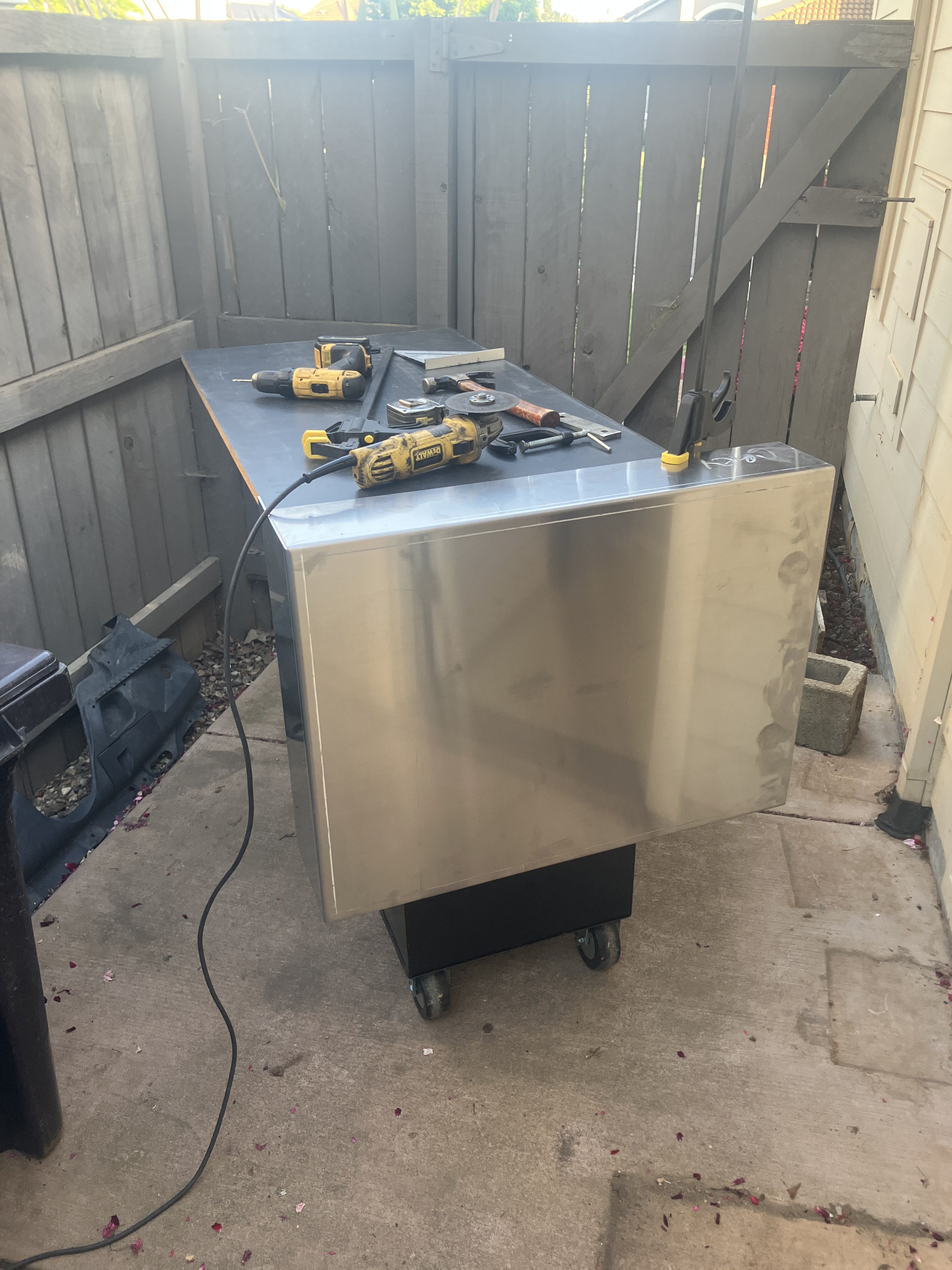

Gregski
Posts: 3157

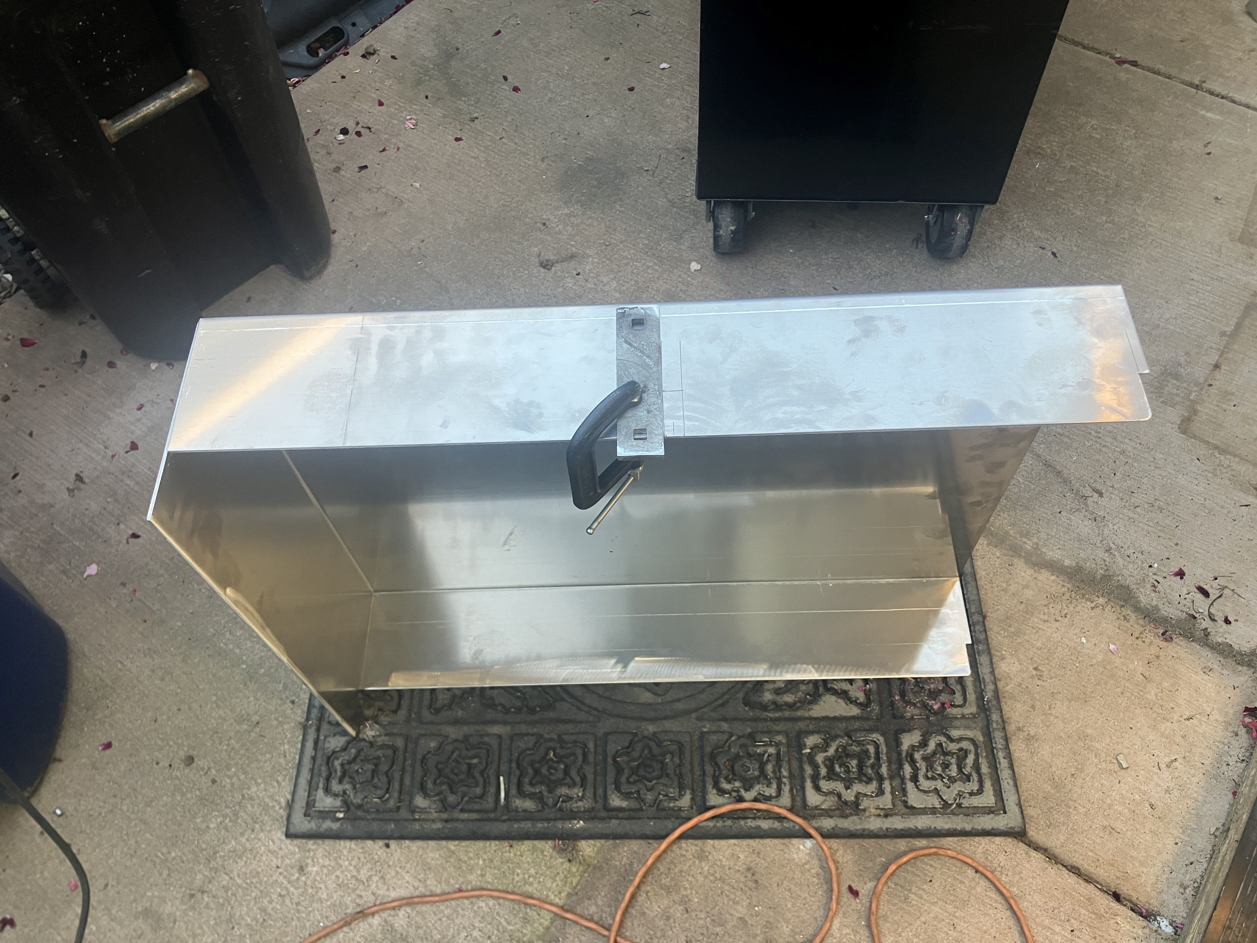

Post by Gregski »

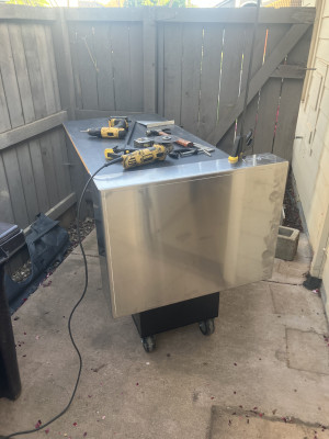

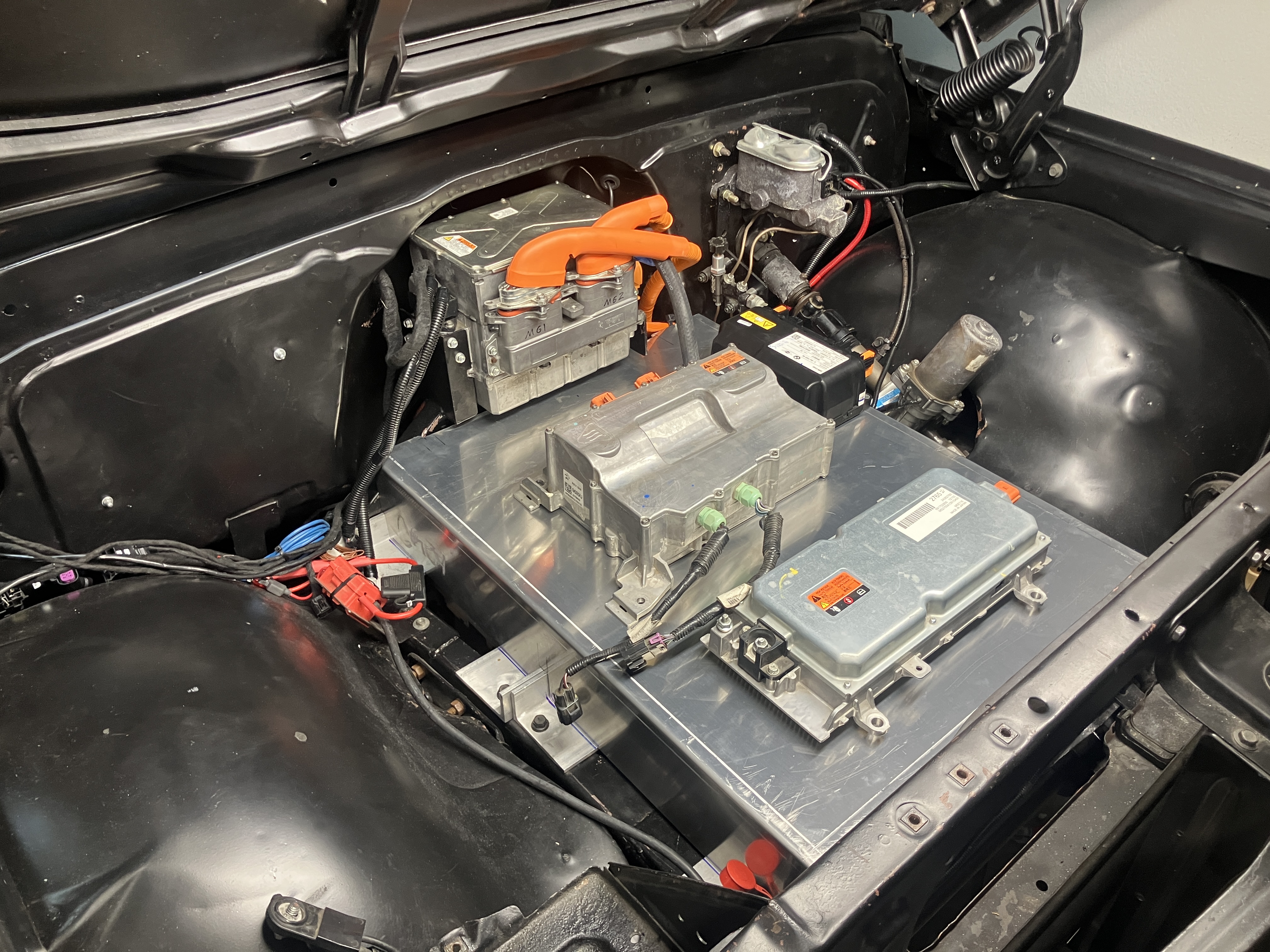

how it's goink...
[ just a trial fit, so please put away your EyeCrometers ]
meanwhile at the lesser known, Send, Notch, Send Facility

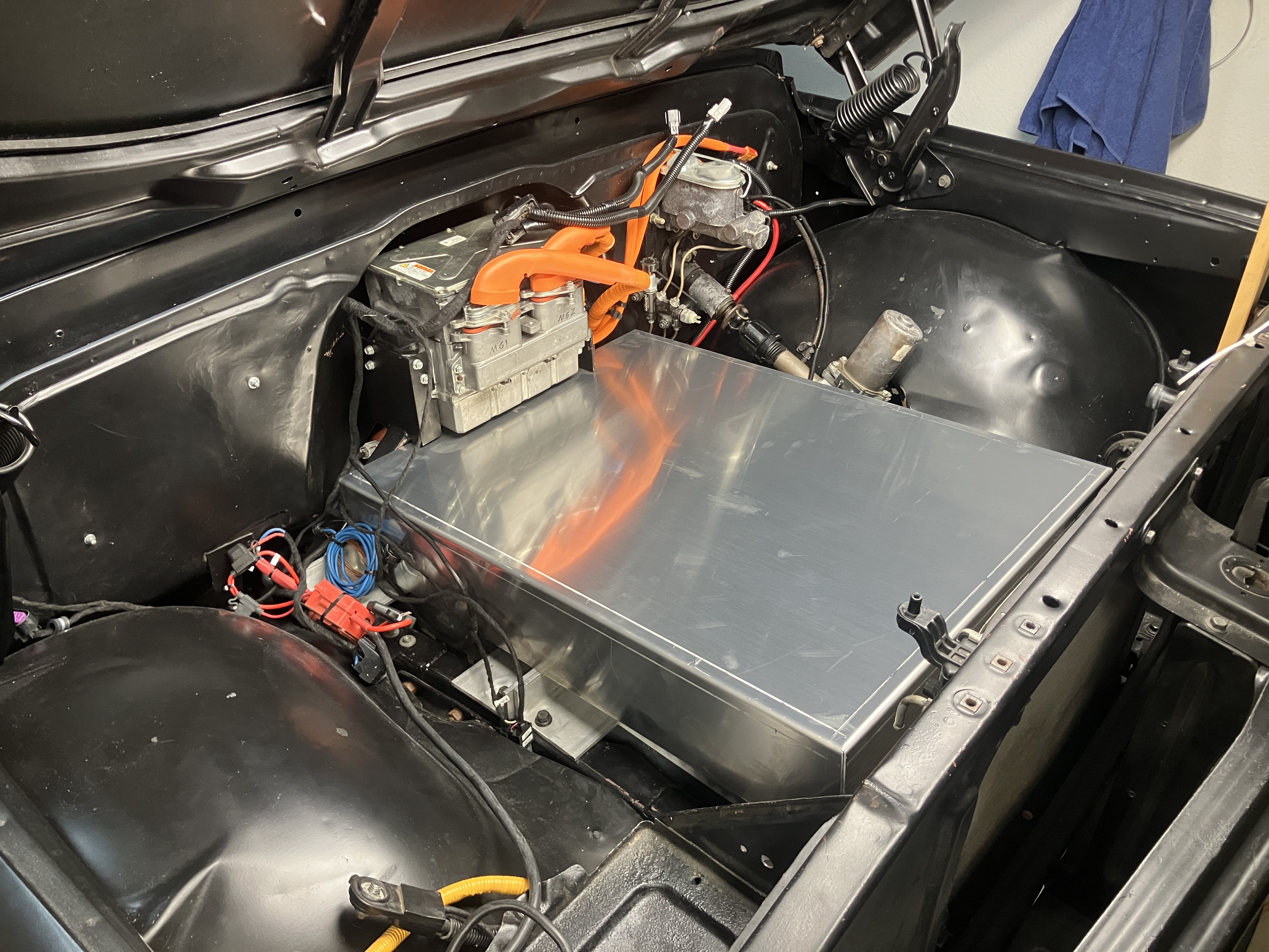

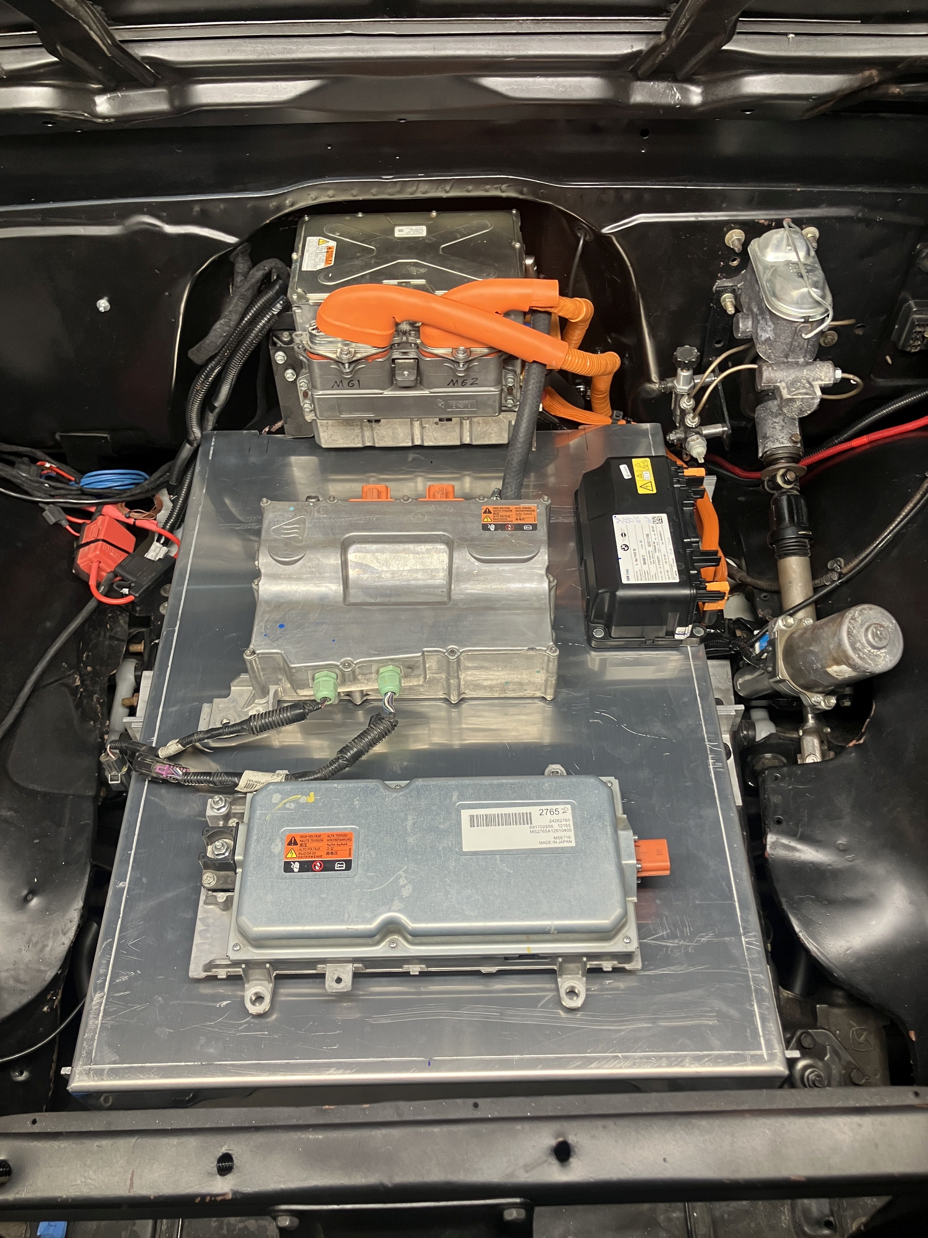

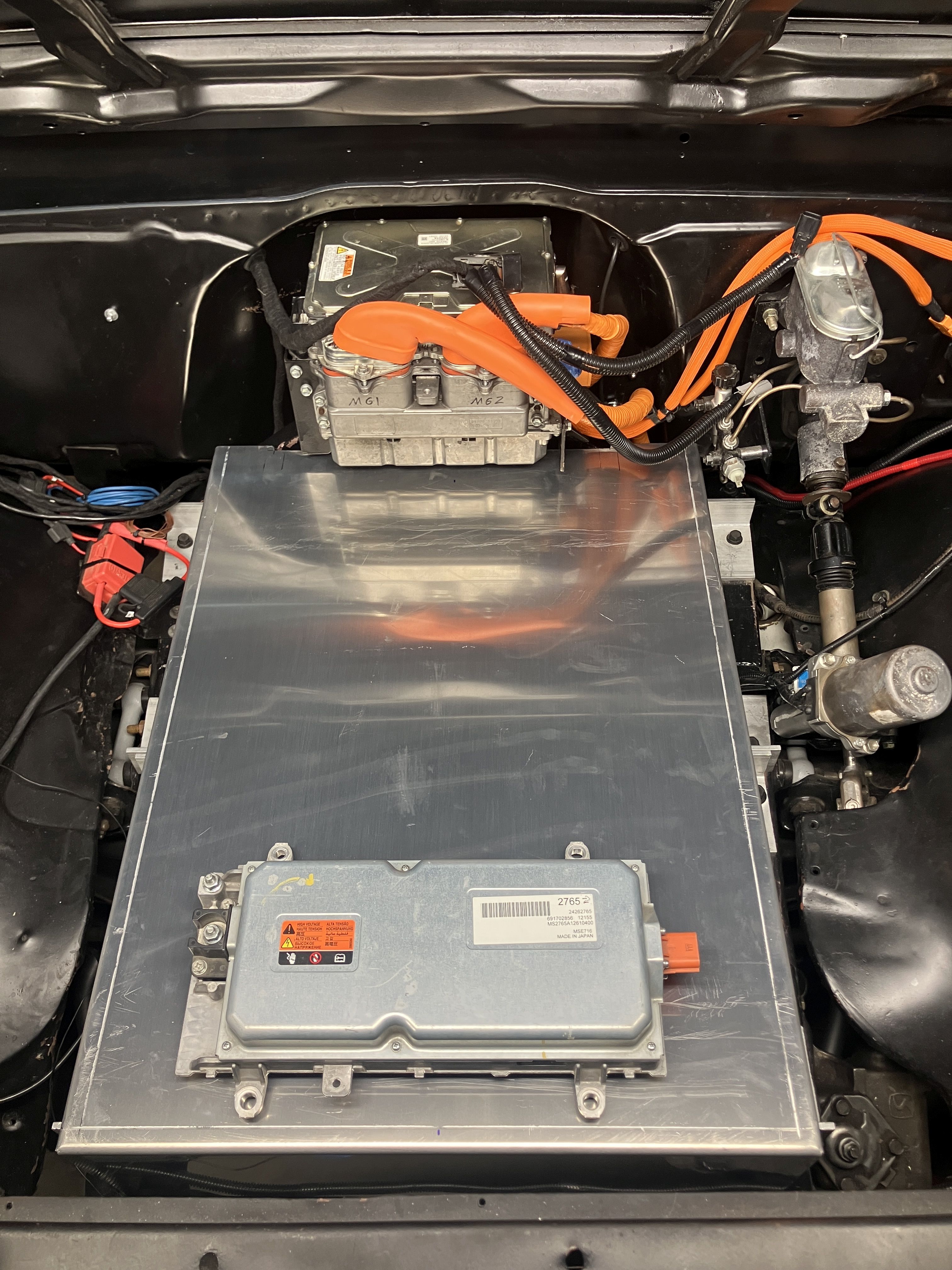

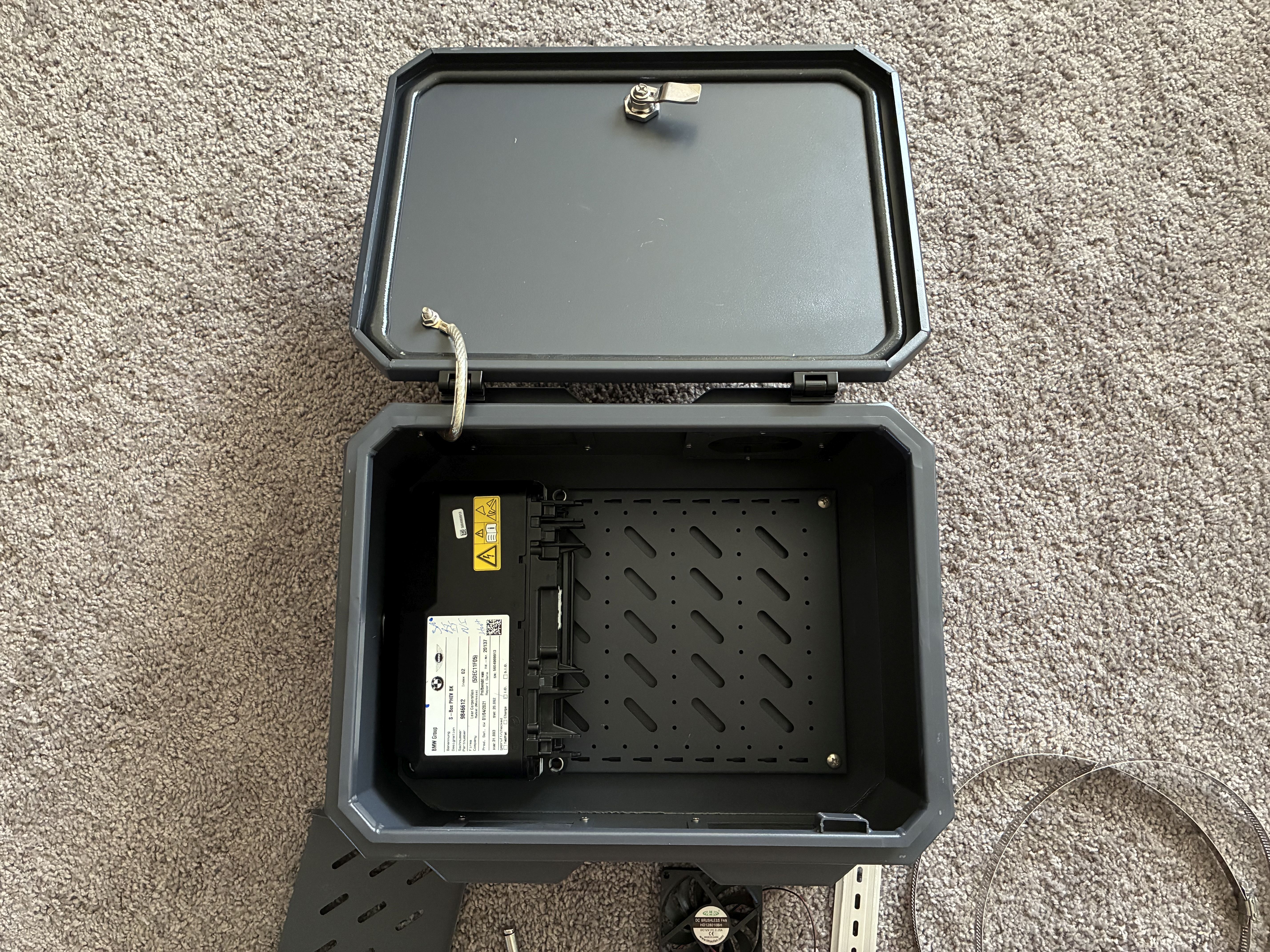

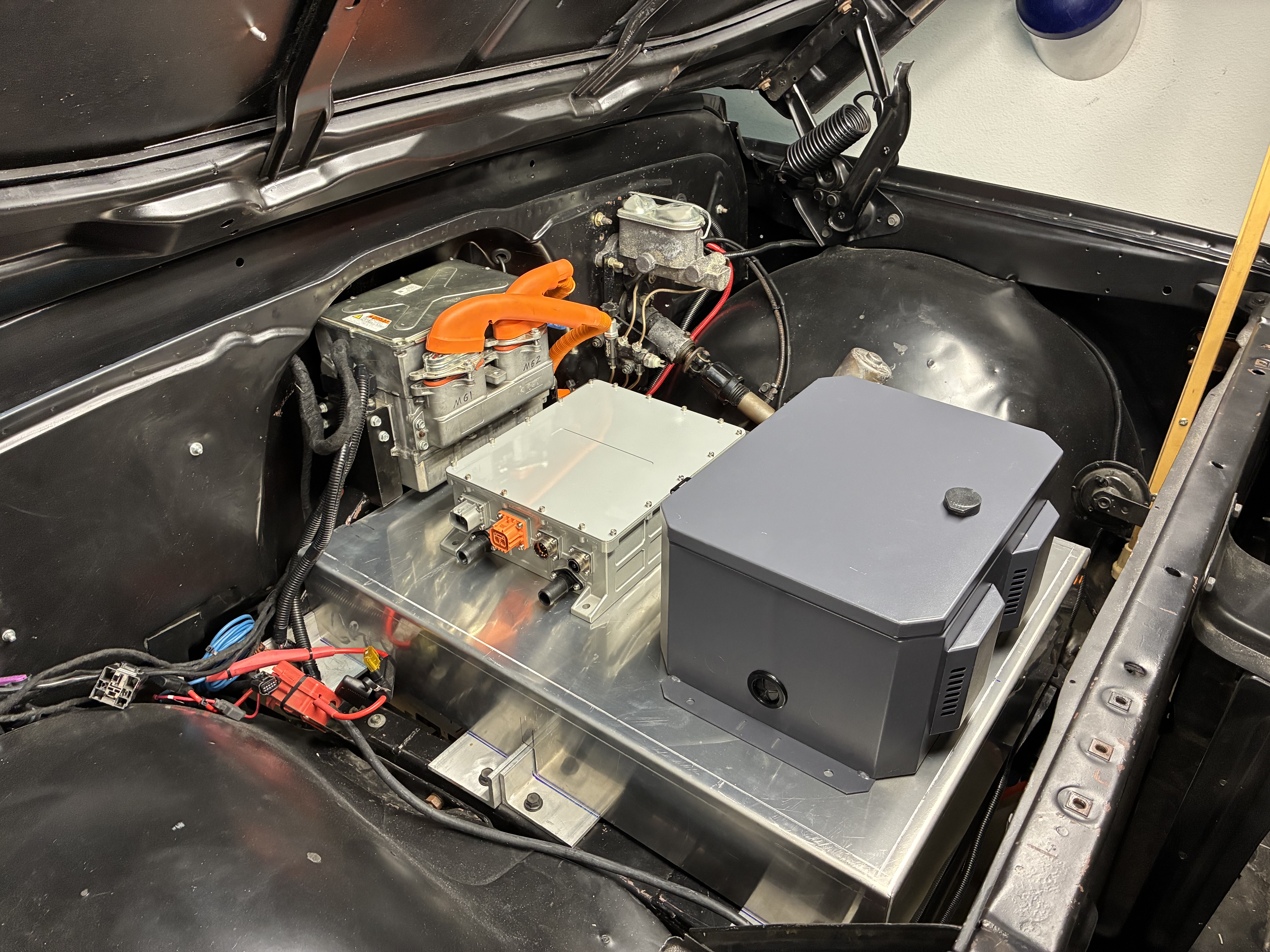

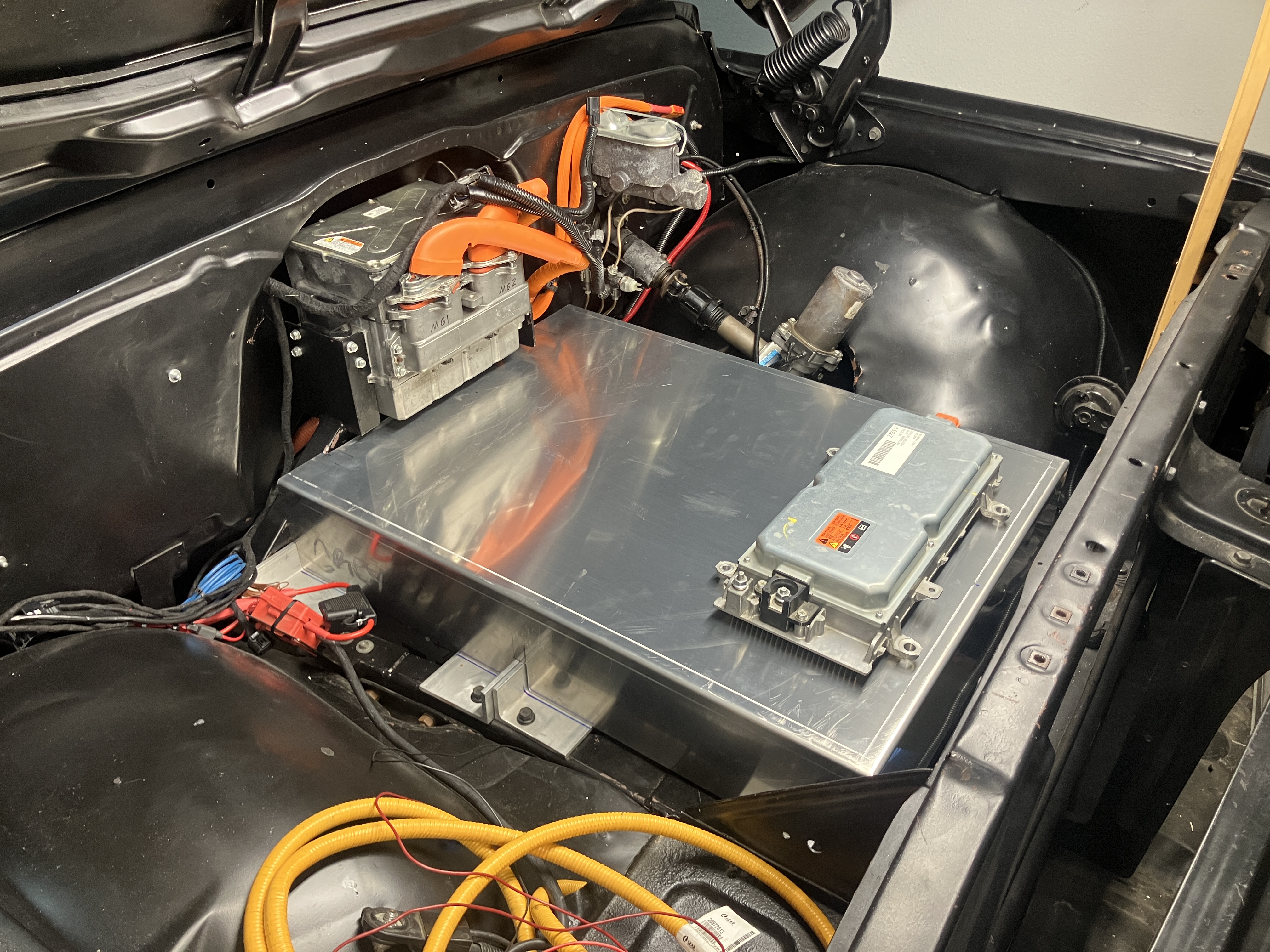

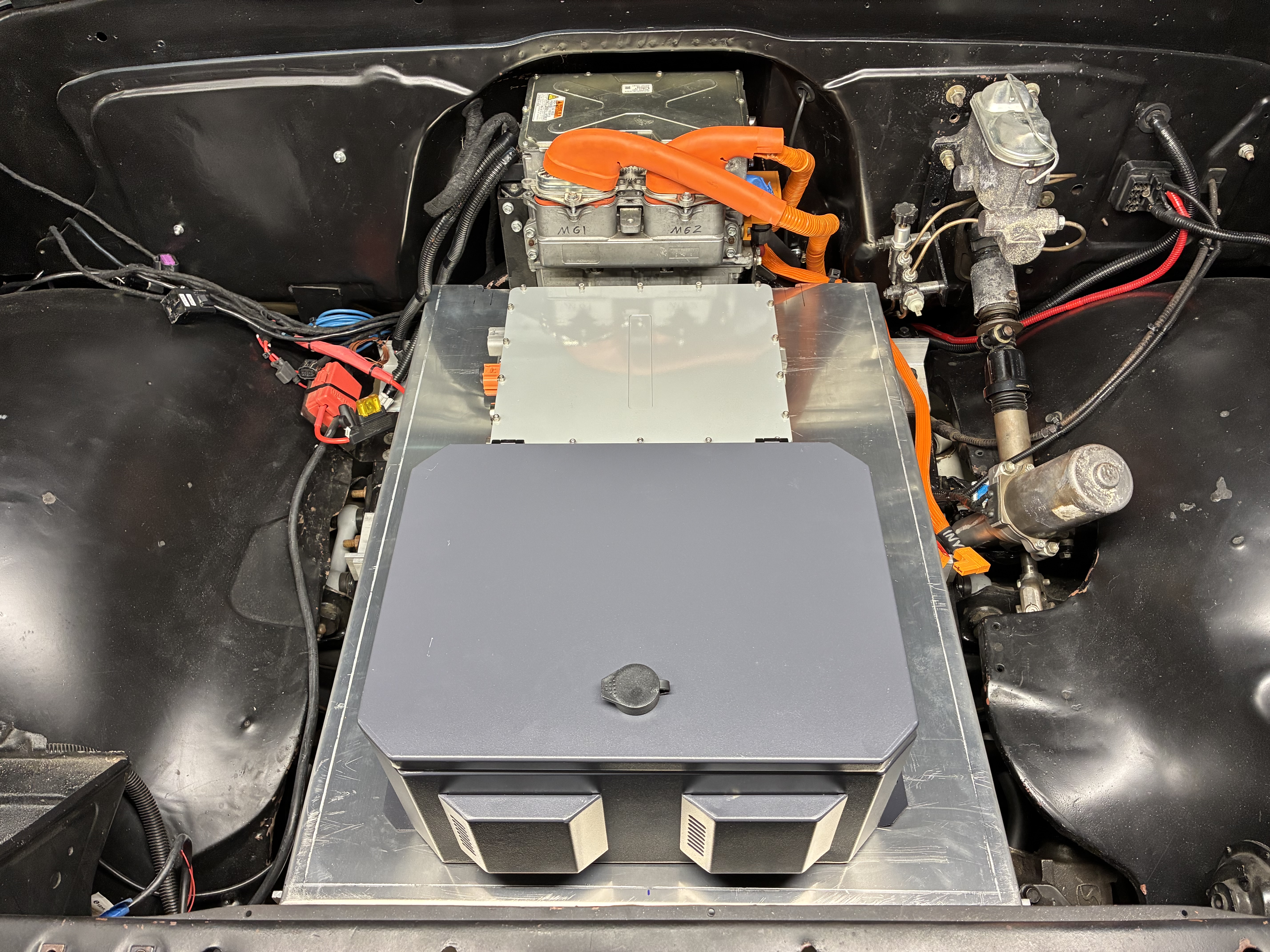

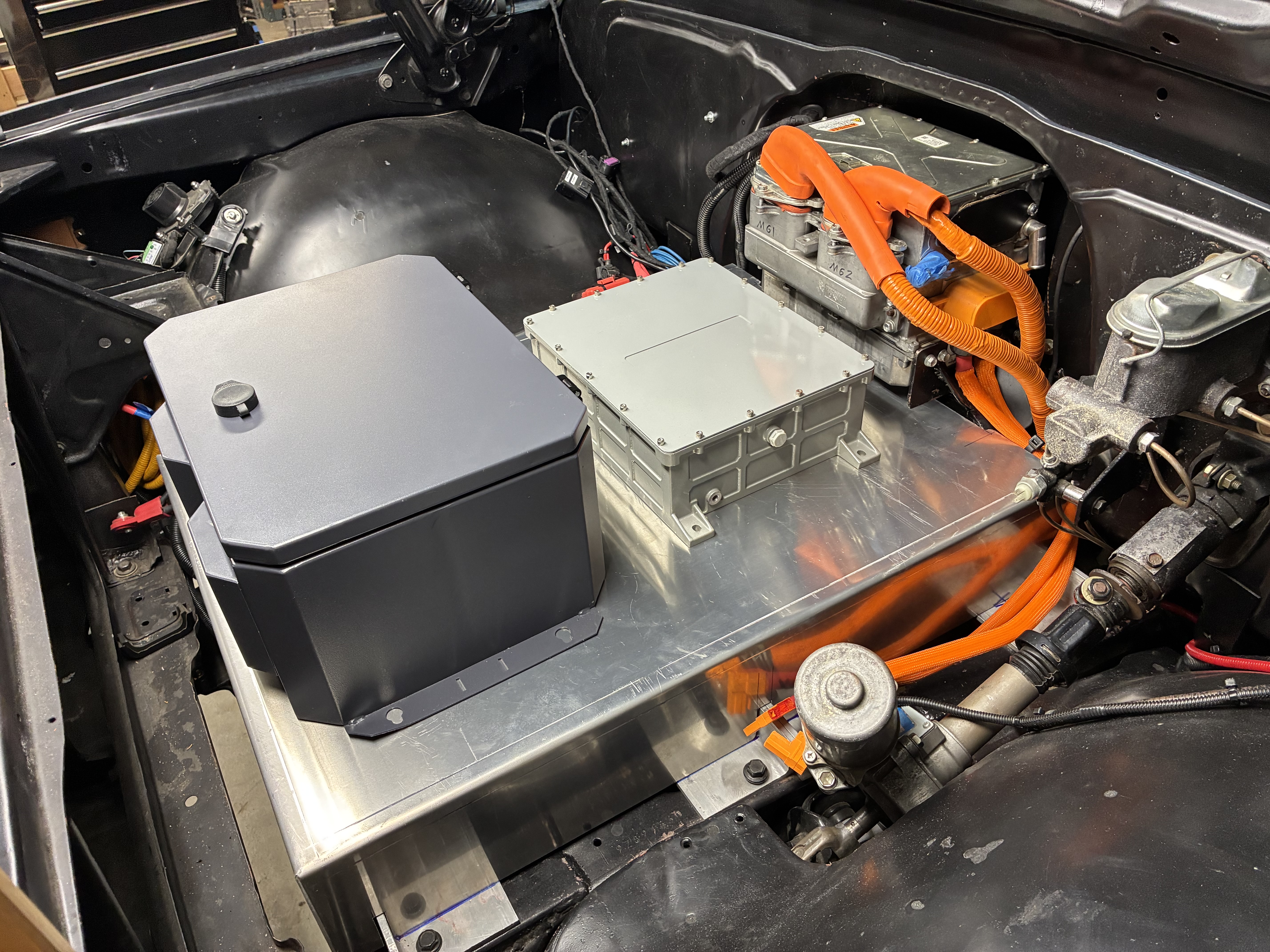

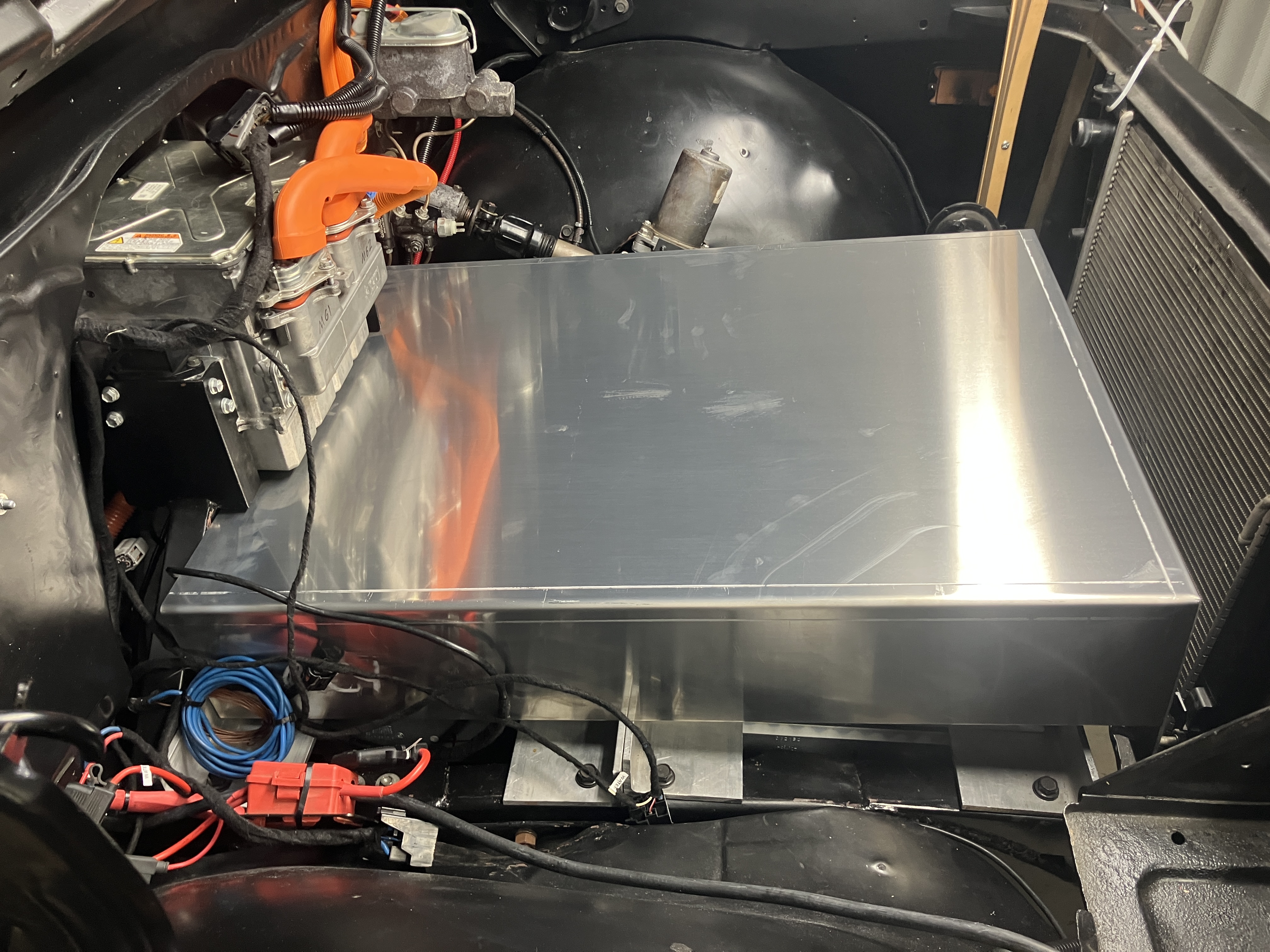

rethinking the component placement, not in love where the black box has taken residence
good ol' air cooled first gen Chevy Volt DC-DC alternator
and above it in the middle(ish) is it's older sibling first gen Chevy Volt battery charger

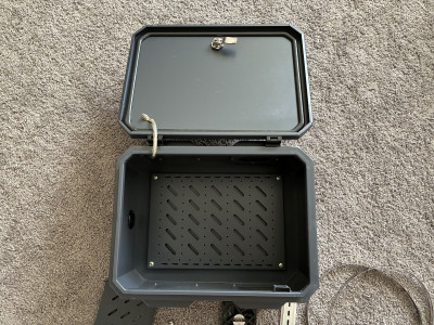

Posts: 2962
Has thanked: 328 times
Been thanked: 847 times

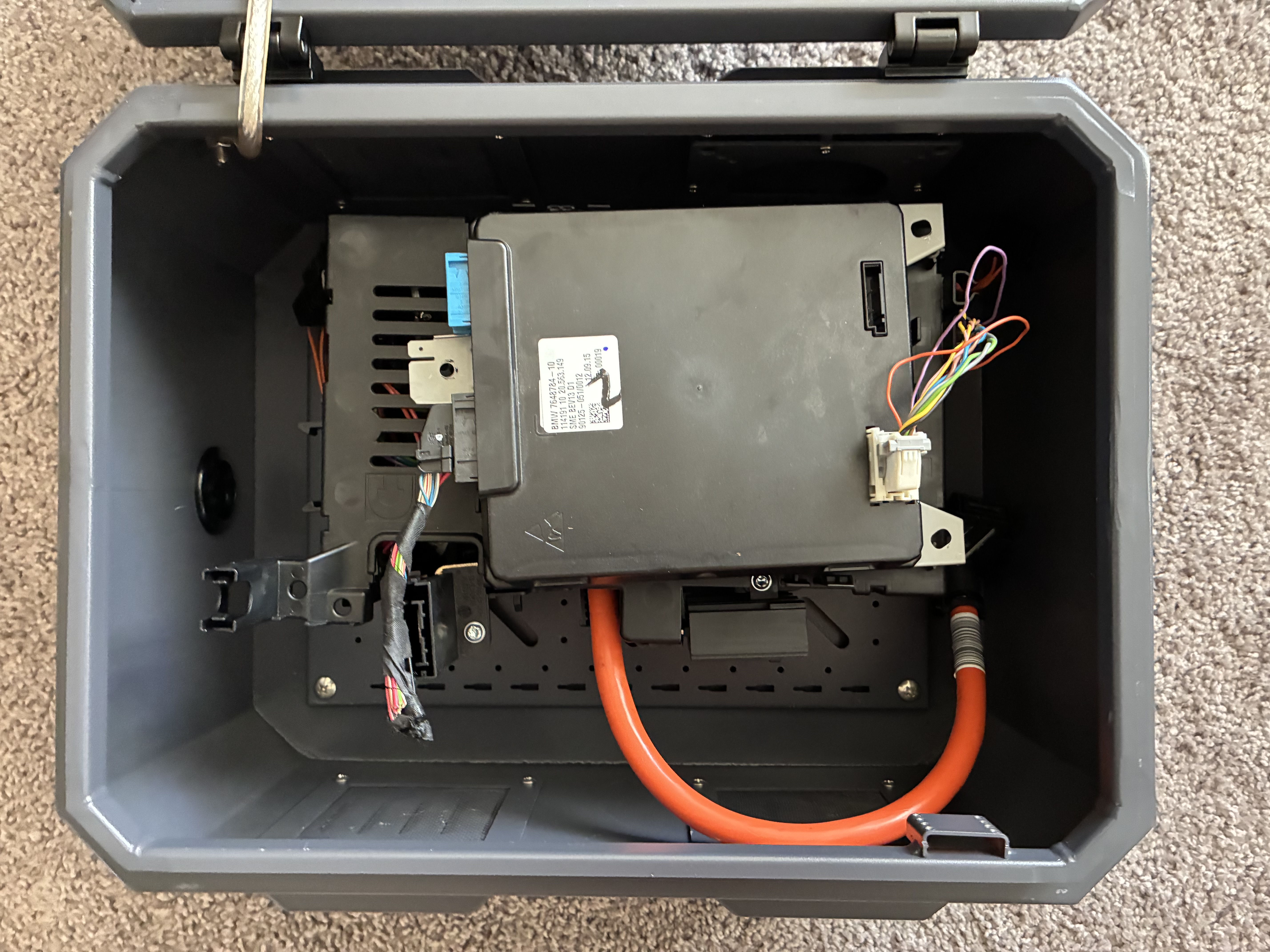

I see a lid for the top, is there a Bottom to the Battery box?
Also the SBox outside the battery box, thats a NO-NO in my opinion as its the thing that shut off HV from leaving the box. It is also clearly not waterproof in any way.
Gregski
Posts: 3157
Post by Gregski »

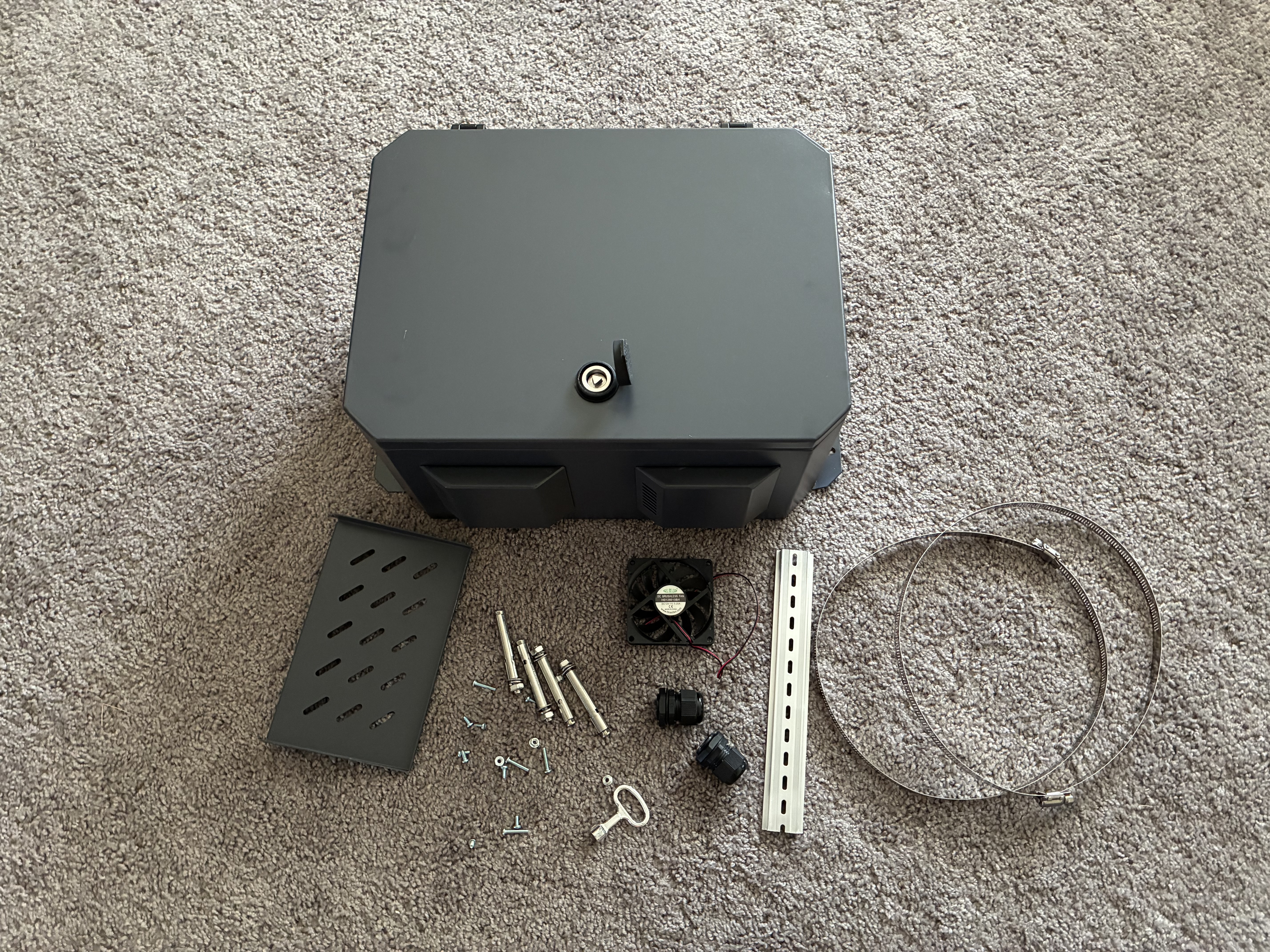

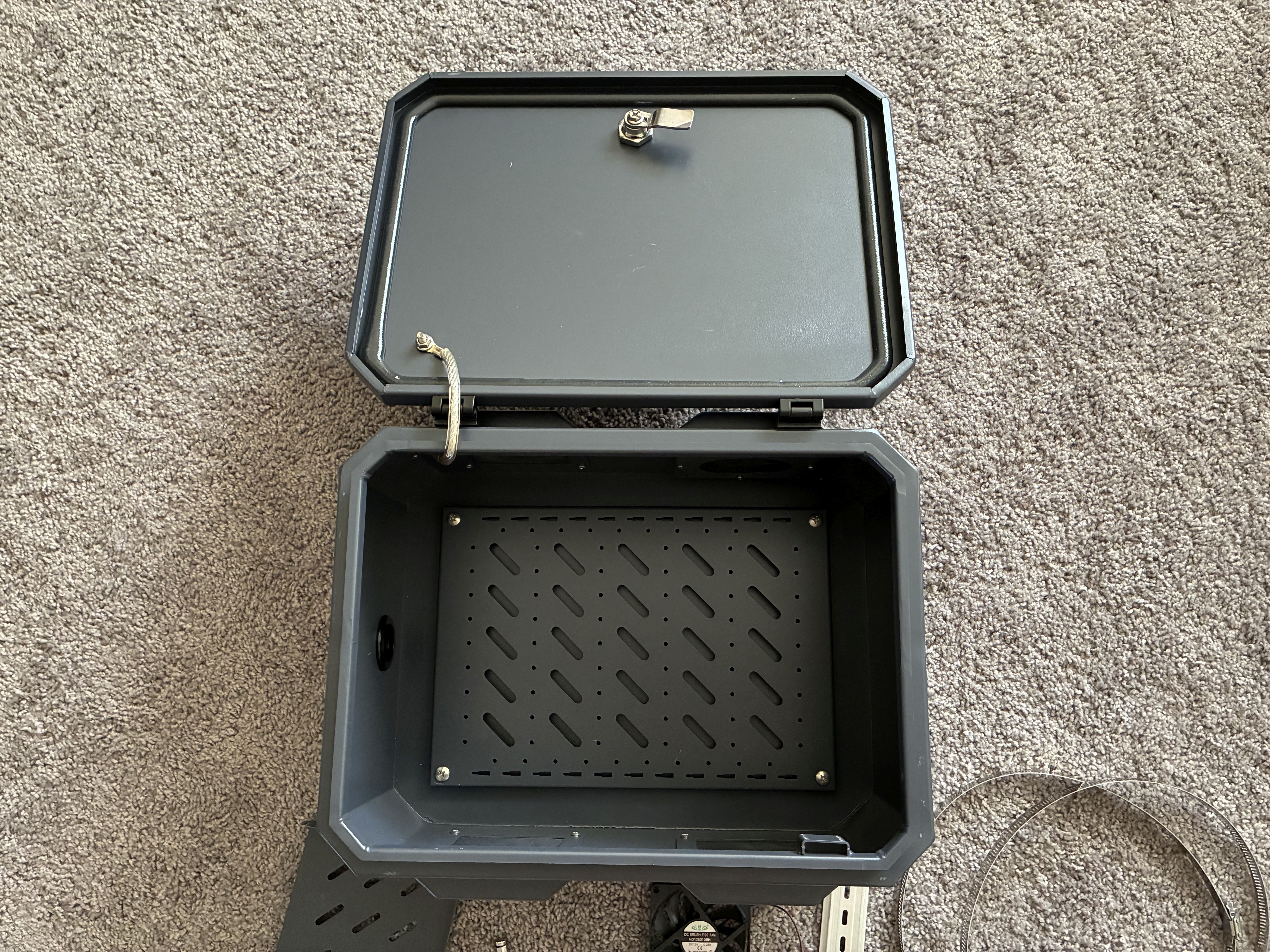

so my Alibaba 400x300x200mm Electrical Outdoor Metal Waterproof Vented Junction Box With Fan finally arrived
$112 bones
BMW 530e sBox inside for sizematology reference
BMW i3 Safety Box inside for a size reference

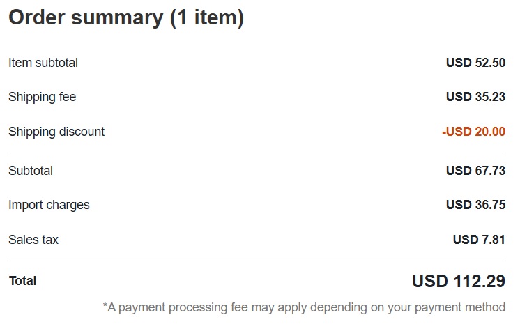

I hear you, well it all started with $52 bucks, then the fees, charges and taxes added up
Alibro
Posts: 1108
Location: Northern Ireland
Has thanked: 503 times
Been thanked: 321 times
Post by Alibro »
Gregski wrote: Sat Jun 28, 2025 12:48 pm I hear you, well it all started with $52 bucks, then the fees, charges and taxes added up
Is that your 'Trump Tax' that was meant to be absorbed by the importer costing $36.75?
