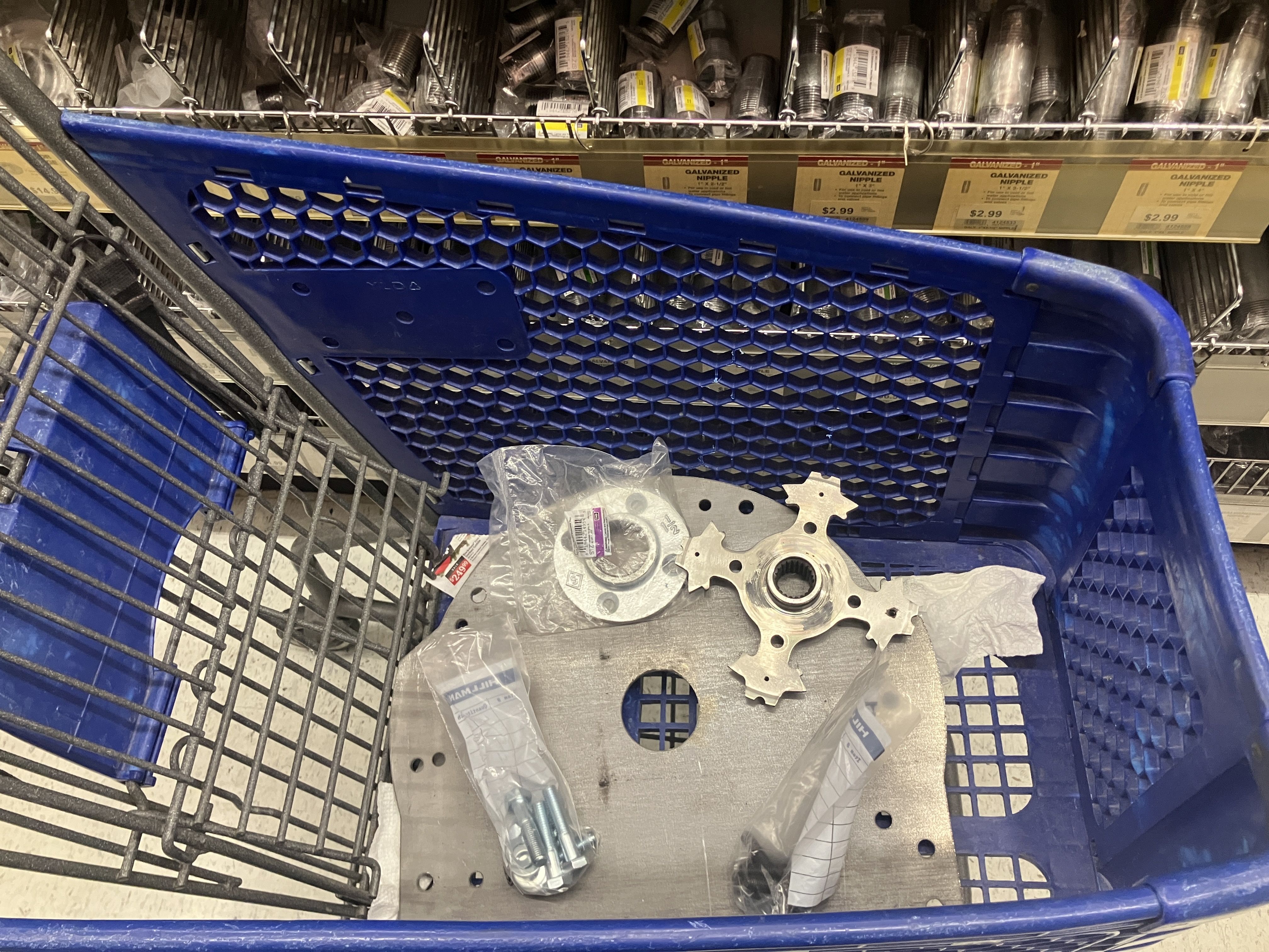

after one too many sleepless nights The Greg made some significant progress on Rev. 2.0 of our input shaft mechanism, using this handy LDR 311 F-112 Galvanized Floor Flange, 1-1/2-Inch, complements of our friends in Vietnam, or as I like to call it the Lexus GS450h transmission plate too big of a hole reducer thingie
here it is as found in our local Ace Hardware store plumbing section
