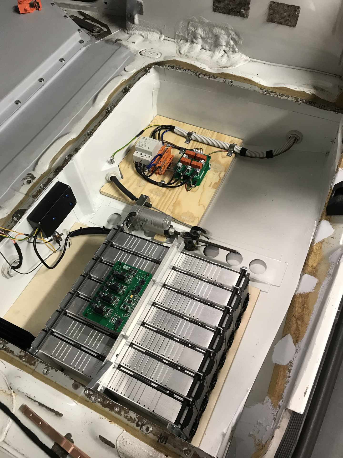

While waiting for the last parts for the DC/DC I have been working on the charger.
Will be using 7pc of Eltek FlatPack 2 HE 48V power supplies.
Stacked.
Stacked.
Inside car with control board on top.
Modular control board.
Will also have detection if 1- or 3-phases is available. With planed configuration I will be able to charge up to 17kW if 32A 3-phase is available and down to 2,3kW if only 10A 1-phase is available.
Board for 1/3-phase switching and 12V supply from 230Vac.

Where did you source your flat packs from and for roughly how much? Also whats the combined weight and size?
Re: Renault Clio Electrique -97
Posted: Sun Jan 23, 2022 7:18 am
by bexander
Some of them at two different occasions from private persons in Sweden. For the first three I paid 1500 SEK a piece and the remaining four I got as a thank you for helping a friend with some other stuff. I would turn to ebay or similar website to find them. You will also need a PCB to connect to them as there is only a slot at the back, no externa connectors.
The datasheet states 109x41.5x327 and 1.95kg.
My stack takes about 140x330x327 an then with above mentioned PCB in the back the length will increase a further 60mm or so. I have not weight the tack but I guess 15kg is a resonable guess.

More things mounted in the car.
Switch board and AC contactor.
Type 2 inlet.
Type 2 inlet.
Anyone have a good idea for a cover for the type 2 inlet? The lid that came with the inlet sticks out outside the car so not good without modification. The cars stock one will not work as it is also the filler cap and at an angle.

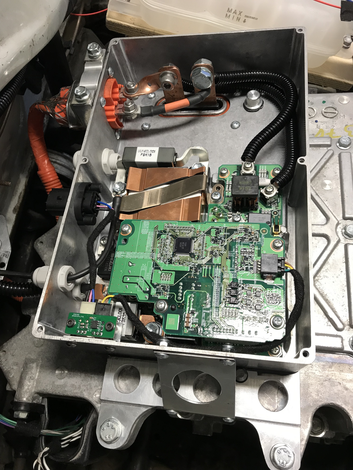

Last parts for the DC/DC have arrived and are in place.
It's a NE555 to provide PWM signal to the DCDC for a solid 14,0V output.
Plan is to also have the relay for the cabin heater PTC inside the DC/DC enclosure but that has lower priority and will have to wait until the car is running.
Posted: Mon Jan 31, 2022 8:33 am
by Bigpie
Is that a prius DCDC liberated?
Posted: Tue Feb 01, 2022 5:09 am
by bexander
Yes, that is correct. It is the contents of a Prius Gen3 DC/DC.
Posted: Sun Feb 13, 2022 6:10 pm
by bexander
The full charger installation. The low voltage wiring to the left is temporary.
Working with improvments to charger SW and BMS SW at the moment.
Have done more driving but the wether was wet, cold and windy so not to concerned about 1,02kWh/10km. This will most likely improve with better weather.
