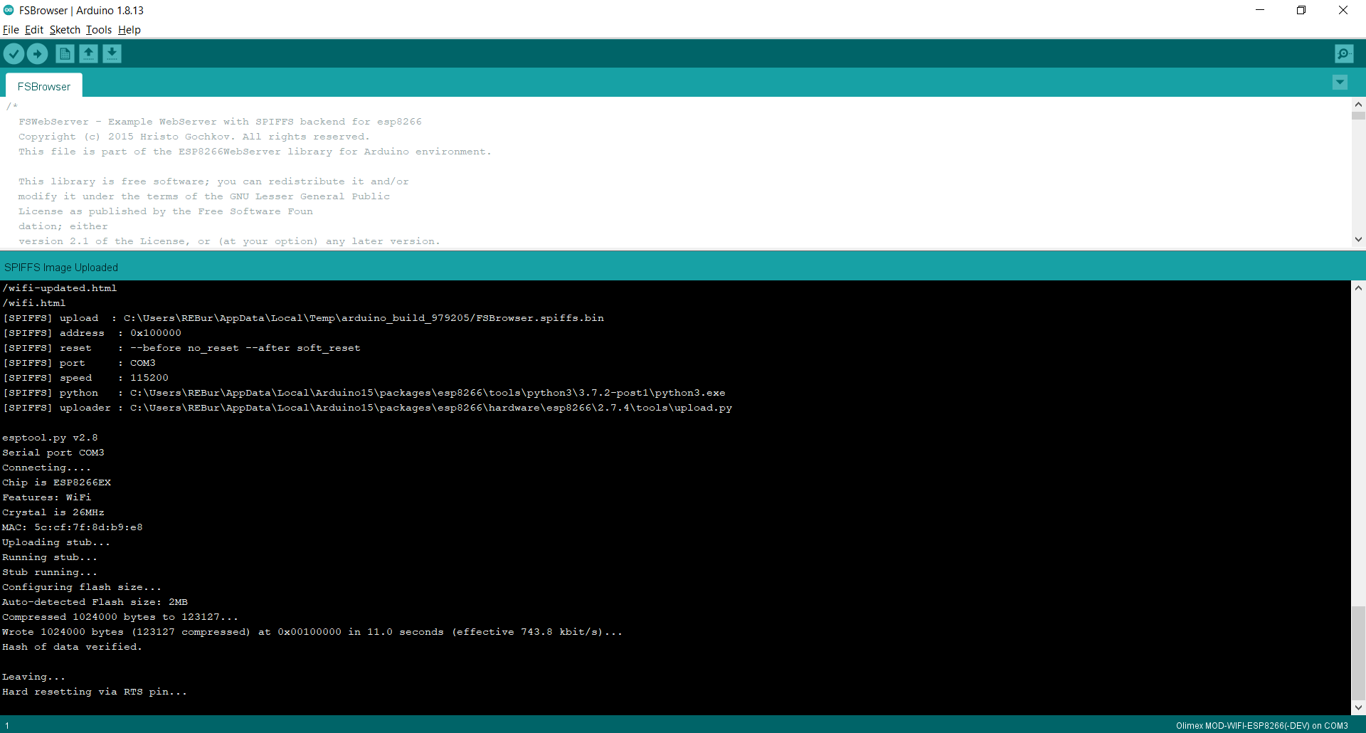

by Peakon28
I have updated esp8266 board package up to version 2.7.4 and sketch compiled correctly and I managed to upload sketch to Olimex board and program SPIFFS.
next test it on the board

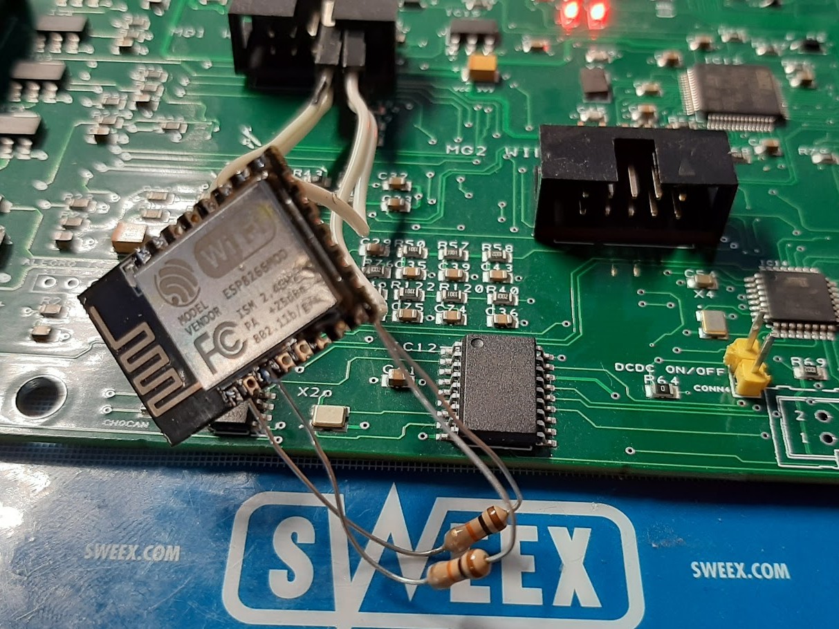

Long time no see :)
Yesterday I've flashed ESP8266-12E using nothing more than FTDI232(cheap USB-TTL, yet has got everything needed onboard), two 10k resistors and one 100MkF capacitor. No additional power supplies. I don't know why people say it need strong power supply. There are a lot of manuals on the internet, but for some reason almost none of them worked.
I created this sheme and it worked:
Then, after successful flashing and setting up module's name and password, connected it to v1d board like this(temporary) and it connected, LED is not flashing, but it is not a problem for me :)
Maybe it will be useful for someone who struggling with flashing ESP-12E or ESP-12F.
