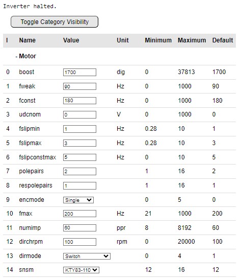

What should I do now? I see the inverter homepage but no parametres? Is there a guide on how to continue, that I haven't seen? I have seen videos about programming the boards that are ordered directly from JLCPCB then one needs to program all the chips and wifi module but I bought it from EVBMW and I have heard or read that it's preprogrammed well seems like it isn't I'll add a clip here what I see from the web interface.

Is the code running on the STM32? I assume this is similar to other boards and has a LED that flashes when the code is running. If code is running then check the WiFi module is fitted correctly. That is all that is needed, but you may have to reload the web page or click on refresh in the web interface to get parameters to display.

royhen99 wrote: Thu Feb 08, 2024 7:47 am Is the code running on the STM32? If code is running then check the WiFi module is fitted correctly. That is all that is needed, but you may have to reload the web page or click on refresh in the web interface to get parameters to display.
Led is blinking so I think that some code is making it to blink.
Well is it possible that web page is displayed when ESP8266 mini D1 ESP wasn't fitted right? I don't think so, I pressed the refresh many times, no change. Do I need to change wifi settings or something or do I need to connect a jumper or where to find the reason I'm not seeing the numbers that everyone else sees?

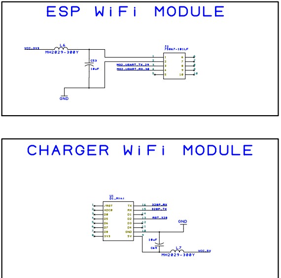

what is the sketch data? Is it for the D1 mini ESP wifi module? It has wifi and I can connect to it, so it works. I think Damien has programmed it already or do they come with that wifi software activated but where does my laptop take the openinverter webpage then? It was already programmed.

The "sketch data" are the files that are on the wifi module for the web page ( they are separate from the ESP8266 code that runs the web server, wifi and communication with the STM32). As the web page appears to be running this it is not likely the problem.
I have looked at the schematic before but had forgotten that this board has two wifi modules, one for the inverter and one for the charger. The D1 mini wifi module is connected to the charger. Either you need an adapter board so the D1 mini can be pluged into the olimex socket or get a olimex module.
The olimex modules are a bit unreliable so another option would be to link the d1 mini TX and RX to the olimex socket TX/RX with wires, if you are not using the charger. Is the controller for the charger, IC13 fitted?

royhen99 wrote: Thu Feb 08, 2024 10:55 pm -This board has two wifi modules, one for the inverter and one for the charger. The D1 mini wifi module is connected to the charger.
-option would be to link the d1 mini TX and RX to the olimex socket TX/RX with wires, if you are not using the charger.
-Is the controller for the charger, IC13 fitted?
Yes now I see why there are two wifi modules on the circuit diagram at first I thought there's an option of one or the other. I remember somewhere on the forum there was a board with two and I didn't get it.

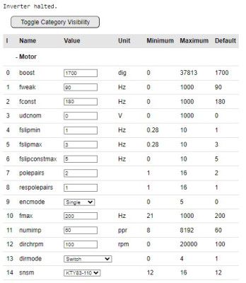

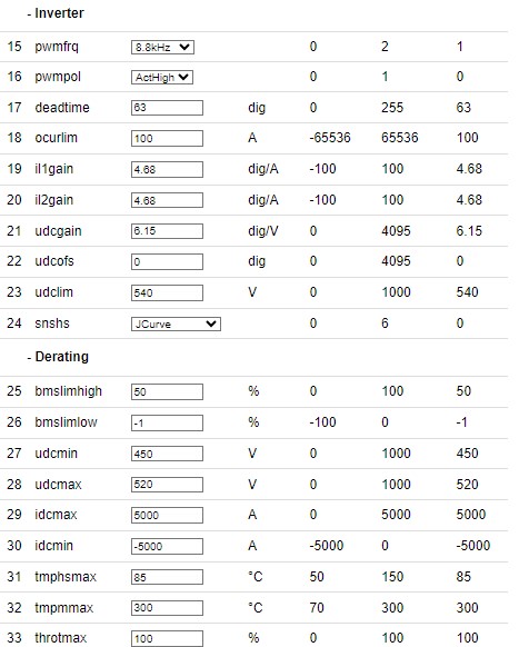

I plugged the D1 mini RX and TX pins into the J2 (olimex) socket pins 3 and 4 and it worked right away when I got the rx/tx pins right! :D Thank you royhen99 for helping me a lot!
IC13 is fitted, Damien had it soldered, someday I need to find out why didn't it show the charger things by wifi connection then.
Some parameters that I see now:
Now need to got to work and connect it to inverter and attach a motor and power supply and get it running!

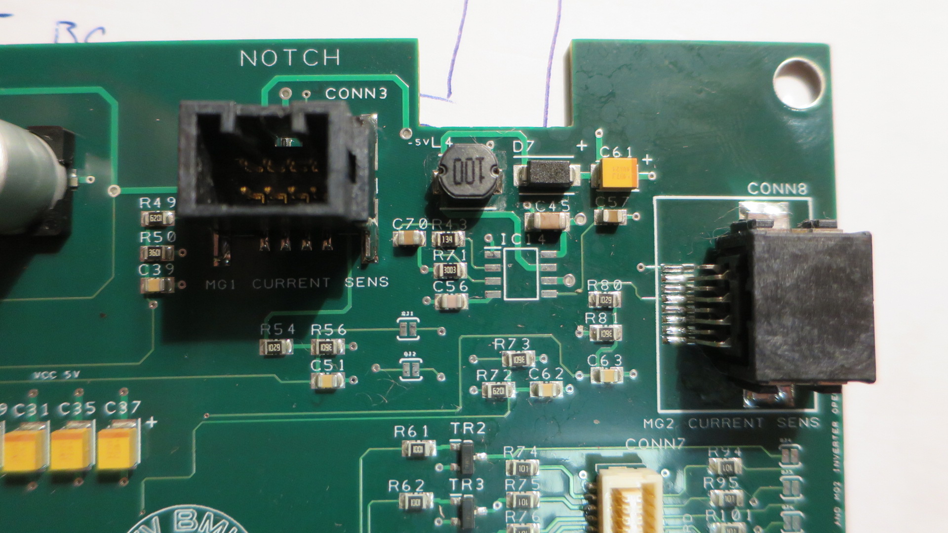

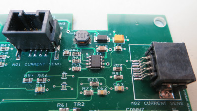

But what about the MG2 current sensor socket of the Yaris board? Found in the Wiki that pins could be reversed and “will kill the -5v output of PS1”. But with note “This is Block ii version and below.”
What does that mean? :?:

moebelschmitt wrote: Fri Mar 29, 2024 8:46 am But what about the MG2 current sensor socket of the Yaris board? Found in the Wiki that pins could be reversed and “will kill the -5v output of PS1”. But with note “This is Block ii version and below.”
If I remember correctly then that Block version is written on the board
