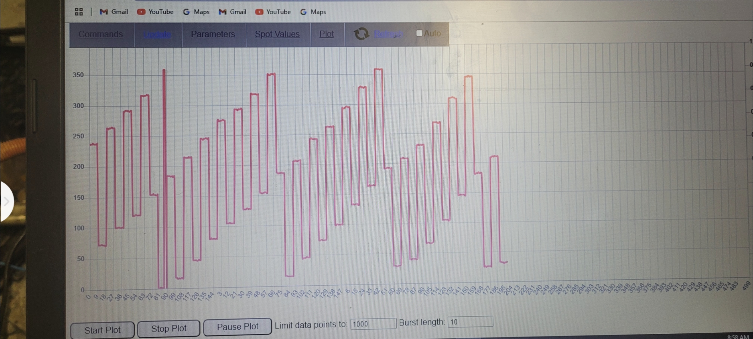

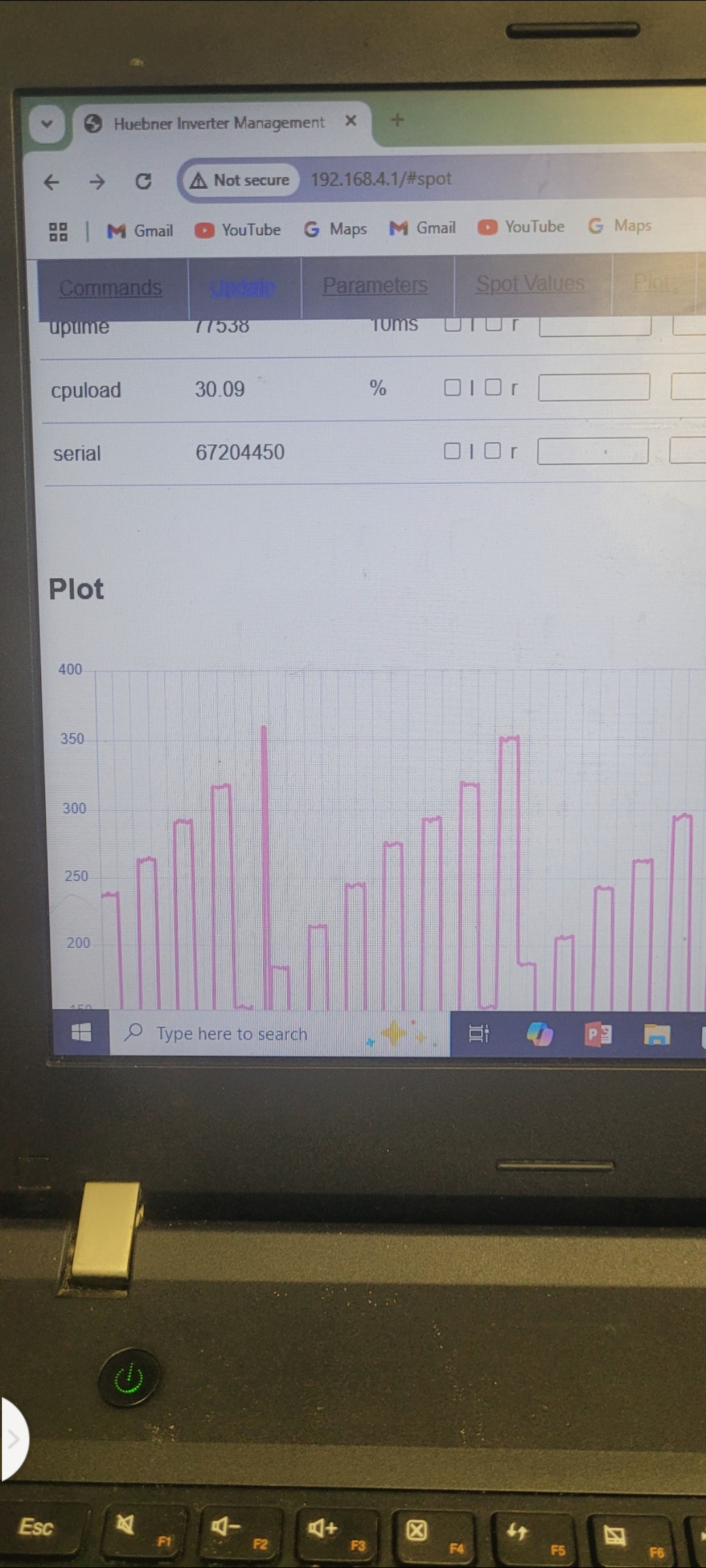

At this stage motor feedback is irrelevant. Can you scope the phase output? Probe ground on HV-, probe tip on L1, L2, L3. Are you getting the PWM with varying duty cycle there?
voti
Posts: 135
Joined: Wed Oct 02, 2024 12:35 pm
Has thanked: 19 times
Been thanked: 15 times
Re: EV Conversion using prius gen 2 inverter/transaxle
Post by voti »
Please don't mind the noise on the scope but I think the duty cycle with PWM is there
