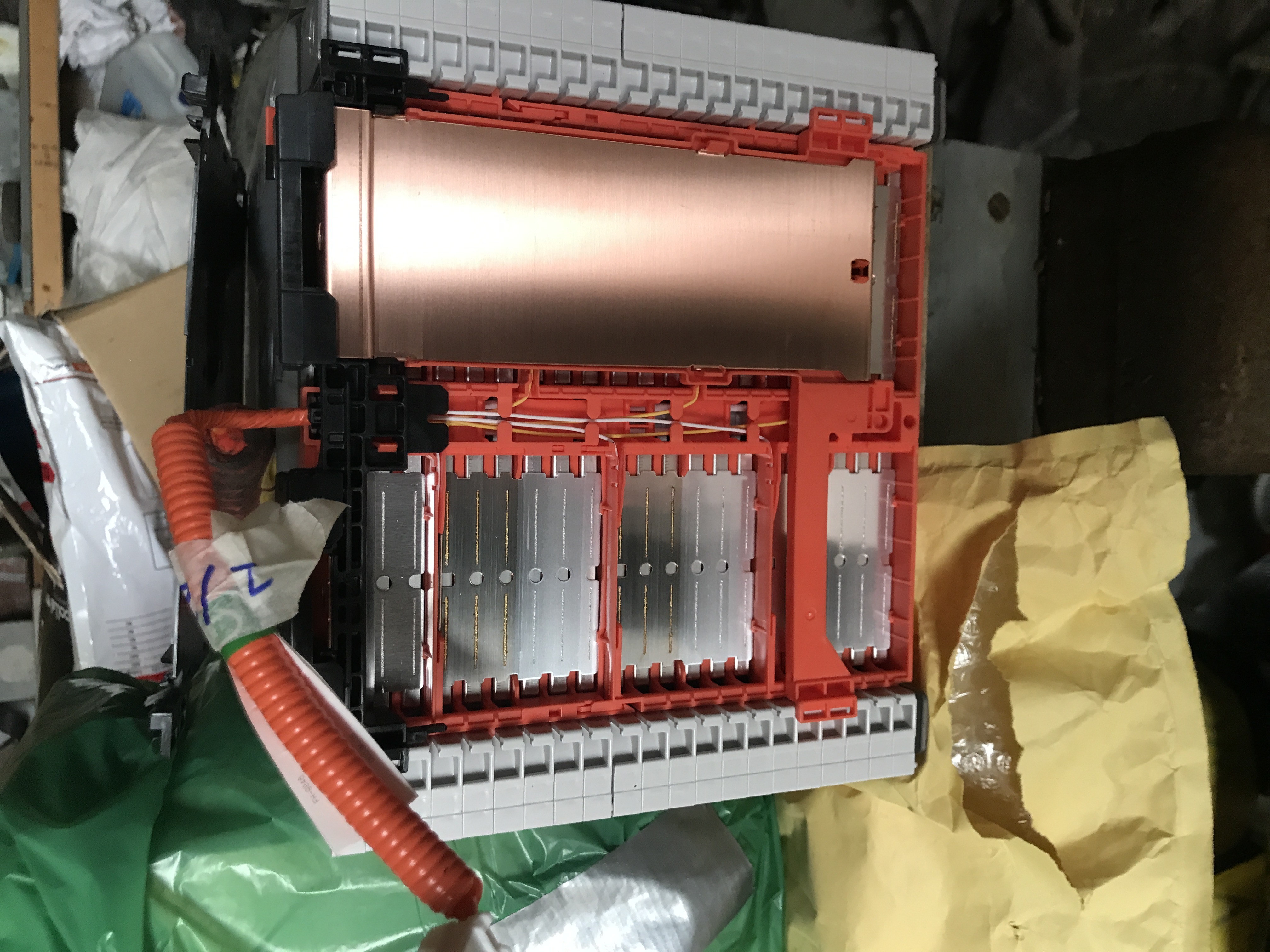

Burn marks on the input/filtering/balancing circuits on one place, so the last connector in this case
BMS is always connected last and disconnected first. The pack is split in two as you mention, so is the BMS circuity in terms of protections for over voltages, thus no electrical references between the halves.

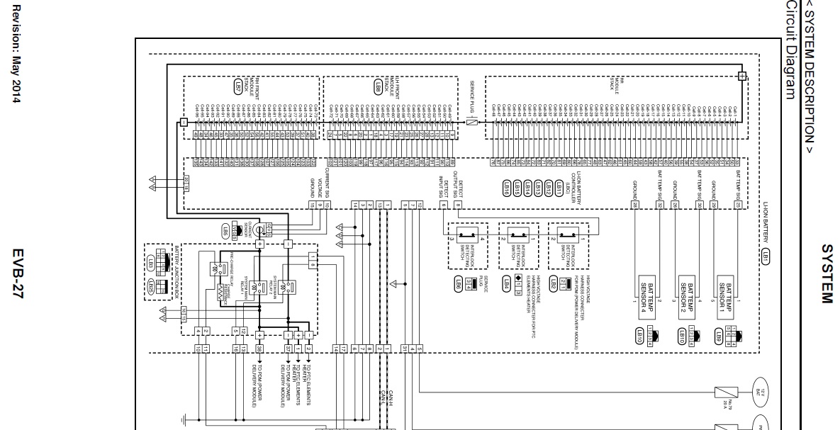

The LEAF30KW battery diagram (EVB.pdf) is available on Google. The BMS module connectors are completely identical. You can take measurements on all 4 connectors with a tester. Just be very careful, smoke may start coming out of you.

The Service Disconnect has NO influence on the BMS.
The BMS is electrically divided in two, the two halves are coupled in their communication by an opto-coupler (galvanic isolation). The is specifically so you can pull the Service Disconnect while there still is some load on the battery output, because at that instant, the full pack voltage will be across the service disconnect *in reverse*.
The BMS consists of a processor with a UART I/O and 24 ASICs that each handle 4 cells, the processor UART output connects to the first ASIC input through an opto-coupler, from there a simple level shifter connects every next ASIC to the previous one. Between ASIC 12 and 13 is the mid-pack Opto coupler (just like the Service Disconnect is in the middle of the pack), then again at the end of the chain ASIC 24 output connects via an opto coupler to the processor UART input. The processor addresses each of the 24 ASICS and each ASIC inspects the serial message if it has their address, if not they simply repeat the message on their output. If the address matches, they decode the message and send a reply, which will ripple further through the chain until it reaches the processor.
The important part is that each ASIC is connected to 4 cells, so it is *powered* from the 10-16V that the 4 series cells carry and the ASIC can also measure and balance the cells under control of the processor by applying a 430 Ohm resistor across any cell to slowly bleed off some energy and lower the State of Charge when necessary due to good cells having lower self discharge than marginal cells. Or temperature difference or ....
If the 4 cells are not connected in the order expected, the ASIC may see a negative voltage or a too high voltage and since there is no protection in the cell connections, that will burn a small crater in the ASIC(s).
Most common mistake is to use a wiring harness from a different generation than the BMS, because the connectors are physically compatible but the cell connections to the connector pins is different between generations. Poof.
Also if you have modified the bus bars and the cells are not connected in the same order in the string as original, then the BMS wiring will connect cells NOT in the same order as the BMS has the ASICs connected to each other: POOF. Lastly, if the cells are in the correct order, but you modified the BMS harness because you re-distributed the modules (I changed the pack for my truck into 3 stacks of 4 plus 4 stacks of 9 modules, so I had to modify the BMS wiring a LOT!) then your best bet before you plug in the BMS is to grab a DVM and a thin solid core wire or thin sewing needle that you clip into your Voltmeter clips and you *measure* *every* pin in the 4 connectors that plug the 96 cells into the BMS, so you can be *sure* that every cell is connected correctly. The Service manual has a nice schematic for the LBC connections, so use the tools and take the time to avoid letting the smoke out, I have never blown a BMS myself and I completely rewired several packs.

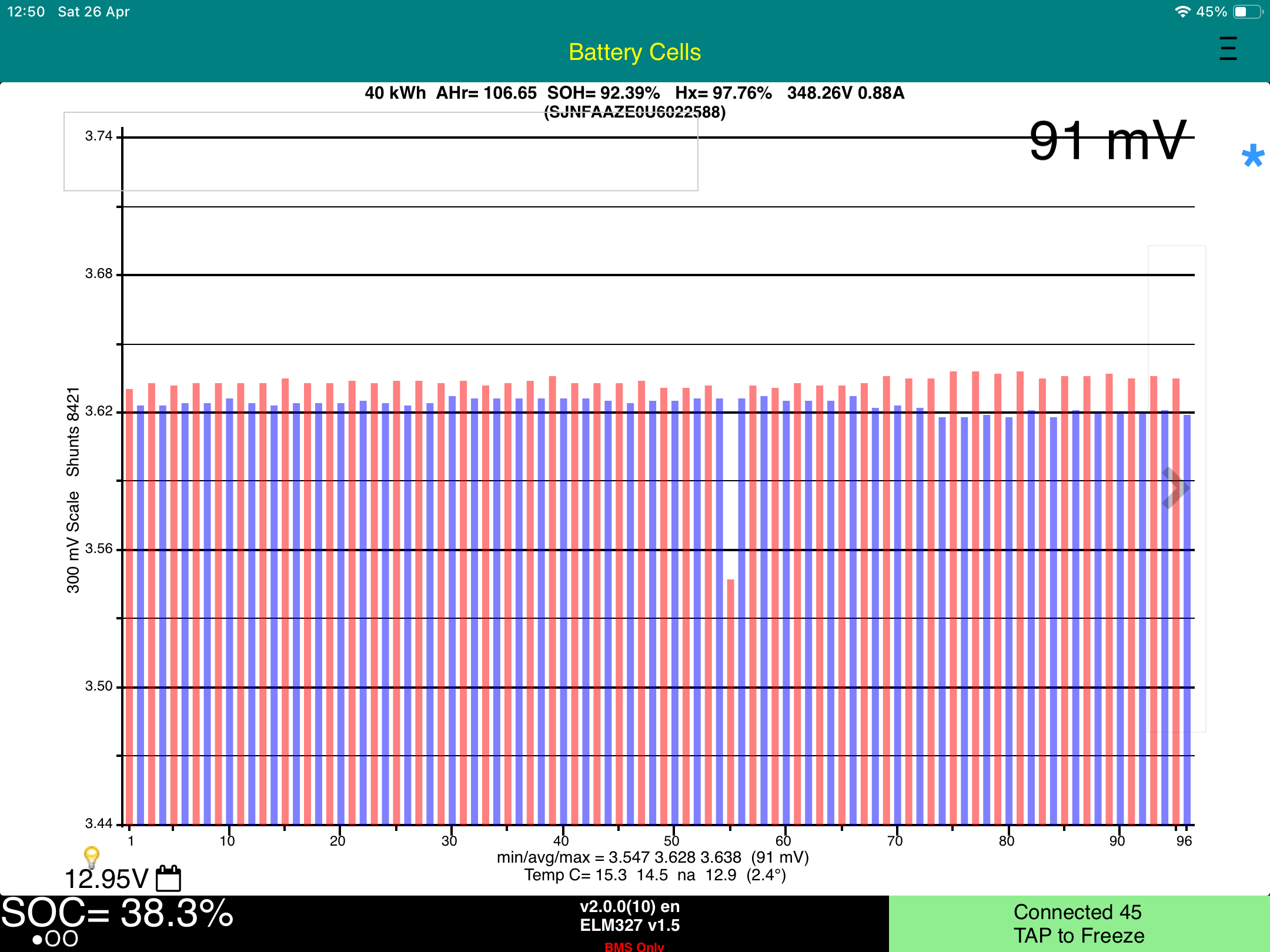

Final point for now is leaf spy and the BMS. I’m unsure of the Leaf Spy logic. The motor stack is a 30kWh. The battery is 60kWh. The replacement BMS I believed was from a 62kWh. But Leaf Spy says 40kWh. Is it confused by my mix of components and makes a best guess? Perhaps the BMS was actually from a 40.
I can force it to 60 by switching the settings and saying explicitly it is 60/62 BMS. But by default on startup it is back to 40.
Here’s an image. Yes I know cell 55 is weak. Realised when I bought it, and decided to push that can down the road. I guess I’ve just caught up with the can. Edit - due to the construction of the 60/62 battery, you can’t swap individual cells, so it would be a complete module - think it’s module 9, one of the tall ones.
Edit - also you can see the last set of cells do show a different voltage. Either this is 40 / 60 BMS situation, or because of the cell taps extensions for these. I’ve been warned about potential anomalies with BMS wire extensions.

Leaf Spy shows AHr=106.65 this is probably BMS40.

I think the question I need to clarify is whether my reported capacity is incorrect due to a possible 40kWh BMS with a 60kWh battery.
This is a question I would appreciate input from anyone reading with experience. I know in the Leaf world people use a CANBridge to spoof the can data to get a leaf to to display correct mileage. But that’s when swapping a complete battery with its internal BMS. In my case I’ve got a swapped BMS and I’m unclear what affect that has.

Marat wrote: Sat Apr 26, 2025 1:41 pm Leaf Spy shows AHr=106.65 this is probably BMS40.
Thanks for clarifying. What affect do you think this would have on reported battery capacity do you think?

Went for a drive. Went up to 50mph this time, all the while listening to every creak and bang from the road and hoping nothing serious was happening. My poor old bus has all its internal panels and insulation stripped out at the moment, and I can’t shut the internal engine hatch currently due to the way the coolant tank is temporarily poking through. So noisy is an understatement.
My weak cell is a concern. I called it a day on the test when I could see on LeafSpy the weak one was down to 3.50 while the others were up around 3.70. Have decided replacing this module is a priority now.
Trickle charge that cell back up with a bench power supply before you do more testing

Everything I’ve read suggests when you have a cell so far out it’s more likely a manufacturing defect. Even if you get it back to match the others, it’ll drop out of sync again. But I don’t claim expert personal knowledge on this.

ianlighting wrote: Mon Apr 28, 2025 2:29 pm Everything I’ve read suggests when you have a cell so far out it’s more likely a manufacturing defect. Even if you get it back to match the others, it’ll drop out of sync again. But I don’t claim expert personal knowledge on this.
If it holds it holds. Better off temporarily balanced than how you are currently using it

Bratitude wrote: Mon Apr 28, 2025 2:45 pm If it holds it holds. Better off temporarily balanced than how you are currently using it
Bit concerned that due to the construction of these modules from the 60/62kwh version of leaf, you can’t access individual cells. The BMS cable breaks out to 9 pins in this case (27 cells for a tall module) the module itself is 3p. So when leaf spy says ‘cell 55’, that’s the best granularity it can provide, but I actually have 3 cells that are ‘55’, and no way of knowing which of the 3 is suspect. If I was to directly charge using the relevant BMS pin, I can’t actually be sure how each of the 3 are performing.
And I need to buy a charger / power supply…
Example image of a medium size module with the front plastic removed. This example has 7 pins in the BMS wiring, for its 21 cells.

If you have cell taps, you can trickle charge the cell back up. A multi meter is all you need to find said cell.
