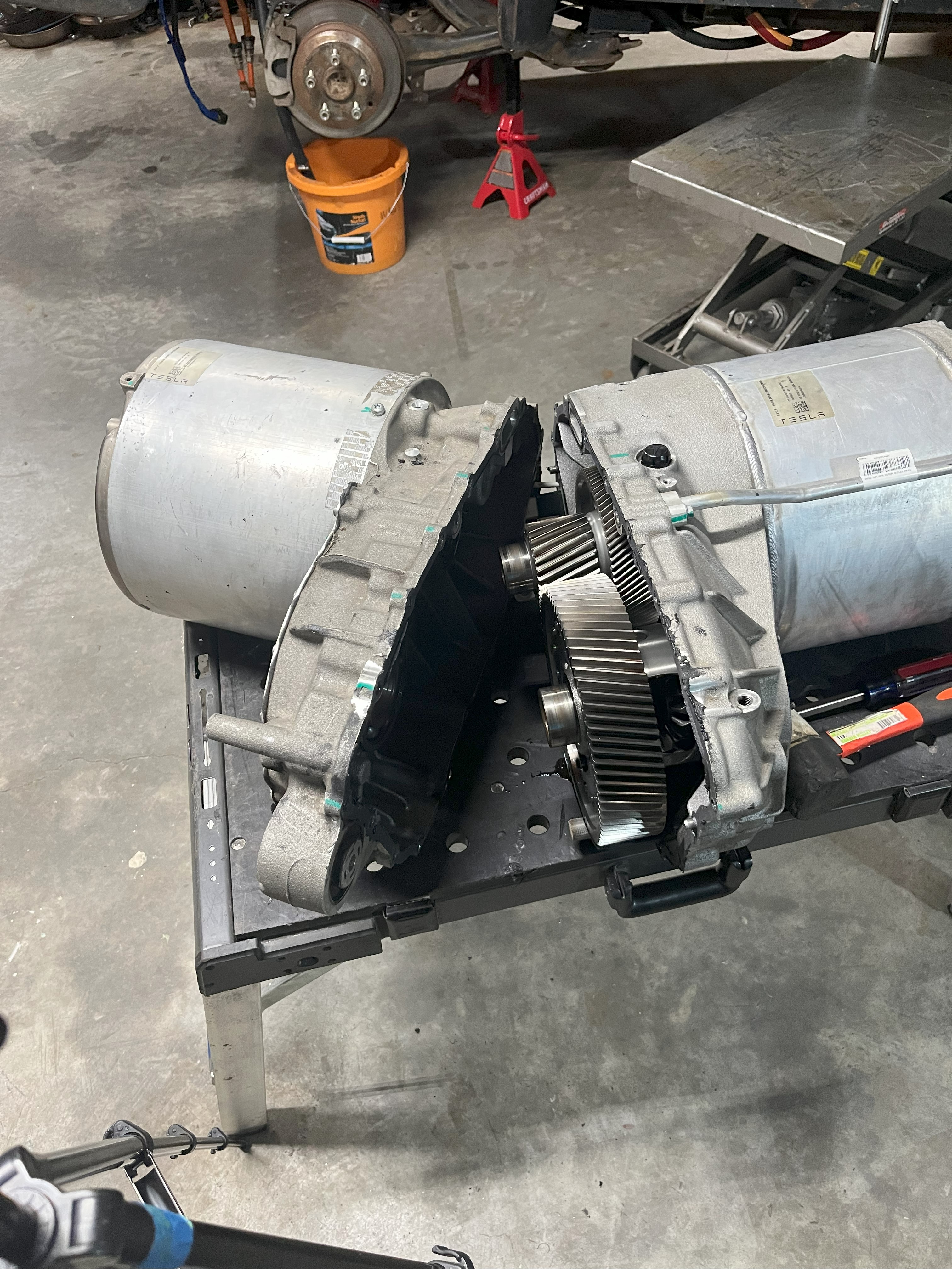

Well the Base unit is fighting just about as hard as it can to avoid me installing the Sport unit.
I got it out of the car relatively easily, though I did realize halfway through that I needed to raise the car another 3 notches on the jack stands to get my hydraulic table under the front of the unit. Then began the issues.
The adapter plates do not want to come out of the unit. No amount of pry bars or slide hammers, or swearing would get them to move. Even managed to pinch my hand in the slide hammer, that was real fun. Saturday, I did some Google-ing, and the only solution I hadn't yet tried was an axle popper fork (actual name) so I found one Amazon said they could overnight to me, arriving before 11am on Easter Sunday. Fantastic! Except its now Monday and I still have not gotten it. Less fantastic!
On the Sport unit there's better news. I opened up the gear box andddddddd its fine. No broken gears, fairly clean oil, I've got no idea why this unit was pulled. Unfortunately, while reassembling, I managed to snap the very last bolt I tightened. Of course it was one that could not be reached with any tools unless the unit was disassembled again. So I did that yesterday, got the bolt out, and replaced it with one off the base unit.
I also removed the inverter from the base unit, partially out of curiosity, partially to facilitate its eventual repair, and partially to keep it protected. In doing so, I don't see clear signs of coolant entering from the motor bus bars, so I wonder if part of the inverter cooling cracked when the unit was ripped out of the car at the end of DW. I need to do more investigation there.
Long story short: If I can get the damn adapter plates out of the base unit, I can get the sport one in the car and hopefully driving again in short order. Hopefully.

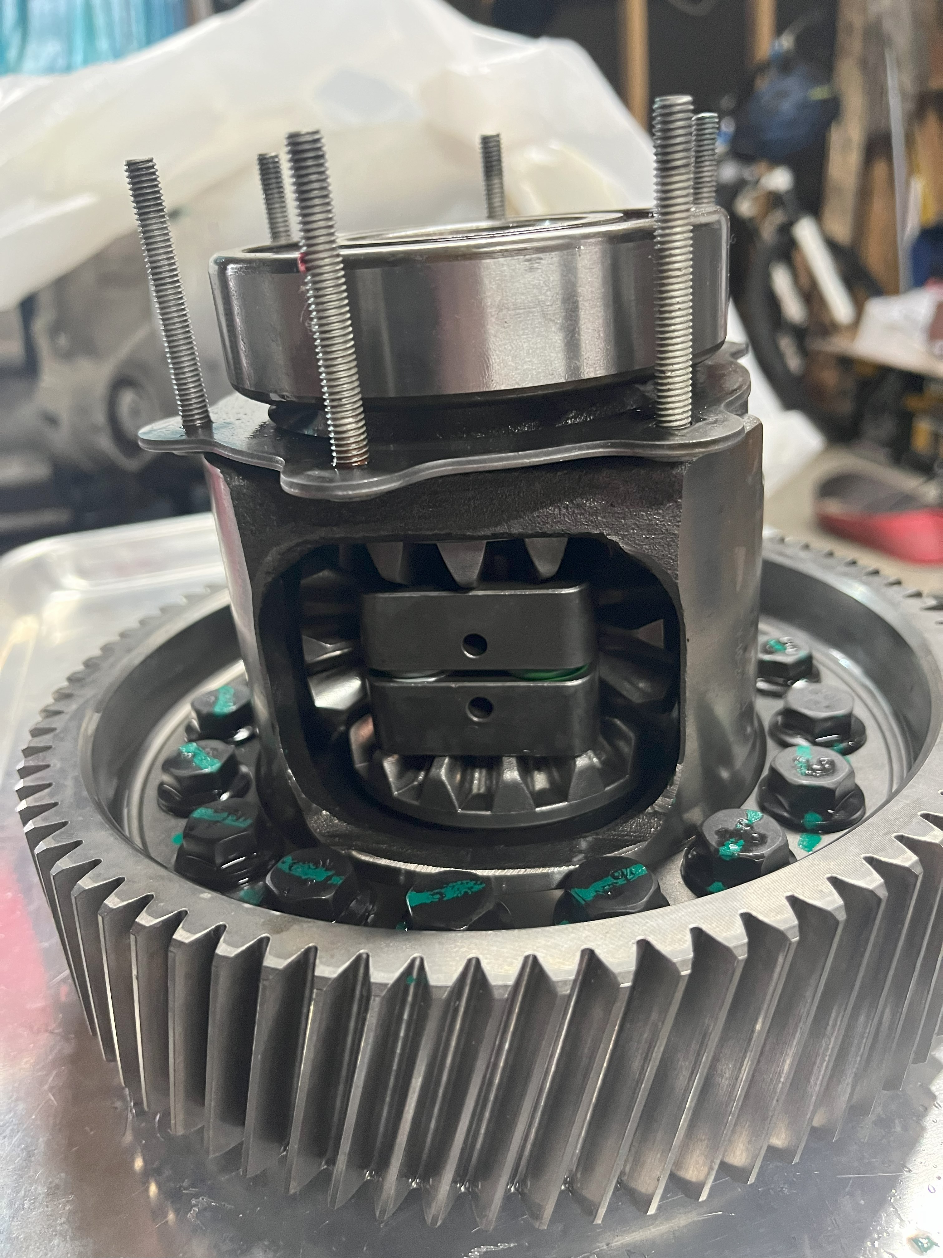

I have finished installing a limited slip conversion kit from Traction Concepts. This uses the stock open diff and adds limited slip components. It took longer to prep and install than I thought it would, but I'm happy with the fitment. Looking forward to testing it soon.

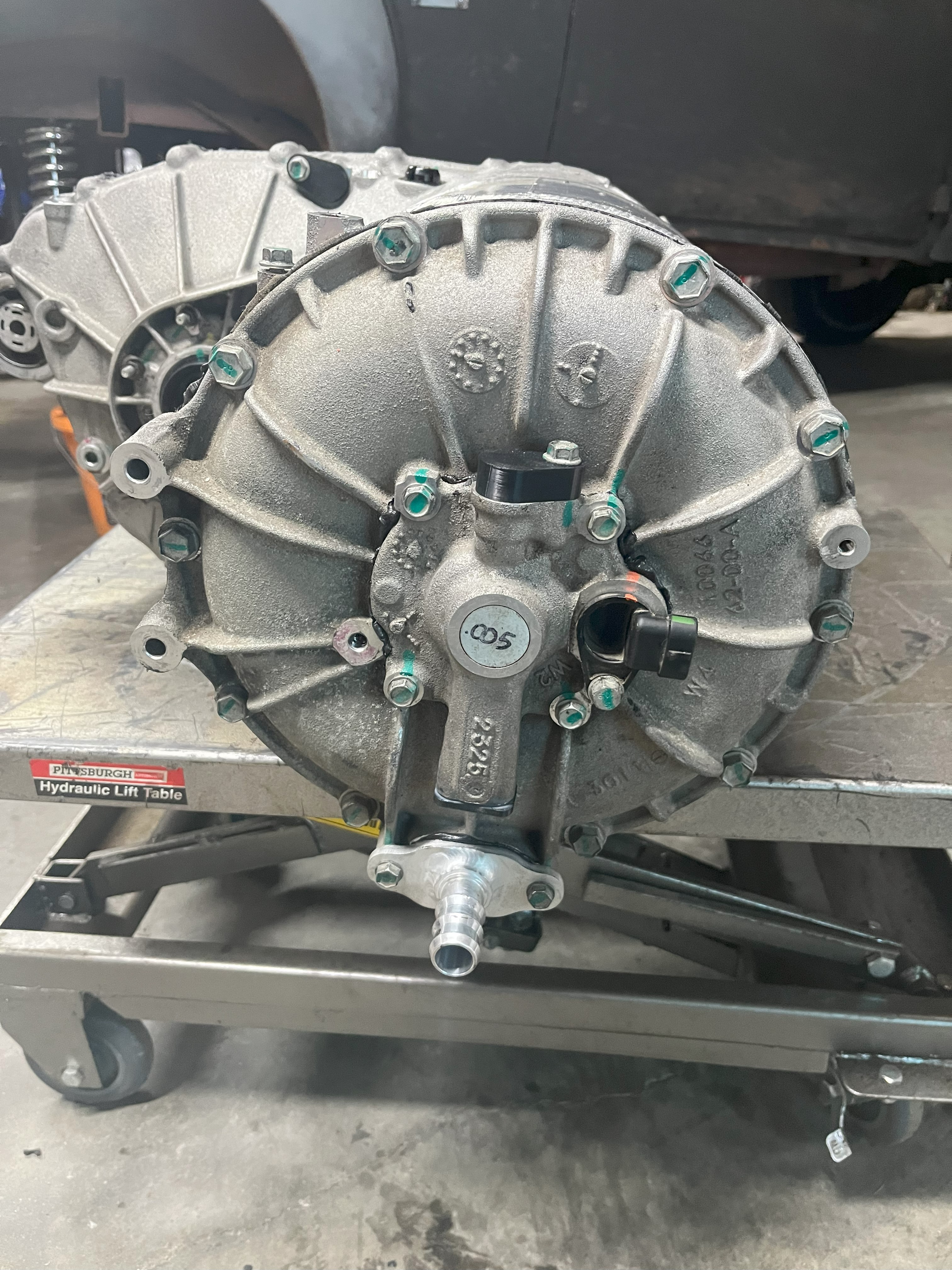

I also installed a rotor coolant delete kit from EV Muscle Cars (aka Kevin Erikson, aka Electrolite guy). Rather than the full billet pieces from Revolt or QC Charge, this modifies the existing coolant manifold to eliminate the rotor cooling and then block off the rotor cooling passageways. It includes a nice TIG welded hose barb/flange, and 3D printed block off pieces.

To be frank, I don't know. I am mildly concerned deleting rotor cooling could be an issue, but I'm also not willing to let a coolant leak take the car off the road again.
Here's what I was able to figure out:
  • Replacement seals are hit or miss, and one of the more common options would limit the speed to around 100mph, which is a problem for racing.
  • It appears Tesla did develop a coolant delete manifold themselves for the -U revision drive units and later.
  • I can find no evidence of Tesla's delete manifold in the wild. It appears on a parts list and one or two service photos, but I can find no reports from Model S owners with a delete manifold. There's also no word on whether those drive units were derated in any way
  • It does appear that those running the aftermarket/DIY delete manifold are not seeing noticeable issues from deleting rotor cooling.
  • One of the billet options does maintain cooling via oil and a heat exchanger, but in my opinion that doesn't do enough on the inverter failure problem. I have also seen an option to modify the inverter housing with a drain, which really seems like a ridiculous approach.
I think over the next 6-18 months, we should know pretty definitively whether rotor cooling was necessary. I'm going on Drag Week again in September; if it survives that, I think it'll be safe to say the rotor cooling was overkill.

Well I was really hoping to be posting this evening about driving the car for the first time in months, and how great the Sport LDU is, and how I'm taking it to cars and coffee in the morning. But alas, the car continues to fight me.
When I bought the sport LDU last summer, I was told it was pulled from the guy's Model S because something failed in the gear box. He could hear the motor trying to turn but no forward motion. So when I went to put it in the car this spring, I opened the gear box, found no gear damage, then tested with just a axle stub, and everything turned, so I went ahead with installing the LSD and coolant delete, and then installing the unit in the car. Today, after finishing the install, I went to drive it, and the motor spun but the car didn't move. Clearly the test with the axle stub was not enough load to show the damage.
After removing it from the car and tearing down the gear box completely this time, I found what I'd feared - the splines on the rotor shaft and its accompanying gear have stripped.
Fortunately, I have the old base unit sitting in the garage half torn apart. Unfortunately, the old adapter plates are still stuck in it, so I can't get into the case. I'm not going to just swap the sport inverter into the base LDU, because the base case has some damage, the thermistor wires are damaged, and I really want the LSD.
My tentative plan (which I am going to sleep on and decide in the morning) is that I will cut one of the old adapters in half so that I can open the base case, then take the first gear and rotor out of the base, and install them in the sport. Then put everything back together and back into the car. I don't like the idea of destroying the adapter, but I've run out of ways to try to remove them, and the parts I need to fix the new unit are sitting right there - buying new parts would be ridiculous.

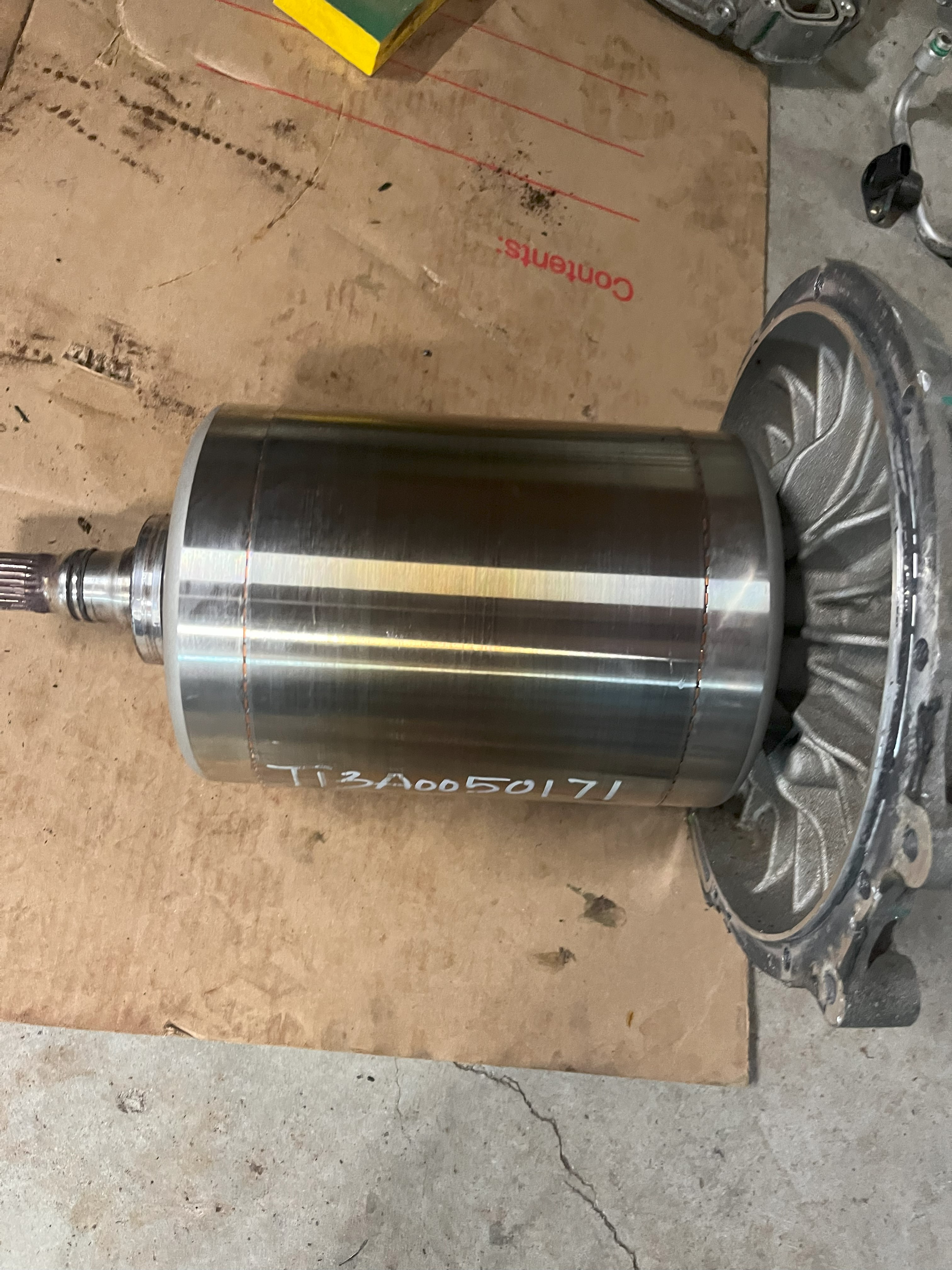

Here's what the rotor shaft of the Sport drive unit looked like:
And the shaft of the Base rotor, in much better shape.
The Base clearly had a coolant leak for longer than I thought. It cleaned up pretty quickly with sand paper and a kitchen scrubbing pad.
The Sport rotor was in much better shape (apart from the stripped shaft.
Two comparisons of the two rotors. In my mildly educated opinion, the differences represent design updates more than a Sport vs Base difference. The center section of the rotors appear identical, the ends are different. The Sport moves the mass to the outside, allowing easier access for a bearing puller (I had to modify my puller to get it behind the bearing on the Base rotor).
I am still working on cutting through the old adapters on the base unit so that I can open the case and get to the gear I need. I'm also not entirely sure the rotor bearing seated correctly when I installed the base rotor into the Sport case. Not a bearing or case issue, just a factor of me rushing. I'll check that before I finish putting things together. Speaking of bearings, both rotors had less than good encoder-end bearings, so I pulled the gearbox-end bearing from the Sport rotor and put it on the Base rotor encoder-end. This will be truly a Dr. Frankenstein's monster of a drive unit, but it will get me back on the road (I hope).
I am wondering if there is any way to swap the shafts between the rotors, but I have so much to do on the car and so little time that slapping it back together is going to have to be enough.

I think you're right. the rotor on my sport unit looks like your base.
