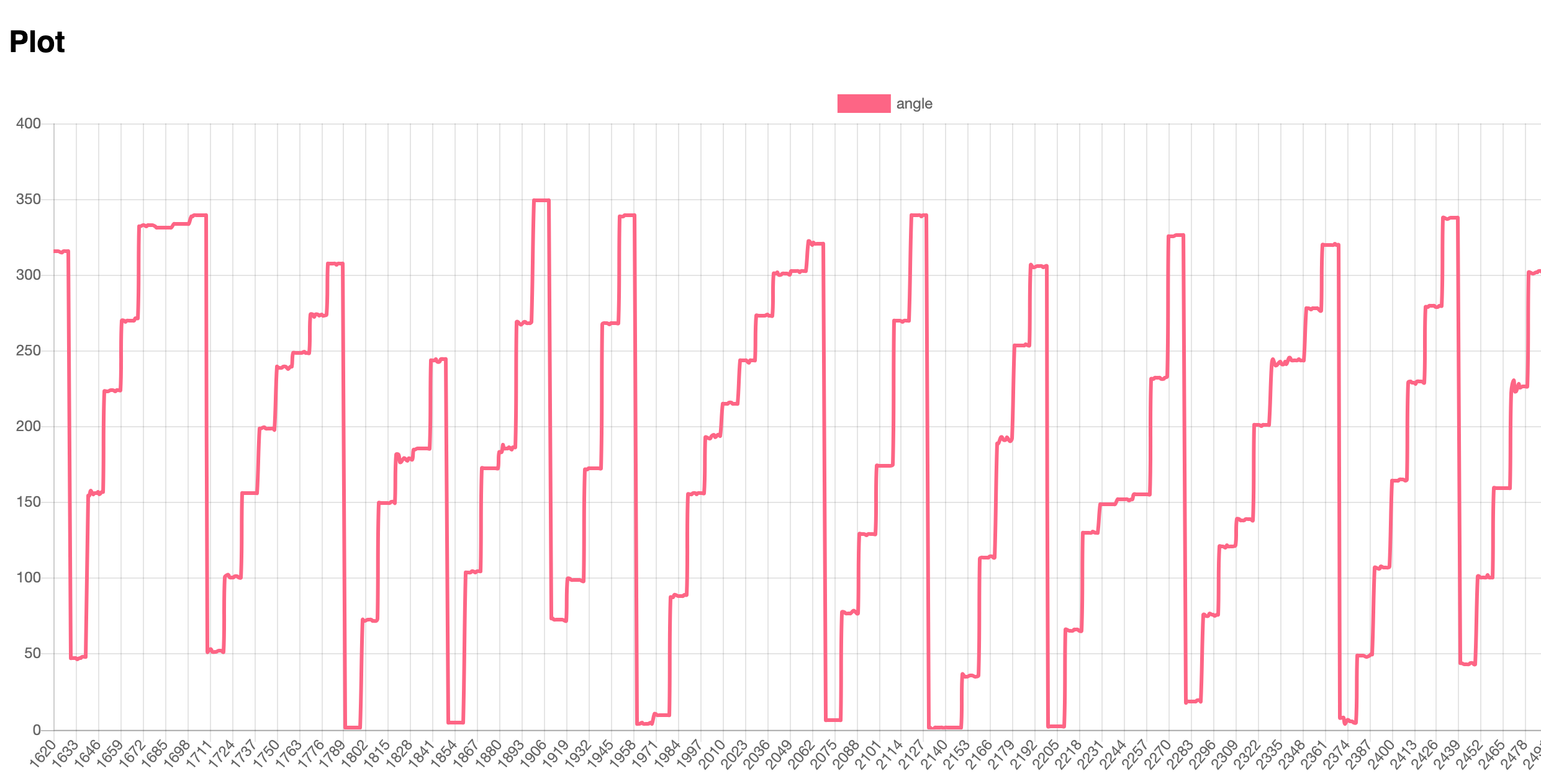

oops, been a long week. It seems the angle plot doesn't work. I tried resolver check and nothing. Swapped to a release version (4.94) and resolver works fine.
Not sure, need to debug further maybe probe the stm32 pinEdit - udc sounds like a software rather than hardware issue but not sure what it could be, do all the other analogue inputs work?

Might have found it. The resolver code is working fine, the value just isn't getting written to the angle spot value correctly.
Line 355 of pwmgeneration-foc.cpp needs to change from
To
Sorry about that
Will update on the PC and push to github tomorrow.
Param::Set(Param::angle, DIGIT_TO_DEGREE(angle)); Code: Select all
Param::SetFixed(Param::angle, DIGIT_TO_DEGREE(angle)); - Bigpie

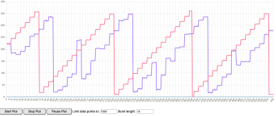

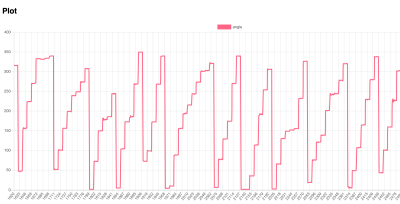

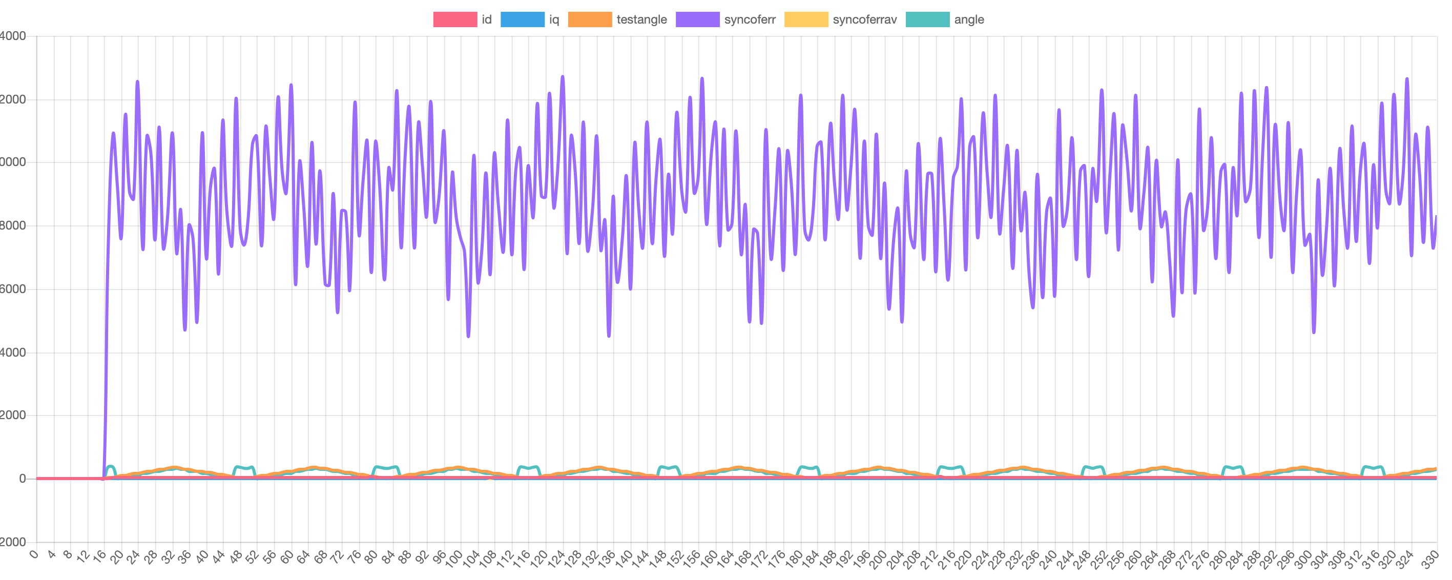

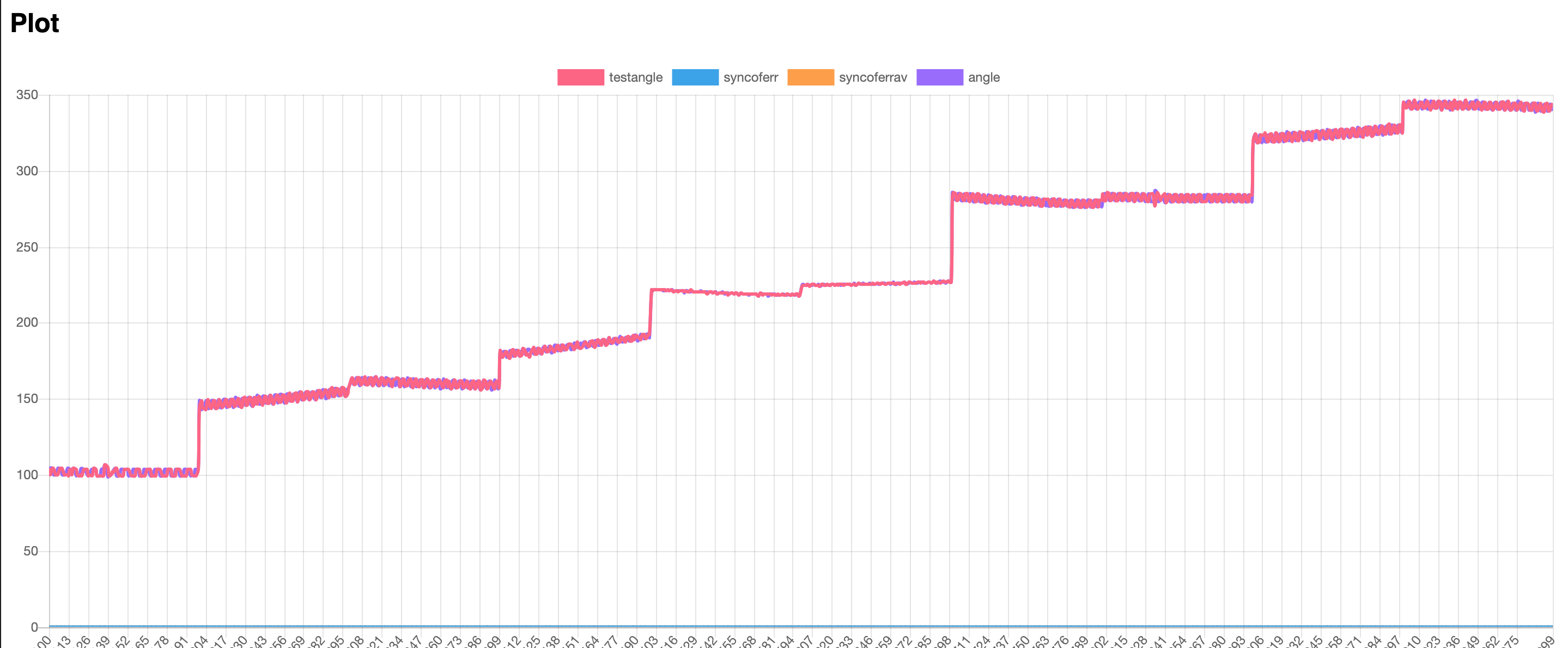

Seems to plot now, suspiciously the angle and test angle seem to be the same regardless of syncoffs value

Re: IPM Motor - Auto-setup
One step forward ......
Doesn't look right, fairly sure both are showing the resolver angle but no idea why, had another look through the code and it seems to be ok. Does a resolver check now read the angle correctly?
Could you try grabbing a plot with both the plot size and burst length set to 1000 to see what it looks like then?
Long shot but might be worth doing a full chip erase and reloading the code. Bit suspicious that going back from 5.27 to earlier versions leaves something in flash that the parameter store doesn't like, if so an erase and reload might help??
Edit - just trying a couple of things here and I'm having trouble getting the plotting to work well enough, best seems to be with burst set to 1 and 100 data points (anything else gives a stepped waveform due to the bursts).
Edit2 - Even then there are sometimes fairly nasty plotting artefacts. Going to code up the syncoferror stuff which should give better results.

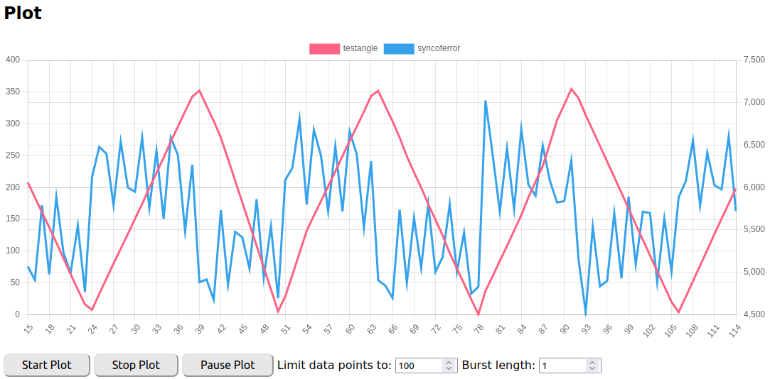

The angle plot looks ok in resolver test mode.

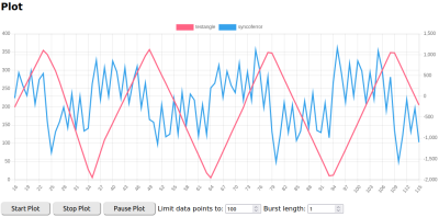

Looks OK, not sure what to make of the test angle bug
Just done the sync error bit on the F405 (as that's what I can test here), results look ok. This is what a plot looks like with syncofs set to 0: You can see the average value of the syncoferror is around 5800. If this value is then written to the syncofs parameter you then get: So an average error of 0 (allowing for the offset due to rotor drag/id only drive in each direction).
Tried filtering the error signal but could only get the IIR filter to work well with floating point arithmetic, which is no good on the F103, so the user will just have to visually average it for now. There are other averaging approaches I could try on the F103 but see if this works first.
Going to port it over to the F103 now and then push to github, will post here when done.
Edit - Changes now on github in the auto-setup-withlogging branch.

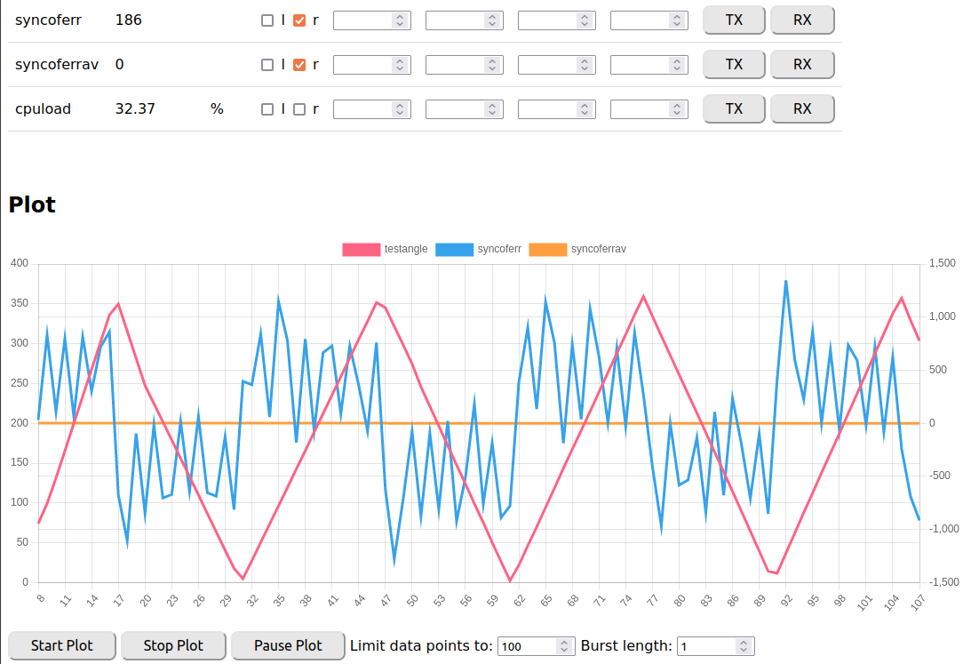

Averaging now working. Added an extra parameter syncofferrav (need a better name!) which is updated once per motor cycle and contains the error, on my setup it is surprisingly clean and gives an offset repeatable to within around 10 units!
This is the result with syncofs set to 0: after it's run for a few motor cycles the value of syncoferrav is the value that should be written to syncofs (as long as syncofs was previously 0), in this case 5681.
If the test is then rerun you get this: error of 0 now reported.
Worth noting that syncoferr is always reported as a signed number (to stop errors around 0 causing the plot range to go from 0 to 65535) while syncoferrav is always reported as an unsigned number so that it is easy to use it to set syncofs. Not quite intuitive (especially if syncoferr is negative) but it seems to be the best compromise.

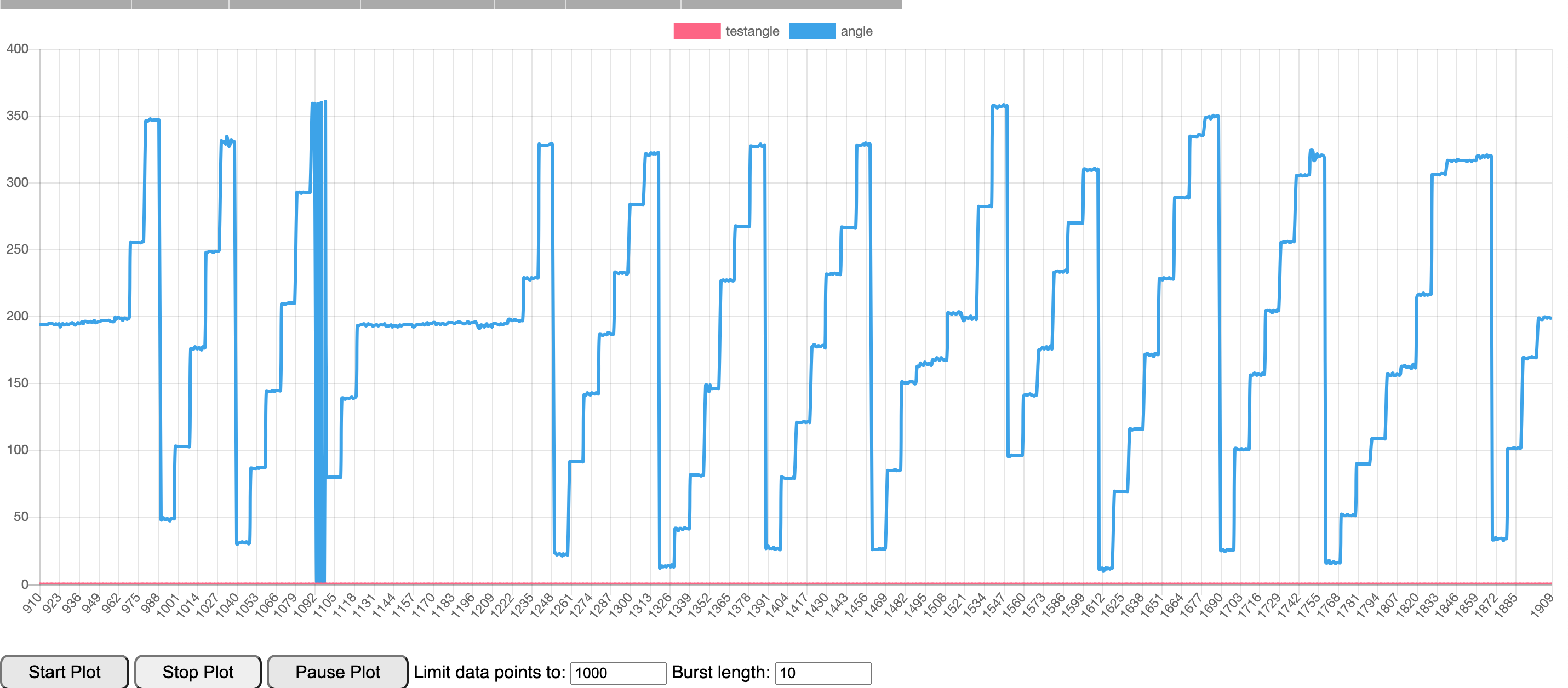

Still the same for me, nothing jumps out from the code, but I'm not an expert
Values are exactly the same

I was hoping it was just a problem reading the parameter (and so the new code would still work) but it looks like it is something actually in the test code. I'll have another look
No idea! Had another look through the code and I just can't see how they can be the same.
If you plot both in resolver check mode do they still track (testangle shouldn't be updated at all in that mode)?
Assume the value of syncofs still has no effect on them in test spin modes?

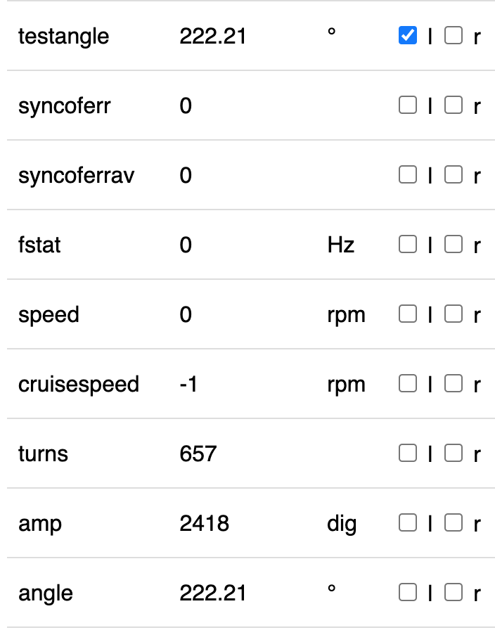

Test angle stays at 0 in resolver check EDIT
is this macro the issue
should it be?
#define DIGIT_TO_DEGREE(a) FP_FROMINT(angle) / (65536 / 360)Code: Select all
#define DIGIT_TO_DEGREE(a) FP_FROMINT(a) / (65536 / 360)BMW E91 2006

Just pushed the change to github and was just about to post here, found it around the same time as you by the look of it!
Hopefully that will sort it
Edit - this is why I dislike burying too much in macros, I must have looked at that line a hundred times without diving into it because it has always worked!

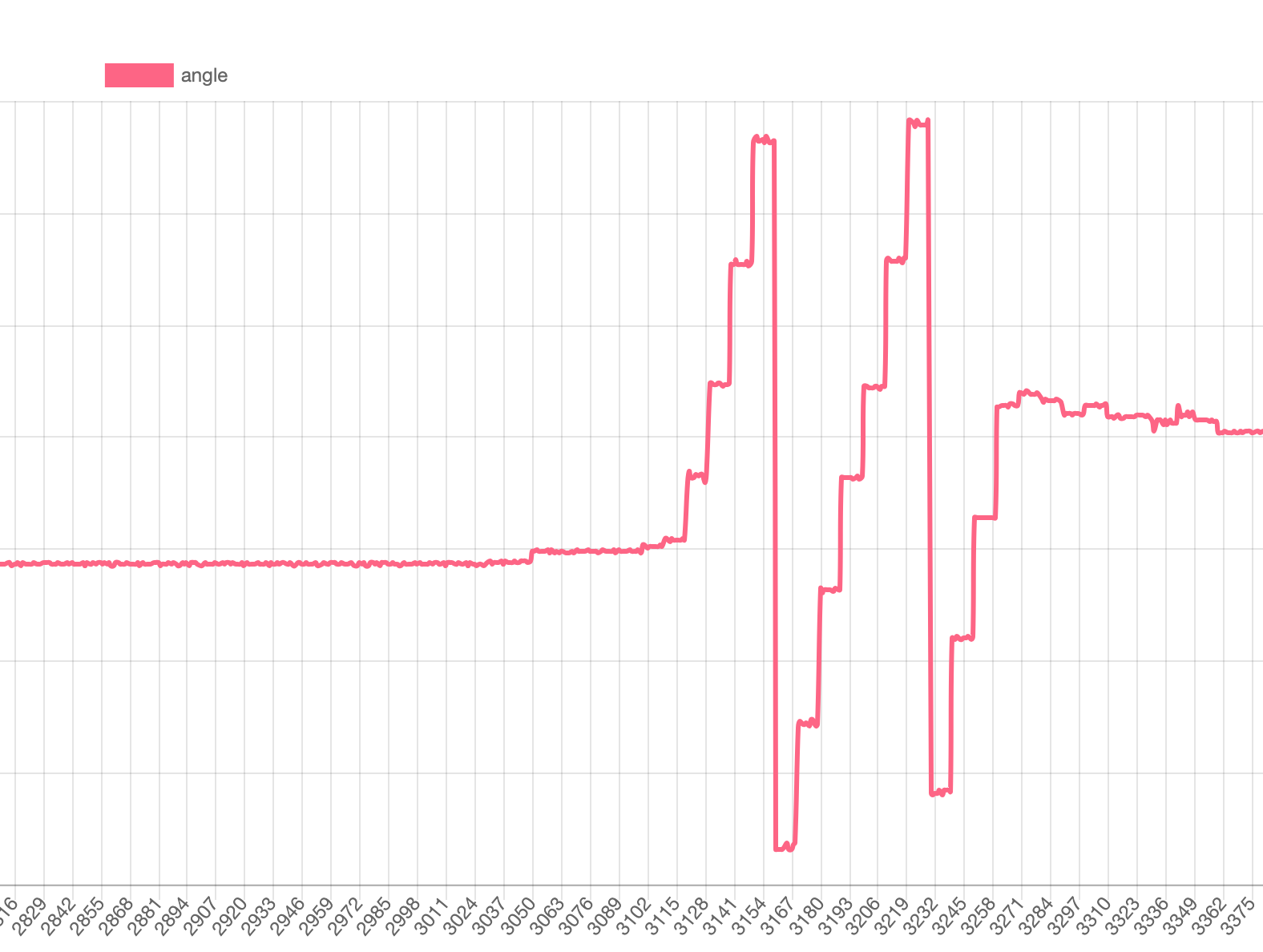

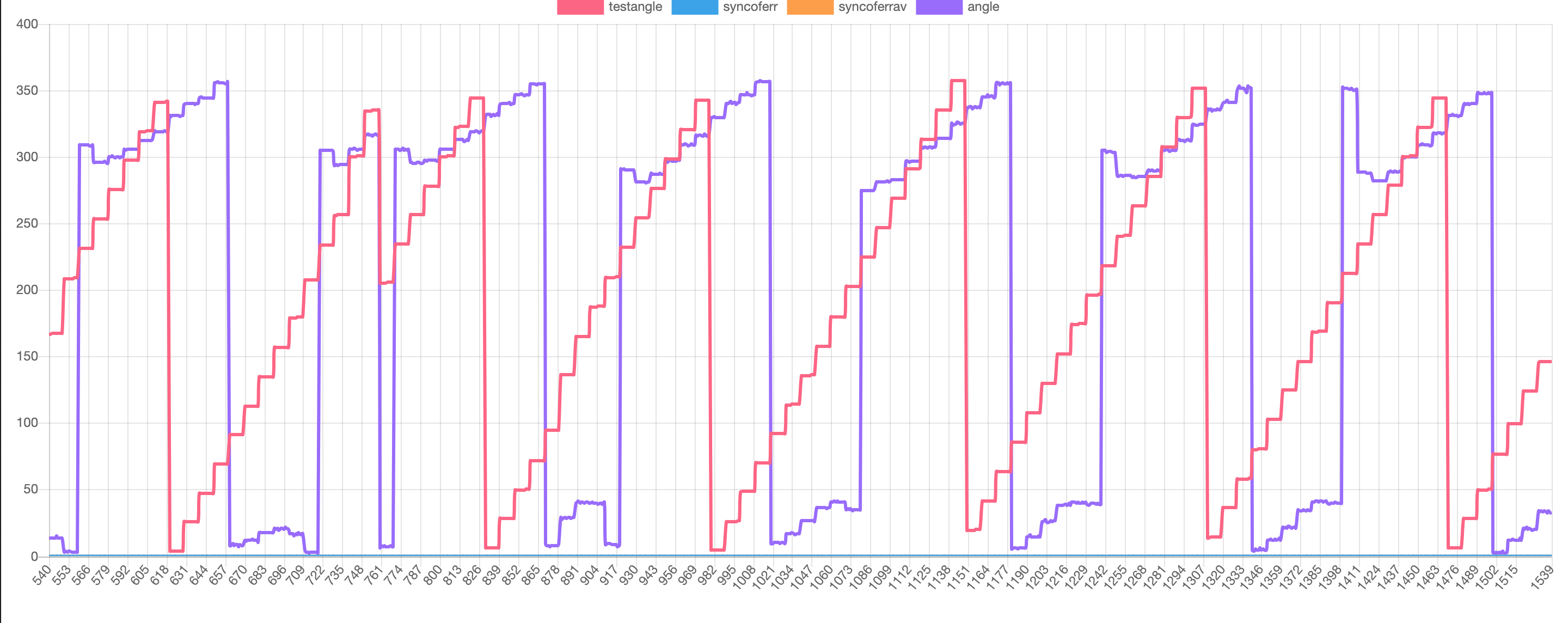

Getting there now. Forward test doesn't spin anymore though. It starts to rotate then rotates back. I tried more Id but no full rotation.
This one shows I had incorrect ratio for motor pole pairs and resolver pole pairs Forgot to screenshot the bidir test.

Looking good
No idea why the forward test isn't working now, had changed a small bit of the code round there (just to zero the error parameters in that mode) but nothing that should affect the rotation. Just had a look over it and can't see anything obvious.
Looks like there are still some plotting artefacts there that aren't helping. I've started using a burst length of 1 which seems to help a little.
Looking forward to seeing whether the calculated offset it gives matches the value you found before.
Thanks for all the testing and debugging!
Edit - One thought, what values are you using for curkp and curki, are they sensible for the motor inductance? If the loops are a little unstable that could cause problems on the forward and bidir tests. Might be worth plotting the currents to see what they are doing?

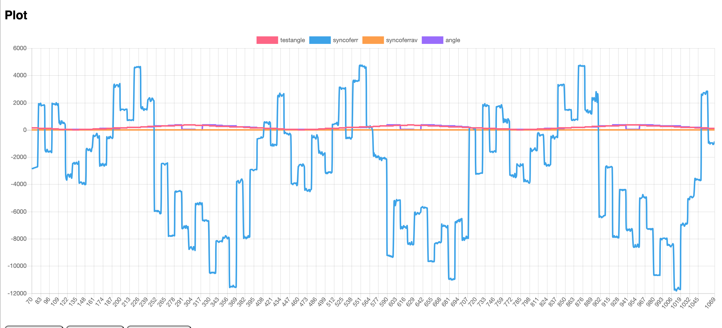

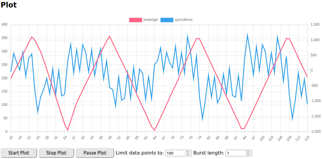

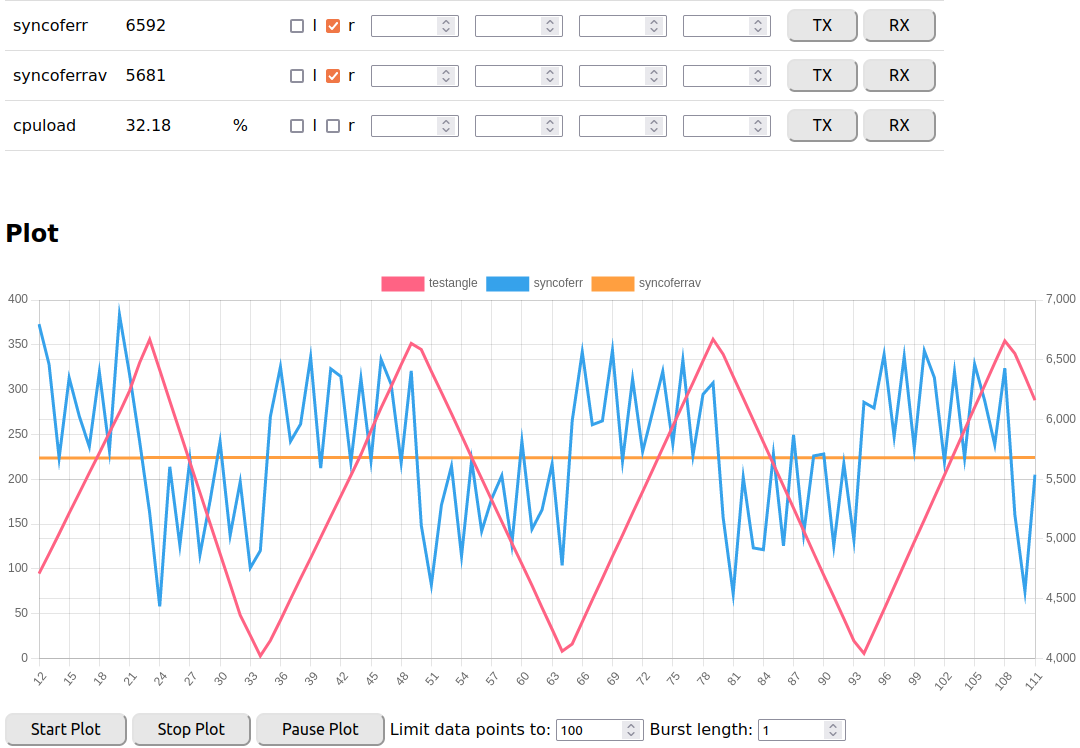

I'm using same values for those that I use in the car.
I let it run a minute and it resulted in an average error of 11778.
I put this in syncofs and run another minute
average error was 0 after this.
I then though I'd try normal running and the motor started spinning up and accelerating without any throttle input. Still progress
Packing up for the night for sure now
Looking good although it realy should be following the field better than that, those errors seem very large. What Id are you running at the moment?
What syncofs value did you get using the iq null method?
Edit - which motor is this?
Edit2 - something also doesn't look right on the second plot, there is no way the syncoferr trace averages to 0, there must be a lot of other stuff going on that isn't being captured by the plot??
