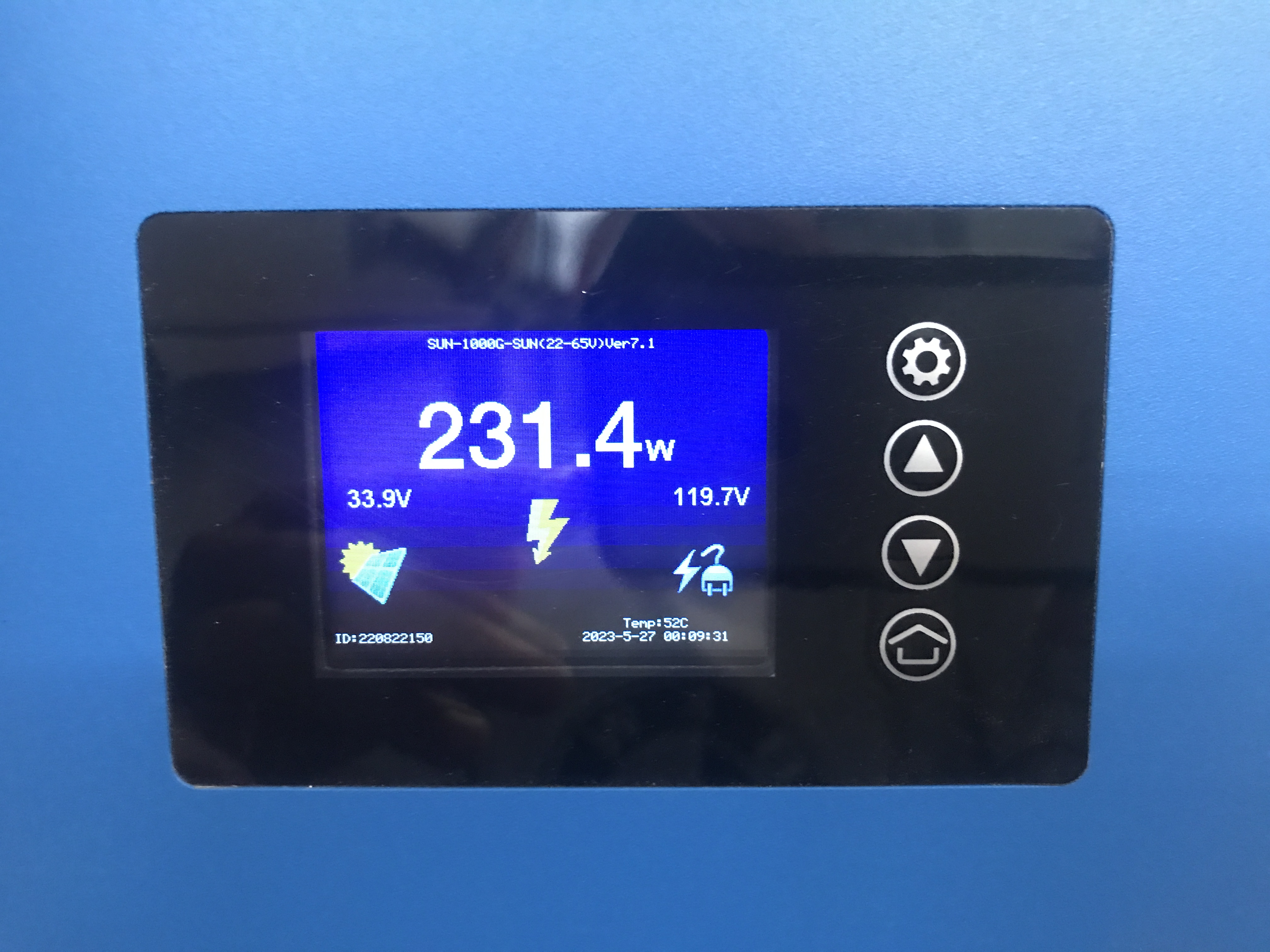

johu wrote: Mon May 22, 2023 5:36 pm My 8.9 kW of panels do max out my inverter at 7.8 kW for a few hours over noon:
So it should be possible to get near 1000W from your. The angle seems pretty much perfect. I found that the "Grid Tie Inverters" don't do a good job at MPP tracking and also have poor efficiency. MPP of my one panel system here is 30V but the inverter runs it at 26V. That's 13% loss right there. Efficiency is about 85% for my 500W model, another 15% gone. So 28% losses in total almost line up with the 60% you calculated.
Prompted by your affirmation of the crappyness of grid tie inverters I decided to go stare at mine for a bit, and I am glad I did. A quick inspection showed that both of my DC leads, both the positive and negative were loose as a goose, not even hand tight. I tightened them immediately first by hand than further gently with some pliers. I can't wait to see what happens tomorrow, if that made a difference. One thing is for sure I will never use that installer again, what a hack !

Any chance you've looked at how to limit the PV production based on your house consumption needs?
I've spoken to PG&E (my grid company) and they said it's not allowed to send energy back to them without permit-ing system and signing up for their NET metering program. I've read somewhere that some folks received letters of warning from PG&E, that they will get disconnected from the grid if they continue sending back energy.
I have now successfully installed 200w panel with a 1000w inverter which produce max. 155w. My house consumes under 250w in idle (green house grow lights, ambient lights, internet, other small things, etc.). But then once in a while a fridge kicks in, washing machine, dryer, etc. Needless to say, I'm in the market to get more panels. However with that brings a question of how to not send the excess energy back to grid at all. As I understood, these inverters do not natively support current limiting function.
Re: The Greg's Grid Tie Solar Project
Posted: Fri Jun 02, 2023 7:58 pm
by Gregski
alexbeatle wrote: Fri Jun 02, 2023 6:48 pm Any chance you've looked at how to limit the PV production based on your house consumption needs?
Excellent question and yes. These cheap Grid Tie inverters do not have a current limiting function, however that does not mean none of the Grid Tie inverters don't have it. My other inverter which I was going to bring up later (might as well do it now) does have this feature.

this is a much more efficient inverter as well, it only has 10% losses, I am not using the current limiting function but I might set it up, I also bought the remote Wifi dongle for it but I could not get it to work.

not sure this is the right video but I tried to find one of the first / earlier ones on these types of Sun inverters with current limiters. Current limiter prevents this device from sending electricity back to your electrical company, some cities don't allow you to send power back to their power plant.
