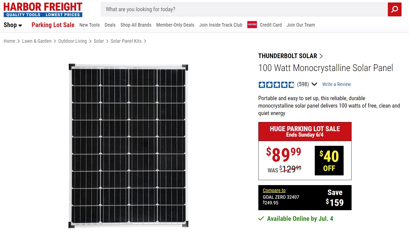

Are Harbor Freight 100 watt solar panels really that good?
and here's a 1 year later review
Gregski
Posts: 3164
Has thanked: 633 times
Been thanked: 1610 times
Re: The Greg's Grid Tie Solar Project
Post by Gregski »
... and if they are, is now the time to get them?

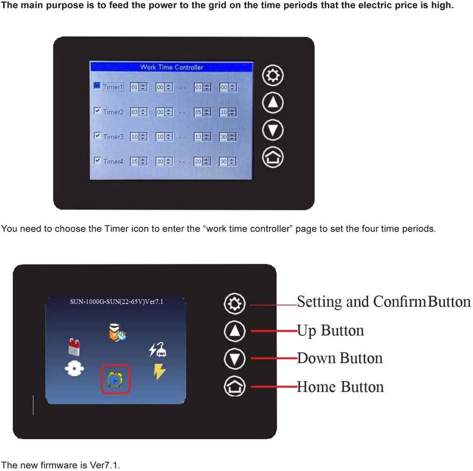

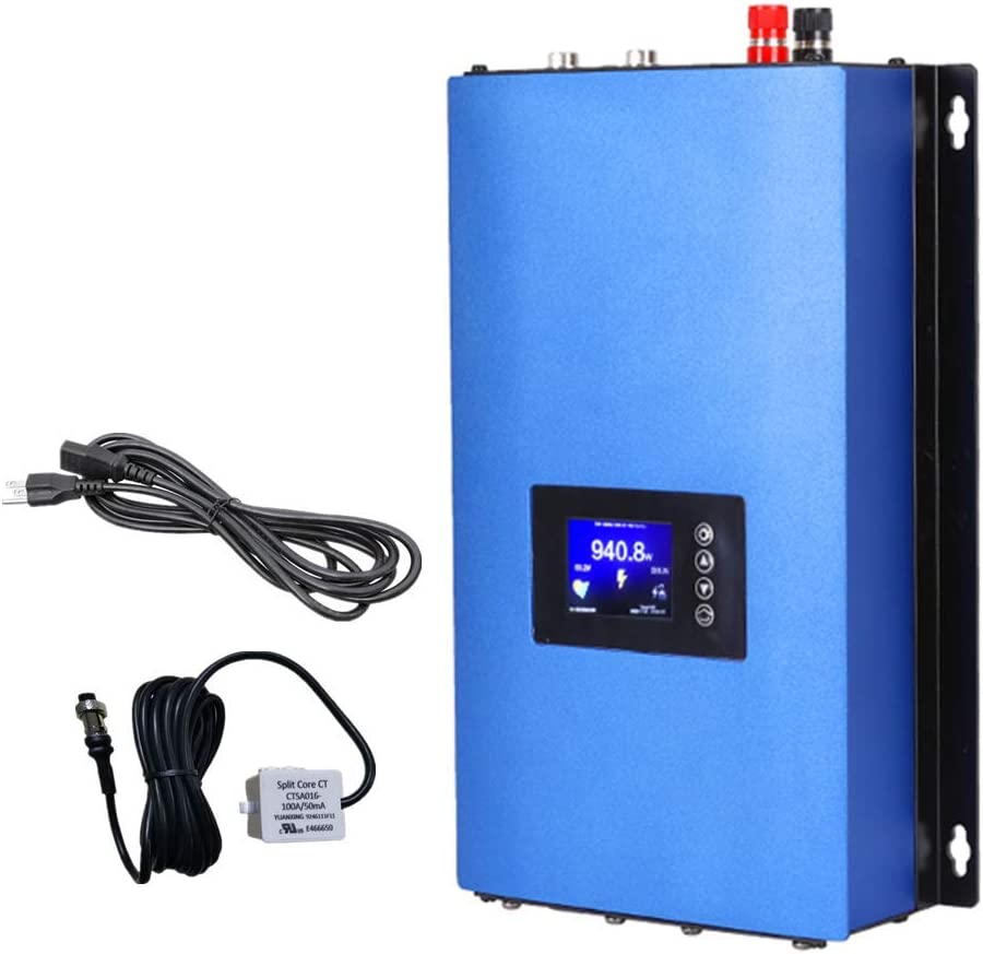

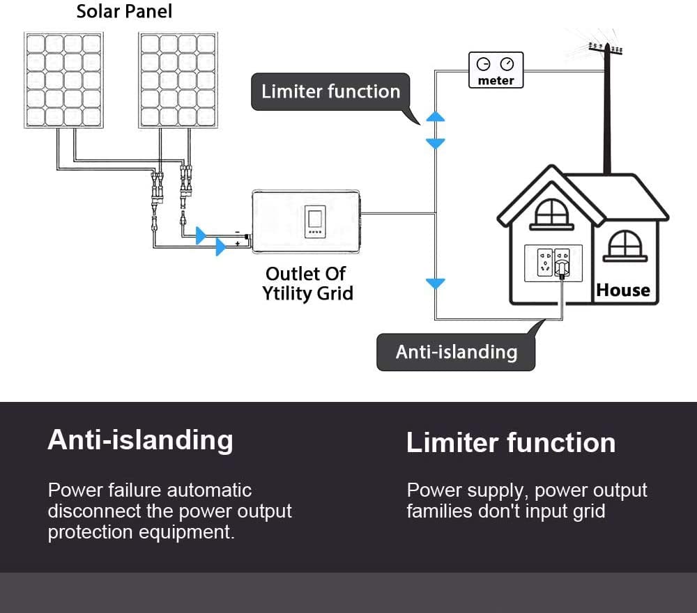

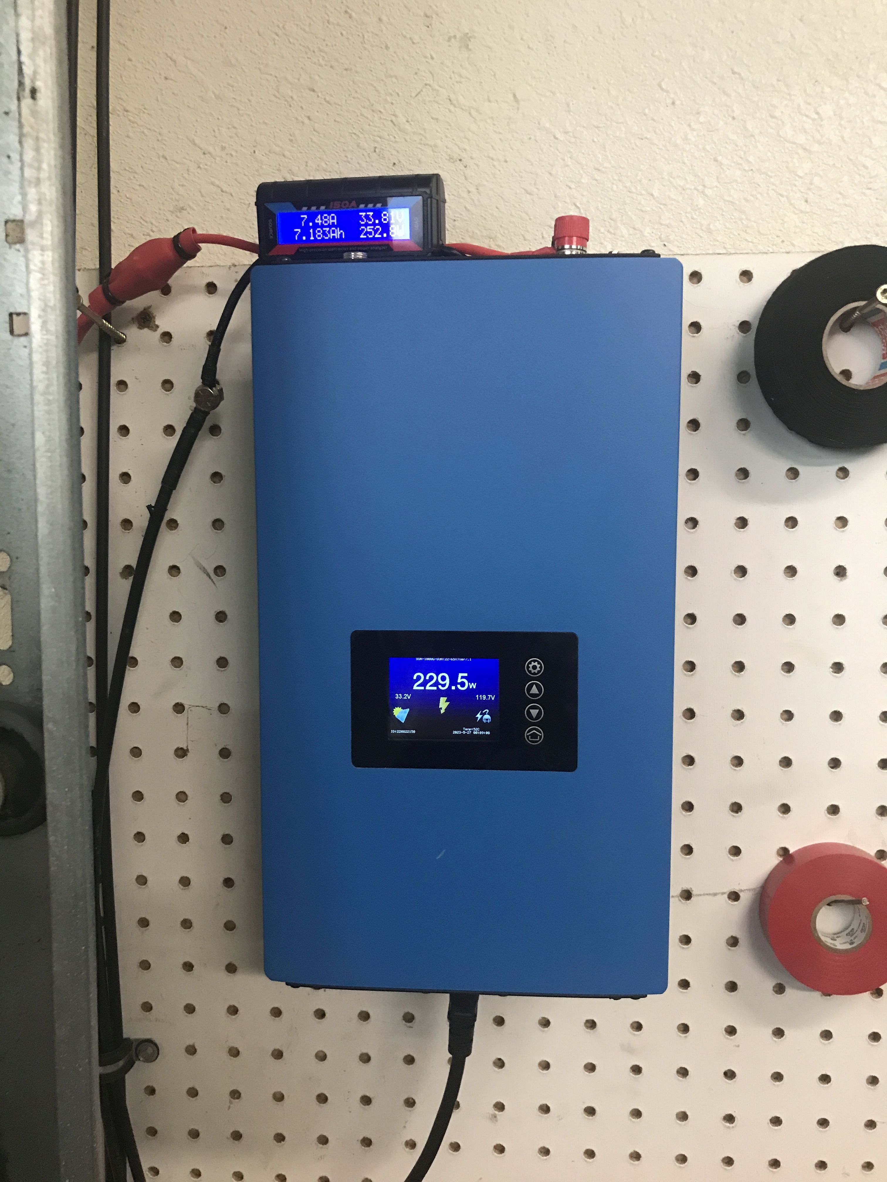

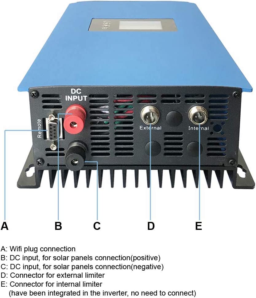

Any chance you've looked at how to limit the PV production based on your house consumption needs?
I've spoken to PG&E (my grid company) and they said it's not allowed to send energy back to them without permit-ing system and signing up for their NET metering program. I've read somewhere that some folks received letters of warning from PG&E, that they will get disconnected from the grid if they continue sending back energy.
I have now successfully installed 200w panel with a 1000w inverter which produce max. 155w. My house consumes under 250w in idle (green house grow lights, ambient lights, internet, other small things, etc.). But then once in a while a fridge kicks in, washing machine, dryer, etc. Needless to say, I'm in the market to get more panels. However with that brings a question of how to not send the excess energy back to grid at all. As I understood, these inverters do not natively support current limiting function.
Gregski
Posts: 3164
Post by Gregski »
alexbeatle wrote: Fri Jun 02, 2023 6:48 pm Any chance you've looked at how to limit the PV production based on your house consumption needs?

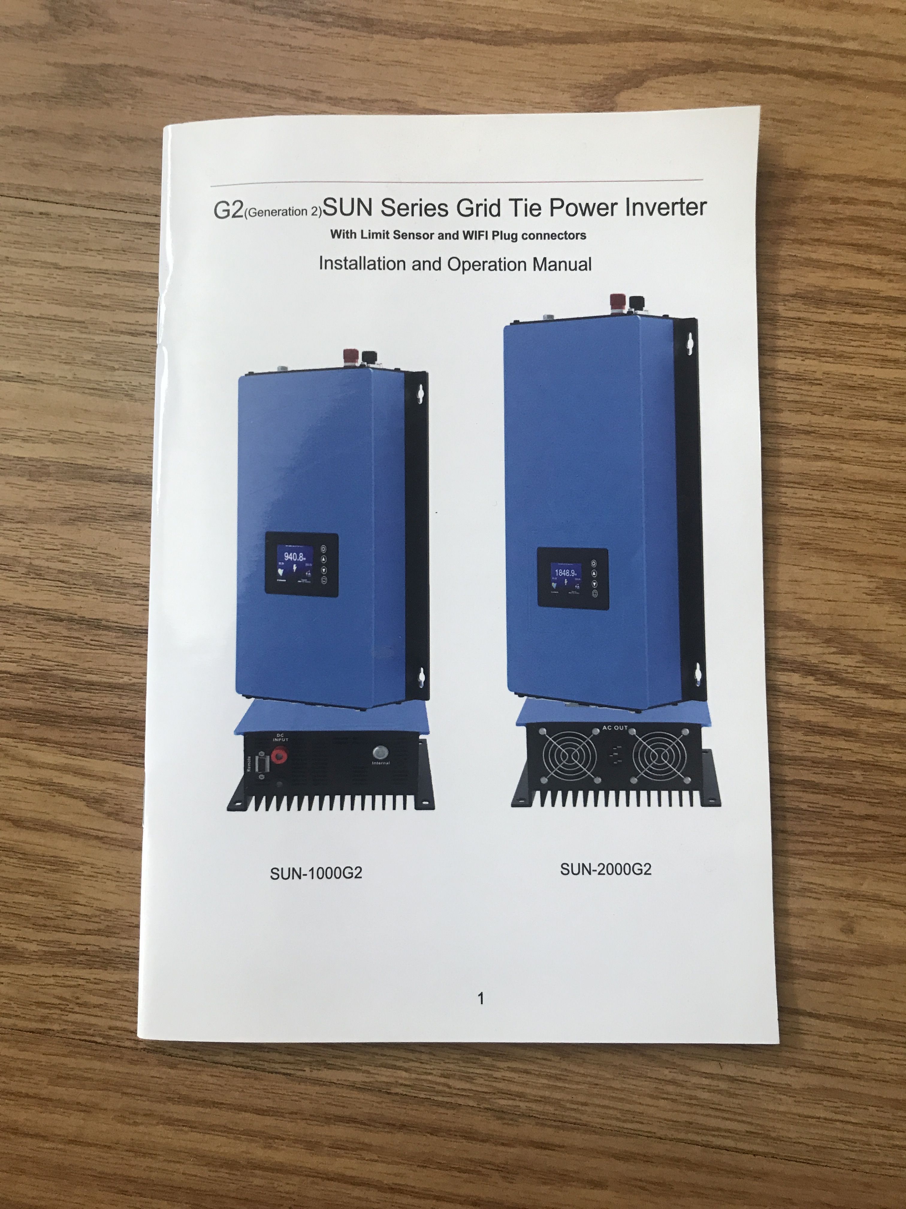

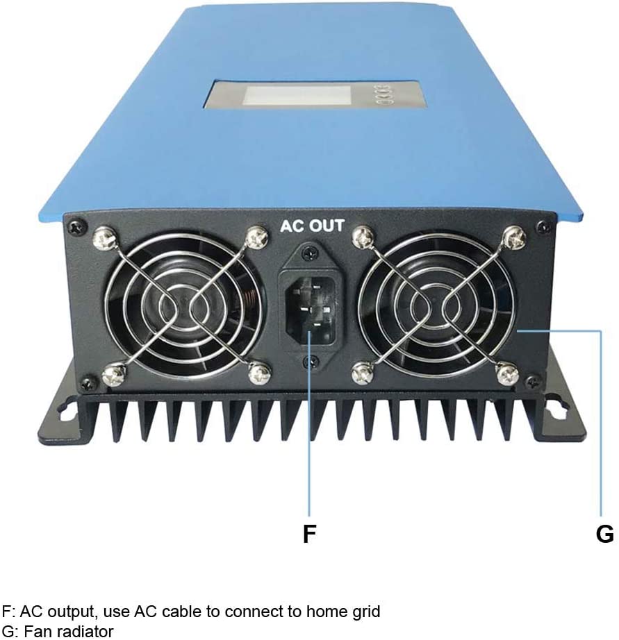

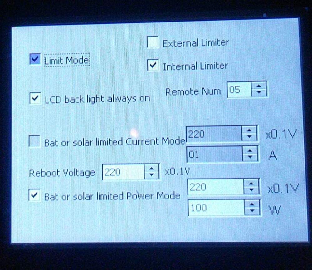

Excellent question and yes. These cheap Grid Tie inverters do not have a current limiting function, however that does not mean none of the Grid Tie inverters don't have it. My other inverter which I was going to bring up later (might as well do it now) does have this feature.
Wow they really went up in price since I purchased mine.

this is a much more efficient inverter as well, it only has 10% losses, I am not using the current limiting function but I might set it up, I also bought the remote Wifi dongle for it but I could not get it to work.

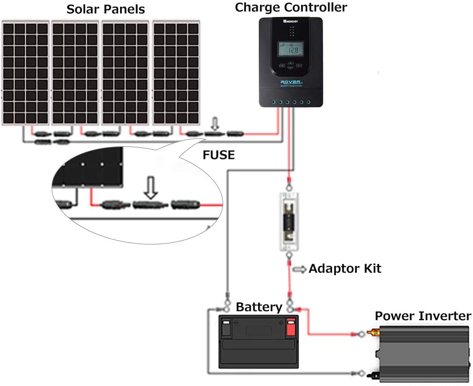

Should you fuse your solar panels?
Should you fuse solar panels in series? If so how?
Should you fuse solar panels in parallel? If so how?
Gregski
Posts: 3164
Post by Gregski »

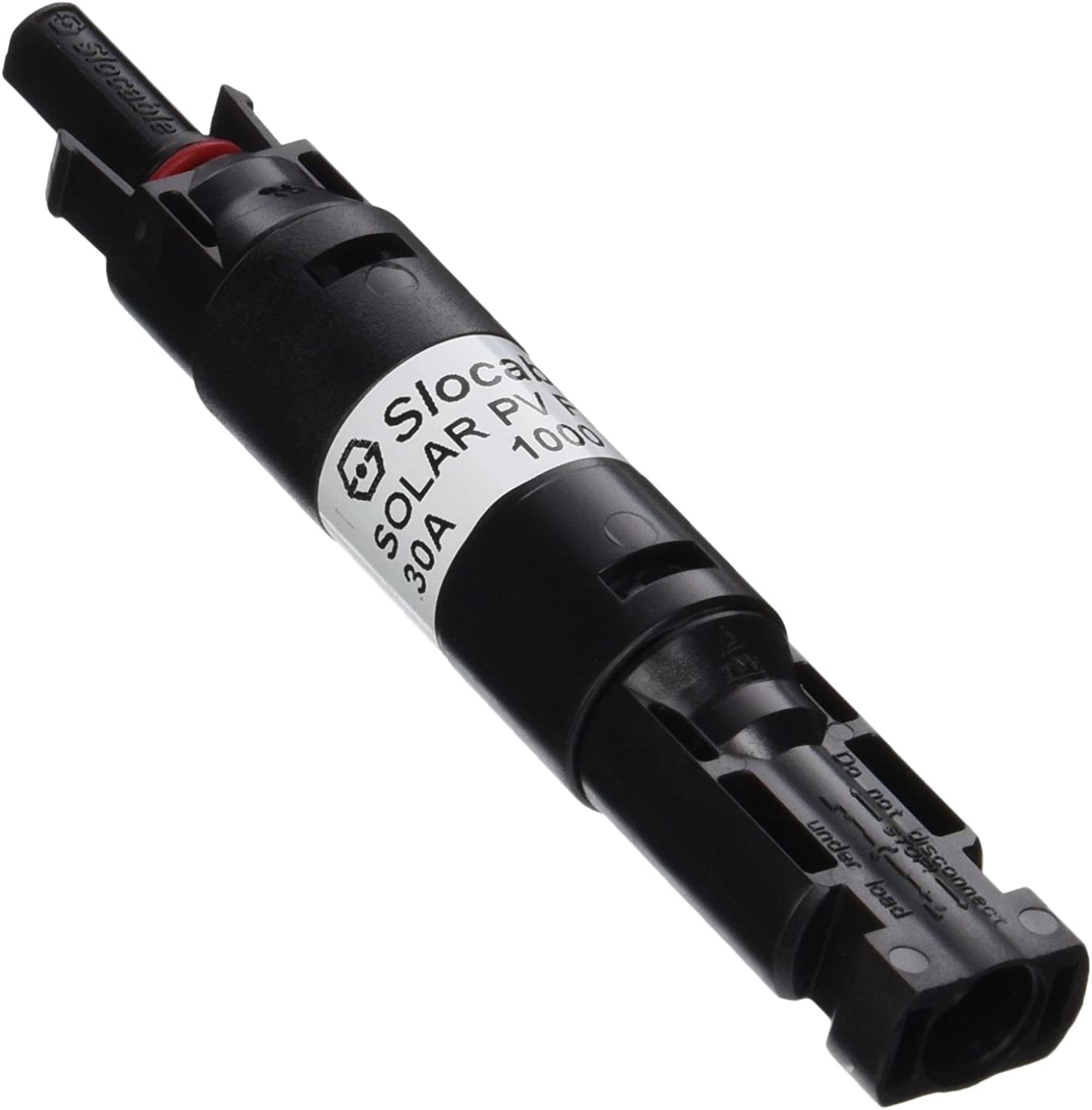

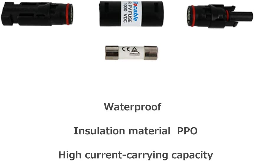

It's a good idea to fuse your solar panels, I get these inline weather proof fuses off of AMAZON

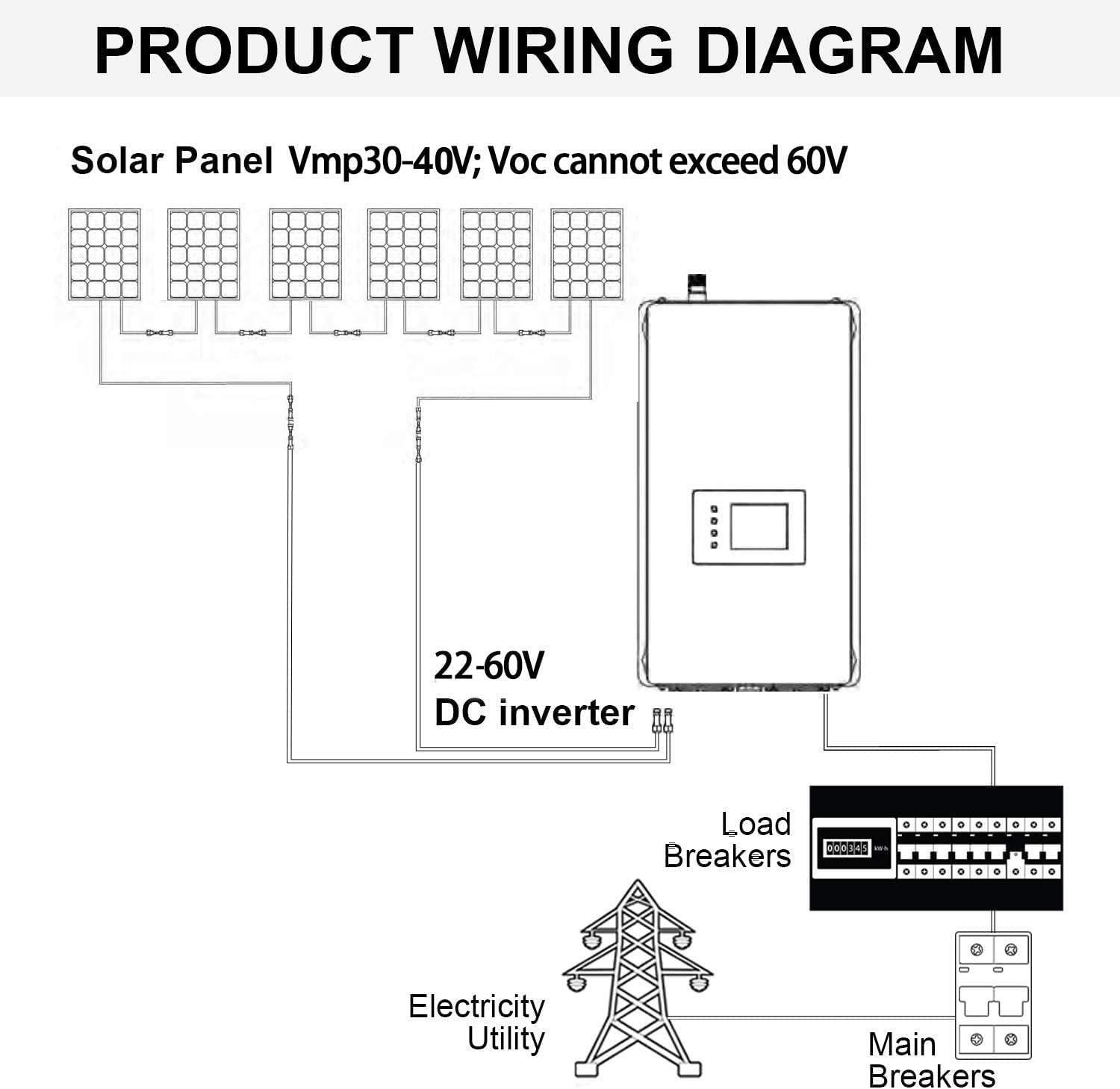

In a pure series setup like the one below you only need one fuse:

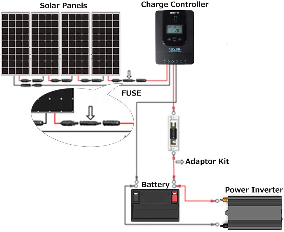

so lets pop some fuses in...

Gregski wrote: Sun Jun 04, 2023 2:10 pm so lets pop some fuses in...
Literally just bought these realizing the potential hazards of the (especially used) PVs!
Posts: 3796
Been thanked: 413 times
I put those in the middle of my panel pack so they could open the circuit in case anything happens. I use 20A fuses since one panel rating is 13A.
For full pack fuse in the house i use 25A automatic fuse:

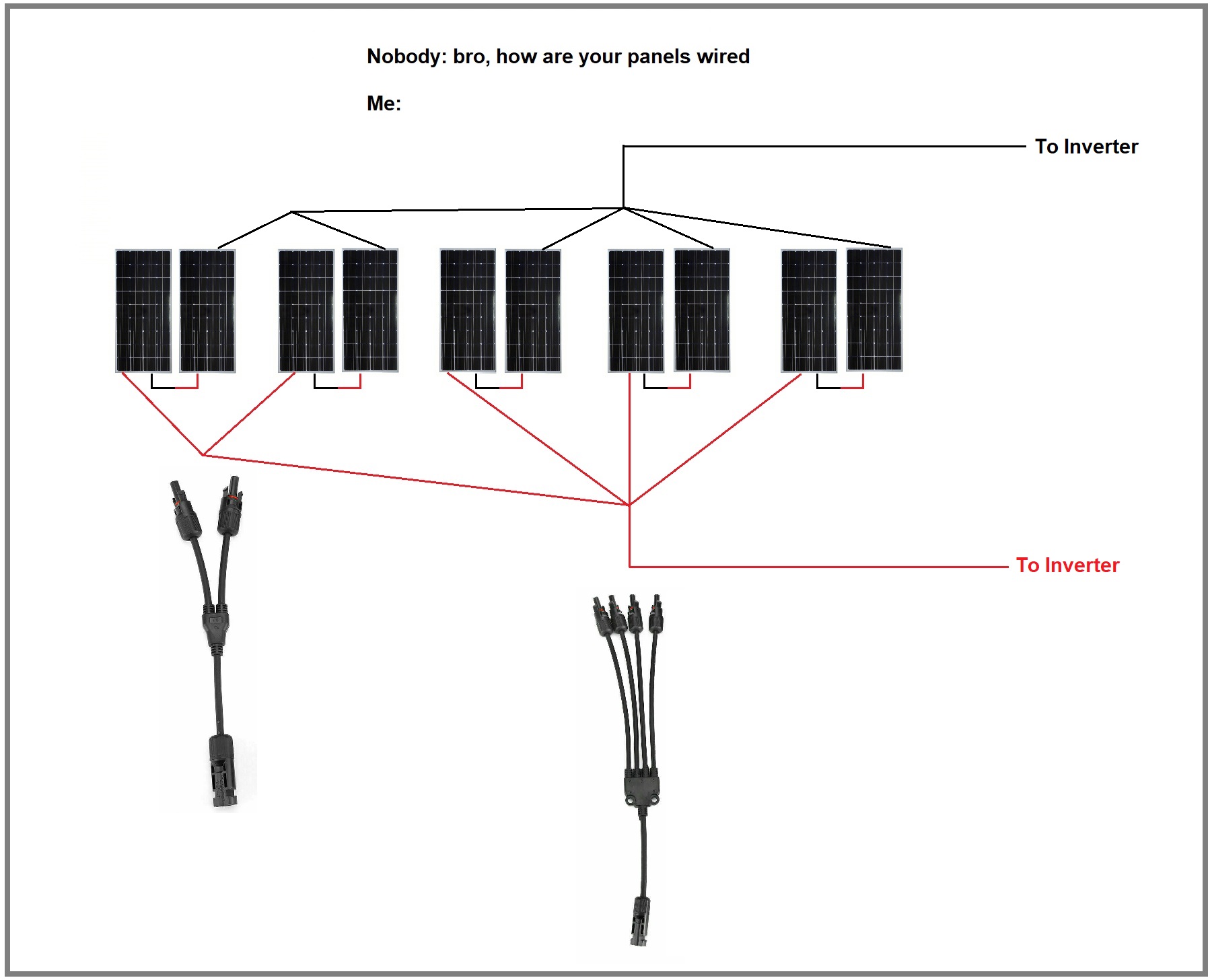

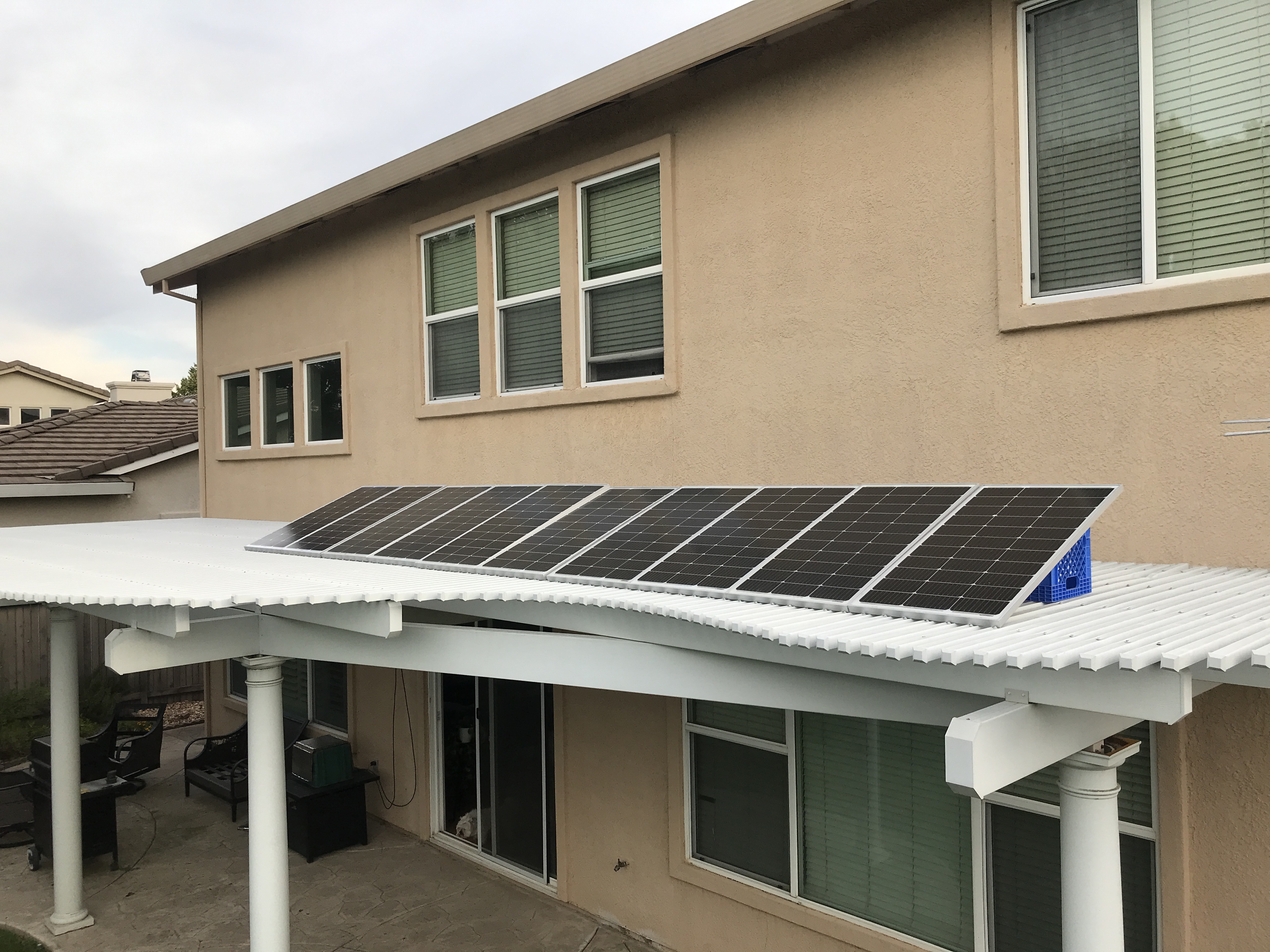

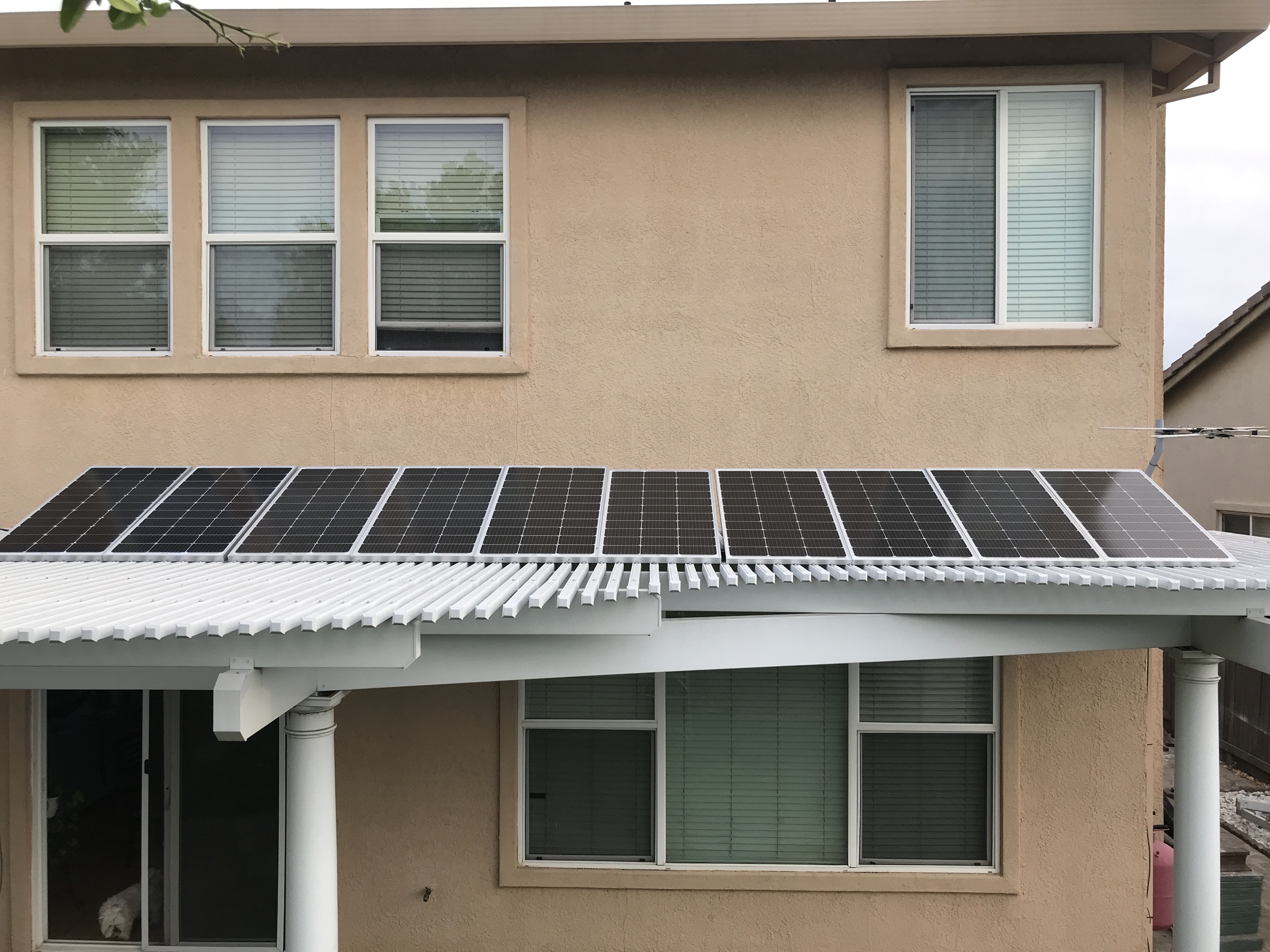

Elon has the Giga Watt Factory, I give you the Grega Watt Patio
this is what I call Solar South, ten 100 watt (mostly Rich Solar) solar panels, facing ... [ wait for it ] South ! at some unspecified angle, which is fully adjustable by sliding the supporting milk crates back and forth (perhaps we shall measure this angle some day)

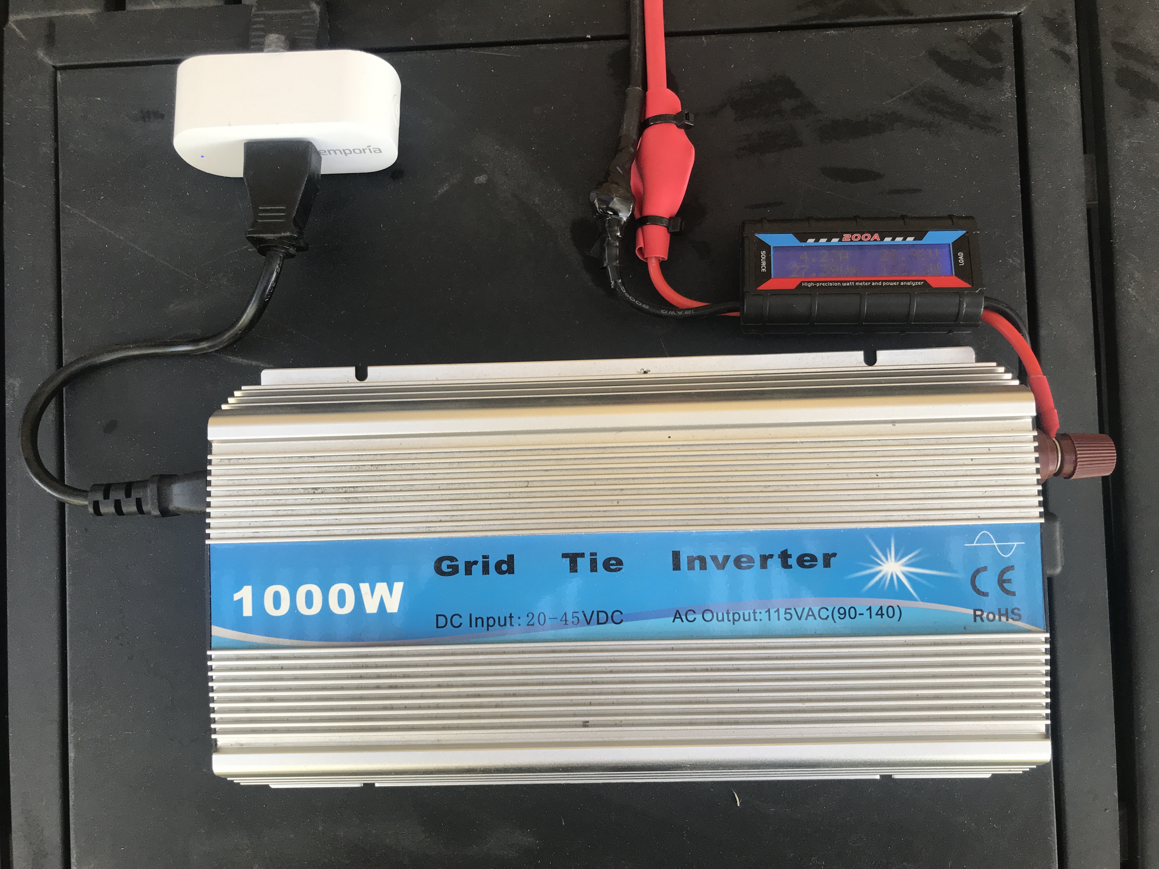

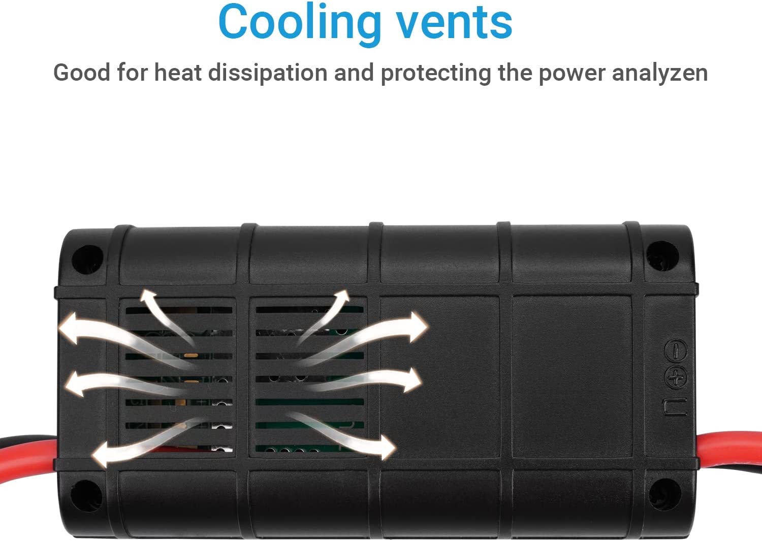

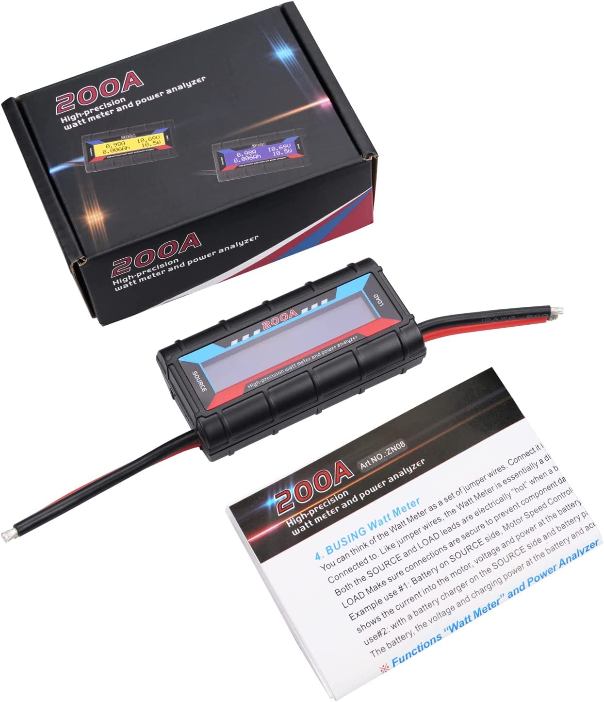

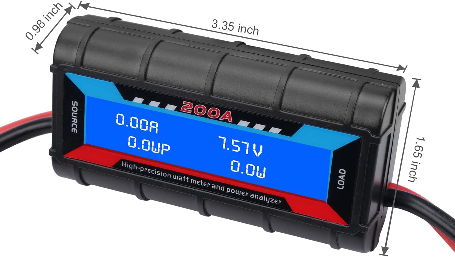

Great now what?
Well now we add a cheap DC power meter to our system to measure how many watts this 1,000 watt solar net can catch. We already know that when they ( the solar panel manufacturers ) say it's a 100 watt solar panel, it is not, so what is it? lets find out

Post by Gregski »
so let's see that beauty installed

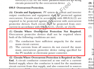

Gregski wrote: Mon Jun 05, 2023 1:42 pm Which amp rating did you end up getting, mine are 15 amps and now i am second guessing myself weather I should have opted for the 10 amp (I basically ran what I had from a prior implementation)
I went with 10A, but it is still on order, cannot tell if it will cause frequent blows or not. And I went with a smaller value because the panels are used. I may even go smaller if 10A doesn't cause issues.
To be more technical, per NFPA70, sometimes you need to add fuses, other times they will not make any difference. You can check the NFPA70 section 690 for all of the solar stuff. Free Access to NFPAs (just need to create an account) - https://link.nfpa.org/free-access/publications/70/2023.
There you can also find the California Electrical Code, which is mostly same as National, but sometimes there're differences. Not for this case though.
A snapshot of the rule about the overcurrent protection:
I will be connecting 3 of the Canadian Solar CS6P-255PX panels in parallel. According to: http://www.solardesigntool.com/componen ... sheet.html
Isc (short circuit current) is 9A and the Series Fuse Rating is 15A. I'm assuming it's actually a max Series Fuse Rating. So smaller value can be used.
So based on my setup, the condition 690.9(A)(1)(2) won't be met and hence I need to have fuses on all branches. That is because 9A*3 = 27A, which is greater than 15A fuse rating of each PV.
If it was a brand new PV, I'd just use a 15A fuse.

Post by Gregski »

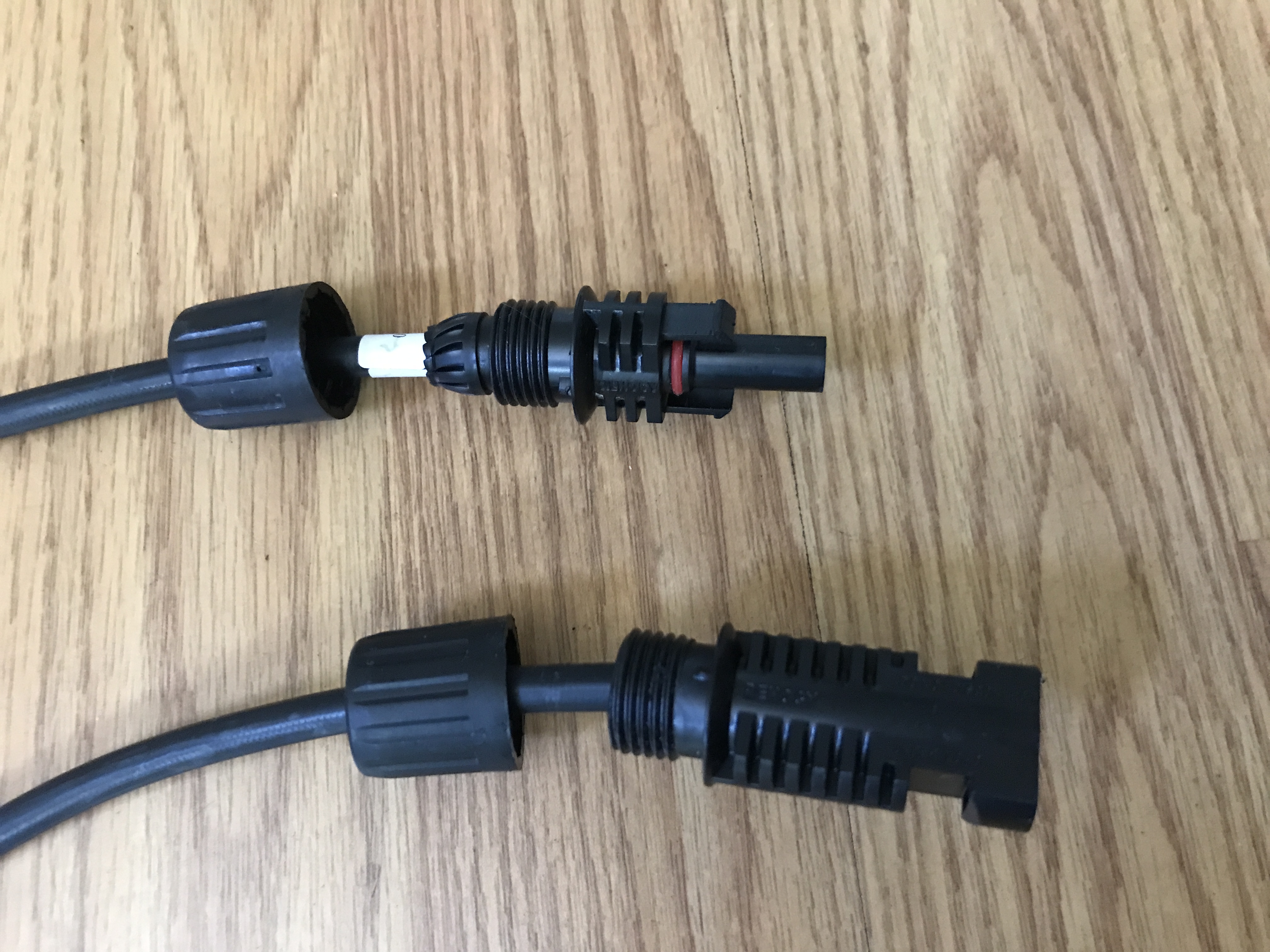

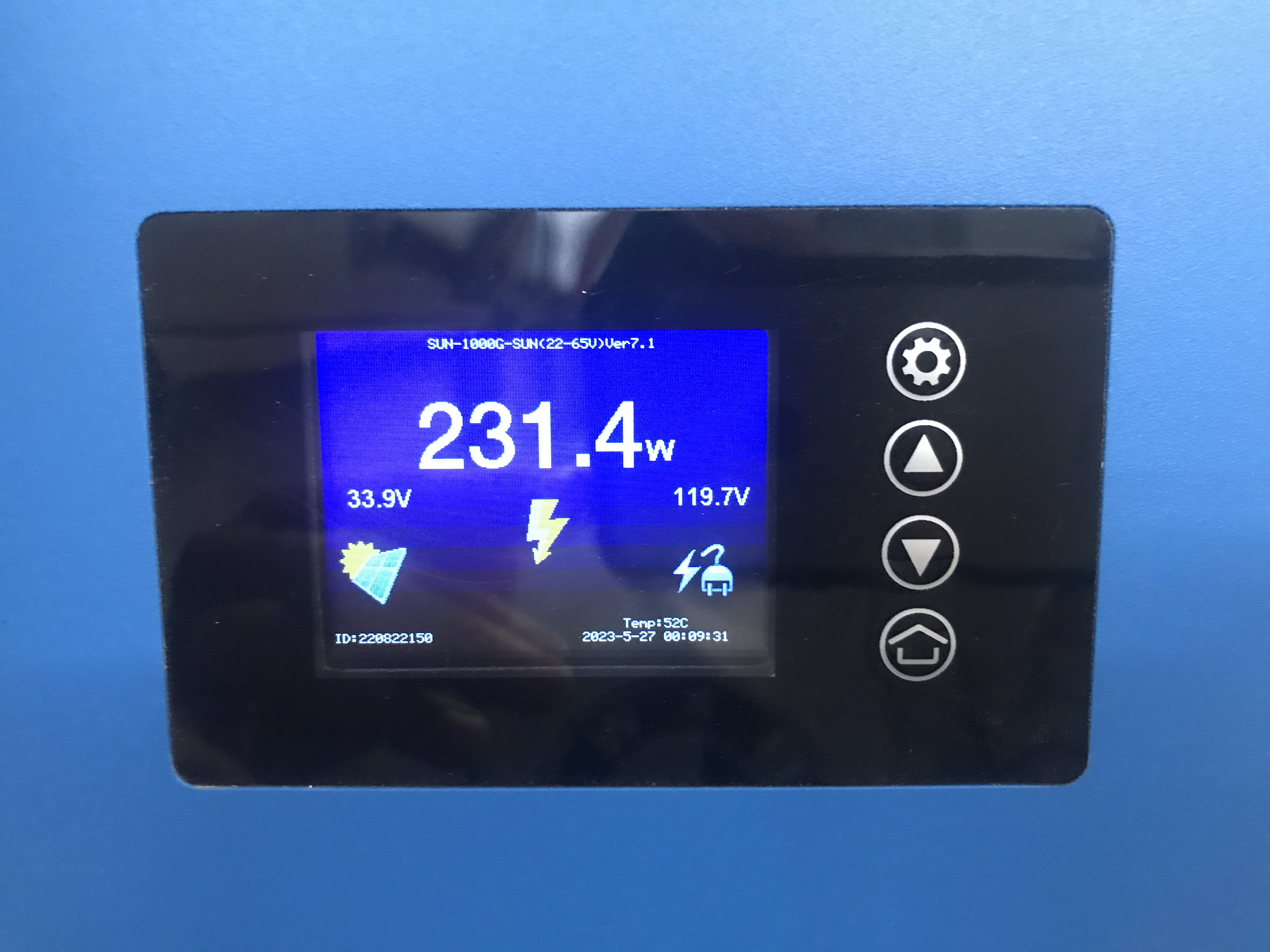

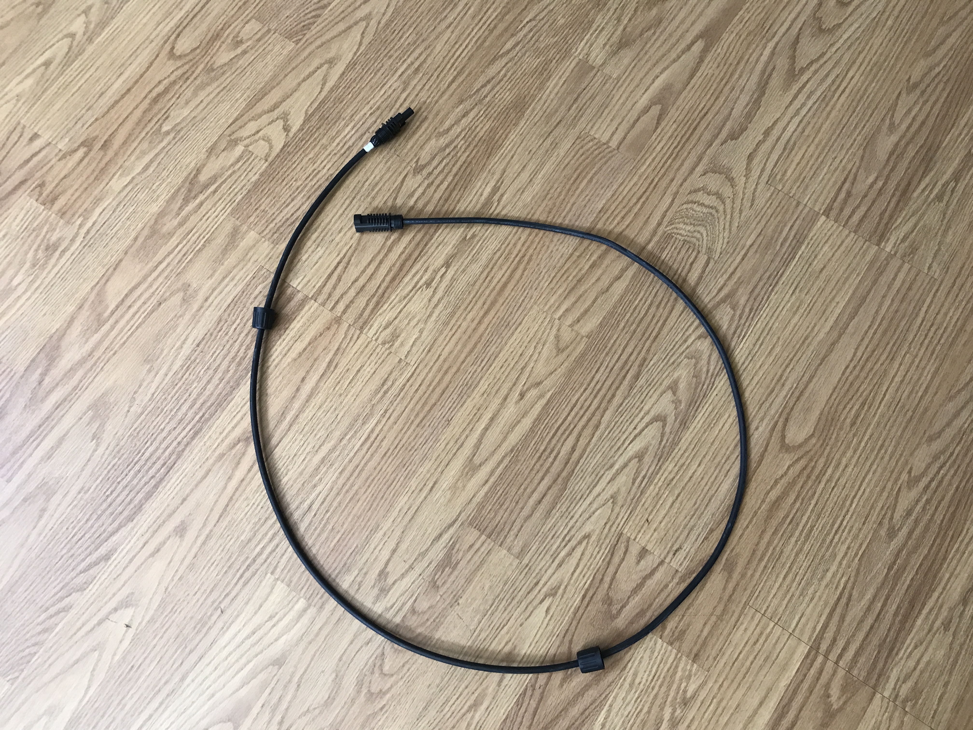

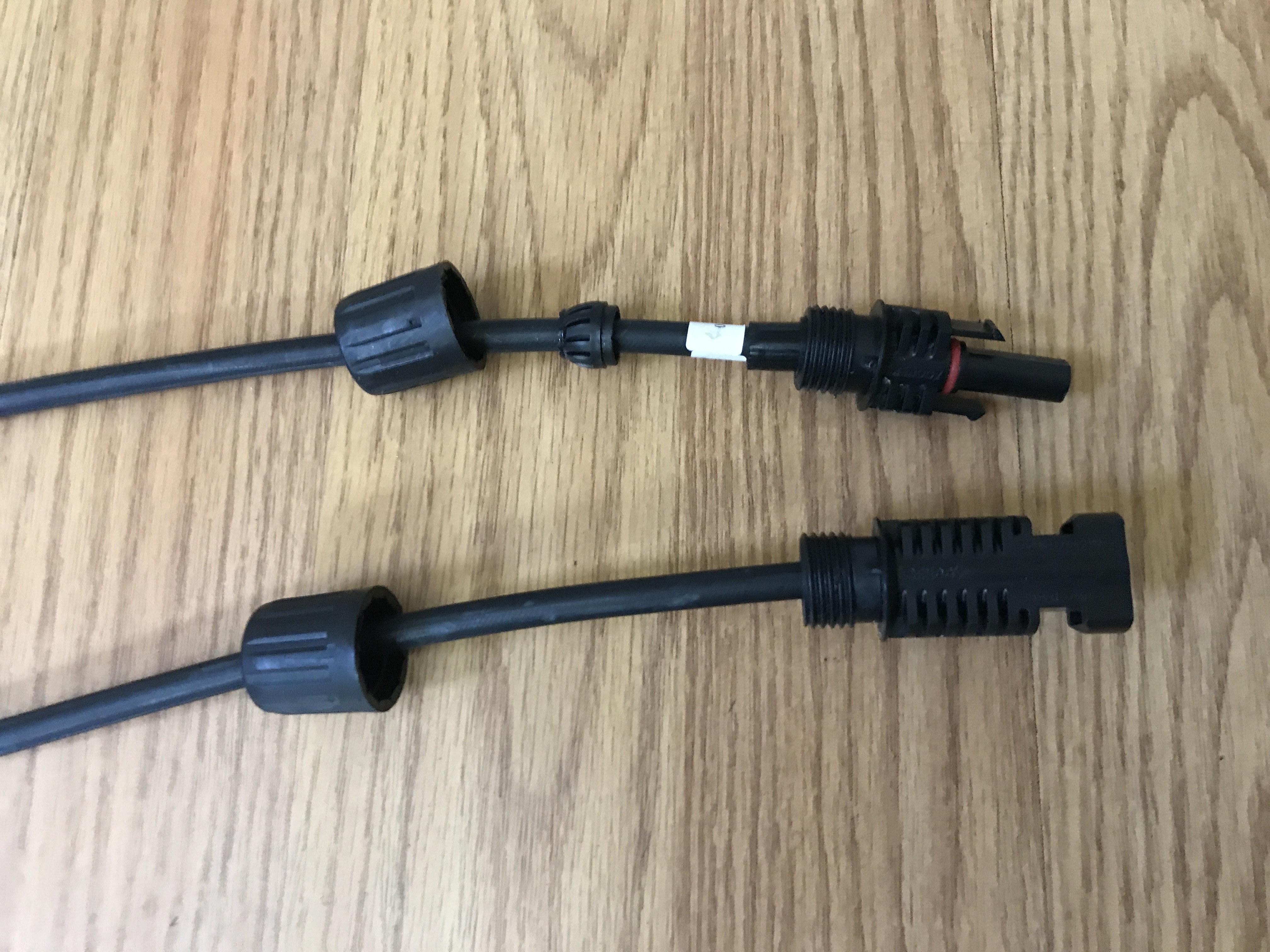

so with the DC meter installed I am now able to see how my 1000 watt system is doing, and it aint doing as good as I thought, so I go troubleshooting and find a few issues
so first, just because you have a brand new cable doesn't mean it is good, can you spot what is wrong with this 5' extension cable?

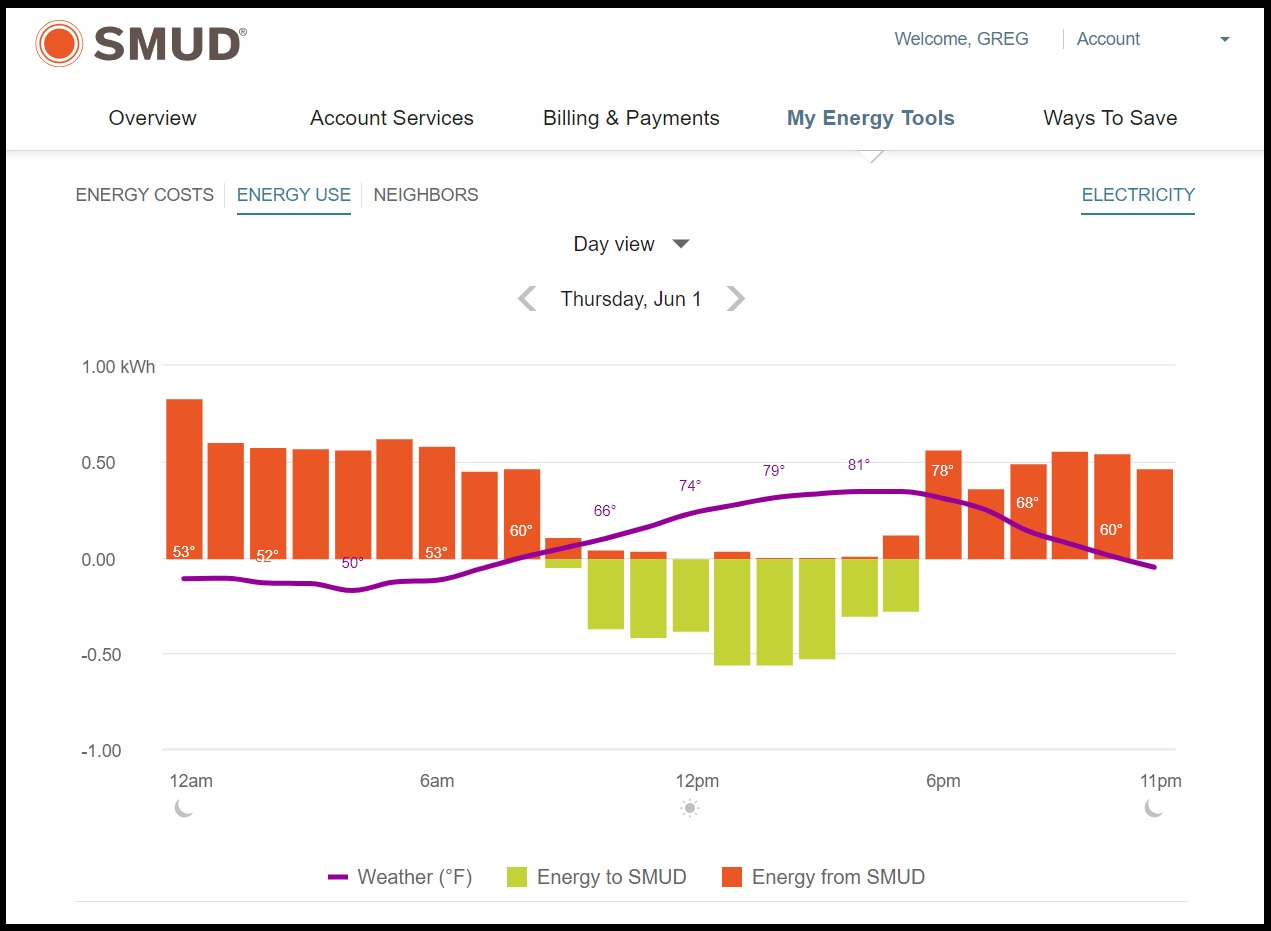

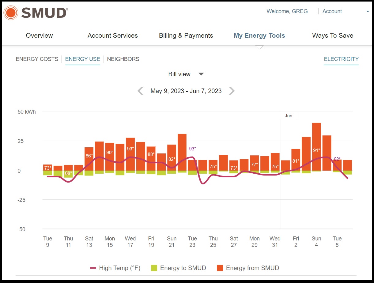

sending power back to the city's municipal utility district like a Boss ? (or is it like a fool?)
Gregski
Posts: 3164
Post by Gregski »
and here is what a day looks like, I am capturing more solar power than what I use from 10am until 6pm
