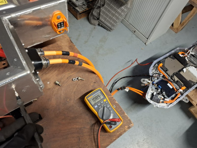

Posted: Tue Nov 19, 2024 1:40 pm
by nkiernan
HV measurement precautions!
Looking for some help! It's been a while and I have a backlog of updates to add here shortly. Right now, I'm back finalising the build of the HVJB and running some final bench tests to make sure PCS, DC-DC, charging etc are funcitonal. While doing random voltage measurements to check for HV isolation issues, I noticed some voltage readings between HV+ busbar and the HVJB case/chassis. Hoping I can get some guidance or suggestions from the forum just to be cautious.
I didn't expect any voltage reading between HV- busbar or HV+ busbar and the casing/chassis.
The HVJB for this build houses the Tesla Model 3 PCS and a backplate with the busbars, shunt (not necessary for now with BMS SBox in system), DC charging contactors (for when that's implemented), some fuse/breakers for PCS and future external loads (Mitsubishi heater and A/C pump)
I have a BMW X5 battery pack and running Damian's arduino script to control pre-charge and full pack voltage
During testing, I am reading aprrox. 0.4 VDC between the HV- busbar and chassis, but getting between 25 VDC and 30 VDC between the HV+ busbar and chassis (starts at 31/32 and drops slowly)!
Now I'm not expecting any voltage reading here, and proceeded to remove/isolate various components to see if there was an issue. I suspected dodgy busbar isolators, PCS doing something odd, or poor insulation at any crimps. Keep getting the voltage reading, so finally removed the HV+ battery lead. Still getting the voltage reading. What I'm getting from this, is that there is nothing leaking from the HV+ side to the chassis, and possibly this is expected...a difference in ground planes or something similar? With HV removed from the HVJB, I get open circuits between the busbars and chassis
I did some checks with a 12V bulb to see if there was any current and the bulb didn't light to either HV+ or HV- and chassis
Because its HV, and to show it respect, hoping someone with a better understanding could confirm if this looks to be an issue or expected before I start putting it back together?
Re: [WIP] L322 RR Vogue - The beached whale
Posted: Tue Nov 19, 2024 1:52 pm
by tom91
I note that your Junctionbox and Battery box do not seem to be connected together to equalize the grounds.
Have you done any measurements on the HV battery, leads to casing?
When you did the light bulb test did you have your multimeter in current reading mode to check the level of current flowing?
Do you have a hi-pot tester that can do resistance measurements at 500V or 1kV? Then you can test each subsection of your junction box.
Edit also noticed you did not pull the plugs out of the PCS, you only pulled the positive fuse input wires. This would only leave the PCS to HV negative.
EDIT 2 The BMW HV contactor box has built in isolation monitoring, so there is a chance you are seeing this. I do not know if there is a way to turn it off.
Posted: Tue Nov 19, 2024 2:21 pm
by nkiernan
Thanks for the reply Tom, you raise some good points so I have more checks to do
tom91 wrote: Tue Nov 19, 2024 1:52 pm I note that your Junctionbox and Battery box do not seem to be connected together to equalize the grounds
Ok, you're right, I didn't think to connect both cases. I'll do that and recheck
tom91 wrote: Tue Nov 19, 2024 1:52 pm Have you done any measurements on the HV battery, leads to casing?
Will do this too
tom91 wrote: Tue Nov 19, 2024 1:52 pm When you did the light bulb test did you have your multimeter in current reading mode to check the level of current flowing?
I was relying on the bulb lighting so didn't pay attention to the meter
tom91 wrote: Tue Nov 19, 2024 1:52 pm Do you have a hi-pot tester that can do resistance measurements at 500V or 1kV? Then you can test each subsection of your junction box.
Unfortunately not
tom91 wrote: Tue Nov 19, 2024 1:52 pm Edit also noticed you did not pull the plugs out of the PCS, you only pulled the positive fuse input wires. This would only leave the PCS to HV negative
I did pull the HV connector from the PCS for one test so HV+ and HV- disconnected at PCS and was still seeing the same voltage HV+ to chassis, so was happy it didn't appear to be the PCS
tom91 wrote: Tue Nov 19, 2024 1:52 pm EDIT 2 The BMW HV contactor box has built in isolation monitoring, so there is a chance you are seeing this. I do not know if there is a way to turn it off.
Interesting. If I hadn't the cases connected as per your first point, this presume this wouldn't affect the HV+/chassis voltage I'm seeing?

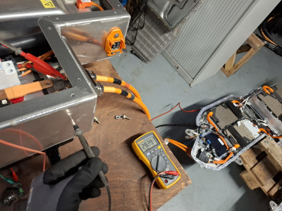

Posted: Tue Nov 19, 2024 6:30 pm
by nkiernan
Redoing the earlier tests with a meter set to amps in series with the bulb for both HV+ and HV- to chassis, 0A for both and bulb didn't light, but voltage shows when measured (approx. 30 VDC and drops over short time). Before connecting the battery pack case and the HVJB enclosure for common ground, I checked both HV+ and HV- leads to battery pack case. This shows approx. 180 VDC and then dropped off over a short period
Next I connected the battery pack case and the HVJB enclosure and redid the HV+ to HVJB enclosure/chassis. Photos below show the same results as above, approx. 180 VDC (initially higher than when cases weren't connected) and then drops off over time. What I notice here is if I remove the multimeter probe and wait a short while and reapply the prove, the voltage has risen and then starts to drop off again. If I wait a couple of minutes and then reapply the probe, its back up to approx. 180 VDC before dropping off
With the comment about the BMW isolation monitoring above, I assumed this would be part of the SBox unit, so I removed the HV+ and HV- connections between the SBox and the battery pack to isolate the battery modules. However, same results from both the battery pack HV+ and HV- back to battery pack case! I then removed the BMS connector from the pack to the BMS master, incase that was a final HV path from the 12 modules in series and anything outside the pack...but same initial voltage that drops off.
This baffled me, surely there shouldn't be any voltage showing at this stage, unless its something to do with the multimeter. Had a good look around the internals of the battery pack to check for any module or cable damage or other connection, but nothing obvious showing up. Seems to be battery module level related at this stage, or is there any way this is normal!!?
Posted: Tue Nov 19, 2024 6:41 pm
by tom91
At this stage it means there is a potential break down of isolation in one of your modules.
Due to the construction the "grounded" case will behave as a capacitor to the Cells/HV circuit building charge/voltage over time. A multimeter is a high impedance device thus will be discharging that charge causing a leakage to ground.
I would proceed to remove all module connections and measure each one by one to see which module has the issue.
Posted: Wed Nov 20, 2024 5:33 pm
by nkiernan
tom91 wrote: Tue Nov 19, 2024 6:41 pm I would proceed to remove all module connections and measure each one by one to see which module has the issue.
Disconnected all the modules that were accessible on top and checked these individually again...similar but lower initial voltages that dropped off to approx. 0.002VDC in most cases. Will remove each module but started with this one to check and BMS was also disconnected. Is a standard multimeter of any use to truly check the modules!? Small voltage readings that drop off but this could be the meter and swapping between positive and negative. Resistance shows open.
Is there a sensible priced DIY option for a proper module tester I wonder? Will check if there's something like a Fluke 1507 insulation resistance tester in work maybe
Posted: Thu Nov 21, 2024 7:49 am
by nkiernan
tom91 wrote: Wed Nov 20, 2024 6:22 pm The multimeter is fine, you saw it drop to 25-24V and stay there right? So no need for an HI-pot tester/Megger
Without the HVJB and battery enclosures connected, from HV+ lead to HVJB enclosure the voltage would start at 25 to 30 VDC then drop off over a short period to a volt or so. HV+ lead to battery enclosure started up around 180 VDC and dropped off the same way.
After connecting the enclosures, the HV+ to HVJB enclosure was now also at 180 VDC and dropped off. So the voltages always dropped to a volt or so. Each module is sitting approx 27V. It'll be Saturday before I get to work through the rest of the modules. But reading your comments, reminded me the pack is sitting as shown below with the two lower case halves not connected. I get the same result on both halves, so will connect these as a check before dismantling further
Posted: Thu Nov 21, 2024 10:05 am
by tom91
nkiernan wrote: Thu Nov 21, 2024 7:49 am So the voltages always dropped to a volt or so
Wait what, you are saying all the measurements you took always decayed to around 1V or less? This is news to me your previous posts did not mention they would reach this, what sort of time does it take. Please be as specific as possible.
It sounds like this is not an issue as it first appeared. Please note things like temperature and moisture along side the multimeter used will greatly impact your readings.
