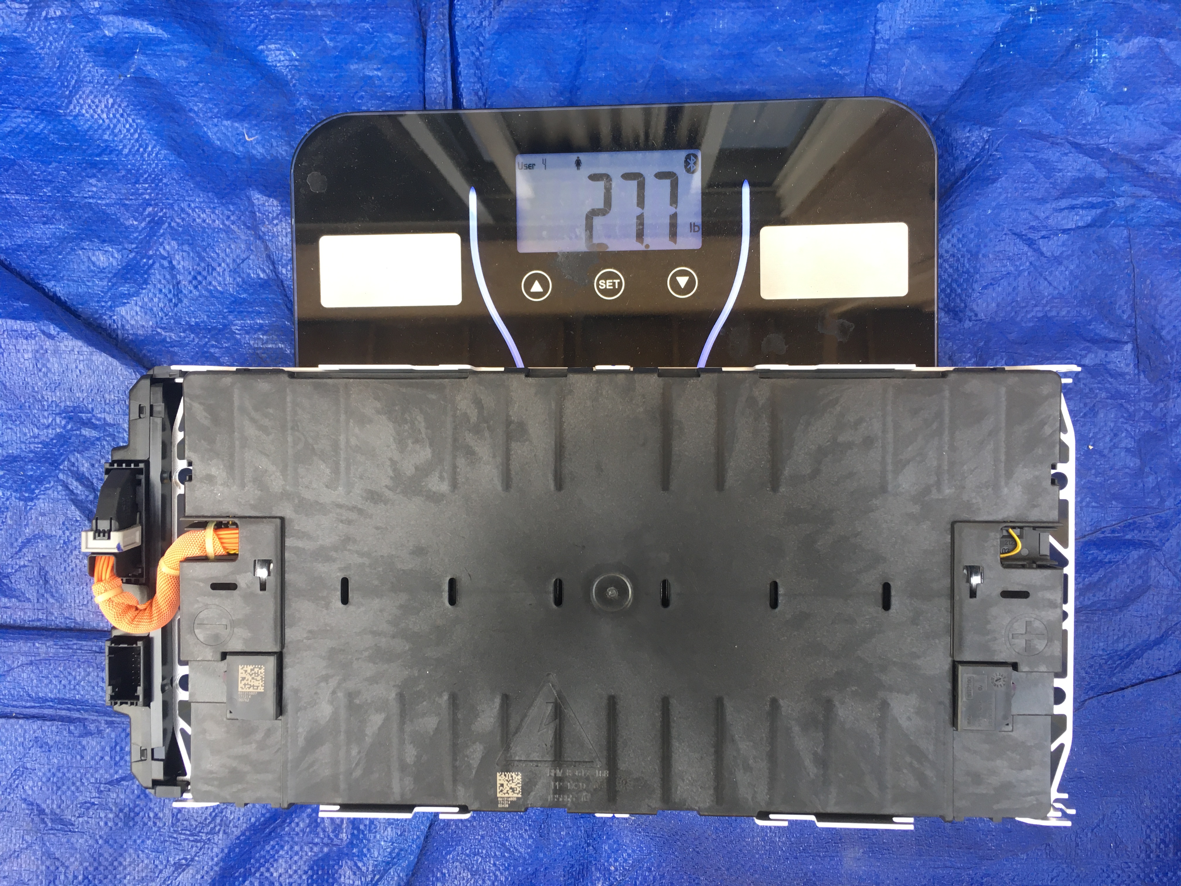

Posted: Sun Dec 12, 2021 1:27 am
by Gregski
I managed to yank one cell module out so that we can get more acquainted, and I threw it on the scale
