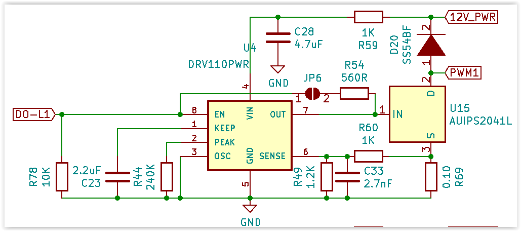

I myself have a little smaller project in the pieline, as I want to use the original tesla m3 hv contactor.
I have ordered some stuff from TI.com so I can put together an economizer circuit for the coil. Should be based on a DRV110, I hope I manage to put together something usable. https://www.ti.com/product/DRV110https://www.ti.com/tool/DRV110EVM

Went the same route. My pittfalls seemed to be:fredd90 wrote: ↑Fri Mar 26, 2021 1:04 am ...Should be based on a DRV110, I hope I manage to put together something usable. https://www.ti.com/product/DRV110https://www.ti.com/tool/DRV110EVM
- When using a low-side protected-mosfet, find one that is capable of doing 20KHz (most are not).
- My contactors seem to have a small capacitor across the coil. This disturbs the current measurement of the DRV110 (immediately limits at the initial pulse) and thus the current regulation. That's the reason behind the RC-network parallel to the sense-resistor.
- Don't forget the pull-down at the enable-input when driving from a CPU. The DRV110 has an internal pull-up, so when the CPU-output floats (at boot) is will activate all contactors
- Really test with the contactors wou want to use, measure current feedback with an oscilloscope and adjust the RC-network to avoid hissing sounds from the contactor and a stable pulsewidth.
JLC doesn't stock the DRV110, so I manually add them only to the outputs that I use for contactors. Solderjumper is to use the FET as a normal output when the DRV110 is not present.
How I ended:

Interesting, I have already had time to sketch a bit on components and it is as you say, difficult to find fast switching n-channel mosfet.FJ3422 wrote: ↑Sun Apr 04, 2021 7:26 amWent the same route. My pittfalls seemed to be:fredd90 wrote: ↑Fri Mar 26, 2021 1:04 am ...Should be based on a DRV110, I hope I manage to put together something usable. https://www.ti.com/product/DRV110https://www.ti.com/tool/DRV110EVM
- Don't forget the pull-down at the enable-input when driving from a CPU. The DRV110 has an internal pull-up, so when the CPU-output floats (at boot) is will activate all contactors.
How I ended:
Good idea regarding pulldown resistor, easy to forget
My plan is to buy a loose hv-contactor and experiment with it, it draws about 8-9A in startcurrent so the mosfet needs to be quite solid.
I have found this one on Elfa: https://www.elfa.se/en/automotive-mosfe ... opup=false
Continuous drain 20A @ 40v. and 20-25ns at full amp
I bought the drv110 experiment board to make things easy but the included mosfet maxed out at 1A unfortunately, just wait for the new mosfet.
I have no idea if my contactors are equipped with a condensator, hope not

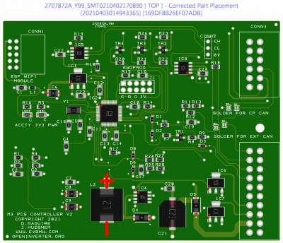

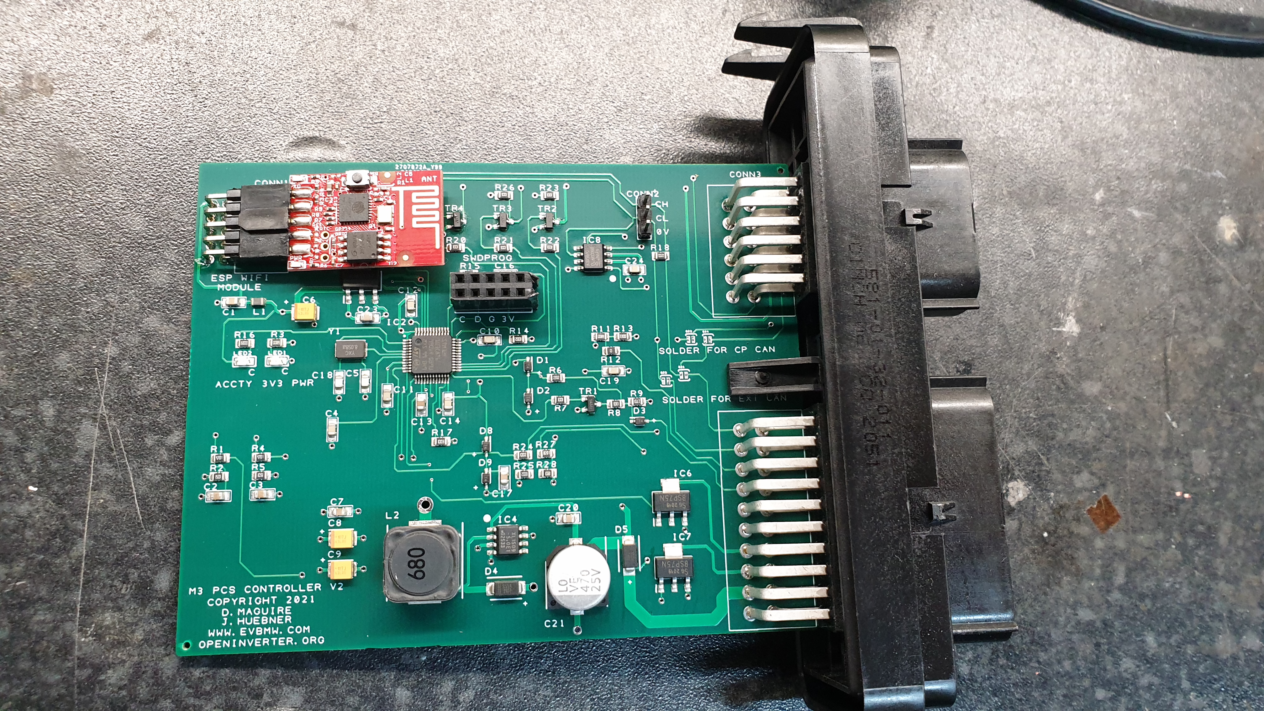

Got some time this morning to build up a controller and start testing. DCDC side works but no output from charger. traced to a simple software issue (incorrect boolean) so once Johannes fixes that we should be charging:) Assuming all goes well boards and kits will then be in the webshop.

Boards and kits now available from the webshop and support thread setup :
viewtopic.php?f=10&t=1585

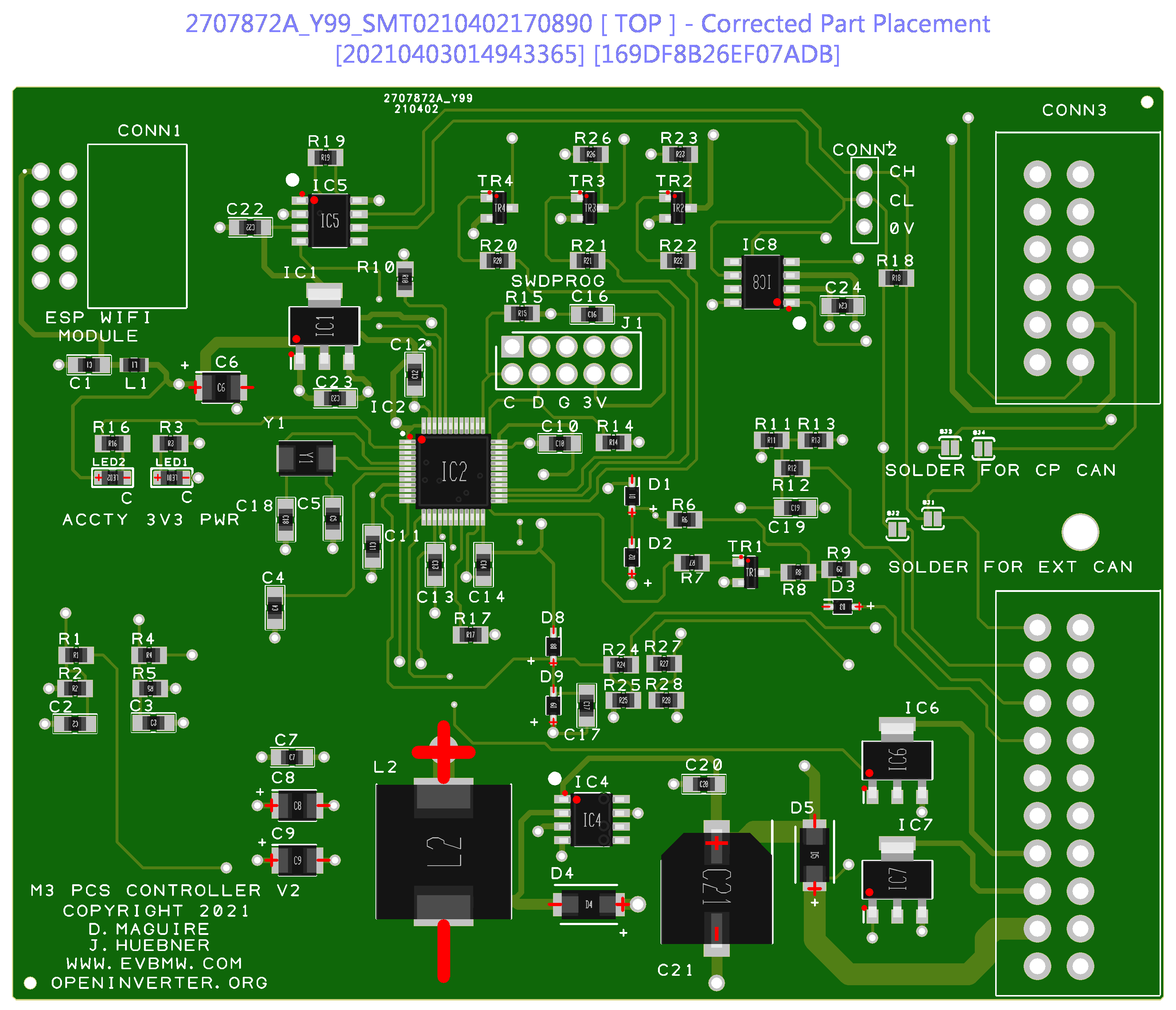

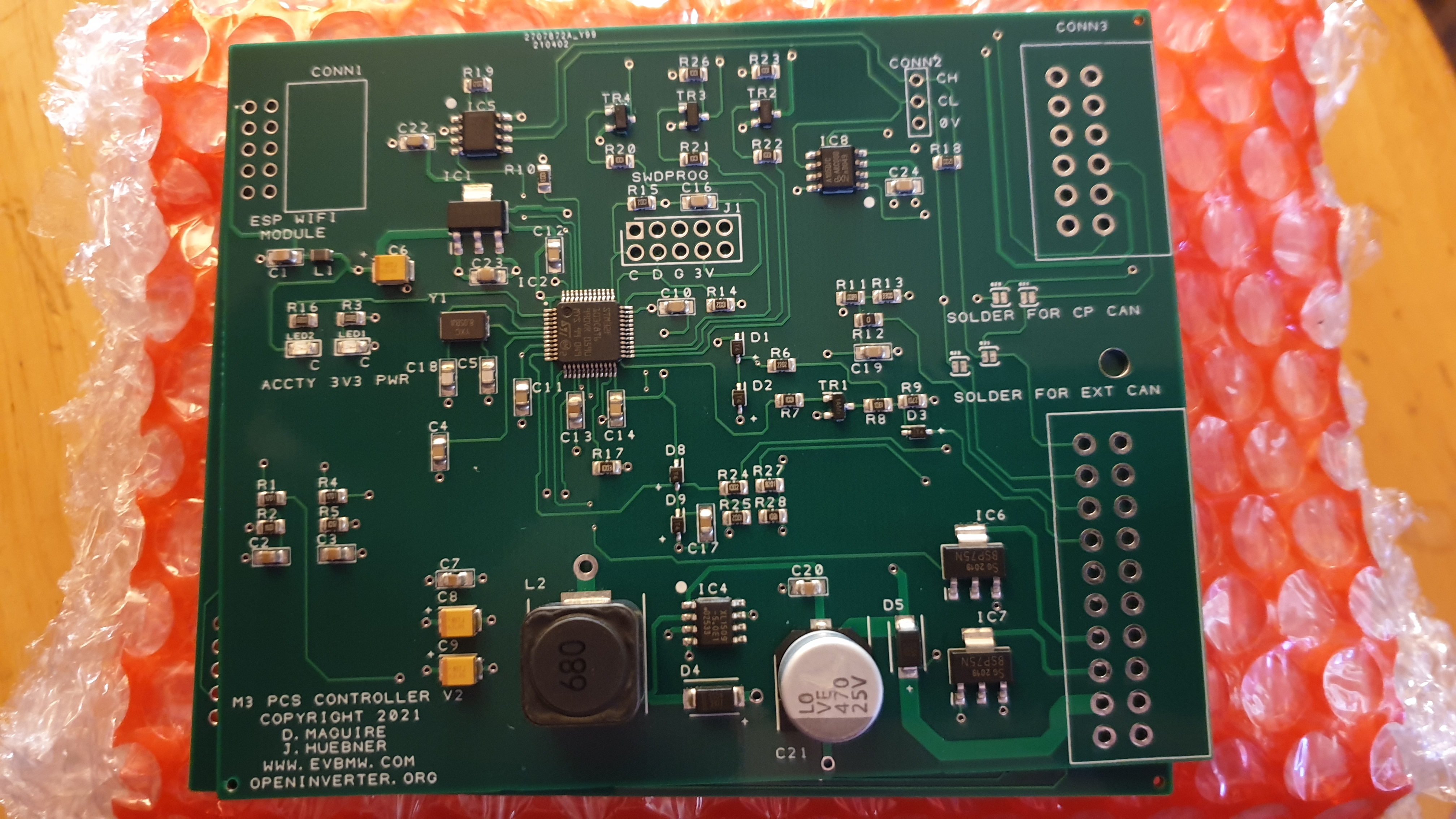

Hello everyone
I have a faulty Tesla MODEL-3 charger. It does not charge with full power from the 3-phase network.
I would like to run it using the Damien Maguire module.
I made a board according to the scheme on
the STM32F103 processor.
After starting and connecting the CAN monitor, my charger sends data on
different addresses.
Can anyone help me in software adaptation for this version of the charger?
