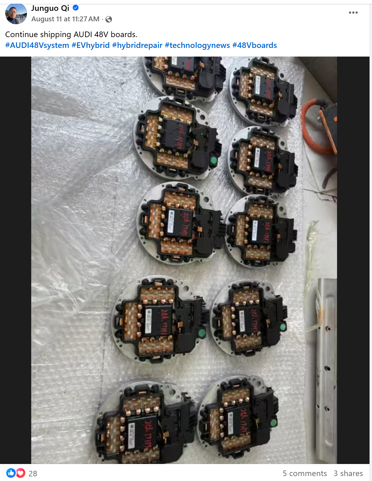

There are existing modules you can buy on aliexpress to just cut and solder on, instead of making your own.

ama wrote: Mon May 13, 2024 3:09 pm There are existing modules you can buy on aliexpress to just cut and solder on, instead of making your own.
Are they any good / last?

I believe so, at least some of them should be similar or better than original.
I did some research in Chinese, the repair guys seems to really like this as they do not fail again as often compare to if you just put another OEM one back in.

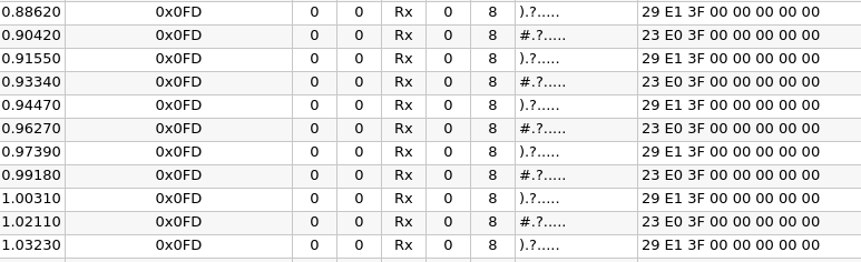

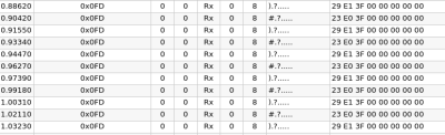

Nice, im glad someone has made progress, there is always the problem of finding a can log from a working car. I have a Valeo one from a different model, i wonder if the message structure is the same. What does the unit transmit over CAN when powered?
the one i have sends these messages:
00000190 8 10 92 a0 48 04 70 00 09
00000192 8 00 00 00 00 00 00 00 6a
00000193 8 00 00 00 00 00 00 00 6a
