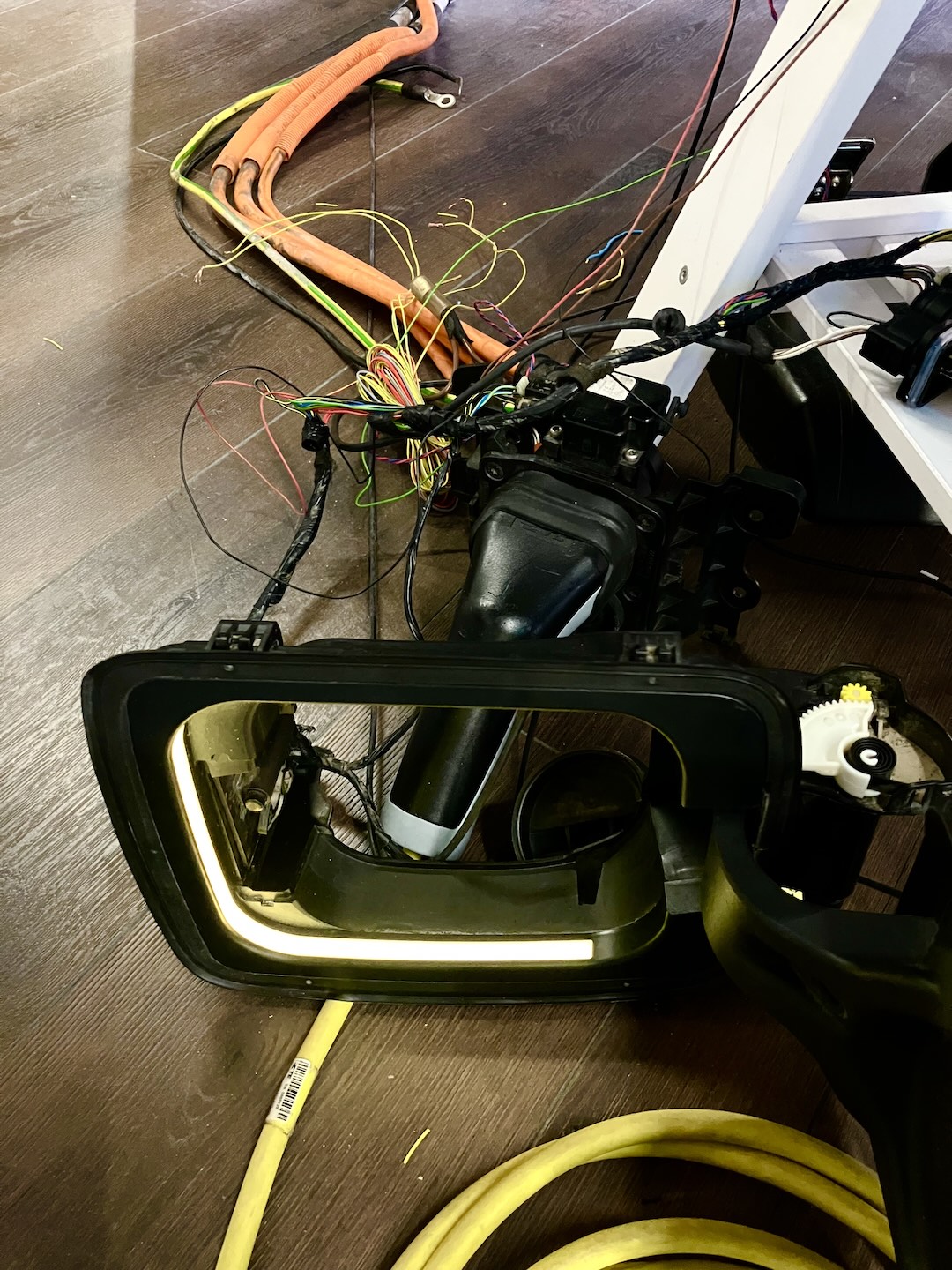

We are building an EVSE car simulator using the BMW i3 LIM + original harness + socket + lock + door, all sourced from the local scrapper. LIM part number is 61 35 9 454 319 (2020-05-30).
We managed to charge with AC, after spoofing all CAN messages, but the LED is not blinking BLUE (or staying BLUE for that matter), but it's doing a short YELLOW (or ORANGE) blink which is fine, then goes into blinking GREEN (or almost YELLOW), which we never saw anywhere.. is it the weld test failed doing this?
We get this: RX: 0x272 | Data: 07 FE 71 12 FF FF FF FF
Since we don't need the contactors for our use-case, we tried to desolder the internal R120 (0.12 ohm) resistors from inside the module and increase it 100x, added 12 ohms there and 15 kohms outside on the wires, but it seems it did not do the trick. We now ordered some 15 ohm 10W resistors with heatsink, will update here if it solves it.
Thank you in advance!

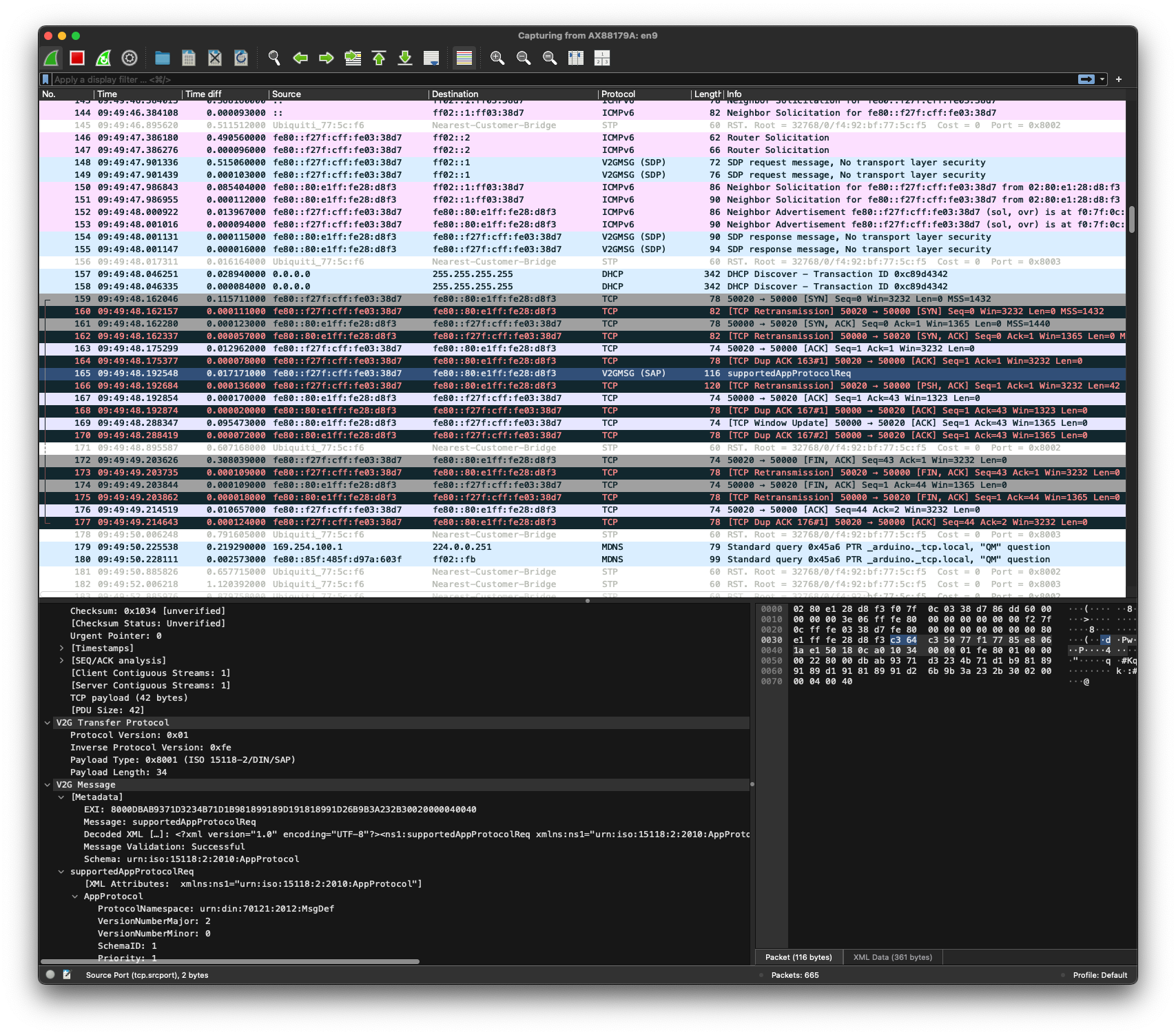

We are now testing the ISO 15118 connectivity, but we can't seem to receive any SLAC attenuation REQ from the LIM. We provide 5% PWM to the CP and we can see the state going into `CCS Comms` for a few seconds while the cable is locked, but then it unlocks the cable and gets into `5% DC` state and stays there forever. Even if we send charge command, it goes flashing yellow (charging), but we can't establish a PLC communication with it....
Any idea what we might be missing? Thank you!

We managed to make it work on SLAC, paired with the LIM on the bench. The missing puzzle was not setting `Phase_Init`= `0x1` in 0x2FA DC command 3.

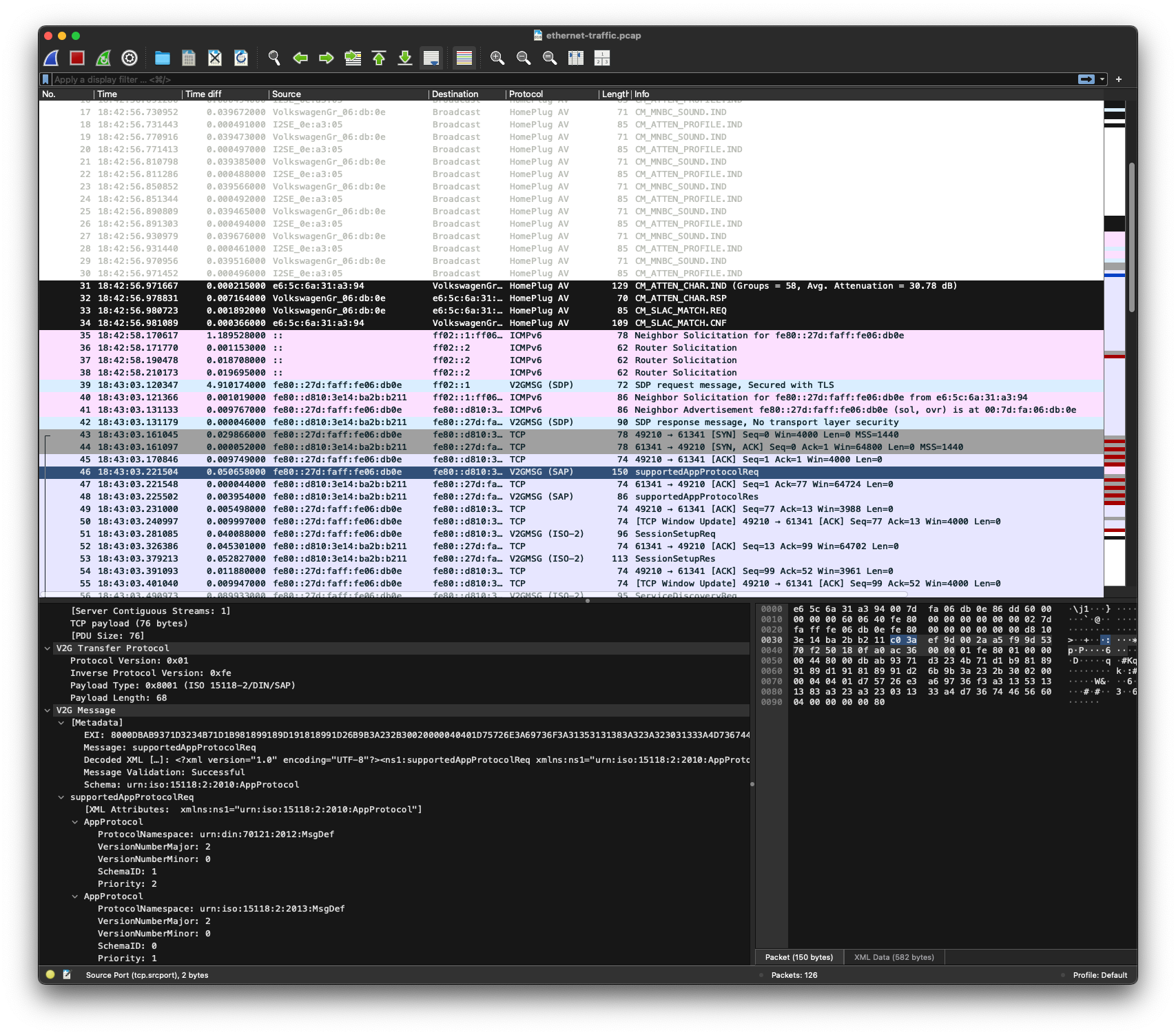

We are also testing and comparing different LIM versions, interestingly enough, on SDP it requested Security: 0x10 (No transport layer security), wondering how is ISO 15118-2 supposed to work without TLS? Also, if we force TLS, what V2G Roots does it check against? Hubject? We will try and see if it does AC on ISO-2, will report back our findings and update the wiki.
For posterity, we will answer our own question: BMW i3 and Mini Electric do NOT support ISO 15118 (not even -2), and not even on the 319 latest 2020 module revision. Also, it does not request TLS at all in the SDP, so most probably does not have any root certs installed.
For reference, I'm adding a comparison dump from VW ID.4; this is how the `supportedAppProtocolReq` should look like when both protocols are offered.
If nobody objects, I will update the wiki to reflect this. This means that in 2018 something else was changed when power was increased, it's still doing it via DIN.

ISO-15118 can be run without TLS. Some vehicles do prefer ISO over DIN even if TLS isn’t established. You’re not allowed to do contract based authentication (plug and charge) in this state, however. The station would only offer external payment for auth.
You can’t really “force” TLS unless you got the LIM to somehow request TLS. Even if you did request, if the station doesn’t support it, it will say so, and communication will be unencrypted.
Curious if it does support AC though.
