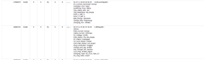

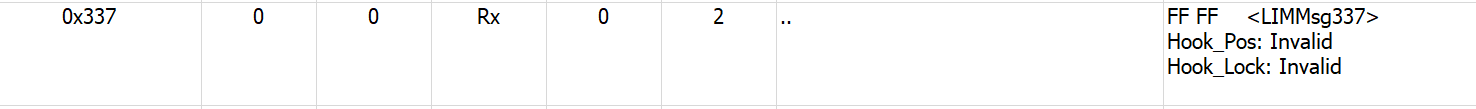

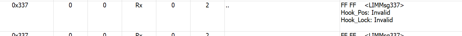

christoph wrote: Mon Dec 12, 2022 6:27 pm Meh, my LIM stopped locking the charging port when I plug in 😕 I measured the lock, it’s 1 kΩ unlocked, 11 kΩ locked as it should be.
Problem solved by sending a OBD reset:
https://github.com/cschleifenbaum/Stm32 ... 901d1e09e6

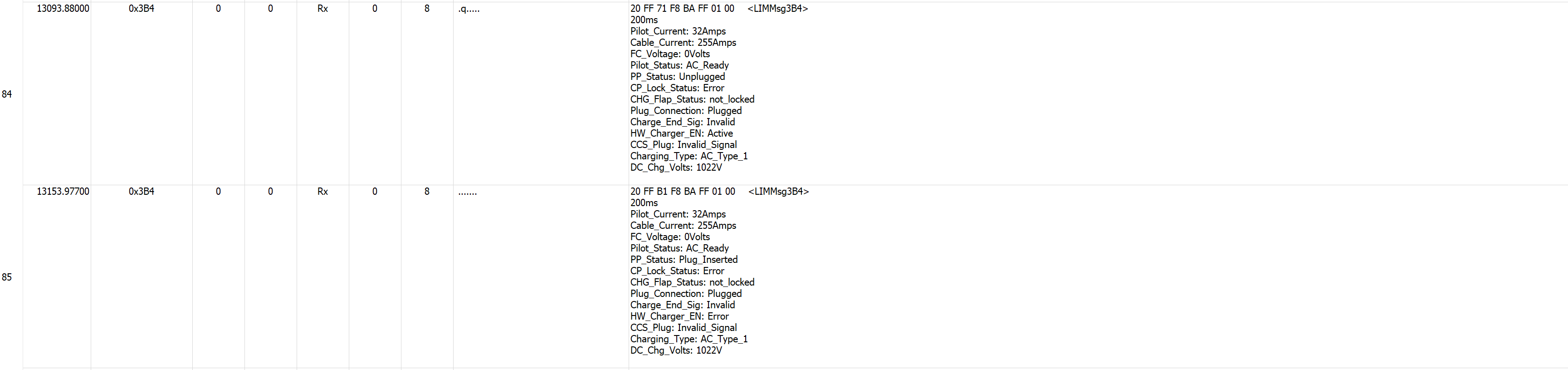

The lock status always remains in error state according to LIM.
LIM however reads the wall charger info, pilot, gives a-ok to charge, which I use it to kick BMS to wake AC charger via CAN and the charger wakes up. Though I don't have HV connected to the charger yet, but the charger starts sending back healthy status messages and detects AC on input. Wall charger says the car is charging.
Charge port LED is white when nothing plugged in; slowly pulsing blue during charge and green when finished.
Logs..
Plugged in..
Pressed stop charging button..
Unplugged..
Edit: I also put a scope on the latch motor outputs of the LIM. Doesn't look like LIM is even trying to kick the motor.

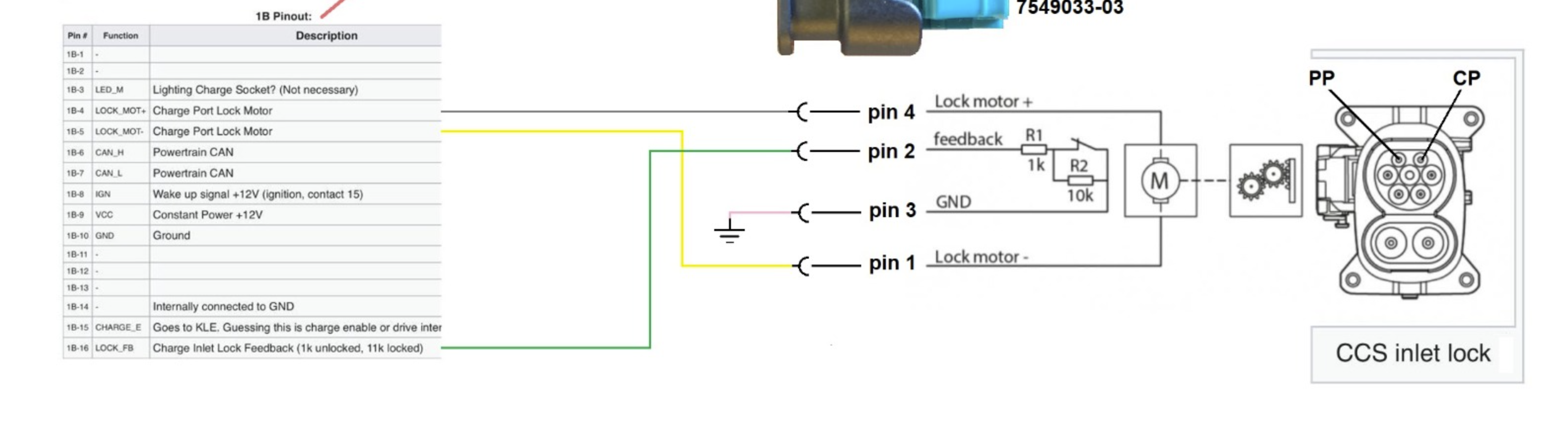

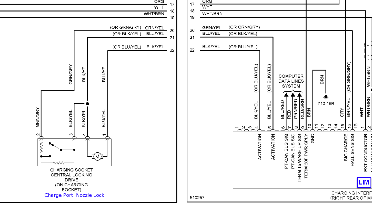

So I tried both wiring versions per wiki without luck. - Lock pin#3 to ground or lock pin#3 connected to lock pin#4.
I plugged in my Type2 LIM and it immediately detected the inlet lock correctly! Measuring voltages on the feedback leg 1B-16 I'm getting same voltage values but opposite polarities on Type2 vs. Type1 LIMs. Connection error? How can it be inverted?
Type 2 LIM:
1. Leave inlet lock pin #3 floating - 1B-16 reads -4.26VDC
2. Connect lock pin #3 to ground - 1B-16 reads -0.76VDC in unlocked, and -2.94VDC in locked state
Type 1 LIM:
1. Leave inlet lock pin #3 floating - 1B-16 reads +4.26VDC
2. Connect lock pin #3 to ground - 1B-16 reads +0.76VDC in unlocked, and +2.94VDC in locked state
If I connect the lock pin #3 to #4 as per one of the diagrams, the feedback 1B-16 reads constant +4.3VDC no matter the lock position.

Speaking with @Shockazulu1 who used ZombieVCU + Type 1 LIM + Type 1 i3 charge port combo to successfully charge in the US. LIM does not lock the inlet on his vehicle during the AC charging either, but it does during the DC charging. Yet another difference for the Type 1 vehicles!?
Guess I'll see how it goes at the public AC and DC chargers.
He uses this diagram:
Big thanks to @Shockazulu1!

Type 1 LIM does not lock Charge Inlet when AC Charging:
-the switch in the charging handle is also the unlock trigger for the catch on the handle. Some EVSEs with tehered type 1s do not have any other way to stop charge.
Type 2 LIM locks Charge Inlet when DC Charging:
-required by charging standards
Type 2 Lim always locks when charging

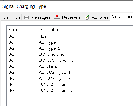

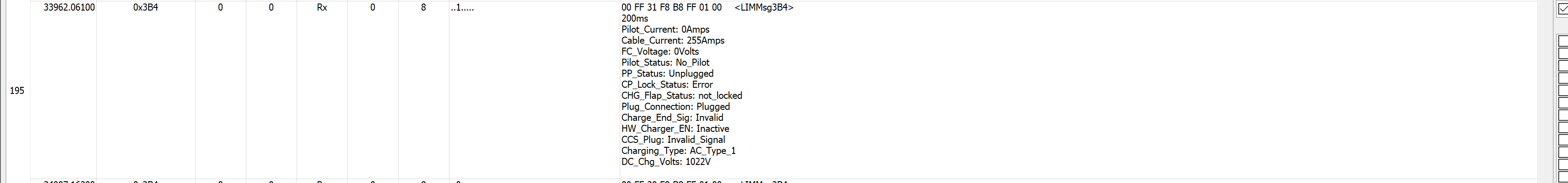

Yes, sorry, I'll elaborate. I attempted a DC charge at EVSE, yesterday, but was unsuccessful. Reviewing the logfile my code kept waiting in the initiation phase for the EVSE to id itself as DC-Type2 = 0x9, but in fact it was DC-Type1 identifying itself as 0x4. so no charge and EVSE timed-out.
Looks like the correction for the DC-Type1 was addressed with this.
tom91 wrote: Thu Dec 07, 2023 8:37 am
            if(ChargeType==0x04 || ChargeType==0x28|| ChargeType==0x09) lim_stateCnt++;
I'm adding ChargeType==0x04. I'm curious what is 0x28? Below are the EVSE type codes I'm aware of that LIM returns. Hence, I wonder if 0x28 is the AC+DC combo type 2 EVSE and if so, should 0x14 be added as the AC+DC Type 1 EVSE?
0...none
1...AC-Type1
2...AC-Type2
3...Chahdemo
4...DC-Type1
5...AC-CN
8...DC-Type2
10...DC-GB_T
Posts: 2962
Has thanked: 328 times
Been thanked: 847 times
alexbeatle wrote: Tue Oct 22, 2024 6:37 pm I wonder if 0x28 is the AC+DC combo type 2 EVSE and if so, should 0x14 be added as the AC+DC Type 1 EVSE?
No idea where the 0x28 came from, might be my bad or from a log. No point adding more unless you find details in a log.
This is from the DBC

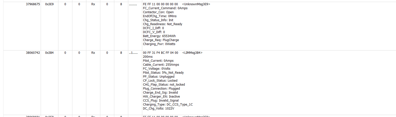

What’s the difference between DC-Type1 0x4 and DC-Type1C 0x8?
Posts: 2962
alexbeatle wrote: Tue Oct 22, 2024 7:44 pm What’s the difference between DC-Type1 0x4 and DC-Type1C 0x8?
DOH thats what I meant by 0x28 meant to be 0x08.
No idea what the difference is, its BMW magic

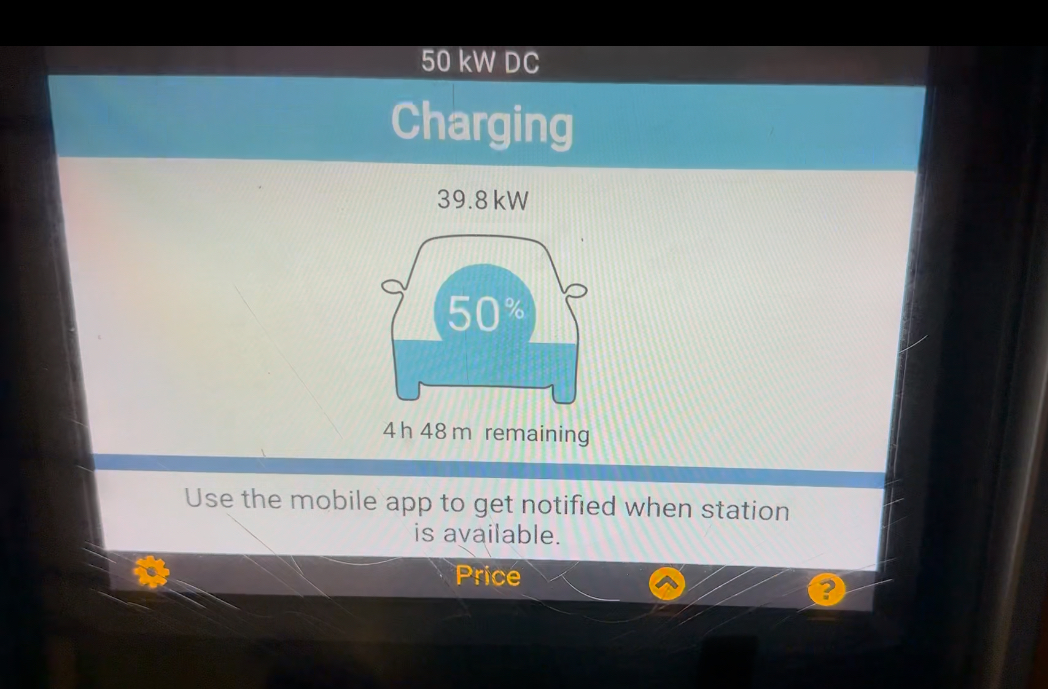

We're in business!
2 successful trials at the Electrify America CCS Type 1 using Damien's code migrated to my Teensy VCU. Slow speed for now - 5A and 20A, but proves the concept. VCU controls the LIM using BMS limits. LIM controls 2x small 15ohm contacts, which in trigger larger kilovacs.
Still a few kinks (ex. Full and Bulk SOC times are off), but the backbone works great. Thank you.
Attaching the log for the 5A charging session if of interest. Unfortunately the SavvyCAN crashed on the 20A so no log, but this video is from the 20A session.

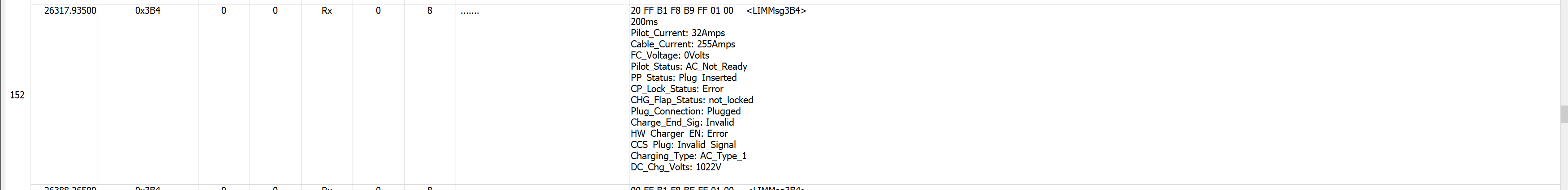

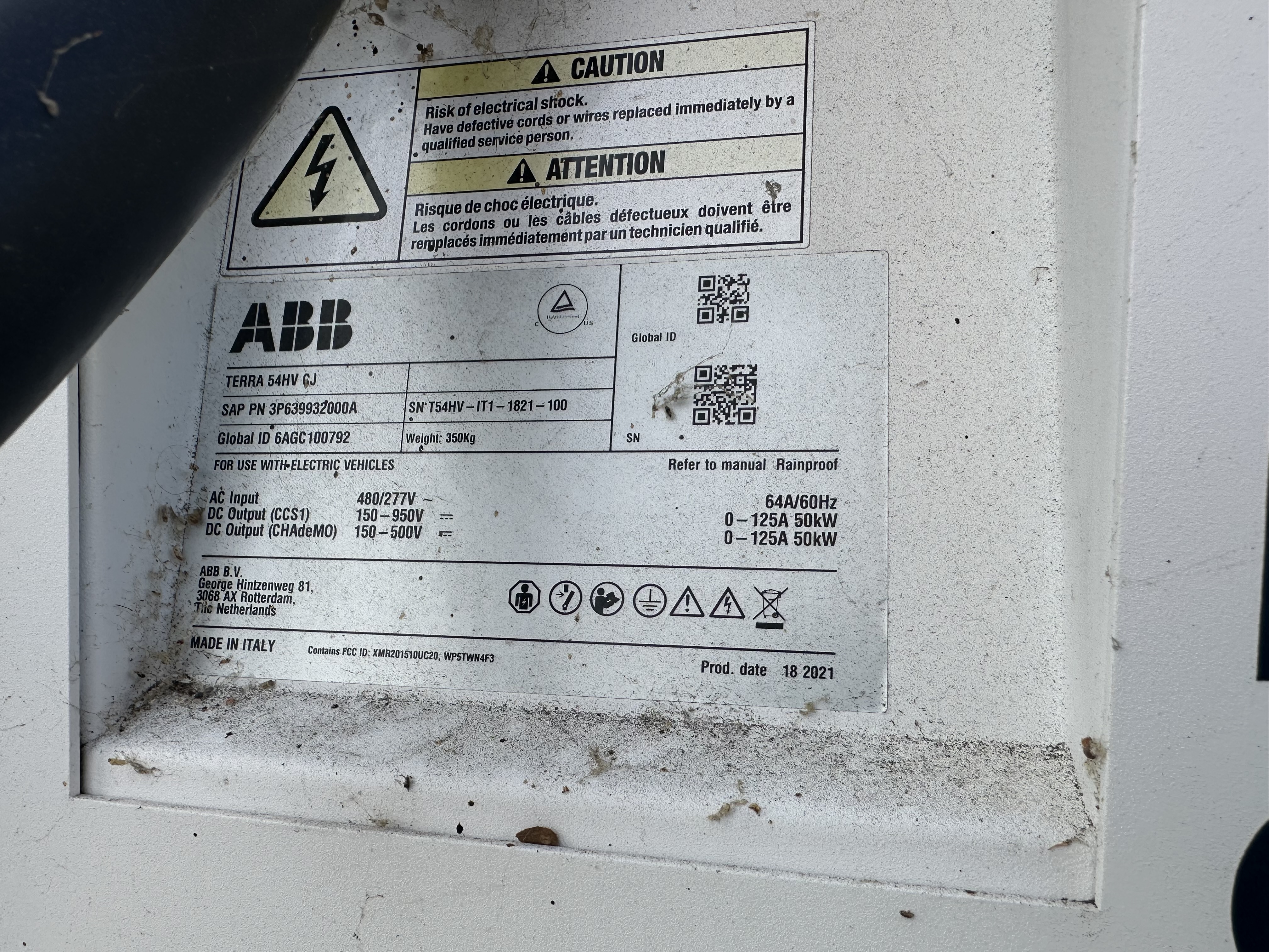

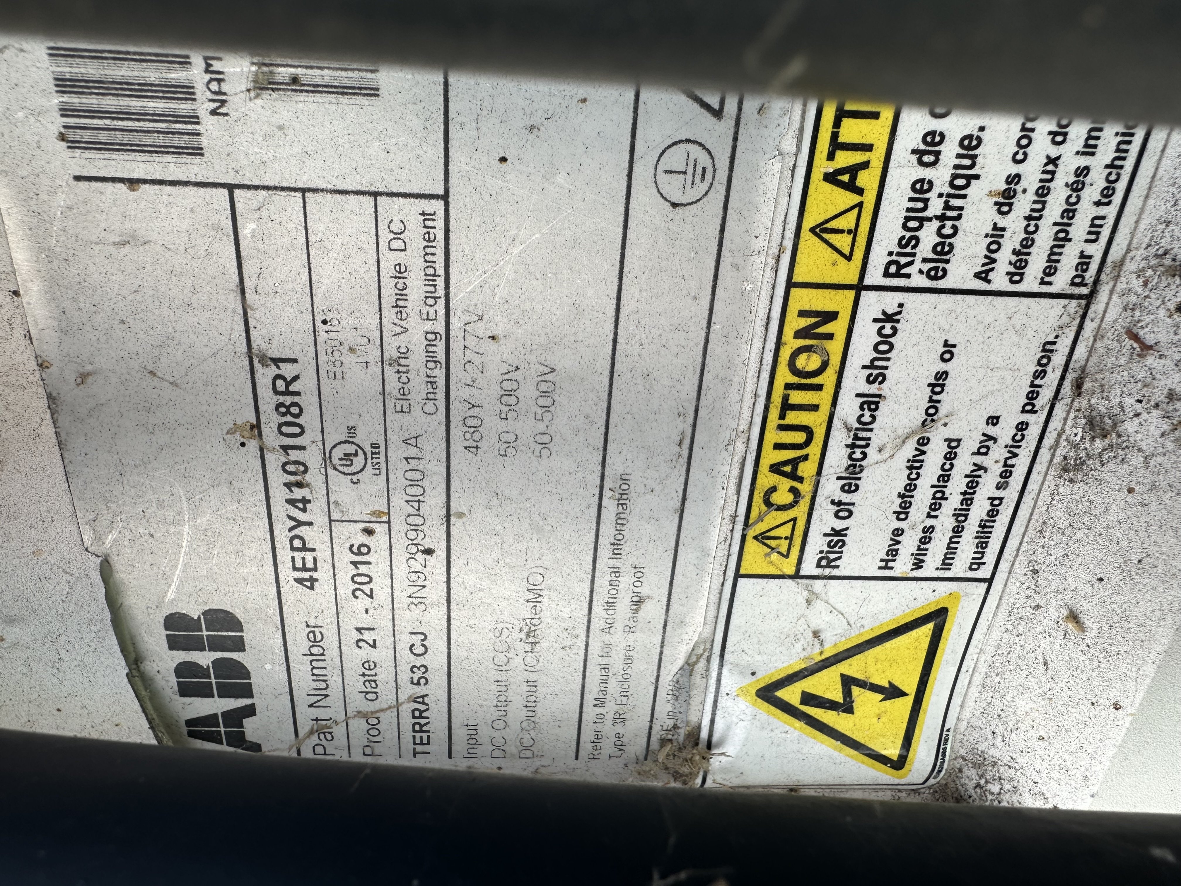

I attempted to charge at a different network today - EVGo. Unfortunately, not successful.
Plugged in vehicle, payment authorised, but within seconds says comm failures with the vehicle.
There were 2 stations. The second one was occupied, but I saw the driver had to start his charging session twice to start on his OEM car.
I tried twice, both times unsuccessfully. I don't have another EVGo nearby, but they're quite common, so would be good to figure them out.
I'll go back tomorrow to try again.
Logs below.
Looks like my state machine enters the CableTest, but then the pilot goes static so charging drops.
Please let me know if you see anything I do not.
Thanks in advance.

Went back to the EVGo today - no go. Fails on the CableTest again. Attaching logs. I saw a car successfully charging on it before me, though.
Today I added LIM contactor re-test code thinking this was the issue. I can hear contactors toggling when I initiate the re-test and they return A-OK status. celeron55's kind wiki writeup helped me, thank you!
I wonder if the below Shockazulu1's issues are somehow related to mine as my CableTest fails so quickly, no contacts close as if vehicle's response isn't fast enough.
Could you please let me know if Shockazulu1's timing changes made it to the main revision or if not, is this the timing related to <case 3> of the LIM code?

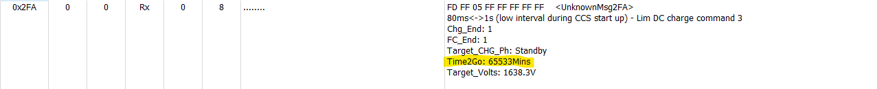

I went to re-test Electrify America with which I was successful before, though at a different location now and it charged no problem. I tested charging at 20A/5kW and 50A/14kW, both charged successfully.
The oddity with this one though, is I'm not sure where it's getting the remaining time to charge from. Says it's receiving from the vehicle, the value is in minutes, but decrements faster then once a minute. Not quite sure where it is taking these values from, as seen in the logs I'm sending 1800s for BulkSOC time and 2400s for FullSOC time, for now.
Attaching logs.

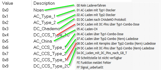

BMW says.:
00 Kein Ladeverfahren
01 AC-Laden mit Typ1-Stecker
02 AC-Laden mit Typ2-Stecker
03 DC-Laden nach CHAdeMO-Protokoll
04 DC-Laden mit DC-Pins über Typ1-Combo-Dose
05 AC-Laden-CN
06 AC-Laden über Typ1-Combo-Dose
07 AC-Laden über Typ2-Combo (Kern)-Ladedose
08 DC-Laden mit Kernpins über Typ2-Combo (Kern)-Ladedose
09 DC-Laden mit DC-Pins über Typ2-Combo (Kern)-Ladedose
0A DC_Laden_mit_DC_Pins_nach_GB_T
FD Schnittstelle ist nicht verfügbar
FE Funktion meldet Fehler
FF Signal_unbefuellt
I think it means DC charging with the AC pins of a type 2 socket.

If we trust the BWM source, the dbc would be wrong in the red marked cases:
Assuming the prefix "C" in the dbc means "core", so the 6mm pins.
Arg, wrong color of number 9, this is DC via 8mm, aka DC extended, so *not* core, wrong suffix C in the DBC.
muehlpower
Posts: 807
Has thanked: 18 times
Been thanked: 186 times
Post by muehlpower »
uhi22 wrote: Mon Oct 28, 2024 6:33 pm Assuming the prefix "C" in the dbc means "core", so the 6mm pins.
Assuming “C” stands for “combo”, then everything fits except 0x8

Lots of different forums claim EVGo is no good - random charging fails, randomly some cars can charge while others can't. The person charging his car today told me his car would fail to charge few hours earlier, but worked this time and he finds this to be a normal practice.
Not sure what to think, I attempted 6 times at 2 stations that are next to each other today, but no go. Though I noticed, sometimes the latch extends and then retracts and logs say "latch error", other times the latch stays on, yet still "comm with car fails". The plug latch looks a little wider than others I've seen, but observing the port latch, it seems to latch it without issue.
Went to a different charging network today - ChargePoint - success. Multiple sessions at different amp rates - all worked. Though initiation before energy transfer takes quite a while.
If interested, here's a log of charging at 125A (max. charger capacity), with the current slowly derating per BMS charge curve. 150A is what I set my BMS max. charge current, but my VCU selected the lowest between the capability and availability.
The time-to-charge for this one always started at 5hrs, no matter the charge current requested. Oh, and minutes decrease at the rate faster than once a minute . :roll:
CP_Pass_150A-125A_20241028.csv
(16.56 MiB) Downloaded 528 times

Anybody explored the Time2Go value in the 0x2FA? Perhaps this is the key to displaying the remaining charge correctly on the chargers.
dbc says it's in minutes on first 2 bytes, but Zombie sends these 0xFC and 0xFD commands there too...
    uint8_t bytes[8];
//Lim command 3. Used in DC mode.
[b]    if(CP_Mode==0x4||CP_Mode==0x5) bytes[0] = 0xFC;
    else bytes[0] = 0xFD;[/b]
//bytes[0] = 0xFD;// FD at standby, change to FC on 5% pilot. Change back to FD during energy transfer
    bytes[1] = 0xFF;//these bytes are used as a timer during energy transfer but not at setup
    bytes[2] = (uint8_t)Chg_Phase<<4;  //upper nibble seems to be a mode command to the ccs station. 0 when off, 9 when in constant current phase of cycle.
    //more investigation needed here...
    //Lower nibble seems to be intended for two end charge commands each of 2 bits.
    bytes[4] = 0xff;
    bytes[5] = 0xff;
    bytes[6] = 0xff;
    bytes[7] = 0xff;
    can->Send(0x2fa, (uint32_t*)bytes,8); // this msg varies from 82ms to 1s intervals.

I found the manufacturer of the EVGo station - the infamous ABB Terra 53 and 54, side by side.
Looks like these had issues, but resolved here.
