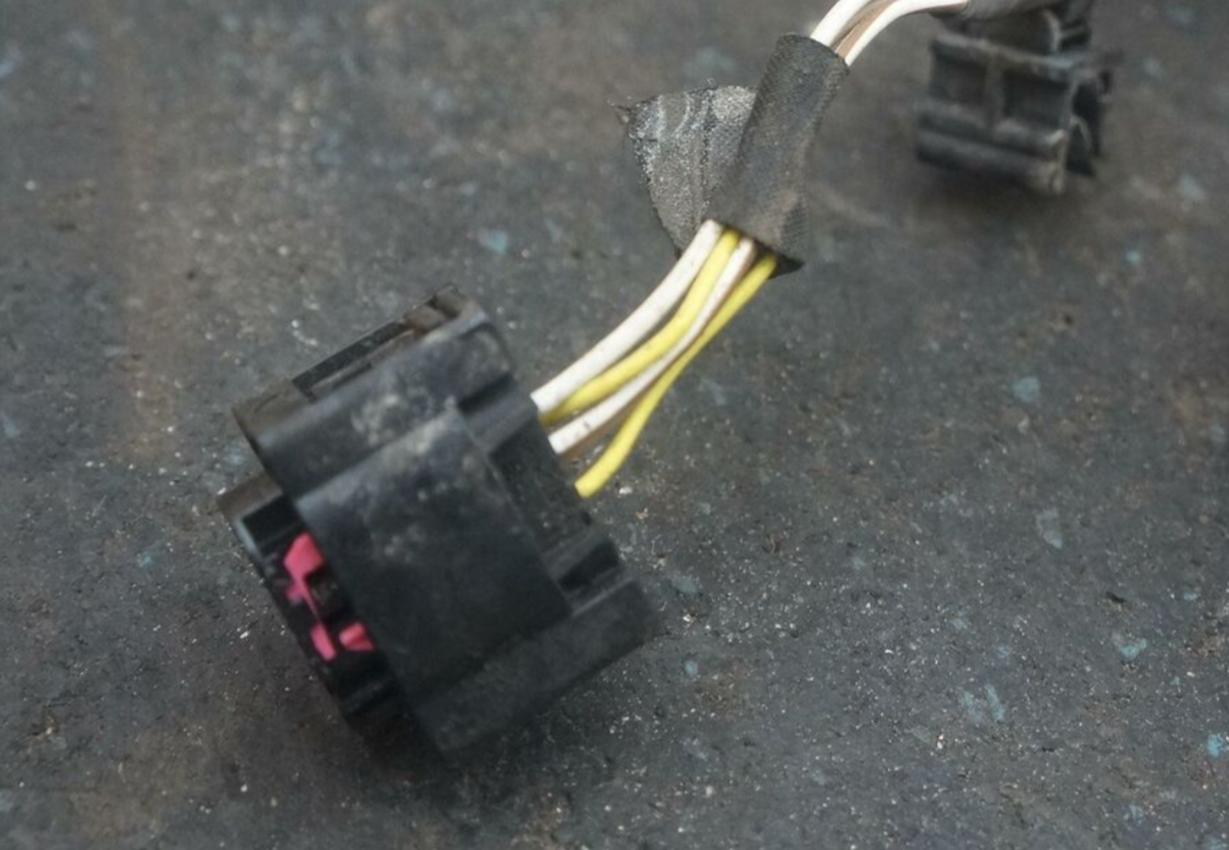

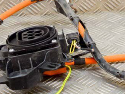

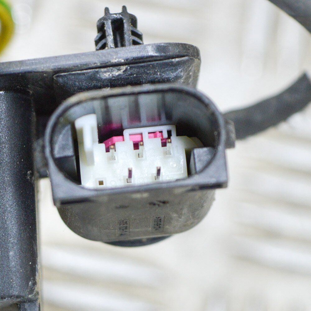

I edited my previous post as I was wrong regarding the lack of this jumper on OEM I3 harnesses, they have the jumper...
The BMW IX3 has a different connector so I can't with compare with that one... but the i8 has the same connector and also the Jumper between 2B-3 and 2B-4, the BMW 330e HV loom has also the Jumper and like on the MINI the jumper is between 2B-4 and 2B-5:

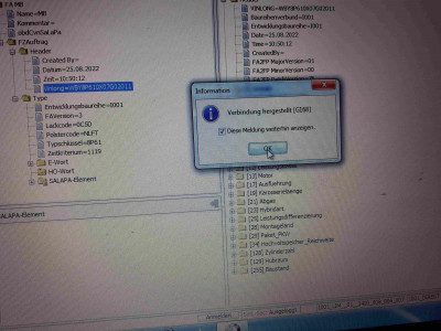

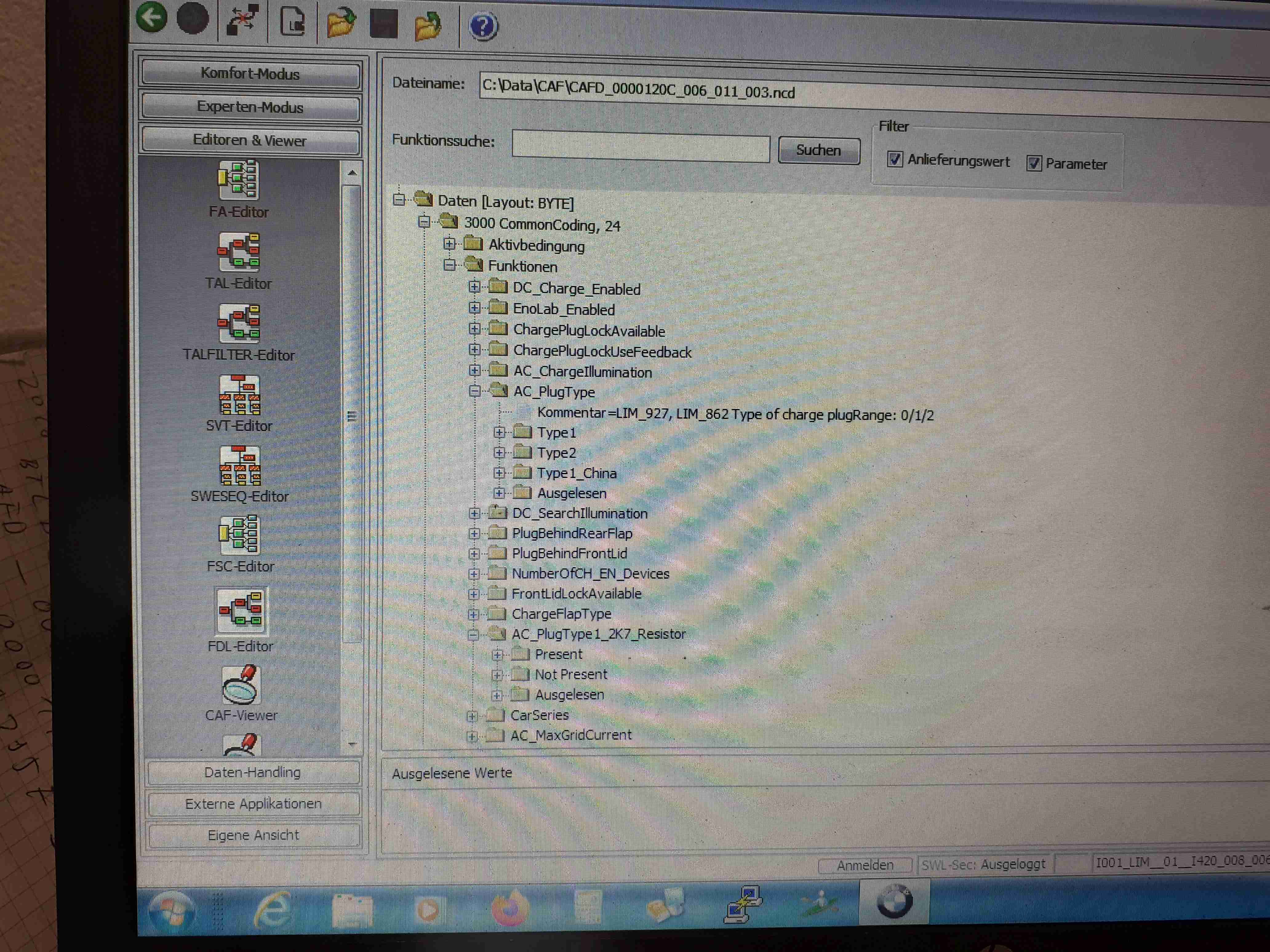

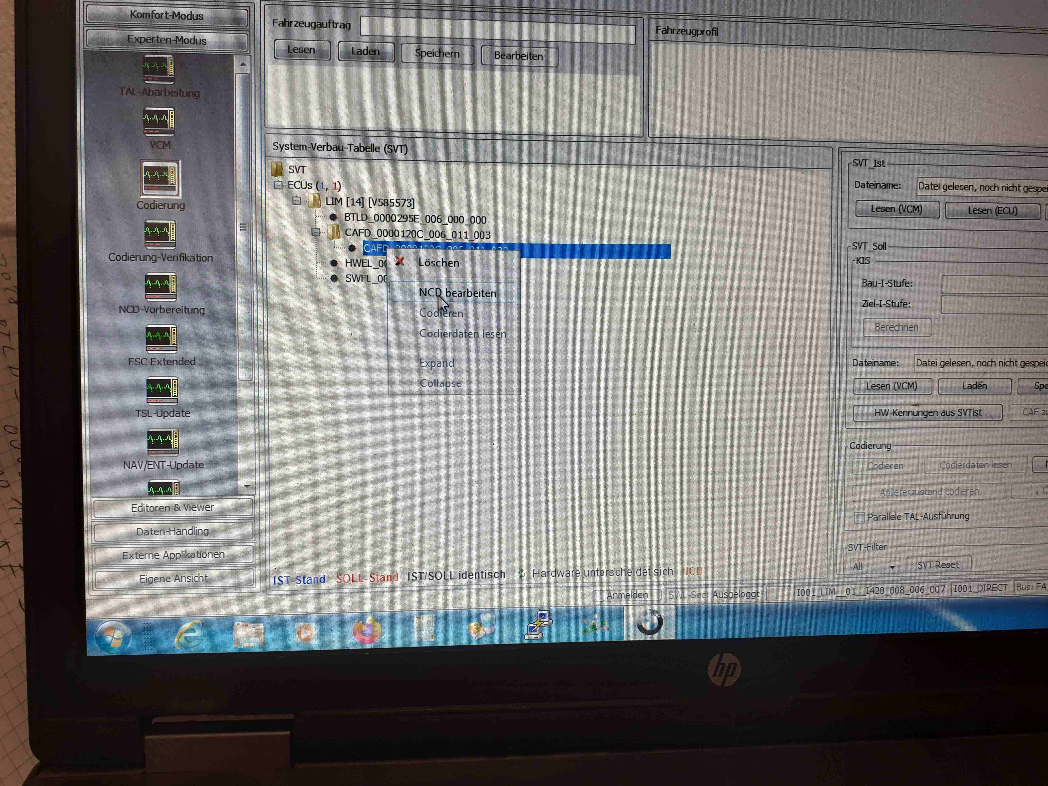

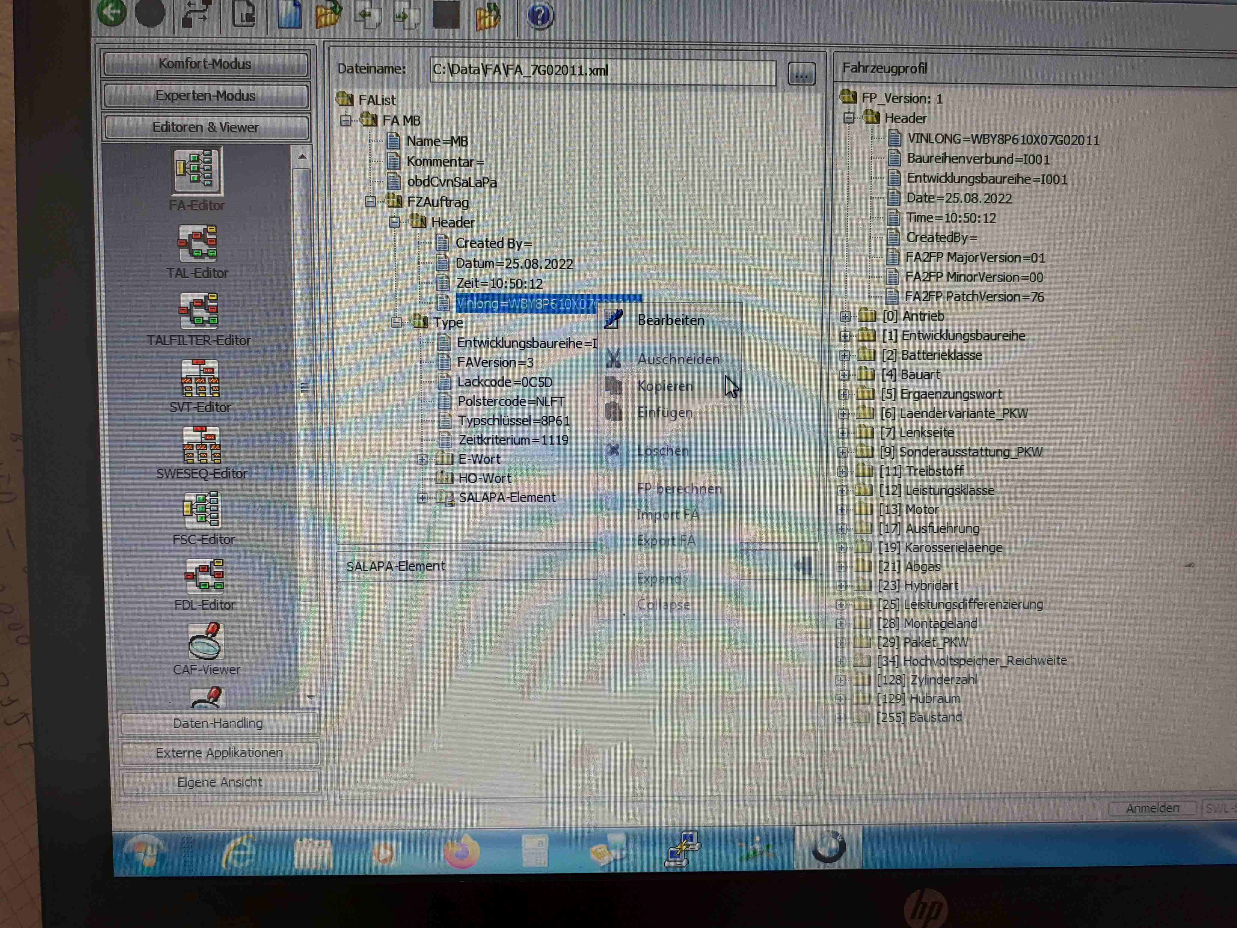

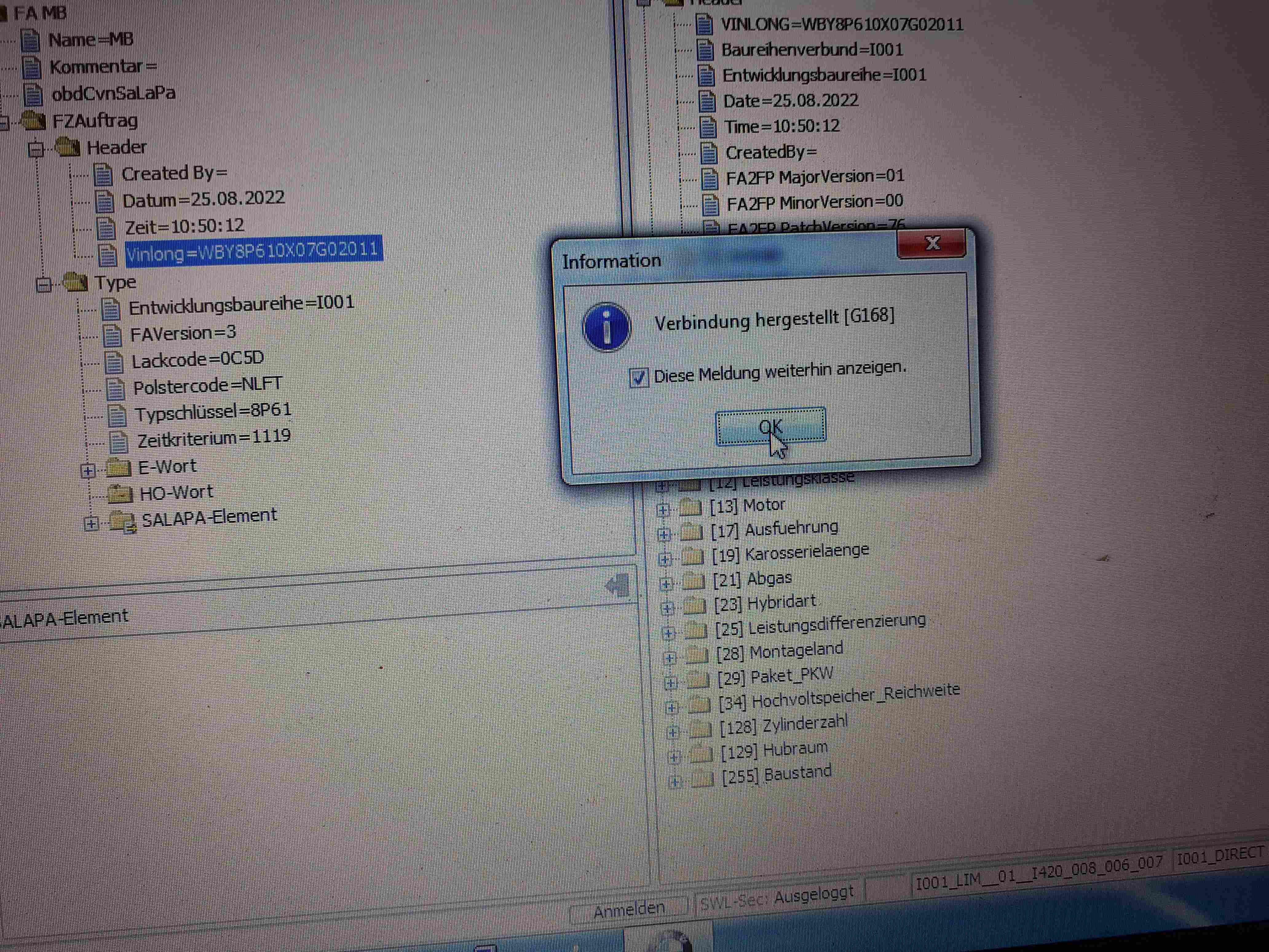

As already written, I use nothing but a Vector CAN card, 12V supply and E-Sys. I have the Fahrzeugauftrag (FA) as a file and do not need to read it from the key. Due to the direct connection with the Vector Card, I don't need a BCD as a gateway either.
I don't know how to sort the pictures, so I numbered them.
The pictures are in the wrong order, bottom to top is correct. The first shows the FA editor, with it I can edit and save the VIN and options. Then you can see how I establish the connection, read the code from the LIM and how I can change the code. As an example, I unfolded two folders.

Are you able to attach/share the FA file?

In the Wiki, I've created a stub to describe this method of LIM configuration programming. Could someone with more detailed knowledge please take a few minutes and update it?
https://openinverter.org/wiki/BMW_I3_Fast_Charging_LIM_Module#Programming_LIM_using_Vector_CAN_and_Fahrzeugauftrag_file

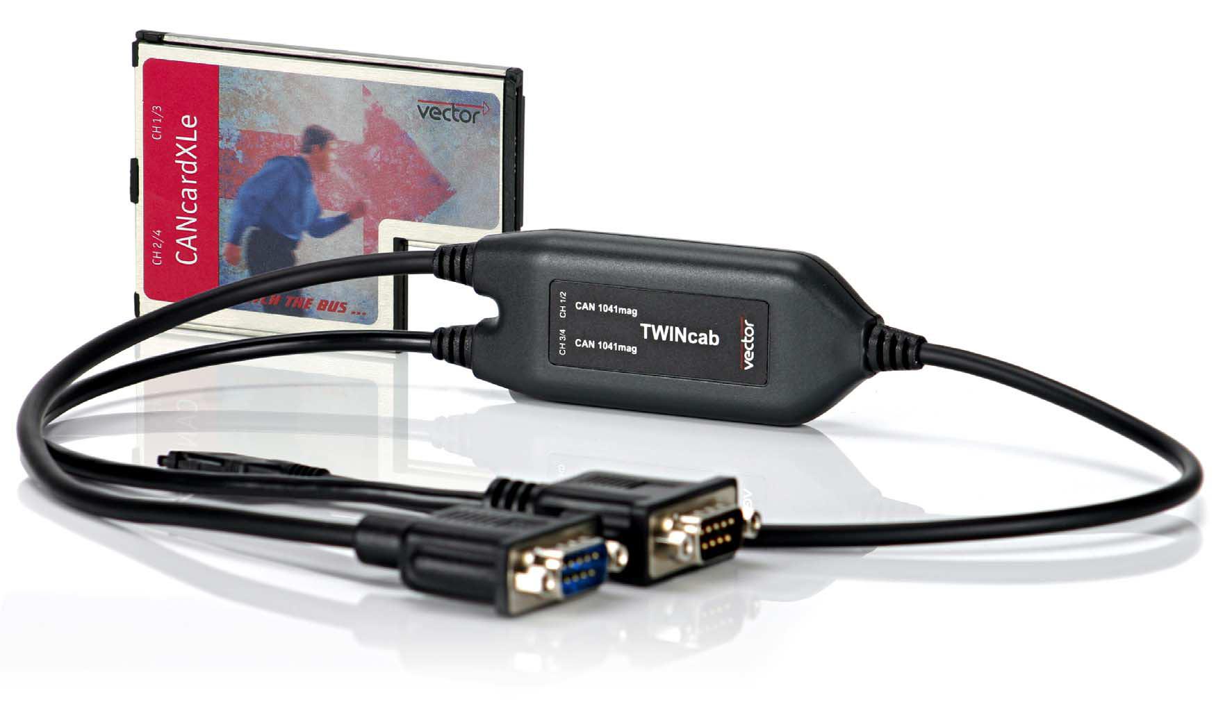

I'm unfamiliar with this hardware, and ten minutes with Google isn't enlightening. Can you elaborate on this hardware?muehlpower wrote: ↑Fri Mar 17, 2023 4:49 pm As already written, I use nothing but a Vector CAN card . . .
What version of BMW E-Sys are you using? The "easy" versions I can get are quite old (2014-ish) v3.23 or thereabouts. I can get newer versions for an add'l fee, but is that necessary?
For those of us who aren't familiar with using E-Sys and coding BMW parts, where can we obtain this configuration file? Is is supplied with E-Sys, or do we have to get is somewhere else?muehlpower wrote: ↑Fri Mar 17, 2023 4:49 pmI have the Fahrzeugauftrag (FA) as a file and do not need to read it from the key.
[I have experience with several other manufacturers' proprietary software, but not BMW's. E-Sys can't be any worse than MB's Star Diagnostic/Xsentry/DAS suite.]

I have E-Sys 3.34.0. On this site i found a download for 3.30. https://bmwtune.com/ I think that works too. I have the configuration file on the computer and can give it to you.

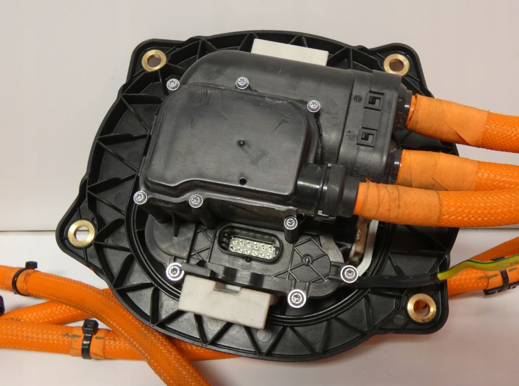

the hardware looks like this:
