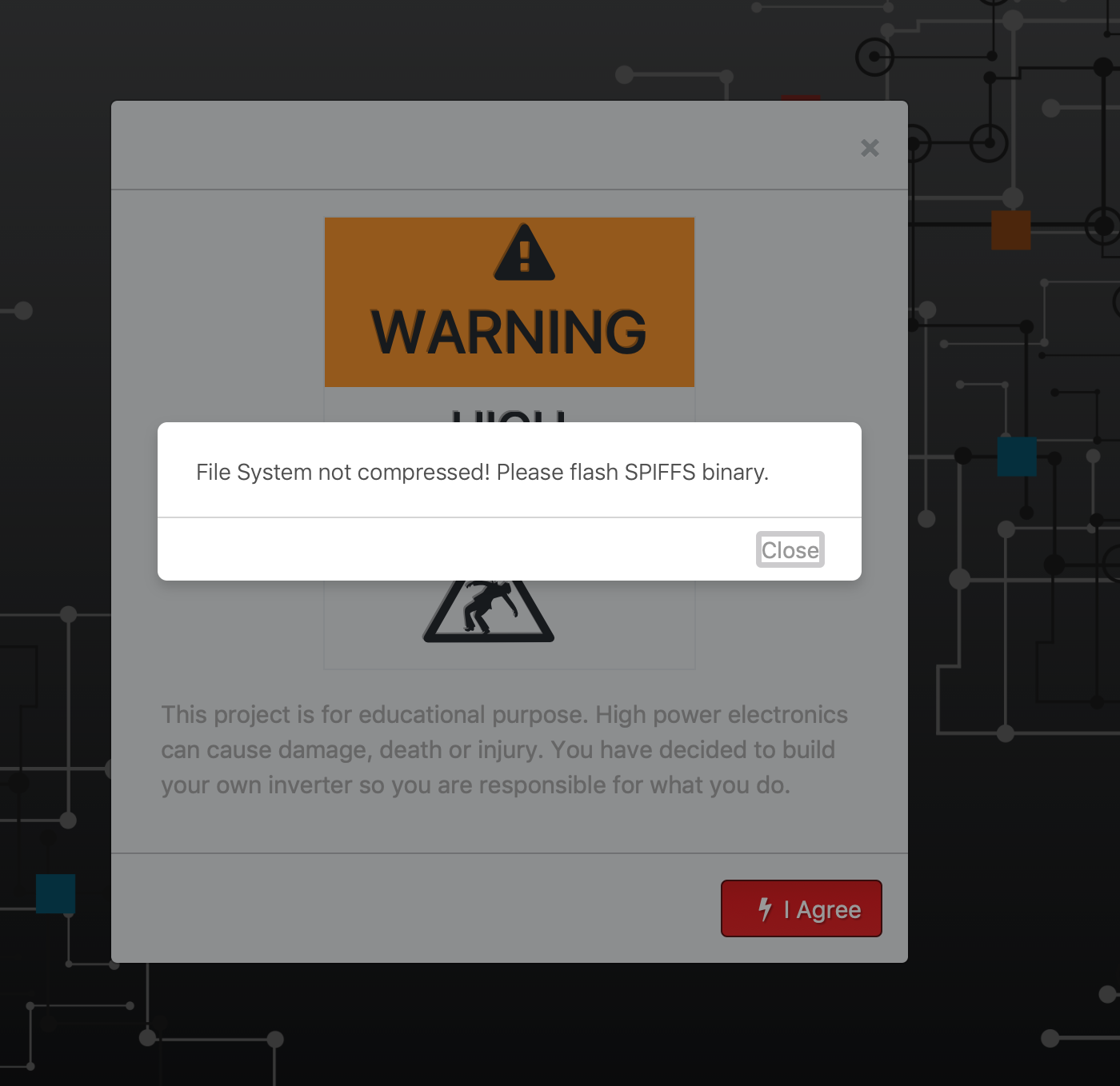

Maybe I spoke too soon. It worked, but now I get a "not compressed" message. I've tried running the script again and selecting "compress javascript -y" when prompted. Anyone have this happen as well?

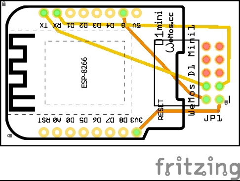

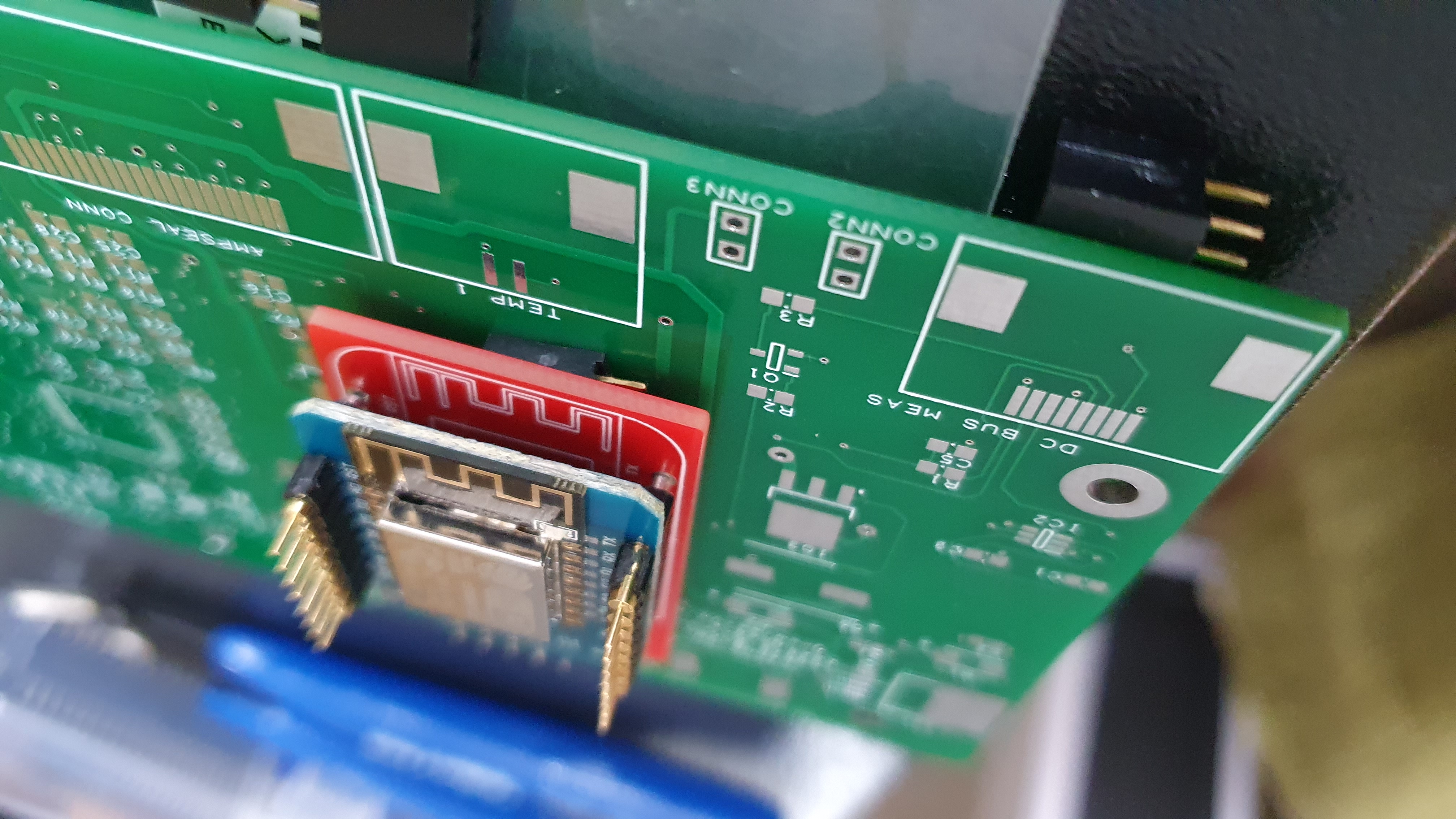

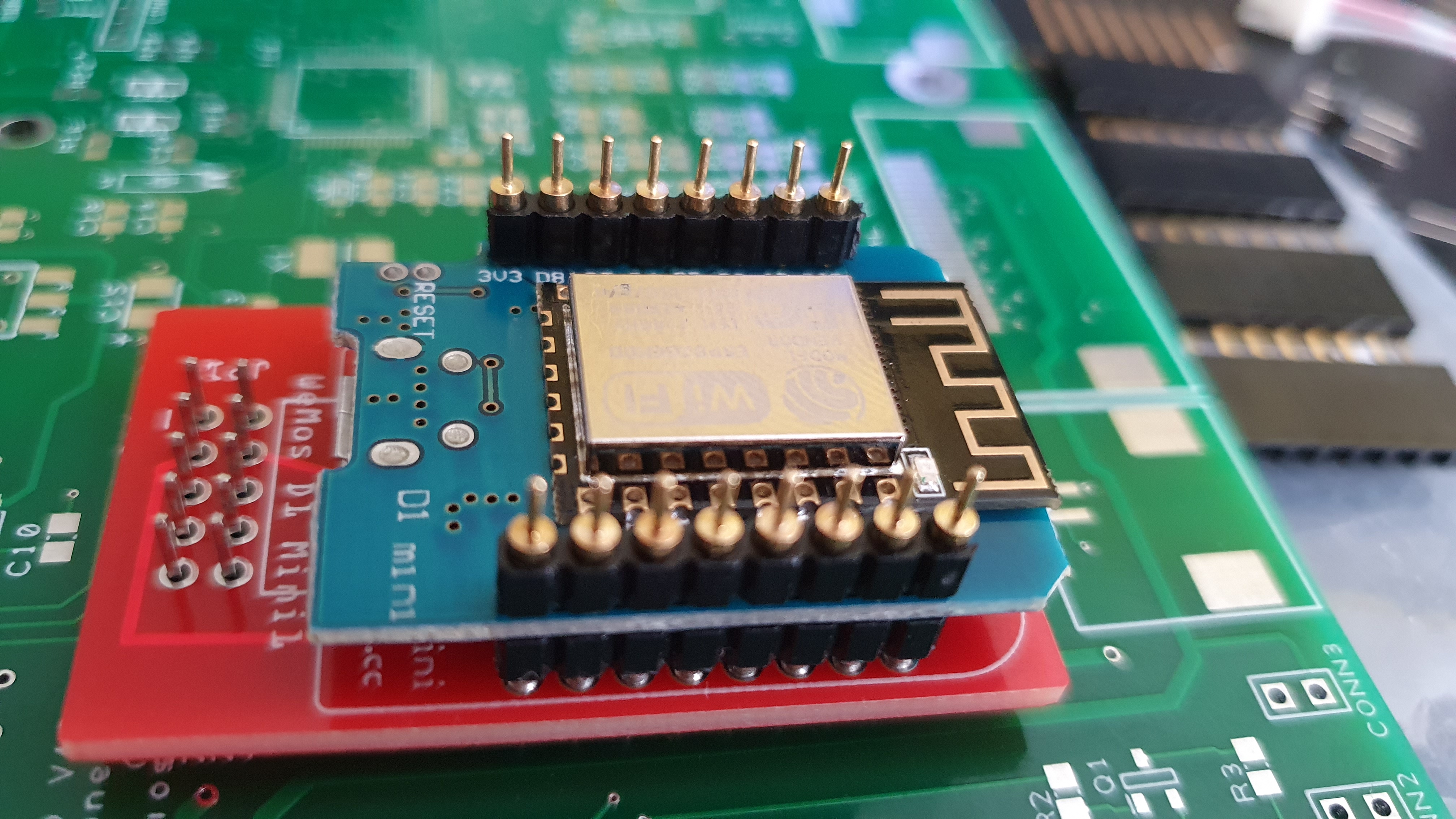

you can us a Wimos D1 Mini I've been working on a shield for the LDU to use the Wimos instead of the Olimex. I have the gerber files and PCB file for Fritz. It Works waiting for my parts to populate my board. Working on my 1991 Mercedes 300CE EV Conversion with a Tesla LDU. All Nissan Leaf battery pack fits in the front, this car came with a M104 6cyl cast iron engine about 900 lbs. Less than the battery pack.
[img]

kaleb wrote: Wed Sep 30, 2020 12:29 am Maybe I spoke too soon. It worked, but now I get a "not compressed" message. I've tried running the script again and selecting "compress javascript -y" when prompted. Anyone have this happen as well?
To get it to work using Arduino IDE, I had to do first a "normal" upload (Sketch -> Upload) and then sketch data upload (Tools -> ESP8266 Sketch Data Upload).
