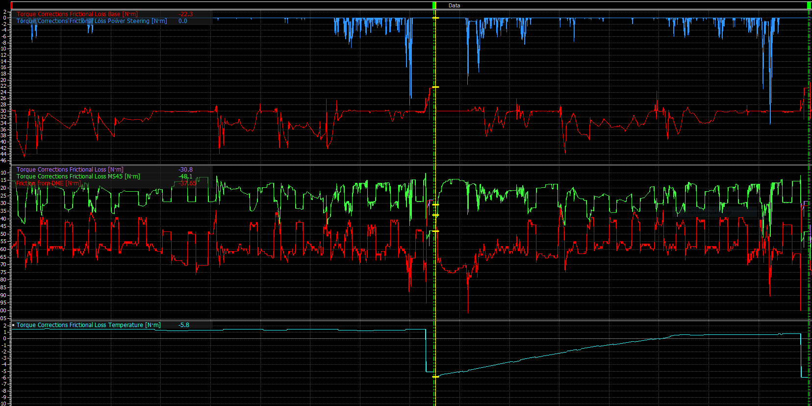

I also am back to trying to get data on the 330 to be more reasonable.
Item 1 is friction.
Looks like I've zigged when I should have zagged:
Looks like I messed up with a sign somewhere.
After this, revisit idle control so that the revs don't fall quite as quickly as they are now. I think the fact that I'm falling past the target RPM is what is giving me trouble.
If necessary, implement PID control on airflow target.
-Matt

Ok lets try that again, shall we?
* Engine Coolant Temperature "Firmware ##" value was completely wrong - because it was in use by the Bosch Racing integration module. Moved it to Firmware 31 (max value) and now I have coolant temperature readings.
* As a result of coolant temperature readings now being correct, friction from temperature should be closer to correct.
* Base values are much, much closer now.
Is it perfect? Nope. Is it a lot closer? Yes!
Voltage values for the MAF seem lower than they should be. This may be affecting the base values a bit as well. As long as I can get values which are in the right ballpark as the stock ECU when under my control, then I'll consider that successful. Not going to go crazy here.
Lambda sensors are not showing up. CAN wiring may have gotten upset. Need to look at that tomorrow.
Then revisit idle control. That's going to be fun.
But, one thing at a time. That's how I'm going to get this done in the next 3 months. I have 4 to get it either all working or converted to an EV as that's when my emissions test is due :)
-Matt

Ok so the missing item is...the alternator. Apparently there's a table which correlates alternator torque / output to the friction losses. Since I have no idea how much power is being generated, my initial guestimate of 15 Nm is going back in. But now accounted for in the right spot. :)
Now on to idle control. That'll be a bit more involved.

Well, I got everything integrated and flashed. I turned on the option to use the new code, and...
A. What a difference a little filtering makes. ;) (Engine Speed Gradient vs Filtered version)
B. I wasn't sure the car was going to idle at all. So, quite happy.
I took a spin around the block and I need to fix the fueling first, it'll stall sometimes coming to a stop. Still doesn't shift to second gear yet. :( But I haven't touched any gear shift stuff recently, so not entirely shocked there.
Still more to go, but goal for today (start car, get it to idle) - achieved.

should be functionally equivalent. Except, it's not.
Turns out integer rounding will bite your butt. Because I had 60 / ... and not 60.0 / ... and using 16 and 256 in other places..I was getting wheel speeds that were only accurate to 1 km/h. Oops.
Also, that code was written before I had a better handle on bit shifting and ORing stuff together. The new code makes more sense, and probably faster, too.
Slowly returning to this stuff, I've got someone who's actually placing orders for my MoTeC M3 package, which is where I found this issue.
I'm dealing with some 'life events' and also trying to help repair my grandmother's house in NY, so there's still unfortunately a larger-than-I'd-like number of things going on, but I should be able to dedicate a >0% of time to the forum, Zombieverter code, and eventually getting my stuff squared away and working.
With respect to my commercial MoTeC stuff, these two BMW packages and my Porsche 996/997 package will probably be the last stuff I work on. Just too much time in - not nearly as fun as it was in the past. I have good people I think I can hand it off to, so at least there will be something good that comes out of it.
I plan on carrying out the EV conversion of the 330. The M3 may not get the hybrid setup in the end, that might be too much effort.
I'll try and catch up on other posts.
