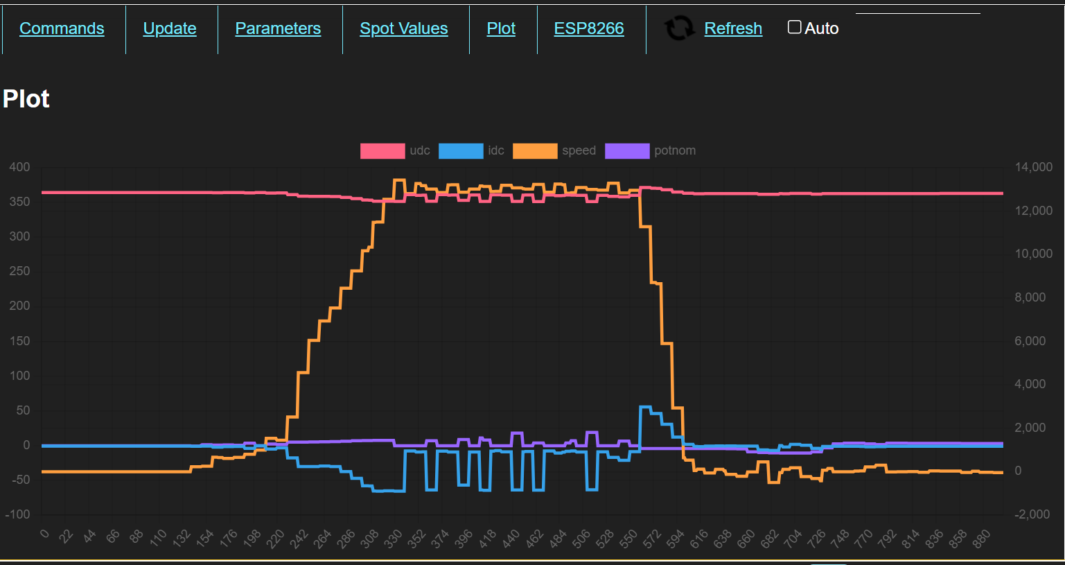

So went for a short fun drive before getting the wheels in the air for a spin test.
Posts: 2962
Has thanked: 328 times
Been thanked: 847 times
Re: Unlocking the power/torque of Prius gen 3 drive train?
So there is regen happening.
Need to see if Potnom gets to the -15. Looks like your torque gets to 350ish as it lines up with UDC on your plot. So from this it seems okay as potnom -100 to 100 gets scaled to torque -3500 to 3500, or in your case as its flipped the signs flip.
You seem to be getting to -10 to -15 potnom as per your setting. I would bump your value for regenmax, this is for throttle regen and regenBrake for your braking regen. Just double them if you feel its currently way to little.

Are these values ok to use to plot for the wheels in the air test run?
Posts: 2962
Should be okay.
Please plot on the left: Potnom + UDC + IDC
Plot on the right: Speed
Thank you

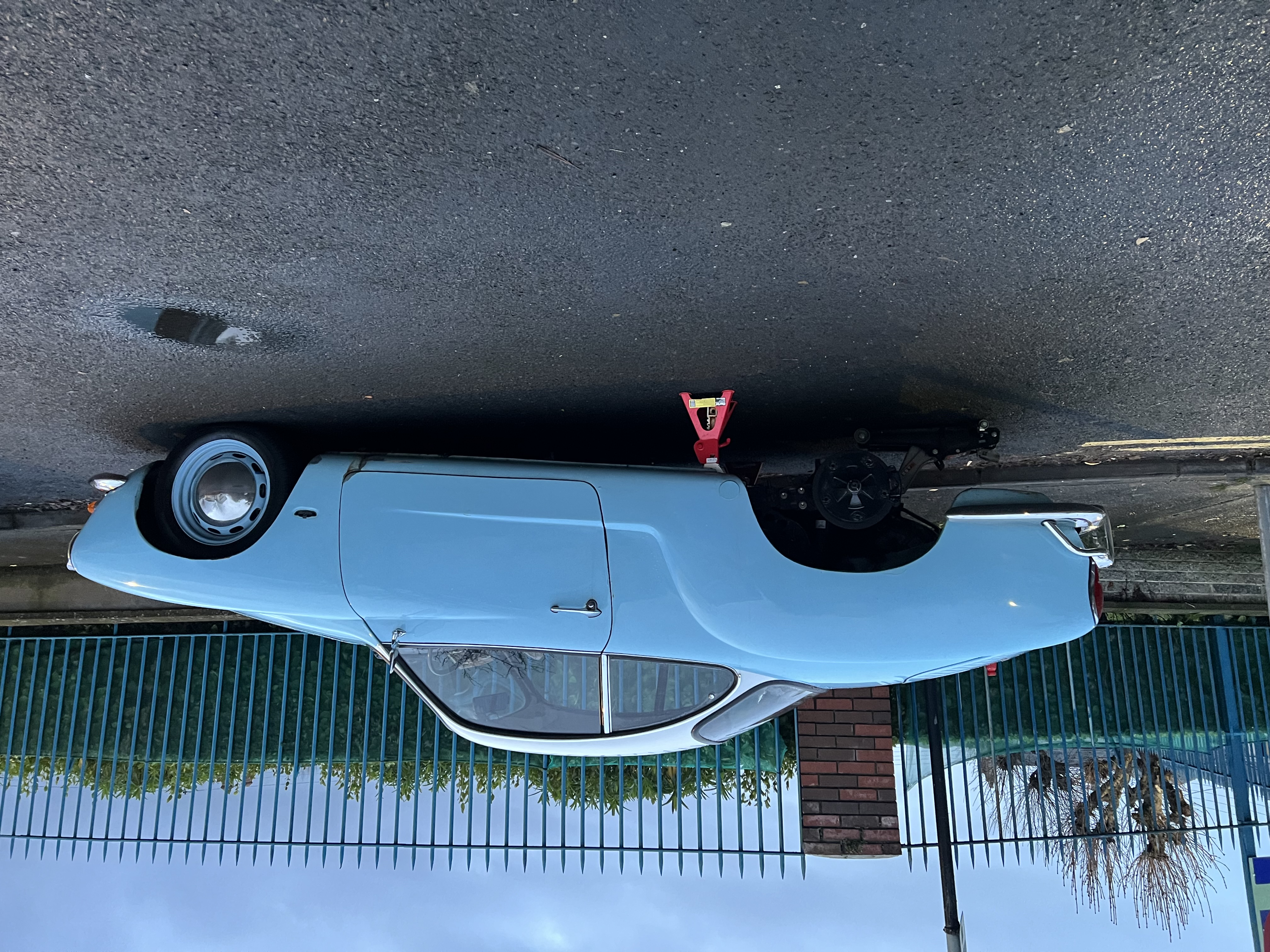

Well it spins faster in the air!
Used the handbrake to slow it down at the end.
Didn’t adjust regen.
Posts: 2962
please confirm which value is which so I am not left guessing.

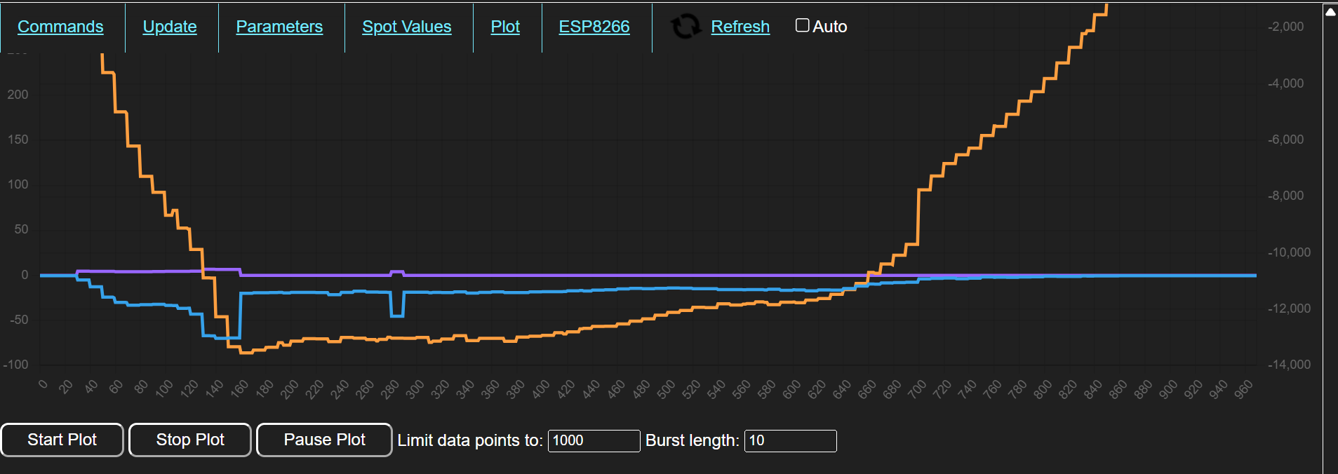

Sorry Tom I must of cut off the screen shot.
I selected L UDC, IDC & Potnom and R Speed
Ghia66
Posts: 170
Has thanked: 749 times
Been thanked: 65 times
Post by Ghia66 »
Ah, this is better!

In the interest of the Gen 3 Prius community would it be worthwhile to do the same test run in reverse? ( my reverse… Greg’s drive)
Ghia66
Posts: 170
Post by Ghia66 »
Red UCD
blue IDC
orange Speed
purple Potnom
Posts: 2962
Ghia66 wrote: Wed Jan 21, 2026 1:18 pm In the interest of the Gen 3 Prius community would it be worthwhile to do the same test run in reverse? ( my reverse… Greg’s drive)
Yes please.
Also wierdly here you get no regen. Also this could be related to "revRegen": 0

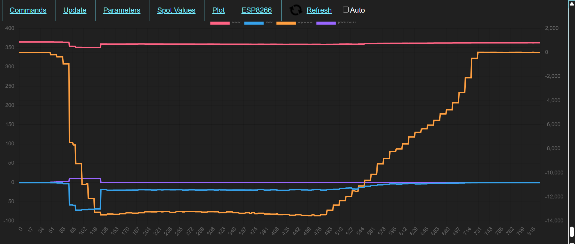

Ghia66
Posts: 170
Post by Ghia66 »
Thanks Tom, will give it a spin in reverse tomorrow.
What do you suggest to change re regen?
params (4) 2.json
(2.14 KiB) Downloaded 2 times
Posts: 2962
set it to -15 like the maxregen

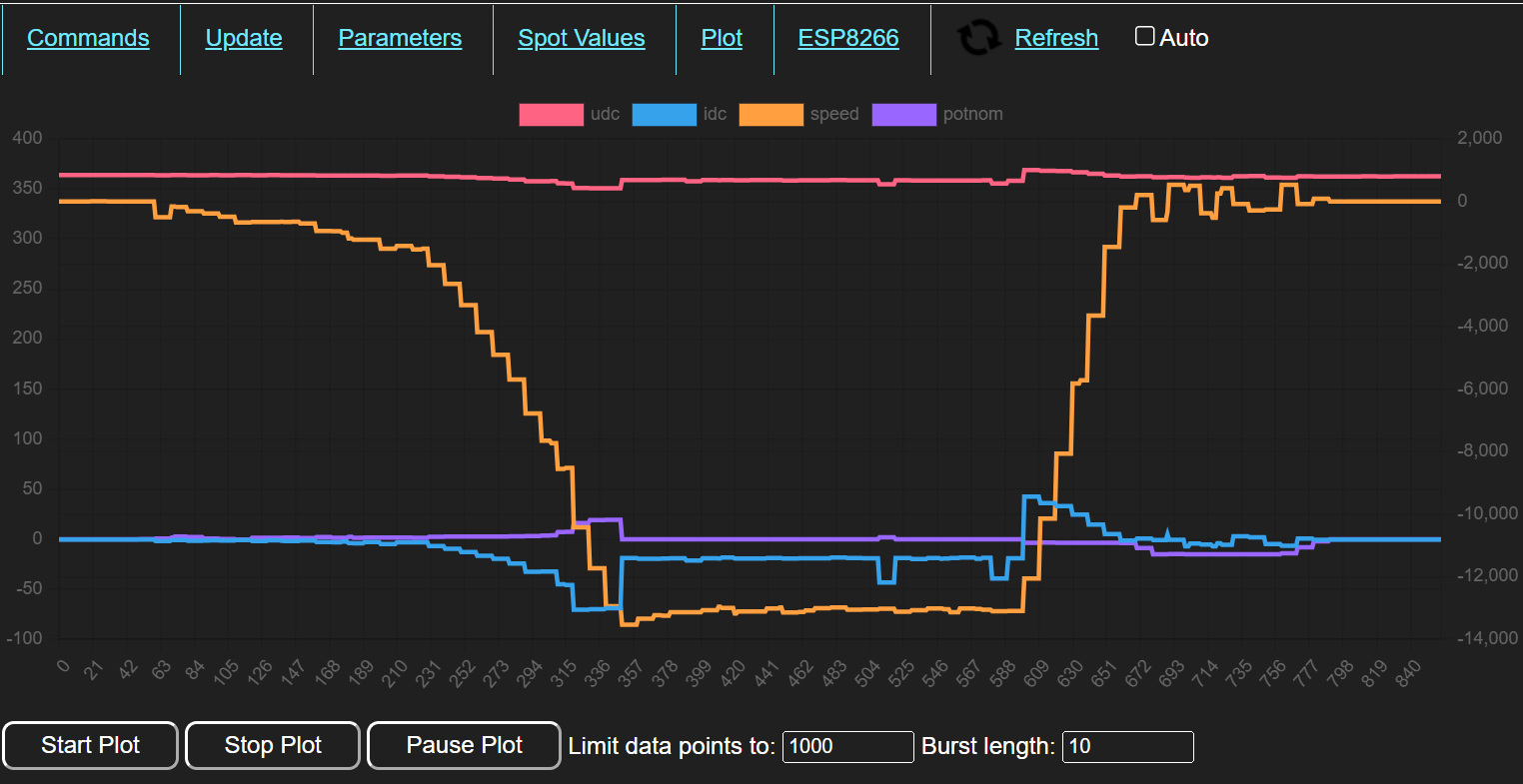

Ghia66
Posts: 170
Post by Ghia66 »
This is my reverse (Greg’s drive) air spin.
I then changed revregen from off! to on. Left regenmax at -15
The Prius Gen 3 sure likes to rev!
Regen worked well to slow the motor. 🙂

marcexec wrote: Sat Nov 22, 2025 3:14 pm Not suggesting to test it on the road, but could the "internal" limit only apply for reverse for some reason?
Probaly even too dangerous with wheels off the ground, though I probably hit 150+ with the motorbike wheel at Dublin Maker when some cheeky kid took it out of reverse :D
Wheels in the air…drive and reverse!

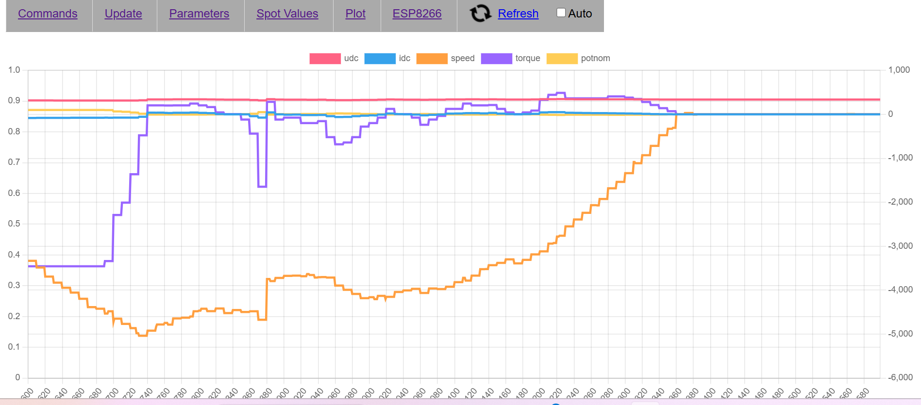

Posts: 2962
Okay so we can confirm your motor is running in reverse which is fine. Toyota do not limit in reverse it appears.
Both go close to 13K reported.
So there must be a current or power limit you are hitting a certain speed. Question is if its related to requested direction not too sure how to easily plot the driving in reverse and getting the 8K speed.
Id say when you get some time can you get another log and graph doing a run to "top speed" if its safely possible.
Left Potnom + IDC + UDC and right speed. Want to see if we derate potnom based on current limit for example, not sure if we rulled that out before.
