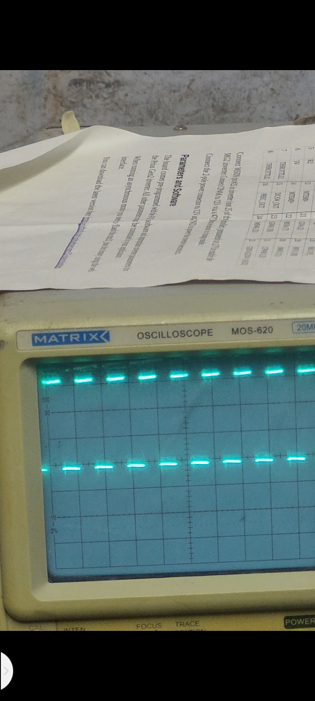

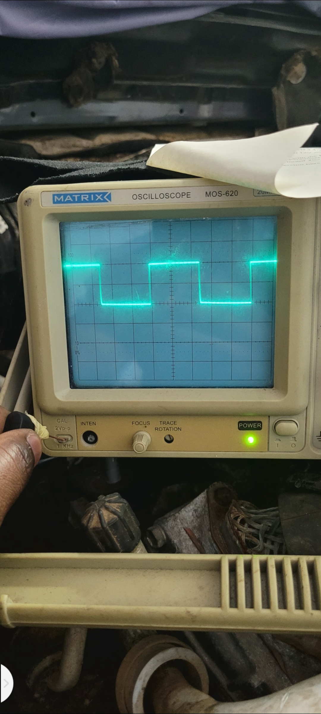

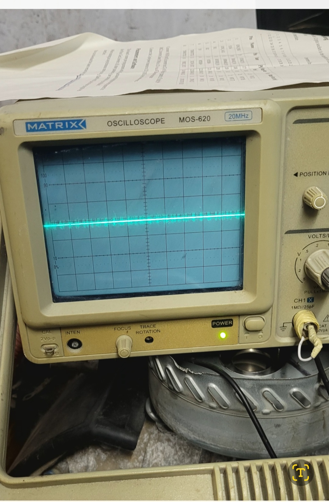

voti wrote: Sat Apr 05, 2025 11:56 am Then from there I logged in the web Interface, set ocurlim -1 ampnom 1 fslipspnt 1 selected manual mode and hit start inverter in manual mode. Went to spot values, refreshed and confirmed manualmode.
Then I first used my multimeter to test for voltage on the ic6 chip. First I tested pin 8 GND and pin 9 VCC and I found 14.57v which my power supply is supplying (15v) the I tested pins 5,6,7 against pin 8GND, the pins 5,6,7 and thr ones on the left side of the ic6 which are input that Johu said I should test, right?.
With the scope I couldn't barely find any readings as I got 0.01v on all this three pins. When I tested using the scope the horizontal green bar on the scope barely moved and it just shifted I think by 0. Something on the horizontal axes I had it on. I hope you understand what I mean. But in shot in barely moved because when I tested pins 8 and pin 9 of ic6, the green horizontal bar shot way up, so high that it couldn't read on the screen, way above 100%.
I just confirmed the tests again. Had my dirmode on DefaultForward, set ocurlim -1 ampnom 1 fslipspnt 1 selected manual mode and confirmed manualRun in opmode. The results were the same as the ones quoted above. I used my multimeter to confirm input voltage to the ULN2003 which is through pins 8 and 9, and I got 14.45v. I went on to test pins 5,6,7 against pin 8 which is our ground and all three pins gave a reading of 0.01v.
When using the oscilloscope to confirm this, I placed my positive probe to pin 9 which is + input. the green line on the scope shoot way above 100.
When placing the positive probe on pins 5,6,7 now the green line barely moved.

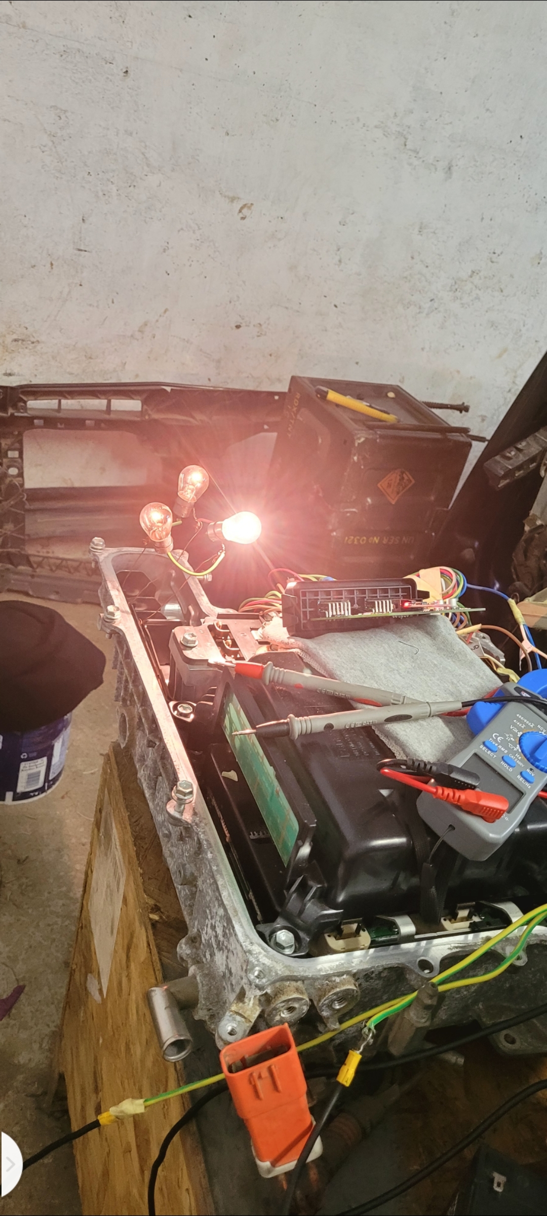

johu wrote: Tue May 06, 2025 3:05 pm Both forward and reverse are high. Why? Please make sure they are both low. Also "din_start" and "din_brake" are always high, shouldn't hurt for now but it is weird
Had to do a bit more research in order to understand what I had to do for this work. I disconnected both pin 11 and 12 which were connected to my power supply "15v" input in order to turn them low. Then I put in the settings on the web Interface and started inverter in manual mode.
First thing I noticed is the whine pitch sound made by the controller suddenly changed and this was a first, it had my eyebrows raised. I confirmed pins 5,6,7 on the ic6 chip and I found that for the first time I got readings and they were 1.6v on each pin. I connected my oscilloscope and confirmed that a square waveform was visible, a bit noisy yes but I saw the square pattern.
I attached three pictures below. First one was before I put in the settings second one for testing the oscilloscope if it works thus we see a perfect square wave then the last one at the bottom is the waveform I got from pins 5,6 and 7

WE HAVE FLASHING LIGHTS PEOPLE 😃😃😃😃😃😃😃😃😃😃😃😃😃😃😃😃😃😃😃😃😃😃😃😃😃😃😃😃.
I'm super excited to witness this. I couldn't have done it without all of your guys here. Thank you so much🫡.
Thank you for your consistent patience with me. When I started this project I didn't know anything about what I was doing, but you were patient with me. I still have a lot to learn from you guys so please don't give up on me.
Like MattsAwesomeStuff said before, I'm not out of the woods yet. I still need to learn more about the functions of all the other parameters and how to get them working for me. I've never done this in my life, and I've never been to any electronics class. Your assistance will be greatly appreciated 🫡

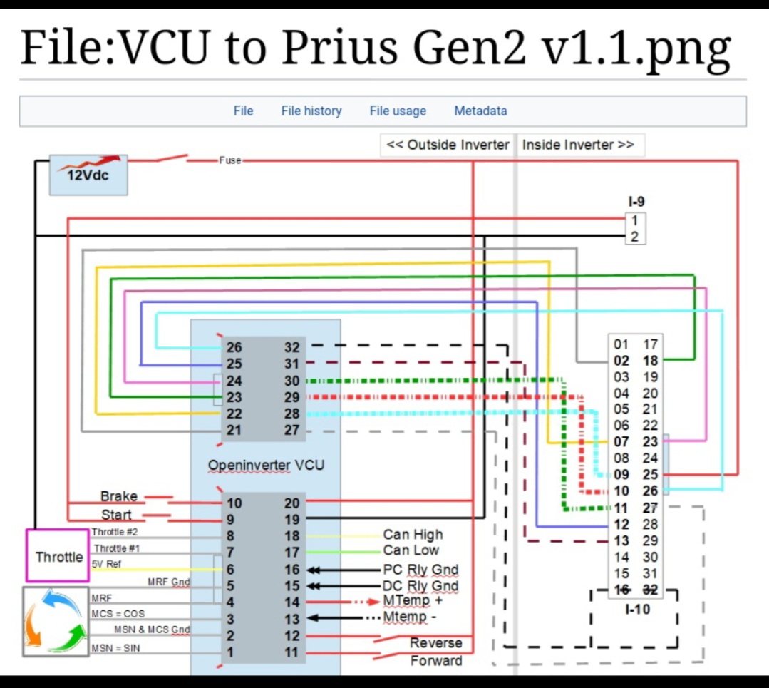

Did I understand you provided 12v to Pins 11 and 12?

RetroZero wrote: Mon May 19, 2025 7:53 pm Did I understand you provided 12v to Pins 11 and 12?
Yes I did. I had connected this pins as per the connection diagram i found on the wiki, Please correct me if I had them wrong.
Check attached screenshot.

The pins 11 and 12 receive 12v via a switch to power each pin according to the direction selected. They are not connected directly to 12v. I will have to document this in the wiki.

RetroZero wrote: Tue May 20, 2025 11:03 amThe pins 11 and 12 receive 12v via a switch to power each pin according to the direction selected. They are not connected directly to 12v. I will have to document this in the wiki.
Aha.
So, had we alternatively continued with my clumsy "Take a photo of every wire you connect" poor-man's troubleshooting, I think we would've caught this eventually.
Going back several months, indeed the problem was "Instructions said to do something, you think you did it, but you actually did something different, and we don't know which thing it was until we look right at it."
Also, that diagram should have a SPDT switch for direction selector, not a pair of independent SPST switches. You never want to be in both forward and reverse at the same time, it's nonsensical.

What was the light bulb that is connected in series on your High Voltage circuit doing? Does it light up brightly?
