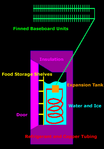

I was looking at ways to passively cool the batteries using a liquid.
Trichlorofluoromethane refrigerant R-11 has a boiling point at 23.8C. was thinking at a closed loop that goes outside the battery box that cools the vapor and transforms it back into a liquid that has a lower temperature.
here is an exaple of a fridge that uses Ammonia - boiling point -35.5C.
https://web.archive.org/web/20011104153 ... IceBox.htm
https://www.engineeringtoolbox.com/boil ... d_155.html
Posted: Sun Dec 10, 2023 8:56 pm
by johu
Isn't vapor cold and liquid hot? So a classical heatpump. I think OEMs use it but usually have a heat exchanger to water to avoid high pressure lines throughout the car.

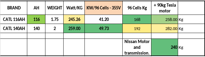

rstevens81 wrote: Thu Dec 07, 2023 4:46 pm did you win as its not viewable any more... do you have the bmw 330e over there as the 12kwhr batteries are relatively cheap (this side of the Atlantic) and its a good starter battery :)
I looked few times at the BMW batteries and they are too heavy. From my calculations they are 101W/kg. that is very low.
BMW batteries have 12kw at 261 lbs / 118.4kg
That compared with new CALB batteries that are 245W/Kg, that is 41kW for 96 batteries at 168Kg.
Screenshot from 2023-12-13 14-31-12.png (10.74 KiB) Viewed 291733 times
I decided that I just want to install the batteries in the front of the car. Because of that I cannot go with LiFePO4 and I need to go with NMC 3.7V cells. that will be 168Kg.

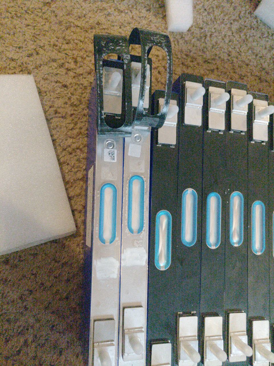

by Proton
back at it again.
I just got the new batteries. unfortunately I had to go with Lithium batteries because they are lighter and can do 3C discharge rate.
I also ordered from China some fiberglass separators between the batteries.
They wil be
mounted in the front. Engine + transmision was 240Kg and 41kw of batteries are 258Kg.
on top of that the exhaust pipe with cathalitic converter are about 25kg, and the Gas tank 16 Galons is about 50Kg.
overall the car will be lighther with this batterie. the other option was the 140Ah batteries but they were 192kG.
I asked them to weld the studs with the square base, so the busbars have more contact surface.

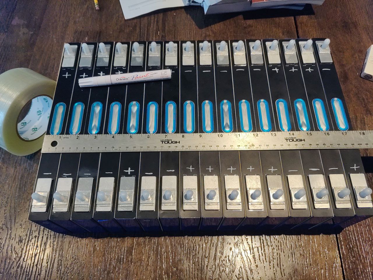

This is 6.8Kw, 16S pack. I will have 6 of these.

by Proton
This is 2 rows with 32 batteries each. I have to add another row on top to have 96 batteries.

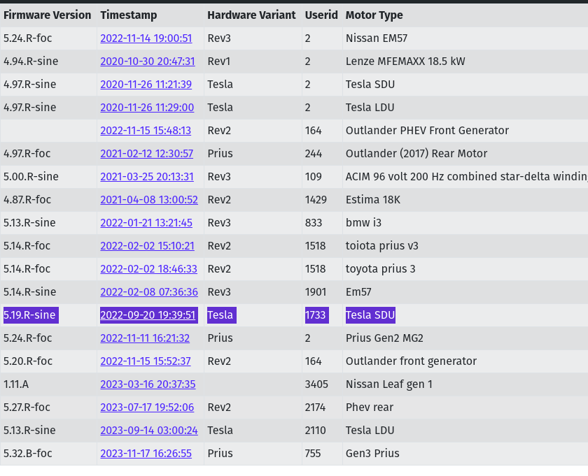

5.32.R gives the BrakeCheck status because cruisemode != Off so it wants to see the brake pedal once at startup. After that you will loose the web UI anyway as that is caused by the contacto surge
Posted: Wed Apr 17, 2024 2:05 pm
by Proton
After work I will load 5.27R since that was the software that worked before, and I do not have a wire from brakes connected to the board. and load the default parameters for 2.19R. Those are the last default parameters published.
I will also use clean power and disconnect the car from the 12v battery, so only the Tesla board is connected.
the power supply will show me how much power is used by the board.
https://openinverter.org/parameters/view.html?id=27
