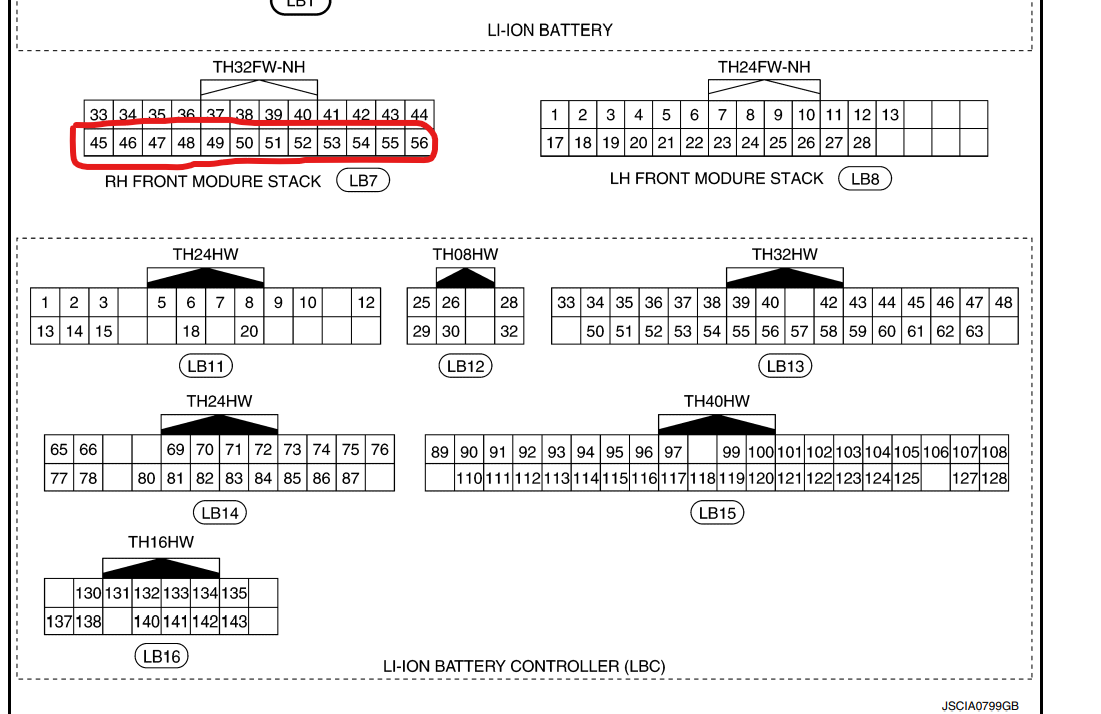

Been a while but got back to the Leaf BMS. During the last few months, I had to replace a few modules and in the process, managed to get a 'grey' LBC into the deal, Perfect! I just had to rewire the grey plug back to its original format and away we go.
Triple checked everything and plugged it in. Tiny pop... argh!!
I traced the tracks back to Cell 75/76, which was one of the ones I replaced. All the existing cells I measured at ~3.983v and the new ones were ~3.964v. Would a difference of 30mV cause this diode and R560 to run into problems? R587 to the left does not look too good either. I have spares to replace the damaged components so, I'm ok about that but, would like to know your thoughts.

Posted: Tue Nov 02, 2021 11:35 pm
by Isaac96
A difference should not cause problems, as the BMS is built to measure and handle exactly that.
A nice little pop is usually a result of missing or reversed wiring. Double check?

Thanks Isaac. Good to know. I think it's a quadruple check :roll:

Just curiously was the bms powered at this point when you connected the cell taps? That damaged 30kwh had something similar but wiring was untouched. I assume previous owner connected cell taps while unit was powered.In my case I was the ic that fried.

paaa wrote: Wed Nov 03, 2021 10:45 pm Just curiously was the bms powered at this point when you connected the cell taps? That damaged 30kwh had something similar but wiring was untouched. I assume previous owner connected cell taps while unit was powered.In my case I was the ic that fried.
Nope. Unpowered at the time. I did find the issue however. I began to check the incremental voltage across each pin in the 40 and 16 way molex connectors and it became apparent, there were anomalies. About 70% of the way, values started jumping and once I had noted everything down and a little reverse engineering, I found stupidly I had wired the 2nd line on the LB7 in reverse. All now de-pinned and re arranged in the correct order. Now hopefully, the smoke will stay in the components. I feel like a moron now as I was convinced I checked this a number of times... Can never check enough times I guess.
