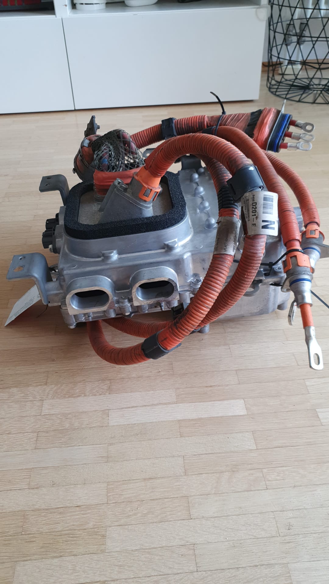

Re: Mitsubishi Outlander rear axle
Unfortunately I'm not near the inverter by myself, so i thought some here will know:
What is supposed to be on these holes?
Thanks, Philip
Thanks, Philip
- rstevens81
- Posts: 386
- Location: Bristol, UK
- Has thanked: 29 times
- Been thanked: 114 times
I think it's the charger&dcdc
Or it least it looks like the dcdc/charger would fit based on the charger I have
- aot93
- Posts: 213
- Location: UK, West Sussex
- Has thanked: 8 times
- Been thanked: 49 times
Yes 1 is for charger / dc-dc.
I can't remember what the other is for on Outlander, I use it for my heater.
- Posts: 2962
- Has thanked: 328 times
- Been thanked: 847 times
The other is for the heater.
The 40 amp fuse is heater I believe.

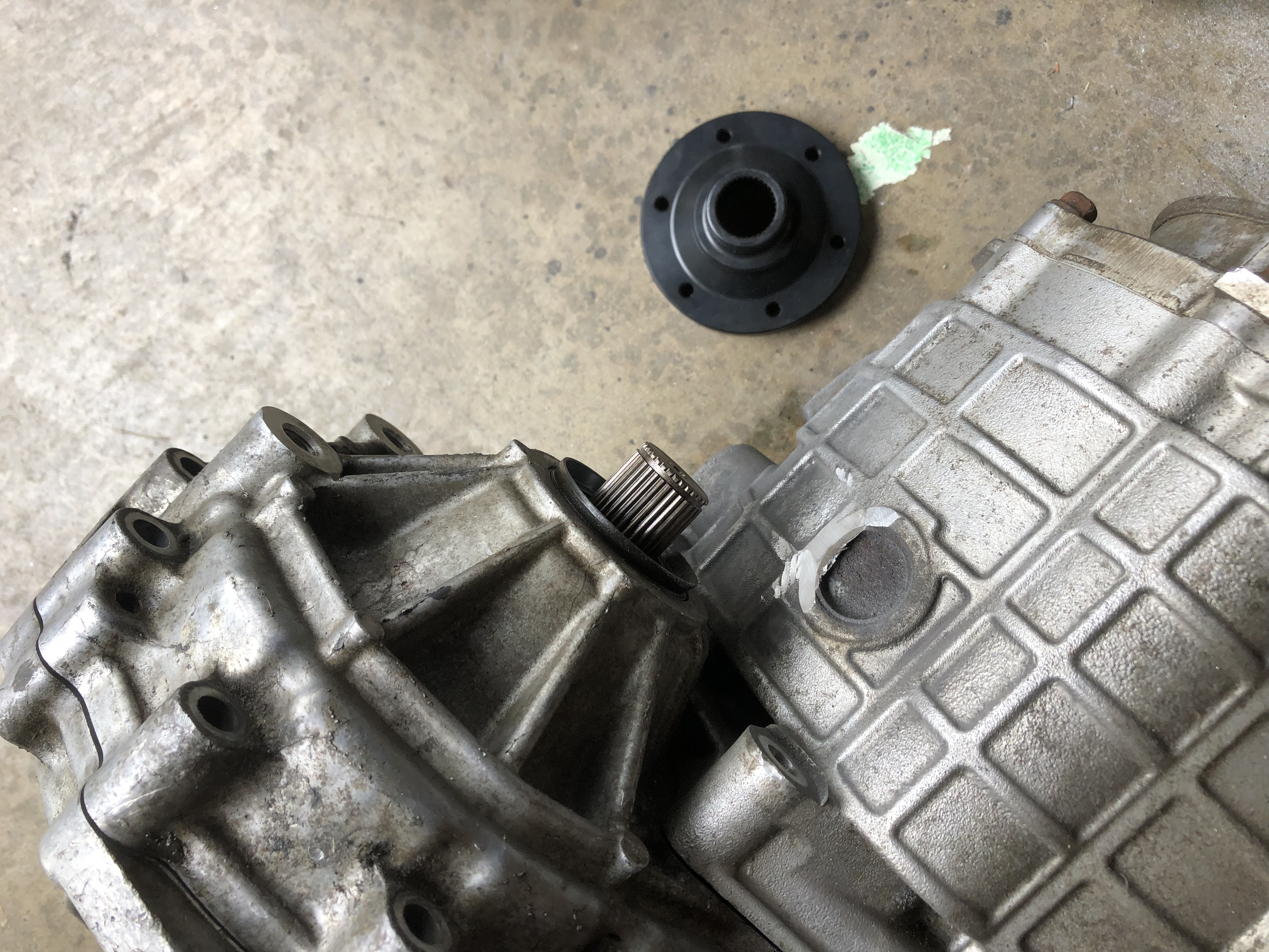

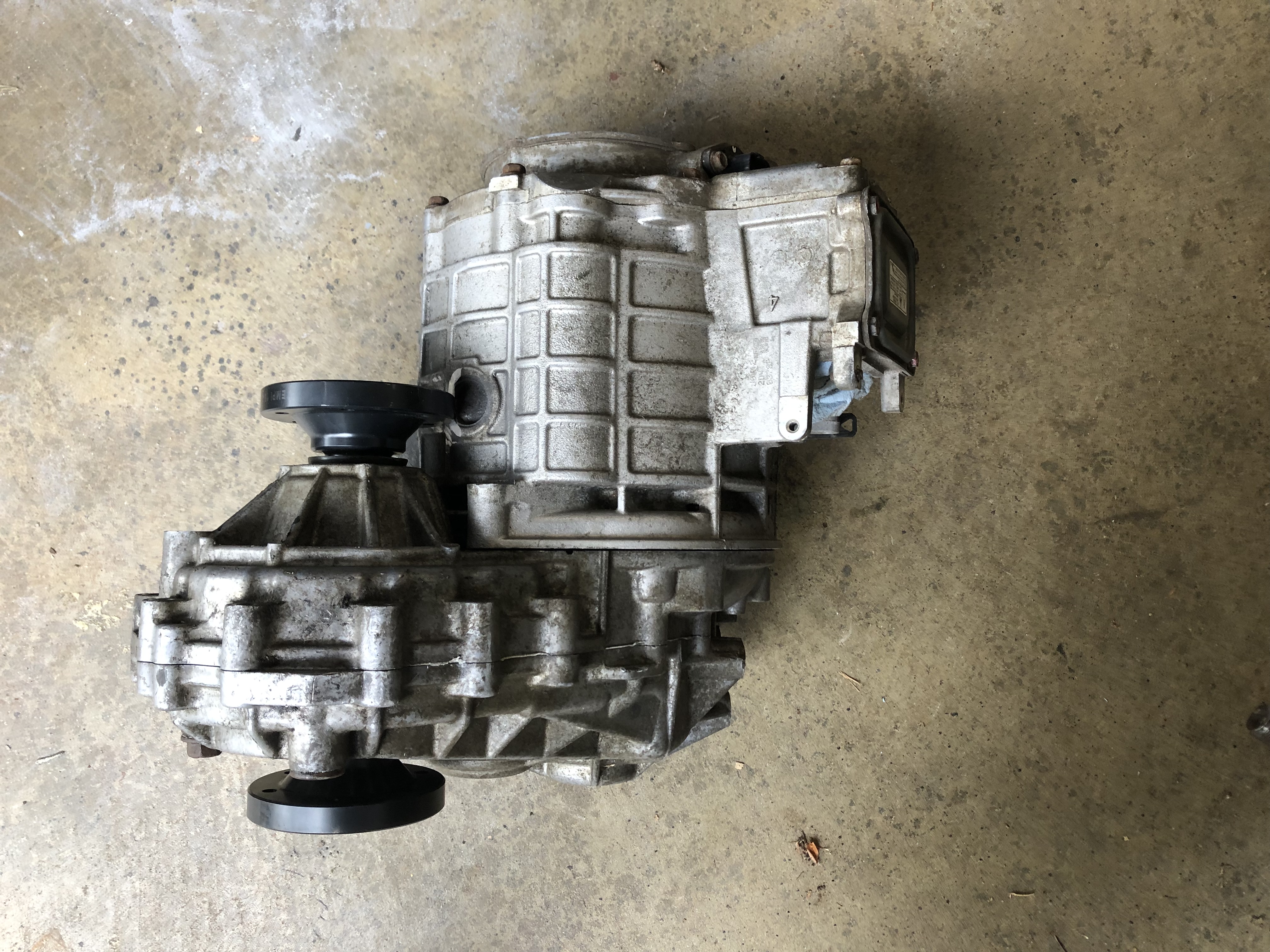

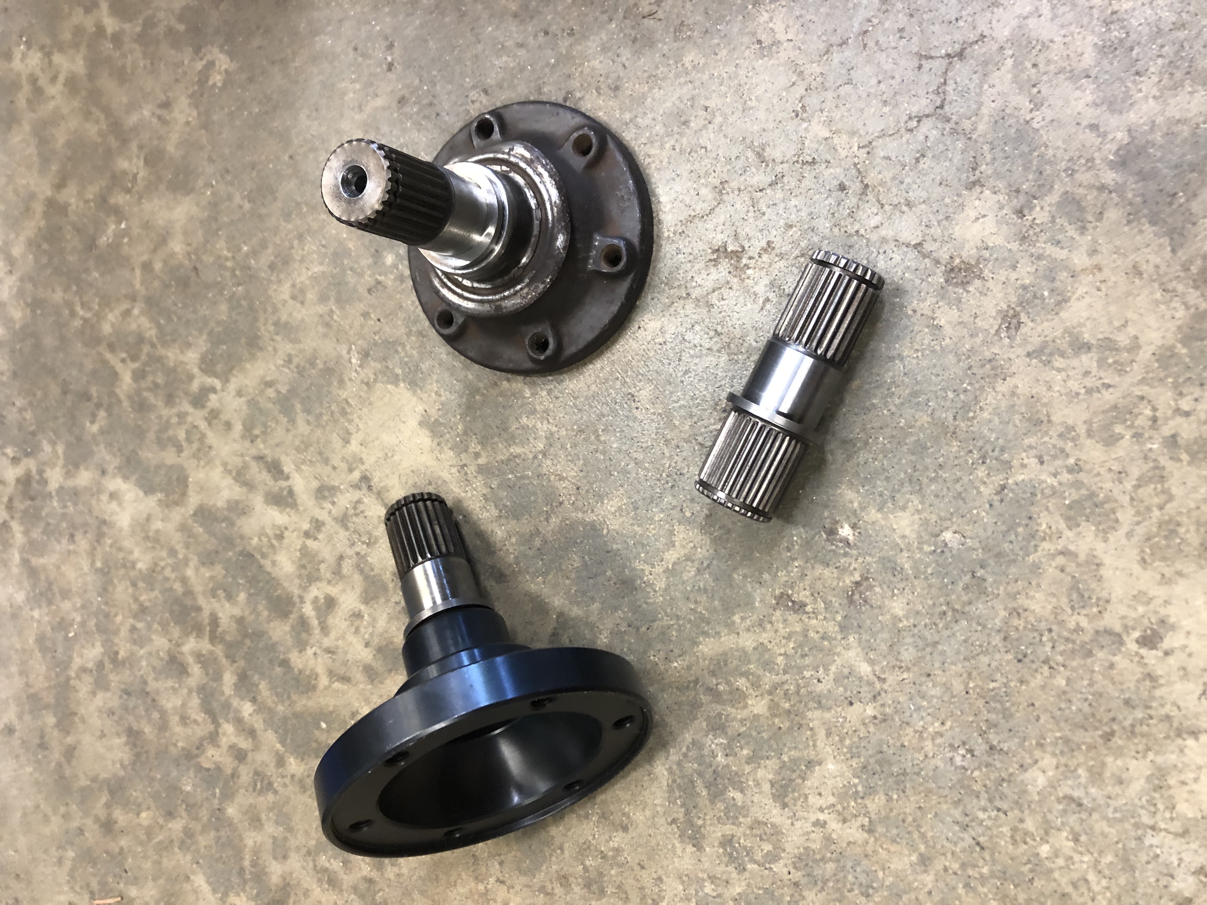

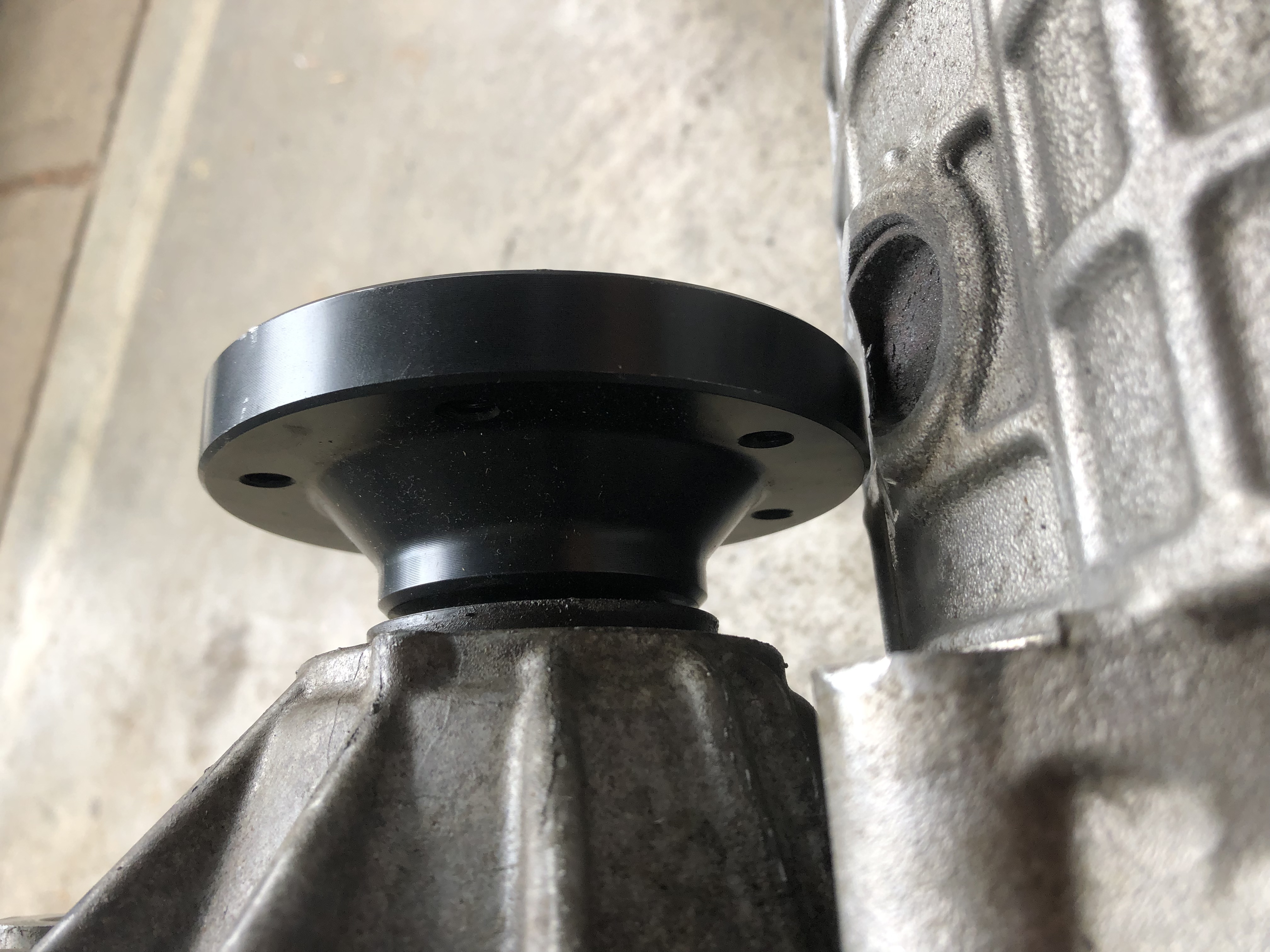

Stub shafts are done.
with some minor shaving of the plugged coolant port on the motor, type 2 (100mm) cv flanges fit nicely
Type 1 (90mm) (vw beetle) fit great as-is.
108mm or 930 flanges should fit, but with a lot more shaving of the motor case.
Looks great, wish they had been available last year before I took the diff/reduction box off mine and built an adaptor to connect to the original gearbox. I now have a spare outlander rear motor ready for my next project so I may still be in the market for a pair down the track.
Just wondering is there some standard for distance between flanges/stubs? If replacing VW transmission model XYZ with mitsubishi rear diff with these stubs, will original drive shafts fit lengthwise?
