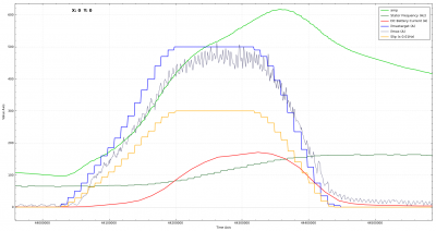

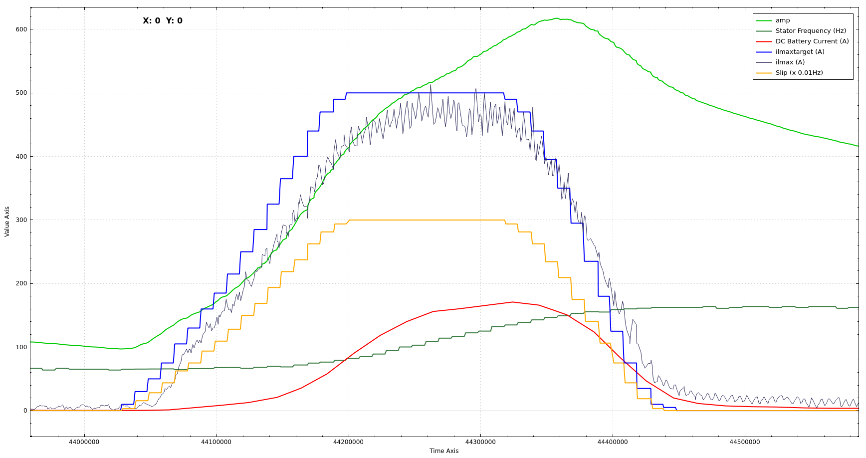

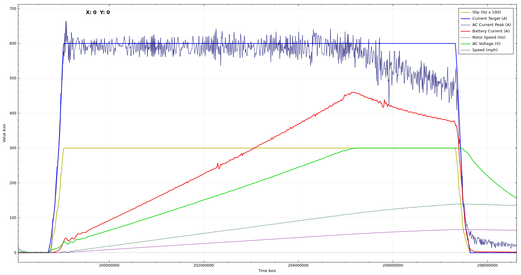

Here's a chart from a real test drive I did today. The current looks a bit noisy, this isn't something you can feel at all while driving, and this may simply be normal noise from the sensors, but I think a slightly lower value of curkp (perhaps 1.0 rather than 2.0) might be needed to prevent this being amplified.
Yellow line is slip, but also directly equals throttle input (0-300).

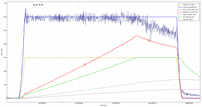

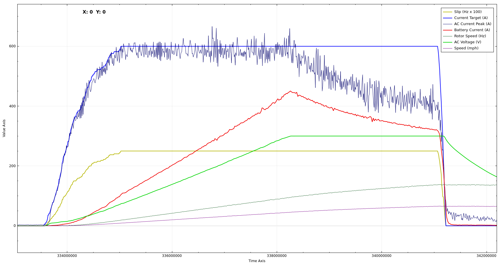

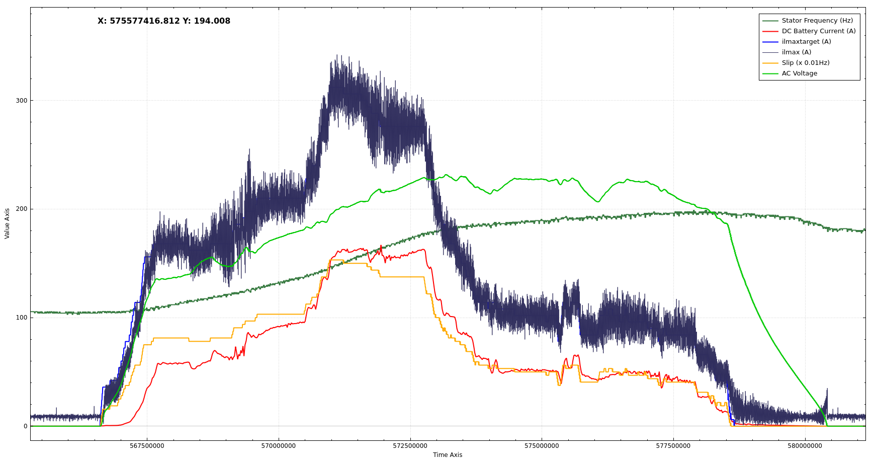

The car runs very well now, but there are a couple of things still to address:
I've just pushed up idcmax to 950 which will actually limit at around 570A. I'm not really clear what's wrong here, but I wonder if the power factor on these motors is indeed just very low. Not something to worry about right now, except to note that the value needs to be increased above the actual current limit (in my case by a factor of about +66%).
Lowering fslipmax from 3.0 to 2.5 provides a decent amount of extra torque, at the expense of top speed (torque falls off much sooner). Really I need to look at field weakening soon to get the best of both. This is really just a simple matter of increasing slip dynamically when voltage runs out. For now, it's easy to try both and see which you like.
Attached is a SavvyCAN JSON log and graph definition in case anyone is interested in looking at the results from a real drive. This shows short drives including 0-60 acceleration with slip values of 2.5 and 3.0 (charts attached).
I think the thing I'm happiest about here is the throttle response. There is absolutely zero lag between input and response.

Re: Current control of induction motors

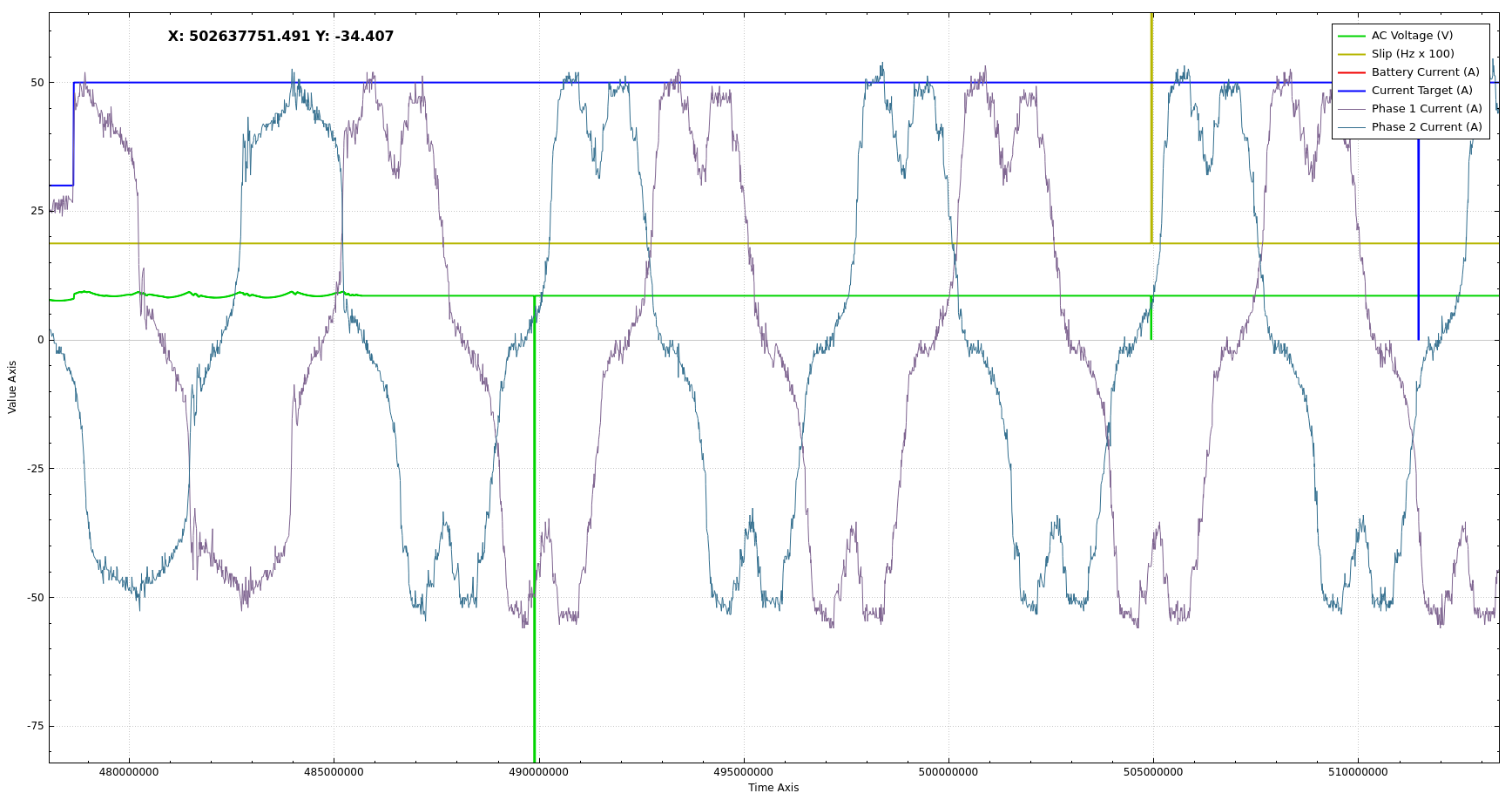

I drove about 25 miles on the new firmware today. All seems good apart from one thing, oscillating at (very) low speed. Initially I'd blamed this on the encoder input, and I think that might still be a factor, but there seems to be a much more serious problem - the weird shaped AC waveforms. I dug deeper into this and have now confirmed that this is *not* a result of my algorithm compensating for errors in the current measurement as I had previously concluded. Here is a chart of current (at about 0.1875Hz frequency), with the amplitude locked and a peak current of 50A. The graph looks almost correct at the start, but that is because the PID is trying to correct it. As soon as I lock the output amplitude, we can see the error clearly.
There are two things wrong here. Firstly, and this doesn't really matter, the commanded slip of 0.1875Hz should result in a wave period of 5.33s. In fact the period is 7.5 seconds. Similarly, a commanded slip of 1Hz gives an output period of 1.06 seconds. This is probably not a problem, but worthy of note.
However, more importantly, the incorrect shape is still present. This causes a substantial oscillation in my total current calculation.
- Been thanked: 1914 times
It looks like the double-humped output voltage of svpwm. Weird. Can you disable svpwm just for checking?
- catphish
- Posts: 966
- Location: Dorset, UK
- Has thanked: 99 times
- Been thanked: 197 times
Working theory: because the voltage is so low (1100 of 37813) the SVM shift might be interacting poorly with the hardware PWM resolution.
I will add an option to disable it and see it it resolves the problem. Since it serves no purpose at low ampitude, perhaps I can just have it dynamically enable when required.
