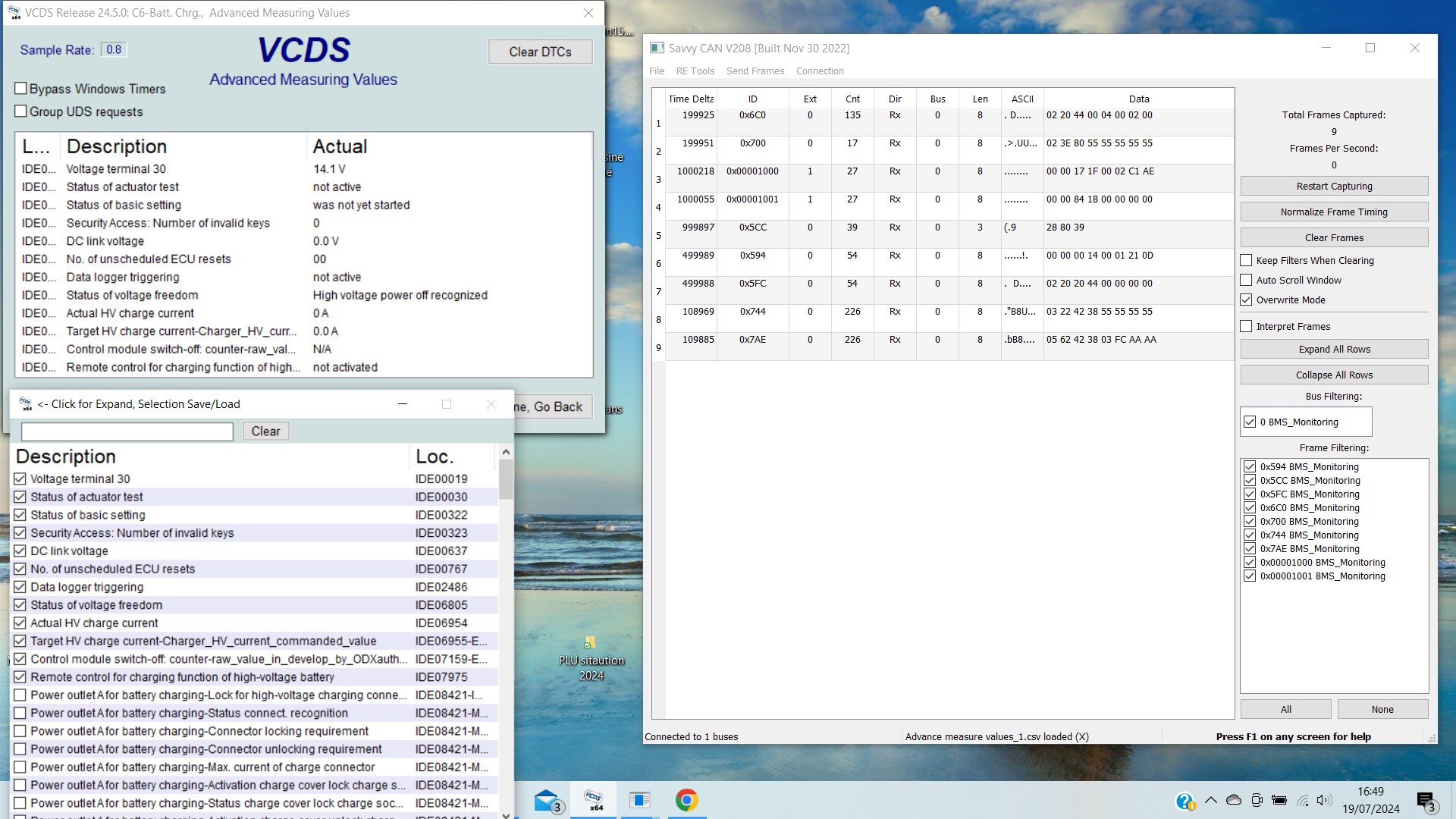

Re: MEB Chargers
Since the only thing I am capable of at the moment is data capturing, is this sort of capture any good for advancing reverse engineering?
Basically I cleared all CAN frames and then started selecting values in VCDS. There was traffic in SavvyCan, so I imagine there is CAN data related to each value individually as well. If this helps, I could start again and log each value individually. Would these types of logs help us (you boffins) to link a CAN message to an actual value?

Re: MEB Chargers
@uhi22, is it possible to point me in the right direction?. I understood that sending 2F 0A 1B 00 on adress 0x744 'should' get the Green LED to be requested to light up. What am I missing? Do I need to simulate a request as if its from a tester?

Re: MEB Chargers
There are two totally different kind of possible communications with the control unit:
1. The "normal", "cyclic" application CAN messages. They have usually CAN IDs below 0x700, and are sent by various control units during the normal car operation.
2. The diagnostic messages, UDS over ISO-TP. This happens only if a diagnostic tester is connected to the car, and the content depends on what the user is doing with the tester. It is intended to support the repair shop, so that they are able to control every light, actuator, whatever, and to read measurements (e.g. voltages or currents), and to read and clear the error memory. The CAN ID 0x700 is the "broadcast" messages, which the tester sends and all connected control units receive it. It is used for the "Tester present" UDS message, which says to the control units "The tester is still connected", and this leads in the control units to keep the current diagnostic session. Each control unit has a certain pair of CAN IDs to talk with the tester. The tester sends a request to the control unit on one CAN ID, and the control unit sends back the diagnostic response on the other CAN ID. The control of a certain light using diagnostic commands usually needs more that just sending one message. A typical example of such an UDS InputOutputControl could need:
- The tester sends a request to enter a specific diagnostic session (e.g. extended session), and the ECU gives a positive response. (not seen in the trace above).
- The tester sends a kind of "authentication" or "Security Access" (not seen in the above traces). This may (shall) prevent replay attacks.
- The tester writes certain identification data (2E F199 and 2E F198 in the discussed trace)
- The tester sends a IOControl with a certain DID, with the command "ShortTermAdjustment" and certain data. This disconnects the light from the application logic, and controls it directly from the diagnostics command.
- The tester sends "tester present" each two seconds, if no other diagnostic commands are ongoing. If no tester communication is ongoing at all, the ECU falls back to "normal mode" after a timeout of some seconds.
- The tester may read some data during the test, e.g. to query the status or measure voltages or currents. E.g. using the service 22 (ReadDataByIdentifier).
- If the tester wants to actively switch the ECU to normal mode, it sends the IOControl with "ReturnControlToEcu" (Example 2F 0A 1B 00). This terminates the control of the light by the tester, and the normal application logic is responsible for the light control.
The sniffing and analysis of the UDS commands is good to get an overview what is possible to control with a diagnostic tester. It helps to check the wiring of the lamps and motors.
On the other hand, the understanding of the UDS commands does not help regarding to the cyclic messages which are needed for communication with other control units. The other control units do not use UDS to control the charger. Only the diagnostic tester uses UDS.
If you plan to do more analysis of the UDS communication, it would be helpful to record a complete session, means to start the recording in SavvyCAN before starting the diagnostic tester.
If you plan to find out the CAN communication which is needed during normal car operation, the analysis of the UDS communication is not of much help.

Thanks for the informative response. I thought it was something like you explained
. So for finding out ID's of different data, having a VCDS hooked up showing actual values, will not help whilst using savvycan in 'fuzzing mode ', because it's 2 different 'languages' being used?
To move forward, CAN logs from a working vehicle are needed then, because the communications used by VCDS are not that of a working vehicle, which is what we're trying to simulate.
I was trying to use the VCDS as a 'working vehicle ' and playing back ID's to see which values changed.

Re: MEB Chargers
Yes, two different "languages". The VCDS talks UDS, the real car environment talks plain CAN.

I'll have a go at playing it back through savvycan and see what I might find to be similar in the MQB DBC file @mitchy linked earlier.
Just a thought, if we were able to duplicate CAN identicle messages that the charger resuires, wouldn't the VCDS 'translate' this into UDS and I would see them changing via actual values?
When I check engine temp or rpm on my Golf 6, this is what happens no?

The VCDS does not translate the raw CAN messages. The process is like this:
- For example, SavvyCAN (or the real car) sends a CAN message with the intended charge current. The sender would be the BMS in this case. Let's say this is byte 1 of the CAN message with ID 345 (just as an example).
- The charger receives the CAN message 345, takes the byte 1 and now knows: The BMS wants e.g. 9 amperes.
- The charger *may* have the possibilty to read the intended charge current via an UDS service. Let's say there is a diagnostic ID 0x5678 for this purpose.
- The user of the VCDS selects to read some data.
- The VCDS sends an UDS request to the charger, ReadDataByIdentifier for DID 0x5678. Technically, this is CAN ID 0x744 with the data 03 22 56 78.
- The charger knows this service, and that's why it sends a positive response with the data. Technically, this is CAN ID 0x7AE with data 04 62 56 78 09.
- The VCDS receives this, and interprets the 09 as "9 amperes". (This scaling could be different, is just an example.)
But, this is just a dream. It is not clear, which measurement values does the charger provide via ReadDataByIdentifier. Ideally, the VCDS would offer a pick list or menu or something like this, where you can select what you want to read. This list of those measurement values could be helpful for analysis.

The VCDS does have a list. There's about 30 or more values to choose from. There's a screen print out in a previous post of mine of some of them.
@Bigpie, I'll see what I come up with in terms of error codes and how to adress them.. I'll play back different logs and see if anything comes up on the VCDS whilst selecting different values.

Re: MEB Chargers
Attempt to find Unlock button on charger flap ID
First checked Actual Value in VCDS and confirmed value changes according to button pressed or not.
No VCDS connected (after I confirmed that the correct message was being received by the charger)
Cleared all Frames in SavvyCan and pressed the button 5 times at 1 second interval.
Then using Sniffing, I replayed the saved data, and I tried to isolate the changing bits. There are 4 ID's that are active, but non that seem to relate to me pressing the Unlock Button 5 times.
I'm looking for "what I am not doing correctly" and not a spooon fed solution. Thanks in advance
For info, I did the same with a type 2 charger plug, but there are even more messages, as the actuator lock, the Control Pilot and Proximity Pilot are also activated, so thought to start with single command. Having said that, when pressing the unlock button, a command is sent to unlock the actuator.
Edit - Charger Type 2 plugged in halfway for Proximity Pilot signal attached as well.
