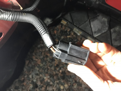

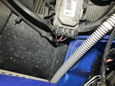

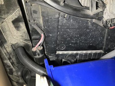

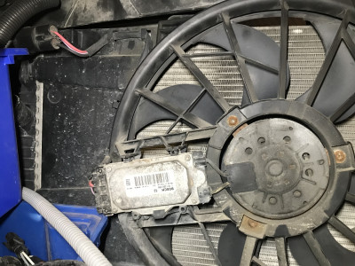

Had another look at the connector and I think it is OK to reuse. Also decided to leave all the connectors off during the initial build as they are difficult to remove without damage, difficult to replace and I don't know if the board actually works yet! Once the board is tested Ill hand solder them on. The soldering wont be quite as neat as reflowing them with the rest of the board but it seems a safer approach.
The PWM frequency on the F4 looks like it will be either 5.1kHz or 10.2kHz due to the increased core clock frequency. I would like to run it at 10.2kHz but not sure the Prius inverter will cope, any thoughts on this?
Also planning to change the way desat detection works. Given the Prius inverter seems so good at protecting itself I'm inclined not to immediately disable PWM (not a great idea if above base frequency) if the MG fault line goes inactive. Instead I'll limit the torque request and light the ECU error light. Again, any thoughts?

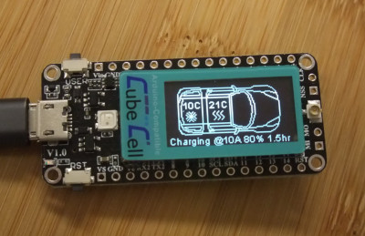

A little more progress on mine. All the bits are sorted out ready to hopefully assemble the board tomorrow. Have revised the terminal class in the firmware so that it will cope with the unidirectional RS485 comms (removed echo characters and added transceiver receive/transmit switching). Also ordered a USB/TTL to RS485 module so that I can talk to it from either the PC or ESP32.
Also the Heltec board that I'm hoping to make a keyfob remote out of turned up today. Only had a quick play with it but fairly impressed so far (not used the RF side just messing about with the display); the Arduino support and examples seem to be really good. This is where I'm up to with it (ignore the heat/cool icons and temperatures - I know they don't make sense!): Can't decide whether to keep the Roadster graphic or just use it as a text display. The graphic is nice to have but it does take up a lot of display real estate making the text a bit on the small side.
I also have the LoRa transceiver for the car end and a spare Nucleo-64 (STM32F103) to hook it up to for testing so hopefully have the RF side working soon too.

Quick progress update - not got the logic board board built, coordination is a bit shot at the moment so will have to wait a few more days.
I have got the LoRa board working. No pics though as it doesn't really look any different to the above but it is now correctly interrogating a remote 'car' node and then displaying car live data. A button press wakes it to request and display data, another short press updates the data and a long press triggers a preheat on the car and also updates the displayed data. Power consumption of the fob node is around 30mA when active and only 14uA when sleeping so even a 100mAh battery will give an 8month battery life and then it can be recharged by plugging into a USB port.
The 'car' node is currently based on a STM32F103 eval board and I've forked a driver repository for the LoRa transceiver and ported it over to the eval board (on my github if anyone is interested). This will eventually be developed into either a stand alone CAN bus node or be integrated into the VCU.
Still need to add security features to it (pre shared key to encode command data) but apart from that it's done.

Quite impressed by LoRa. Having looked at RF stuff in the past and found it hard work (code for packet detection, noise rejection, NRZ/manchester encoding, modulation schemes,etc), and disappointing performance when it does work, LoRa is a breath of fresh air! All the functionality embedded into the transceiver reduces code to basic setup and then just writing packets to the chip at one end and then reading them out the other. In terms of performance it is also better than I expected - set to around half max Tx power and without antennas at all it works fine on the bench, with an antenna on just one node (I only have 1 antenna at the moment!) it works up to 10-15m (including through block walls in the house) so it looks promising for decent range outdoors with proper antennas on both nodes.
For anyone interested below is a summary of my findings while researching the LoRa options:
- There are two versions of the modem chips, the SX126x and SX127x. The SX126x is newer, has 2dB more output power and uses around half the power. The SX127x has better Arduino library support. Both should have similar range/performance. I went with the SX126x due to the lower power and had to port a library over to the STM32 (see https://github.com/Pete9008/SX126x)
Edit - The two should be completely compatible with each other so can be mixed on a network. - For the key fob end there are options based on the ESP32 and on the ASR650x. I went with one from Heltec (CubeCell series) that uses the ASR650x which integrates the SX126x modem and a PSoC 4000 micro (ARM Vortex M0 based) due to the much lower power consumption in both active and standby modes. Libraries are available for this on both Arduino and PlatformIO which have a very good set of examples covering most uses cases.
- For the car end I struggled to find a transceiver module that uses the SX1262 (868MHz UK frequency version) and was easily available and ended up using the LR62E available from Digikey (https://www.digikey.co.uk/en/products/d ... E/13174291). The documentation isn't great and it needed a couple of library tweaks to get it to work (status message response and TXCO control) but seems to now work fine with the modified library.
- Planning on using this antenna on the fob (https://www.digikey.co.uk/en/products/d ... -T/8593246 as it is very compact, not sure how much it will impact on range compared to a proper antenna though (specs say it should compare fairly well but not convinced).
I like the idea but not sure it is worth it. A 300mAhr battery should fit in no problem which would give a battery life of almost 2years (assuming 10 operations per day) so the extra complexity doesn't seem justified. Thinking a little more though it would then have more power available and so could be used for keyless entry - just need to figure out how to bypass the Roadster immobiliser!

Re the BMS it will do - once I've designed it! The plan is to integrate everything I need for the car into a custom VCU. So far my thoughts on it are:
- Based on a STM32L496 processor (91uA/MHz when running, 2xCAN, 3xADC, 2xDAC, 6xUART, etc).
- CAN1 - To interface to Smart's existing bus (only active when ignition on).
- CAN2 - To interface to battery pack, inverter boost/DC:DC processor and charger interface (always active).
- RS485 - To interface to external ESP32 module for web interface and data logging.
- LIN bus 1 - 9600baud, I-Pace A/C expansion valve,
- LIN bus 2 - 9600baud, I-Pace A/C ball valve and I-Pace expansion valve,
- LIN bus 3 - 19200baud, VAG water heater, AC compressor and AC pressure sensor.
- LIN bus 4 - spare channel.
- 4 x PWM outputs - to suit Prius/Auris variable speed aux water pump speed control (inverter/motor loop, battery loop, cabin heat loop and spare).
- 4 x PWM inputs - to suit Prius/Auris variable speed aux water pump status output.
- 2 x 3-way water valve control outputs (interface TBD, battery loop mixing and spare).
- LoRa transceiver - for remote keyfob.
- Charger Pilot and Proximity connections interface.
- Interface for external HV DC voltage measurement circuit (MAX22530 based)
- 8 x 10k NTC temperature sensor inputs (A/C compressor outlet temp, expansion valve outlet temp, cabin evaporator temp, battery water temp, external temp, cabin temp + spare)
- 1 x switch mode out to drive cabin heater fan motor
- 2 x PWM out to drive cabin heater blower control module and radiator fan control module.
- ? x analogue inputs - +12V battery voltage, cabin temp setpoint, cabin fan speed setpoint +TBD
- ? x 3A? low side output drivers - TBD
- ? x 3A? high side output drivers - TBD
- ? x digital inputs - TBD
Again this is very much phase 2 and is highly unlikely to be in the initial car. I've started on the schematic but it is another trickle it along in the background project. The list above is just to try to get it clear in my mind and if I've missed anything hopefully someone will point it out

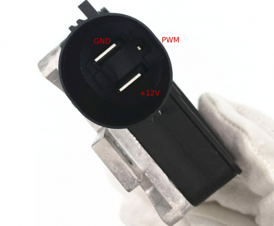

Just had a thought re the above, for cabin heater fan control I was planning to build a brushed DC motor controller into the VCU, the trouble it that means routing the high current fan wiring too the VCU and having the heat generating and potentially electrically noisy PWM stuff inside the enclosure and close to the LoRa module, neither of which are ideal.
It occurred to me that I could use a standard off the shelf radiator fan control module, something like this, https://www.ebay.co.uk/itm/255606958284. I think it just has a PWM control input that controls the fan speed and if so it would be ideal and a lot easier to do.
Has anyone used something like this and if so did it work and can you confirm how they are driven?
Now I know everyone is asking why bother with this at all? Well firstly I would like to eventually be able to preheat/cool the cabin which needs electronic rather than manually switched control. Secondly I'd like to convert to climate control rather than manual control an thirdly the Roadster has a notoriously bad heater fan control switch which has a habit of melting both itself and the attached wiring, and mine already has, so it needs replacing anyway!

Very interesting idea. In the C30 (my other project car) I think uses exactly the controller you linked to. (C30, S40, V50 and C70 uses the same platform, Volvo P1).
In the wiring diagram for my car it looks like this: And then reading the pinout explanation for the 2.0D ECM pin A:B2: It shure looks like the ECM is just sending a 12V PWM signal to the fan controller. The fan controller is mounted very close to the fan motor in the car.
I do not have the C30 in the garage at the moment but I still have all parts needed to hook it up and maybe possible to measure the PWM frequency even if I don't have the IC motor and all the other signals to the ECM. Let me know if I should look into this when the car is back in the garage?
Pete9008
- Posts: 1801
- Has thanked: 102 times
- Been thanked: 351 times
Re: Smart Roadster (with Prius Gen3 Inverter and Outlander Rear Motor)
Thank you, exactly what I was hoping to hear.
Don't worry about trying to measure it, without everything connected up, and possibly the engine running, I doubt it will do anything but thanks for the offer.
What would be very useful is which wire colours go to which connector pins?
I'll get a used one on order and give it a try.

I was thinking that the ECM might send out an PWM signal even if not commanding any fan, but I guess you are right that it will not if the engine is not running.
My module looks very different but the connector looks like it might fit the module you linked to from ebay. So my best guess is
