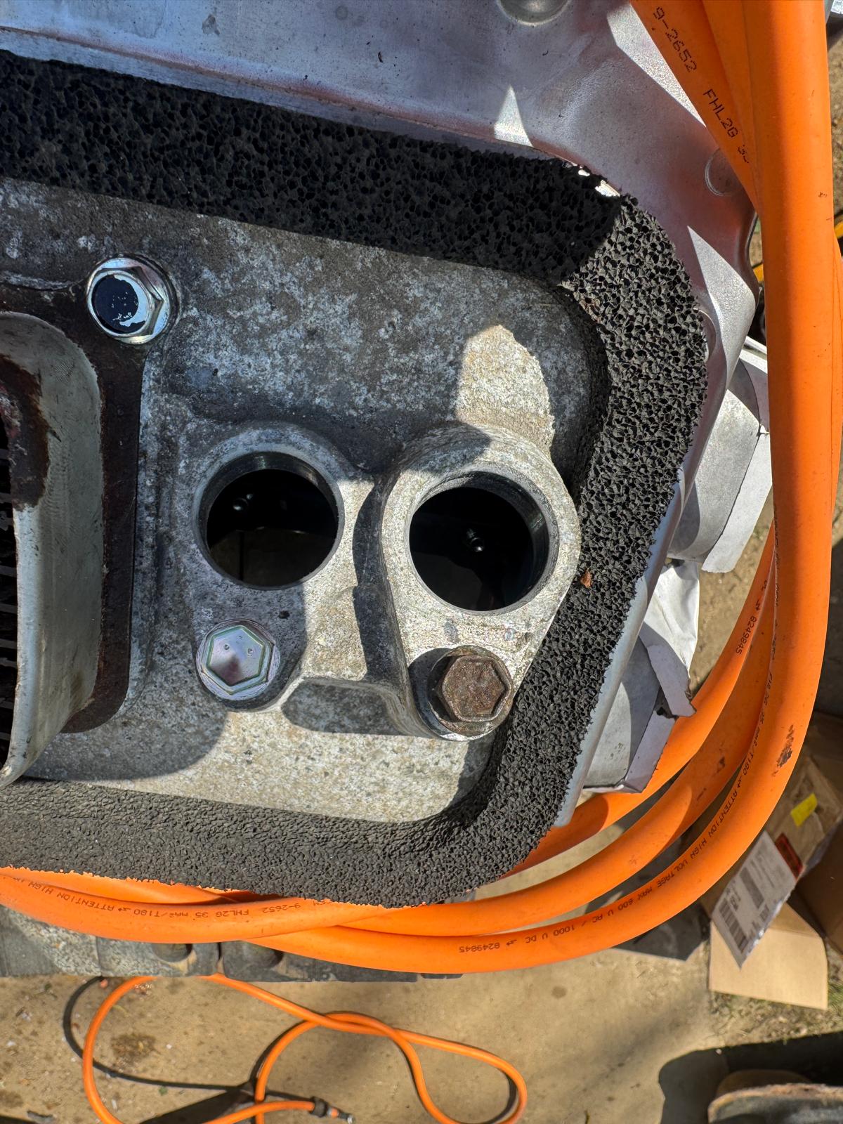

I should know the answer to this as i've been here before but my notes don't record this...
Which of the DC in connections on the Outlander rear inverter is the positive ? I think its the left hand one (i.e. next to the motor wires) in this picture as this has the 30a and 40a fuses on the two small outputs but naturally it would be good to have this confirmed.

FFMan wrote: Thu Apr 23, 2026 4:36 am I should know the answer to this as i've been here before but my notes don't record this...
POSITIVE is the rail where fuses come out of. NEGATIVE side is not fused.
