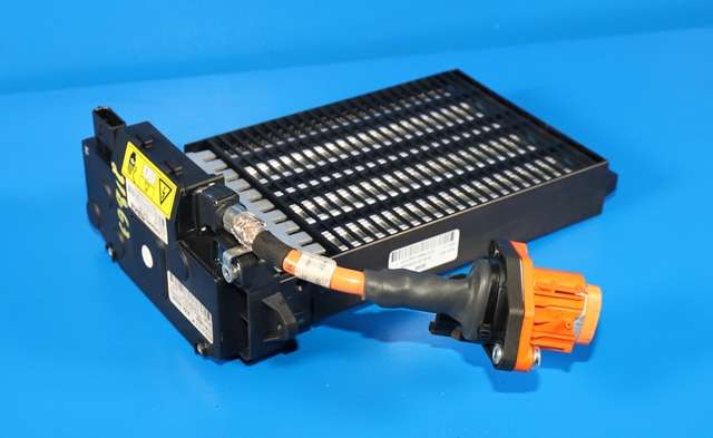

So for my e46 build my plan was to use a gasoline Webasto heater. However I managed to squeeze in allot bigger battery than what was first planned which meant that the reduced range by electric heating would have a smaller impact on usability.
Purchased a PTC heater from a 2015 renault zoe which is almost identical to the leaf/E-NV200 one.
Haven't measured the resistance yet but I'm seeing numbers like 1.8kw on the web. Looks like it operates together with a heat pump and only turns on when temperature gets below -5 and the pump doesn't produce heat . Also for defrosting.
Hardware: HV connector, APEX HV280.
LV pinout: nc-nc-LIN-(neg)-nc-(+12v)
Im trying to control it via LIN and thanks to the link and code below been able to communicate.
https://ev-olution.yolasite.com/nissan- ... roller.php So on ID 0x24 I get a response just as ev-olution. Without HV I got 0xCA, 0x00, 0xFE, 0xEE
With HV(280v) and trying to turn it on by sending byte[2] = 10 on ID 0x3B the response on ID 0x24 is 0xCA, 0x80, 0xFE, 0xEE. After that byte[1] on 0x24 seems to be stuck on 0x80.
No response on voltage or temperature change.
I have shorted the HVIL for testing. Could it require a certain resistance instead of a short? Anyone that has done LIN sniffing on their ZOE?

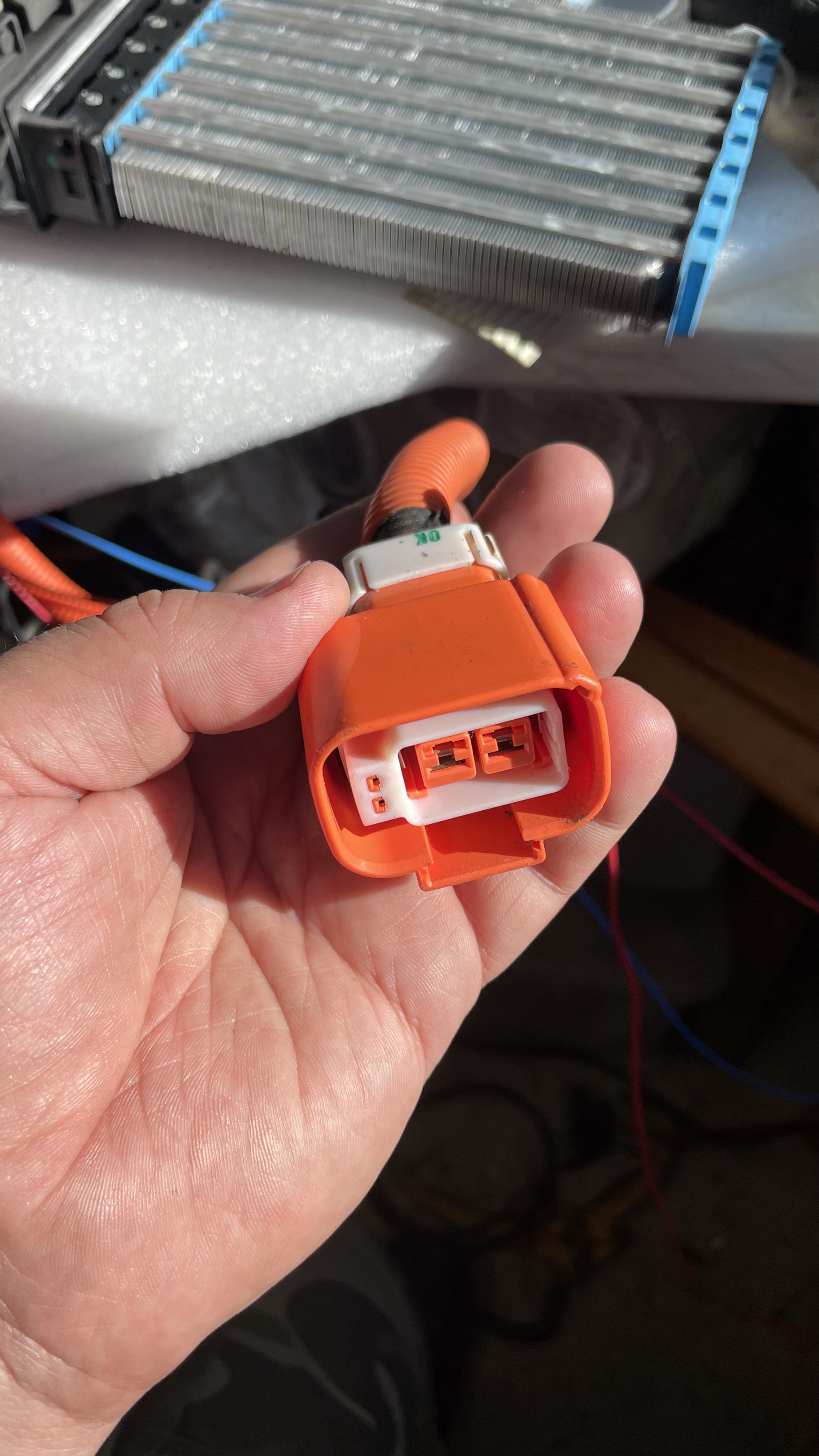

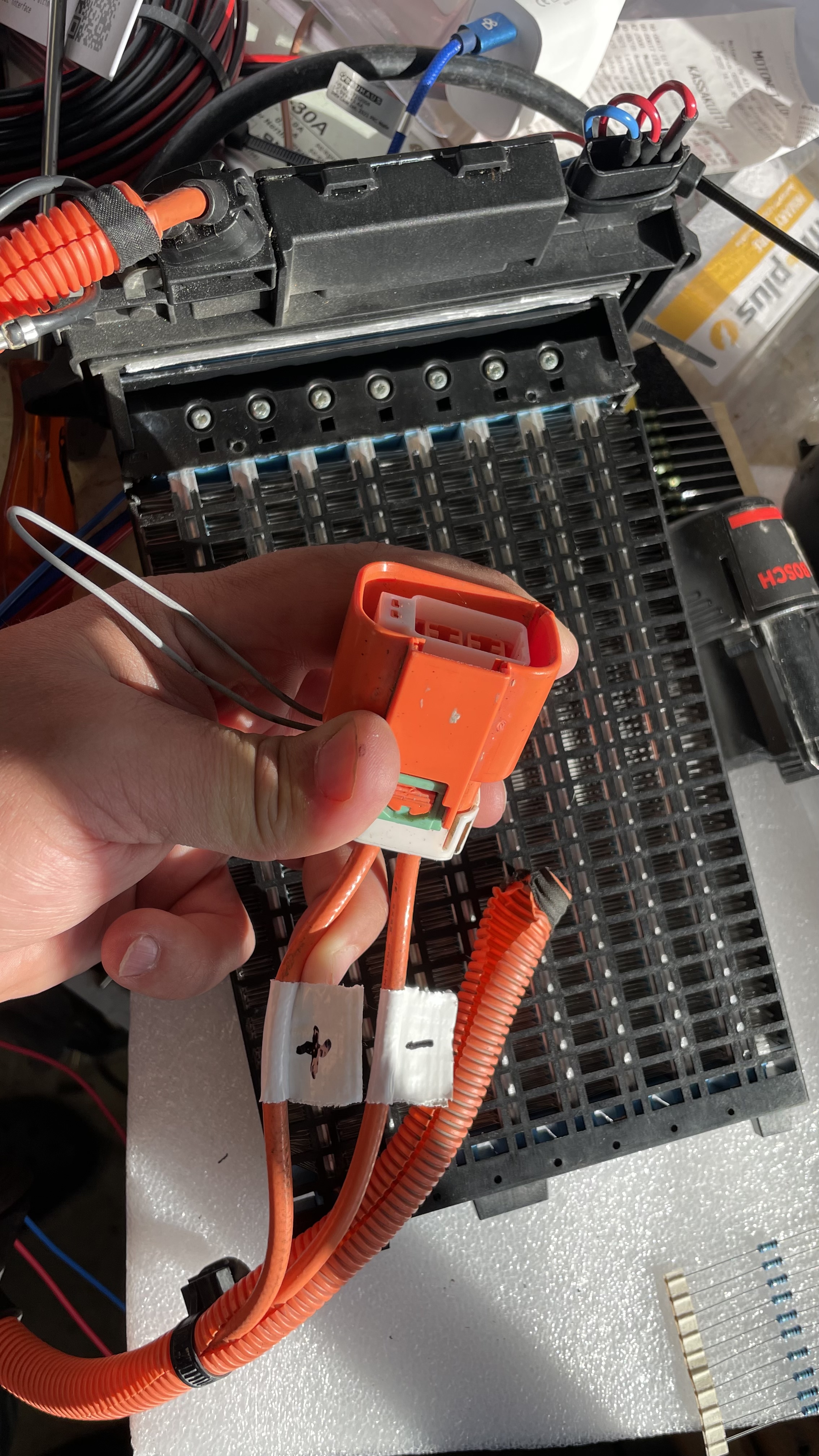

Hi, has anyone been able to figure out the polarity of the HV connector of the Leaf ptc heater 27143-3NF1A?
Even it is resistive load, I guess, the polarity matters.
Many thanks!
Many thanks!

Trying to mimic the work shown at link (https://ev-olution.yolasite.com/nissan- ... roller.php). I only have 170V dc available at home now and feels the heater is not working with that. I keep trying…EV_Builder wrote: ↑Sun Jun 12, 2022 4:21 pm How is the heat intensity controlled and where is it done?
Polarity sorted out here:
