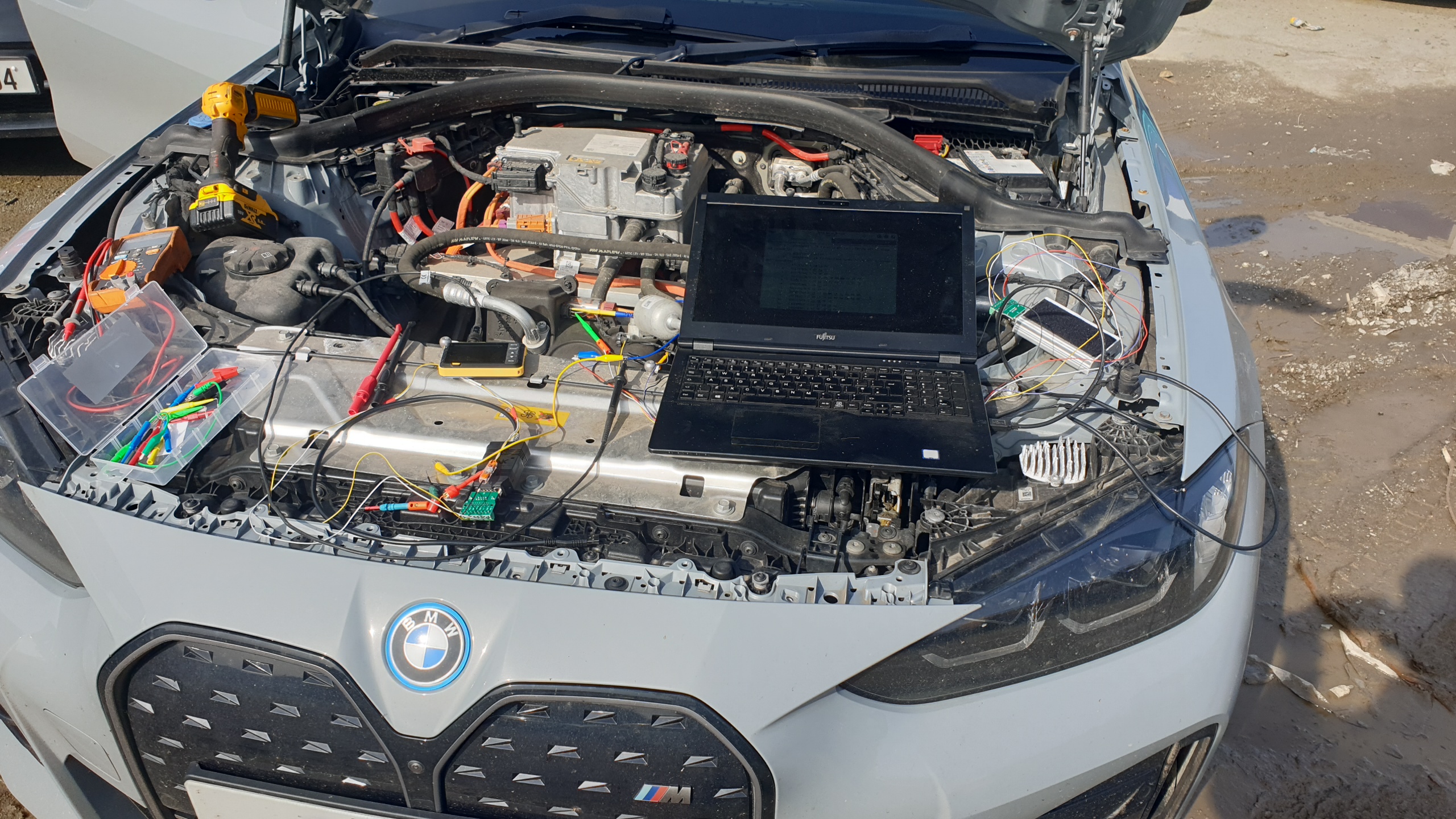

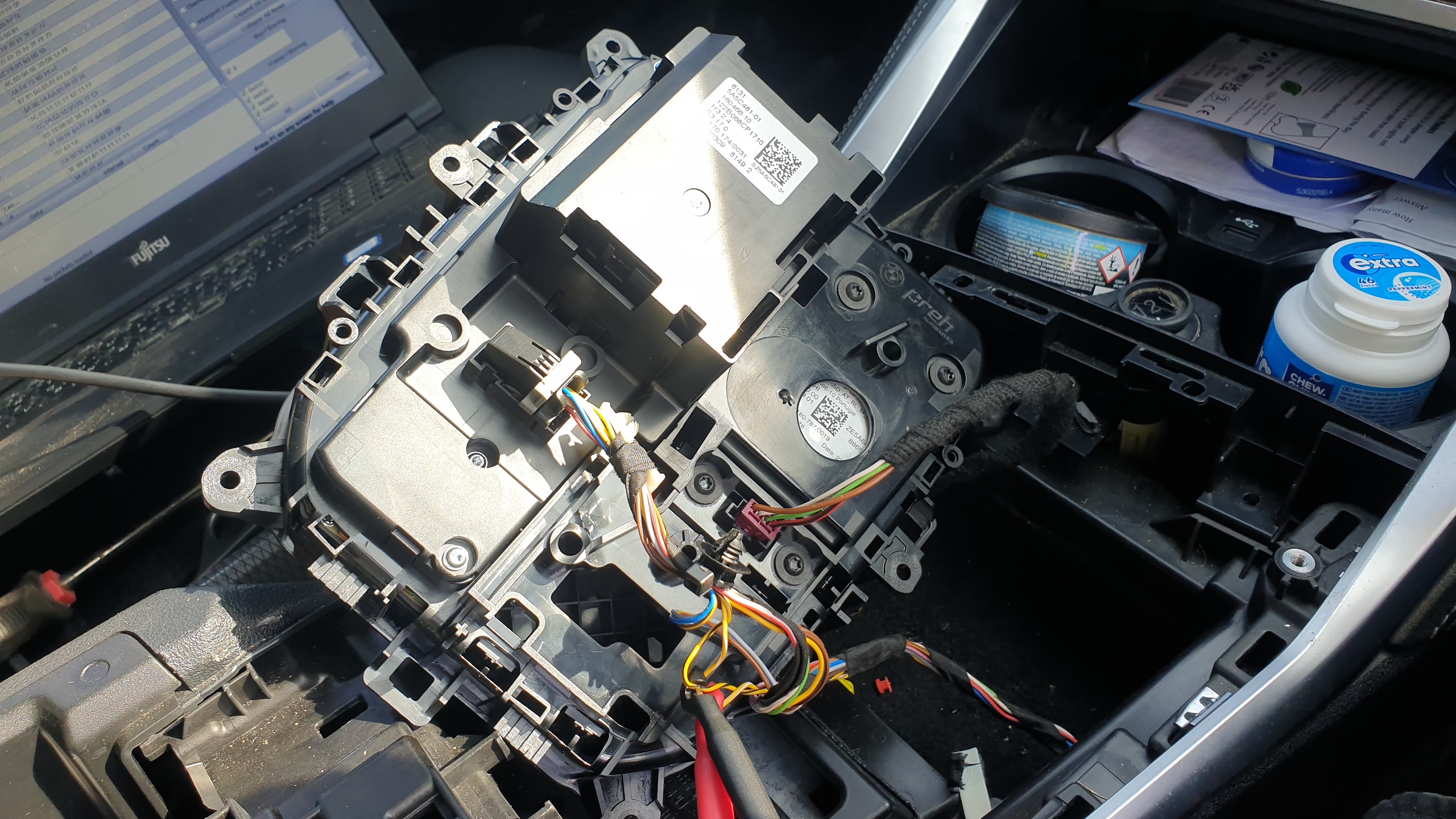

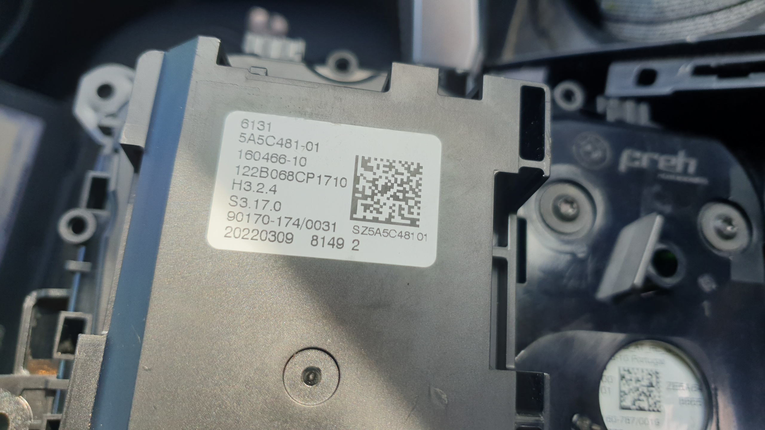

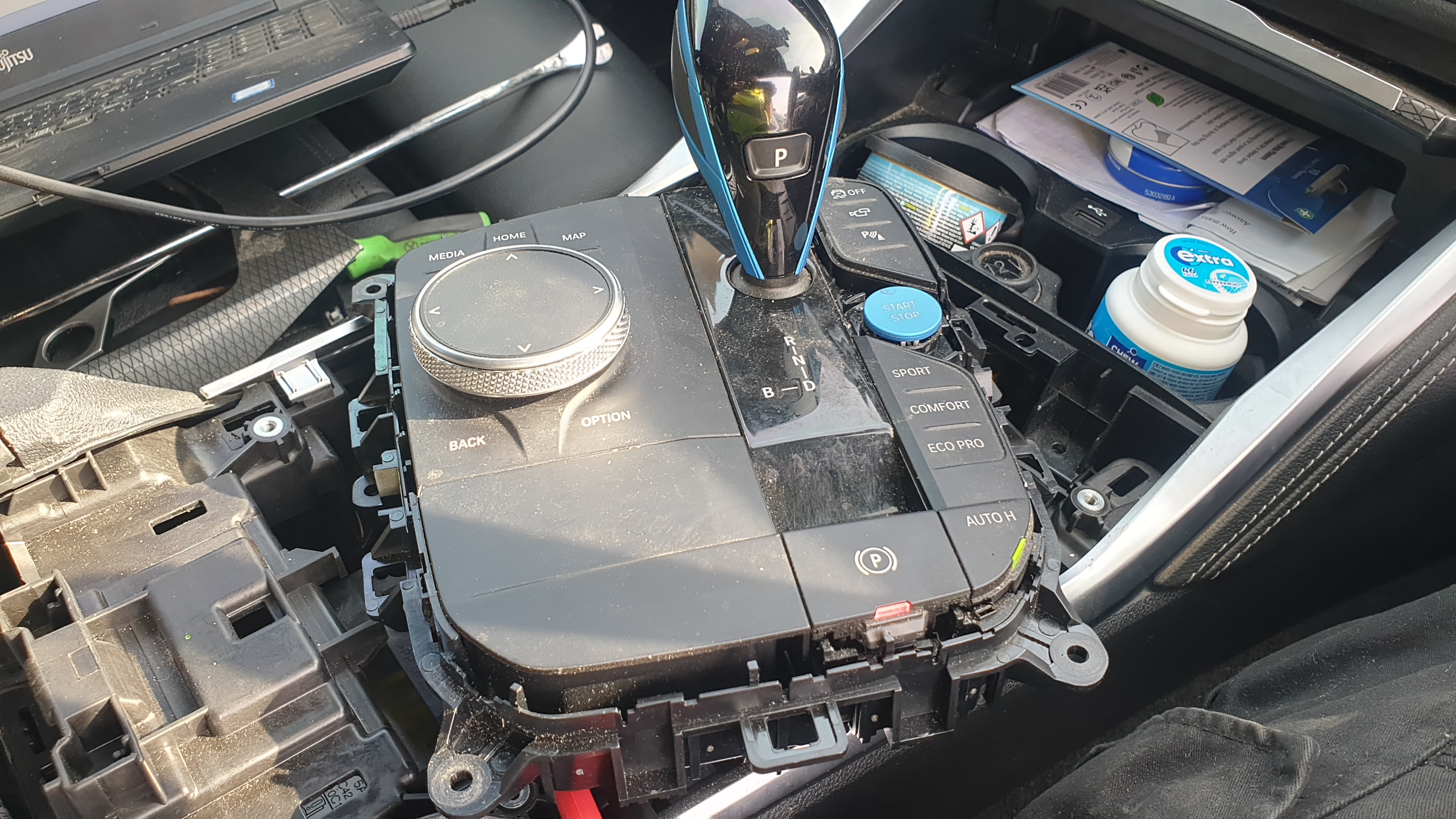

Can log from gear shifter going through gears and creeping. LIN log from Aircon compressor. LIN at 19200kbps. CAN at 500k.
2022 i4 G26 Gran Coupe AWD.
