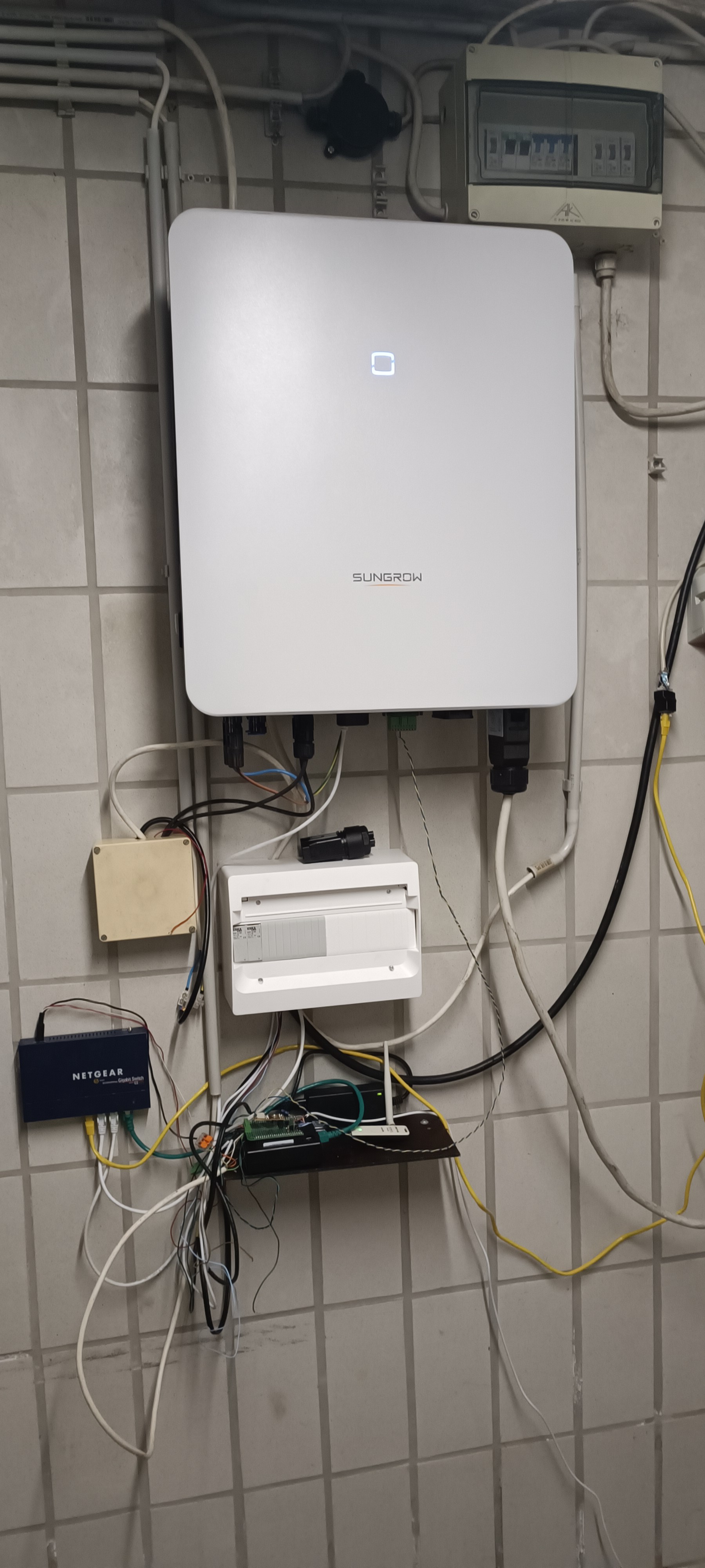

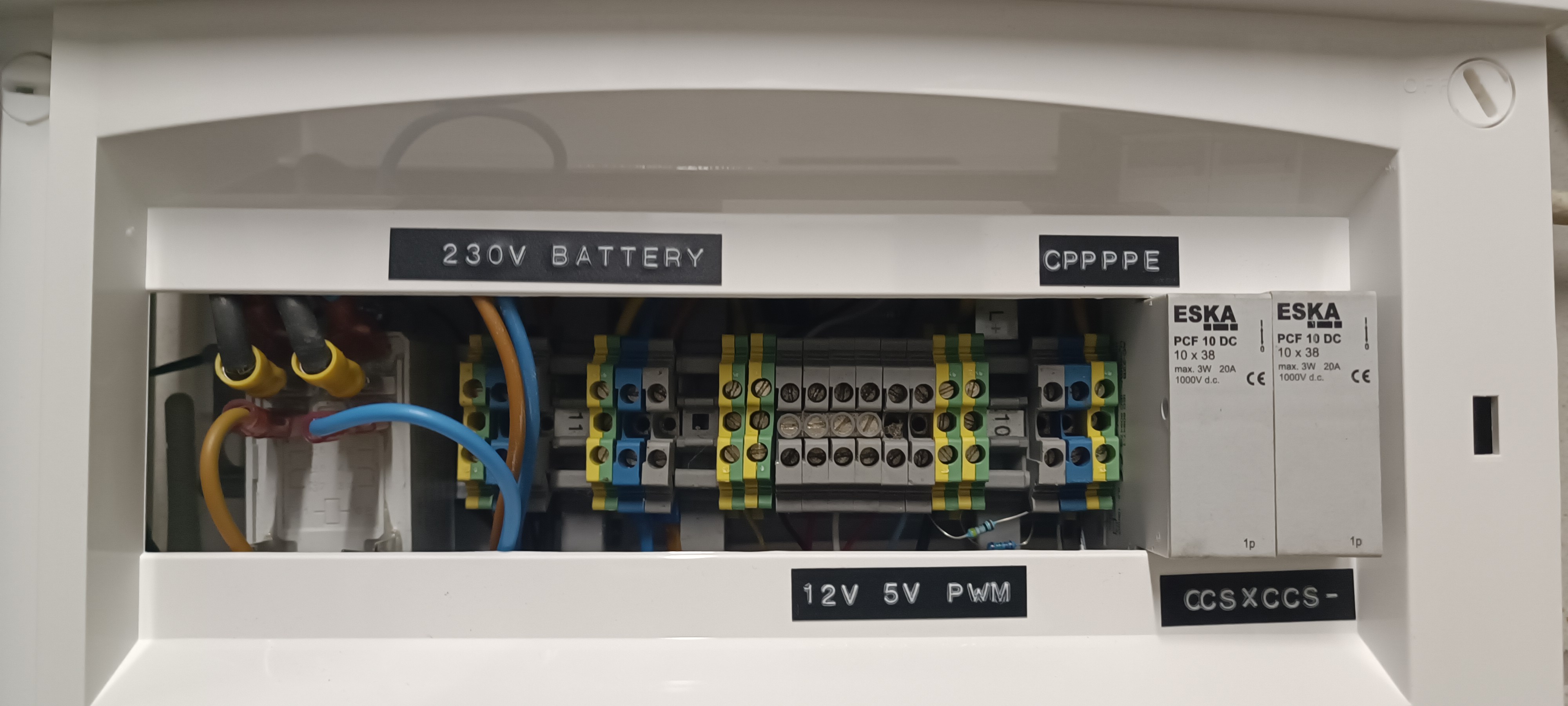

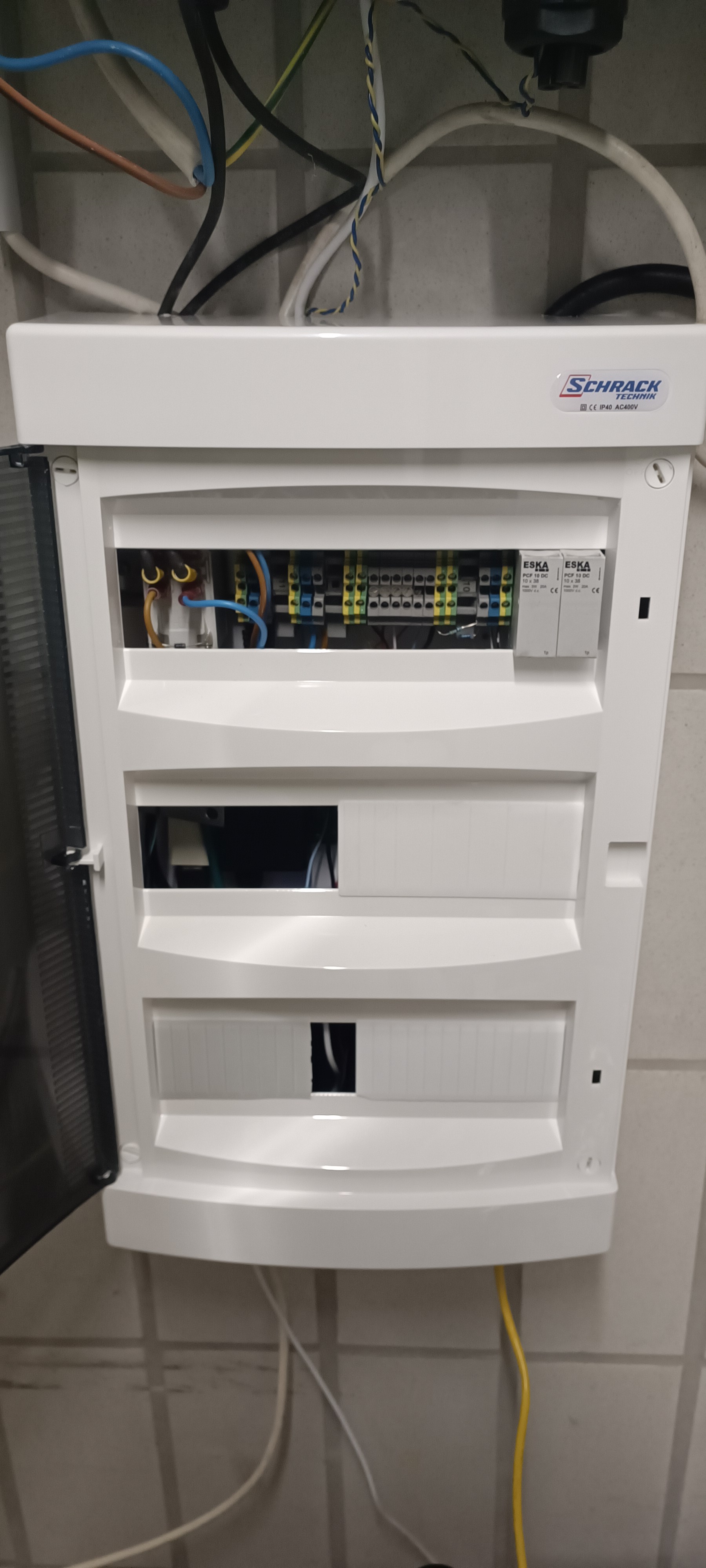

Re: Bidirectional charger with PV Hybrid inverter and pyPLC
(Sorry for posting charger related stuff in the other thread: viewtopic.php?p=79001#p79001 )
For completness, also mentioning it here: To apply a HV voltage to the DC lines, I use this modded step-up converter: https://github.com/dalathegreat/Battery ... age-source In pyPLC I then just try a few PWM frequencies, until the car is happy: https://github.com/lewurm/pyPLC/blob/cd ... #L303-L339
However that doesn't work well if the inverter is on the same line, as the capacitor in the inverter would take aaaaages (I tried, and stopped after 30min). For my inverter, Kostal Plenticore Plus G1, that wouldn't work anyway: The protocol essentially requires to apply HV voltage to the battery input at a given time when the inverter asks for it. So matching that timing with the PreCharge of the car is kind of impossible.
Instead I'm using three contactors (one with a precharge resistor, although I think that one wouldn't be strictly necessary in my case). I only start communication with the inverter once the car is in CurrentDemand and thus only once in this state the inverter can request closing the contactors.
I'm using this: https://www.te.com/de/product-2071584-4.html
With this setup the car (Tesla Model 3) is in CurrentDemand within less than 10s after plugging in. Until the inverter then finally (dis)charges, it can take up to two minutes. Not great, not terrible
No physical interaction with the inverter is needed in my setup, which was particularly important because the inverter is located in the basement.
I should mention that someone wrote a tool to interact with the web API of the inverter, and that allows me to toggle battery support of the inverter programmatically, which makes it overall more predictable: https://github.com/lewurm/pyPLC/blob/cd ... 1105-L1117

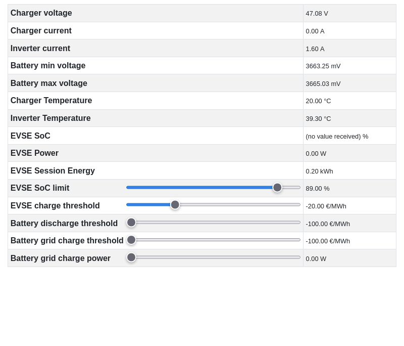

Small update on this. I have tweaked the scripts to automate things more. Now as soon as CCS is plugged in and the inverter ready the control script changes over to using the cars battery instead of the small stationary one. I installed an IP67 switch with LED next to the car to stop the CCS session. The LED blinks when the system is ready and is solid once pyPLC is in state CurrentDemand.
Here is a pretty nice day that has everything
- Charging the car from solar PV (yellow)
- Running dishwasher and laundry machine from car (and PV)
- Changing over to the stationary battery (blue) as the car is disconnected
- Supplying smaller loads in the evening
You can see there is very little draw from the grid that day (red). PV supplied enough energy for cooking, dish washer, 3 laundries and even added 2% (1 kWh) to the car.
PV power isn't measured as it comes from 4 micro inverters.
I've also added more controls to the web page: So now I can program max SoC, maximum price for EV/stationary charging from grid and minimum price for discharging either of the batteries (I'm on a dynamic spot market plan). So already some degree of automation.
Would like to automatically determine the thresholds with forecast data. There's a project that apparently does this but I haven't understood how to use it
https://github.com/Akkudoktor-EOS/EOS

Big update on this. I have removed the old 1.5 kWh storage system and now rely solely on the Sungrow inverter to shift all the power around
I connect V2x and the stationary battery via a changeover relay. It would be great to change over from the stationary to the car battery without powering down the inverter.
To give the inverter something more to do I connected some PV panels to it:
In summer this yields 2-3x more energy than I use on a typical day. Will now stick a dumb heater in the warm water reservoir and replace some natural gas with it.
I've ordered a small cabinet to tug it all into

Finally got around to make this look nicer.
Tied everything together in one box Looks more tidy with the lid on Whole system And finally even did some labels My label "machine" doesn't have a + sign. But I have a bit of a thing for outdated equipment
Will connect the inverter directly to the distribution box above it and free up the the CEE outlet for the traditional EVSE. Plus some more cable management and it should like real shiny
Functionwise does the same as before
